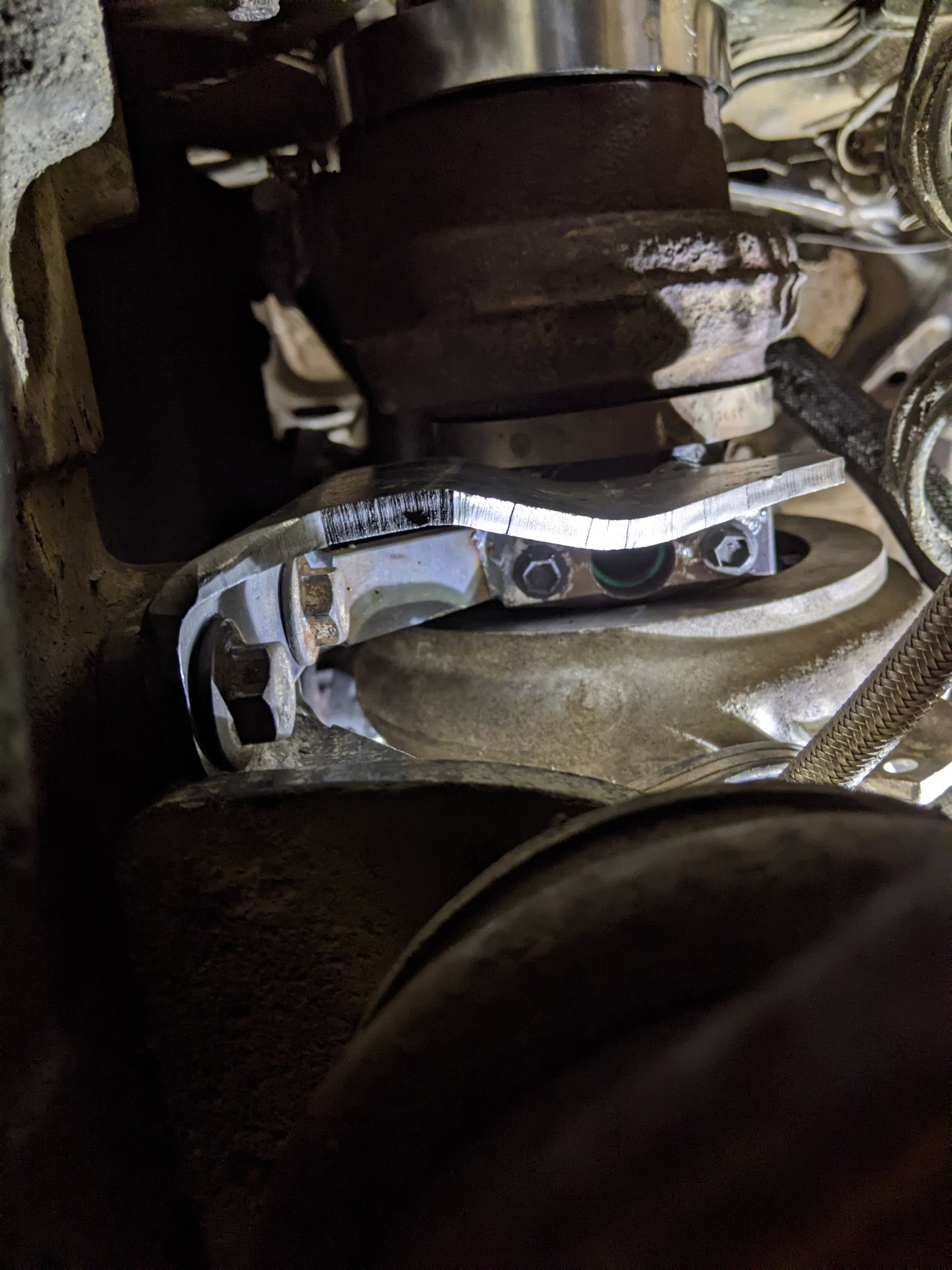

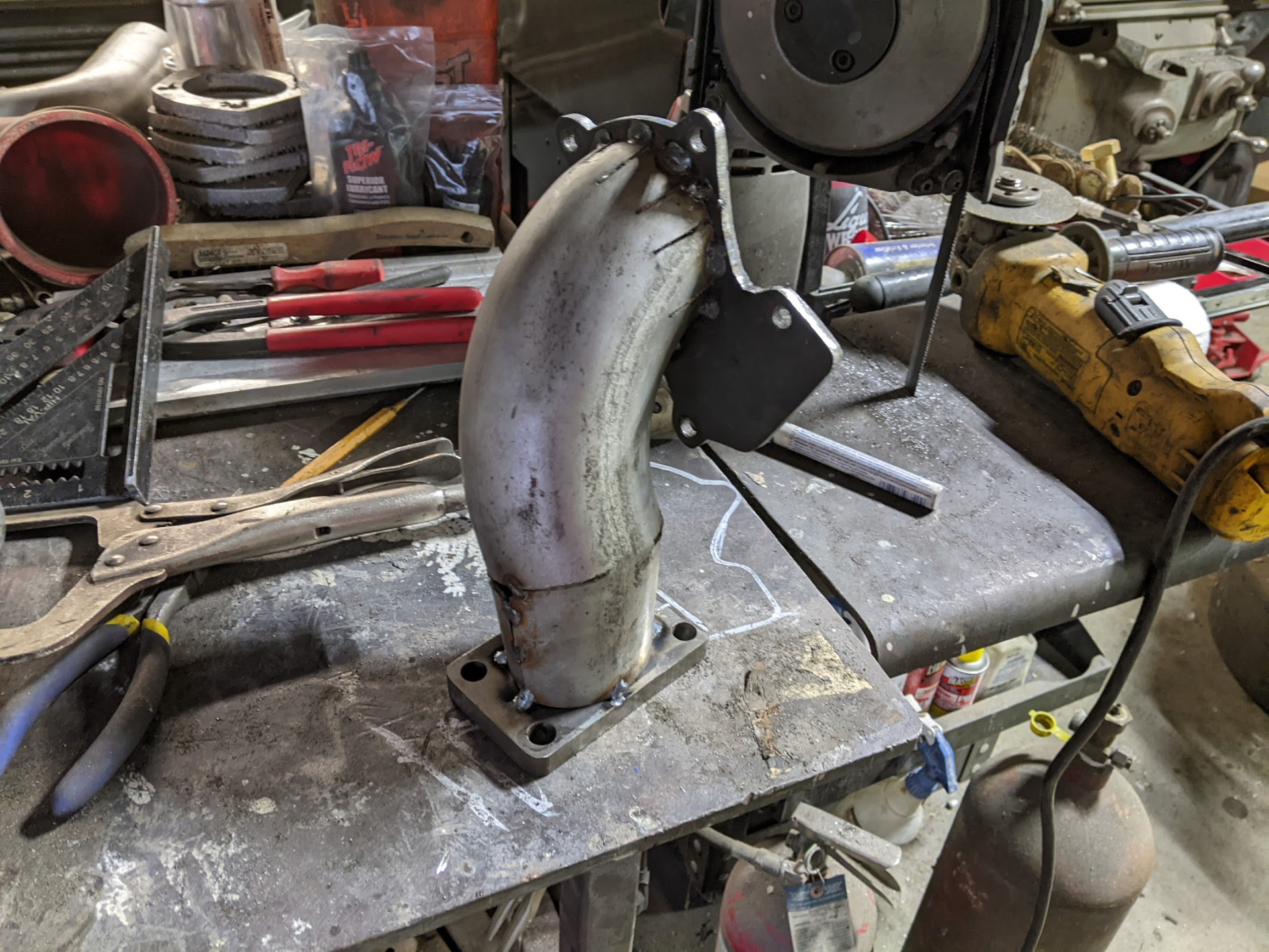

Made a backplate for the hx30 using the oem one as a template, then started on the hot pipe. I think this will work, but the pipe is only exhaust tubing, nothing heavy. The primary support will have to come the brackets, but this will help locate the primary turbo till I can get those fabricated.

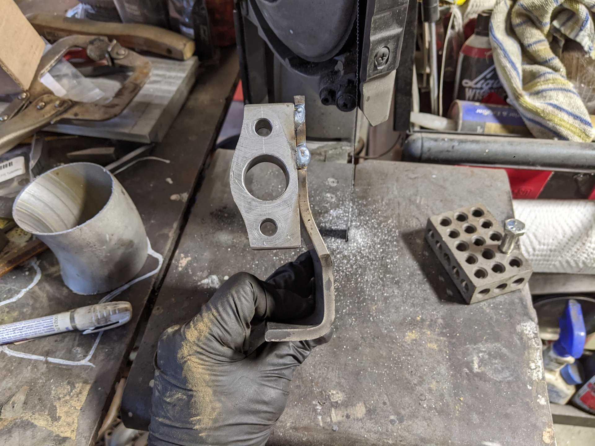

Finished up this afternoon by making a t3 flange. 1/4" a36 plate for the hx30 flange, 1/2" a36 plate for the t3 flange. Drill press, mounted portaband and belt sander ftw.

I think I'm happy with this hot pipe. It's a little awkward in that it has to both angle towards the block, but also reduce to T3 size. Couldn't angle the pipe straight to the flange location because it would have hit the exhaust manifold. There are some gaps that I'm not super stoked about, but it'll work, and clean up nicely. I've got an air file that will get inside the pipe to clean up the back side when the time comes.
The fit is ****ing perfect. Somehow got it on the first try. Plenty of room for exhaust out of the atmospheric turbo along the bellhousing, then about 3/16" of room between the exhaust manifold and the atmospheric turbo's compressor outlet.

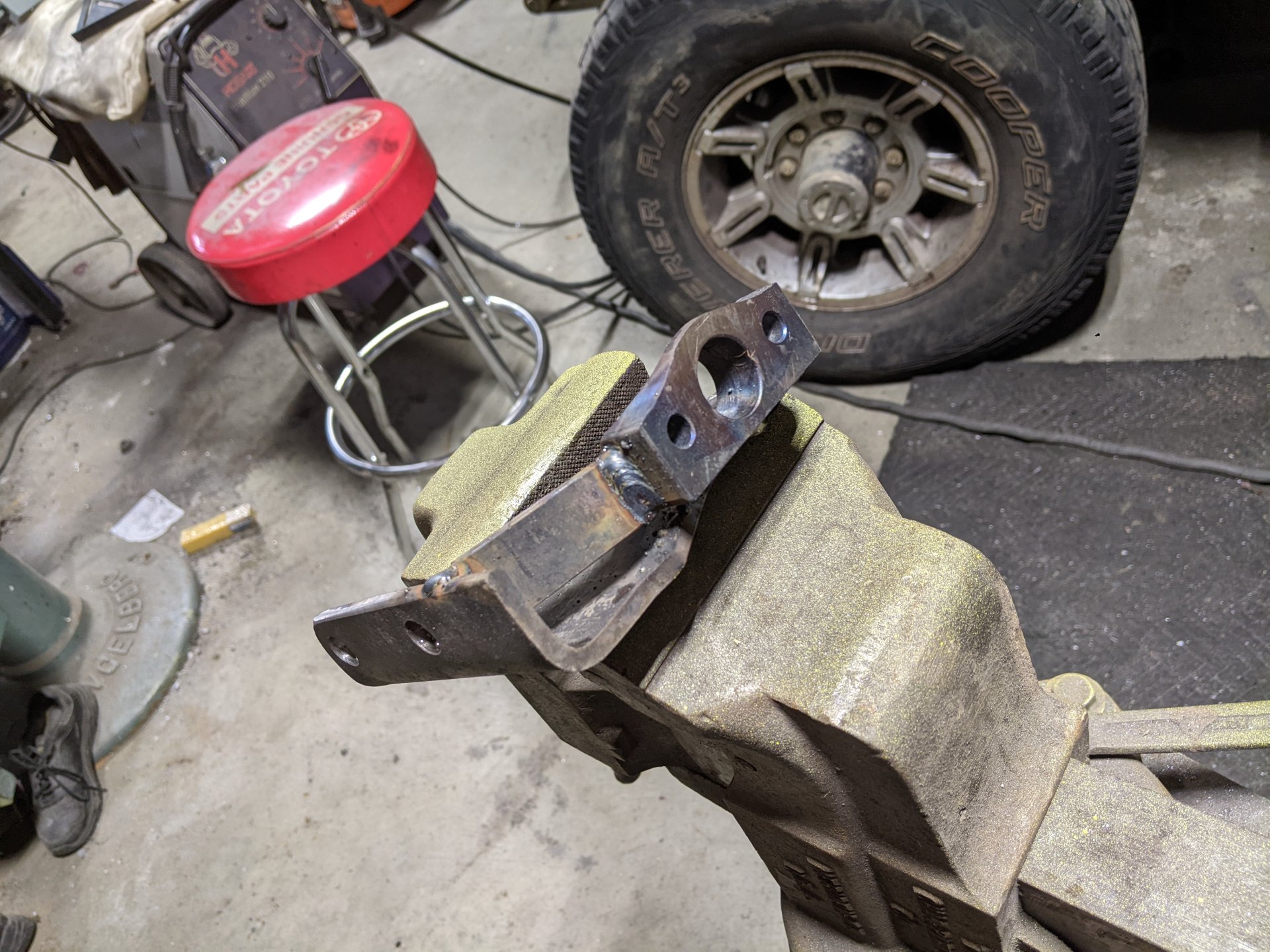

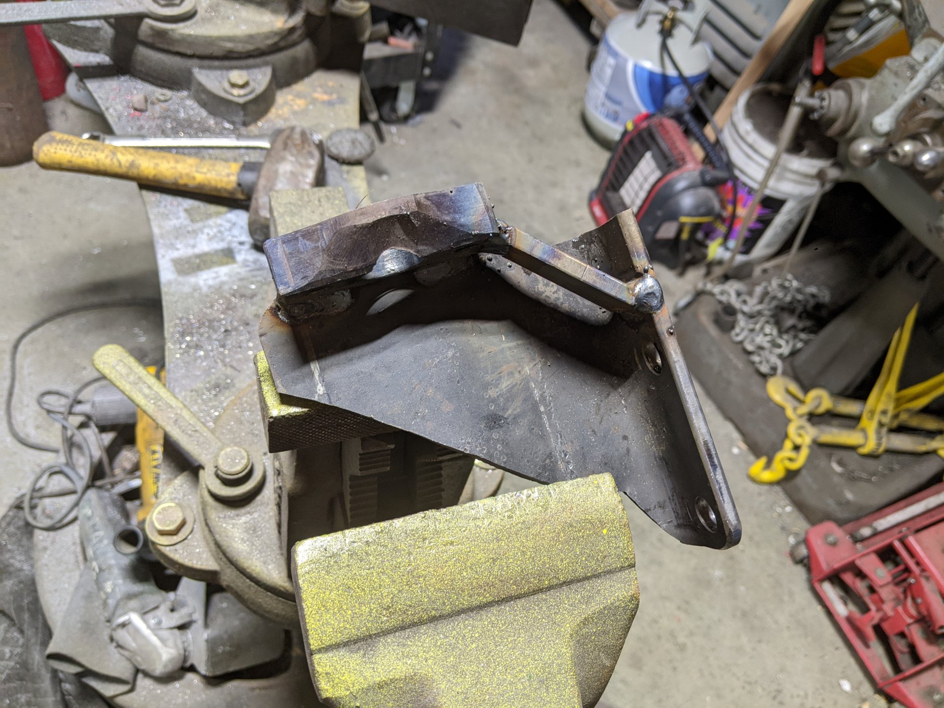

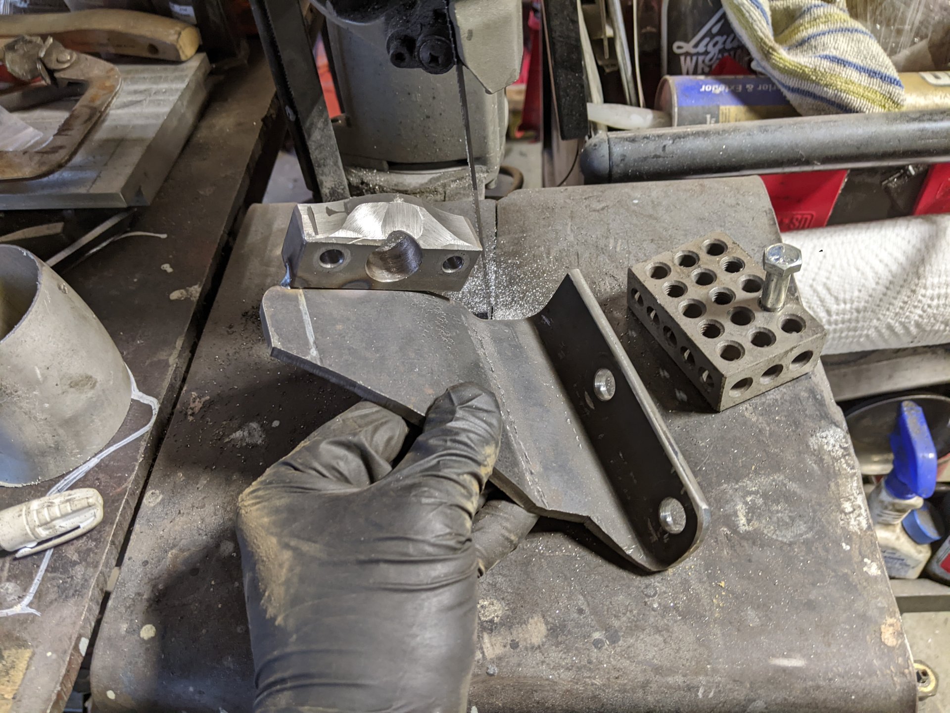

Little portaband action, mill action, more portaband, belt sander, drill press, and the secondary mid-frame mount block is made. I'll weld a drain tube into this at the end.

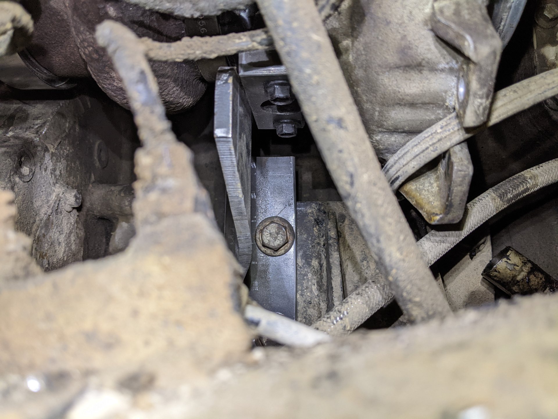

Made the secondary support bracket today and welded it to the block in place after shortening it a bit. Bracket needs another test fit and some cleanup, but I think this will be more than adequate.
Edit: test fit successful, but damn is this thing difficult to get in and out, lol.

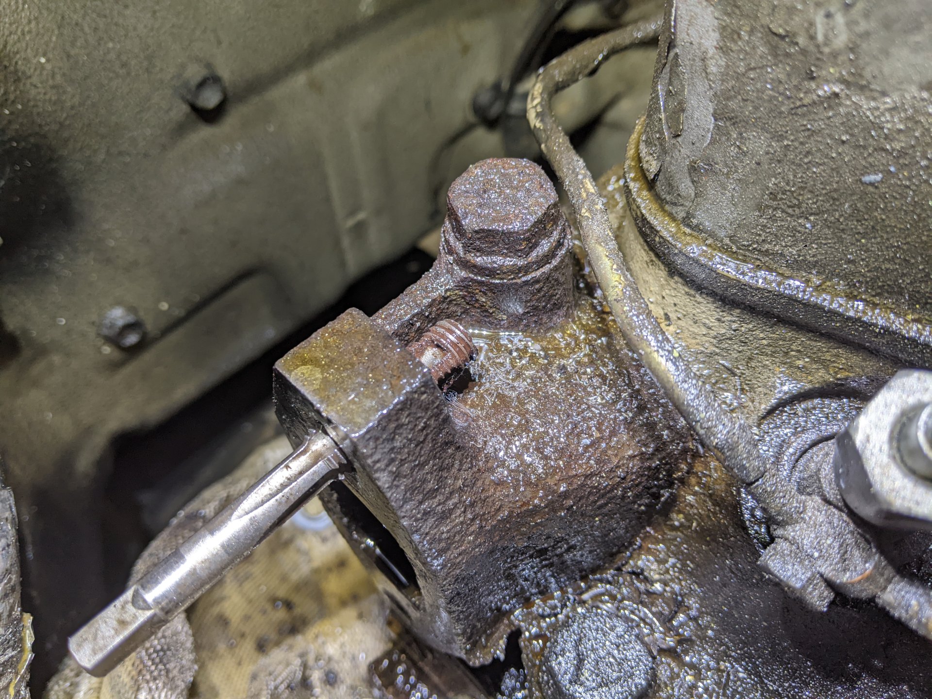

Hot pipe, primary and manifold all came off also. Decided it was time to deal with the two broken manifold bolts.
Bottom one came out after the 5th welded nut thankfully. Top one took 9 failed welded nuts, then drill through and carefully drive the rest out with a tap. Success, but damn does that job suck.
Fun to think that when this same manifold bolt broke when I first got the motor torn down. I didn't have the skill to recover it myself, so the head came off and was sent to a machine shop. Love that I can do this kind of tricky s*** myself now. Saves so much time and money.
