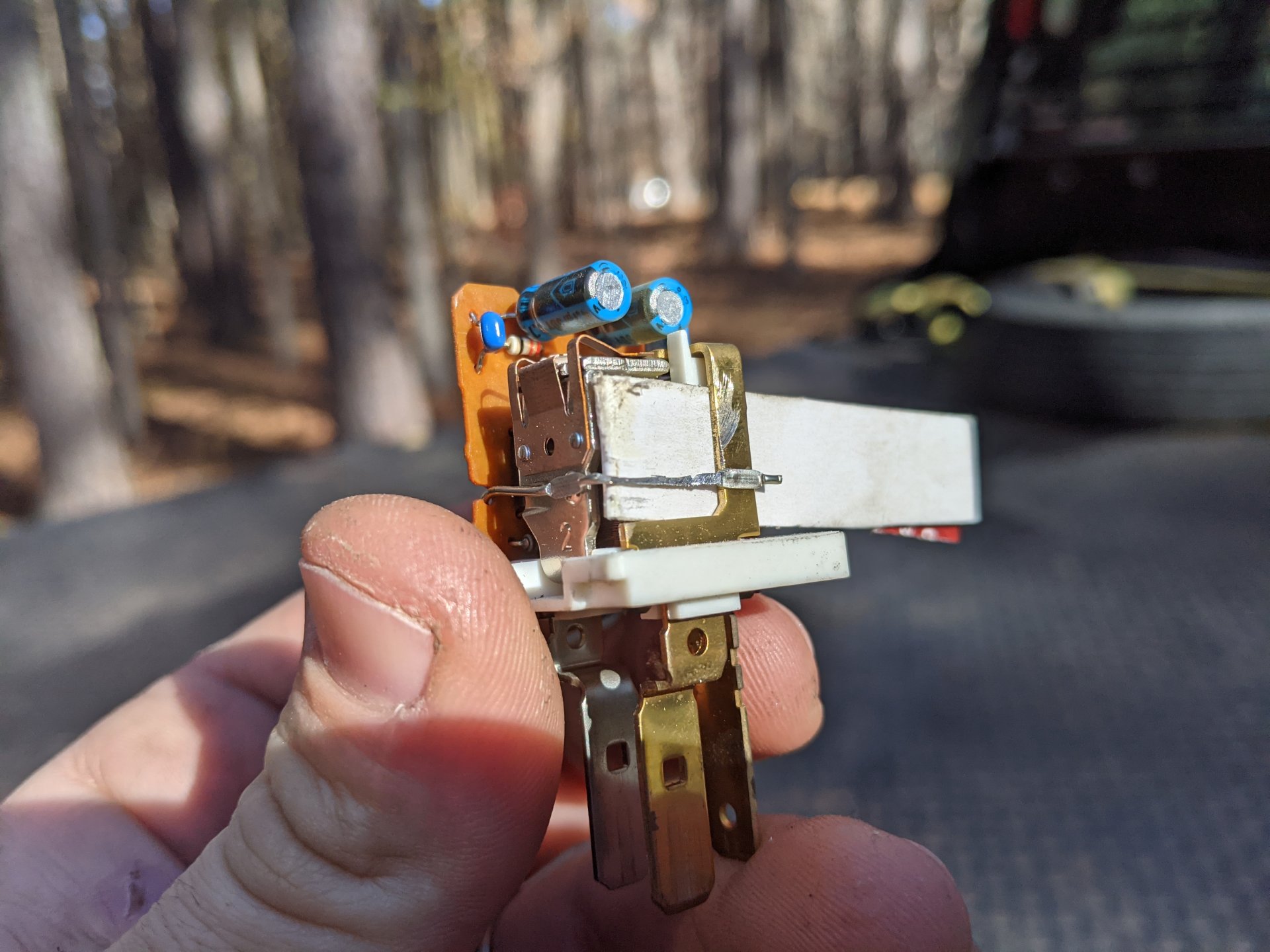

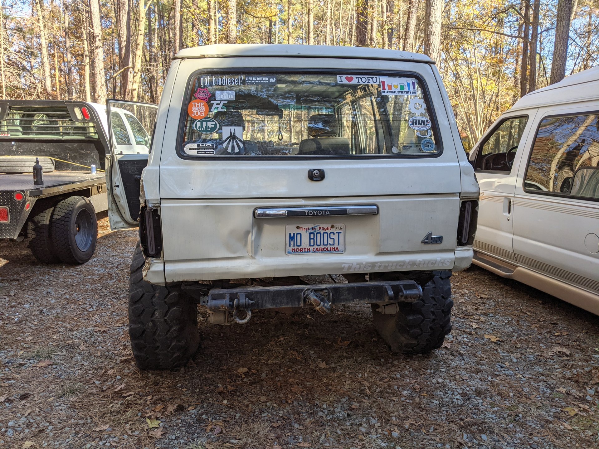

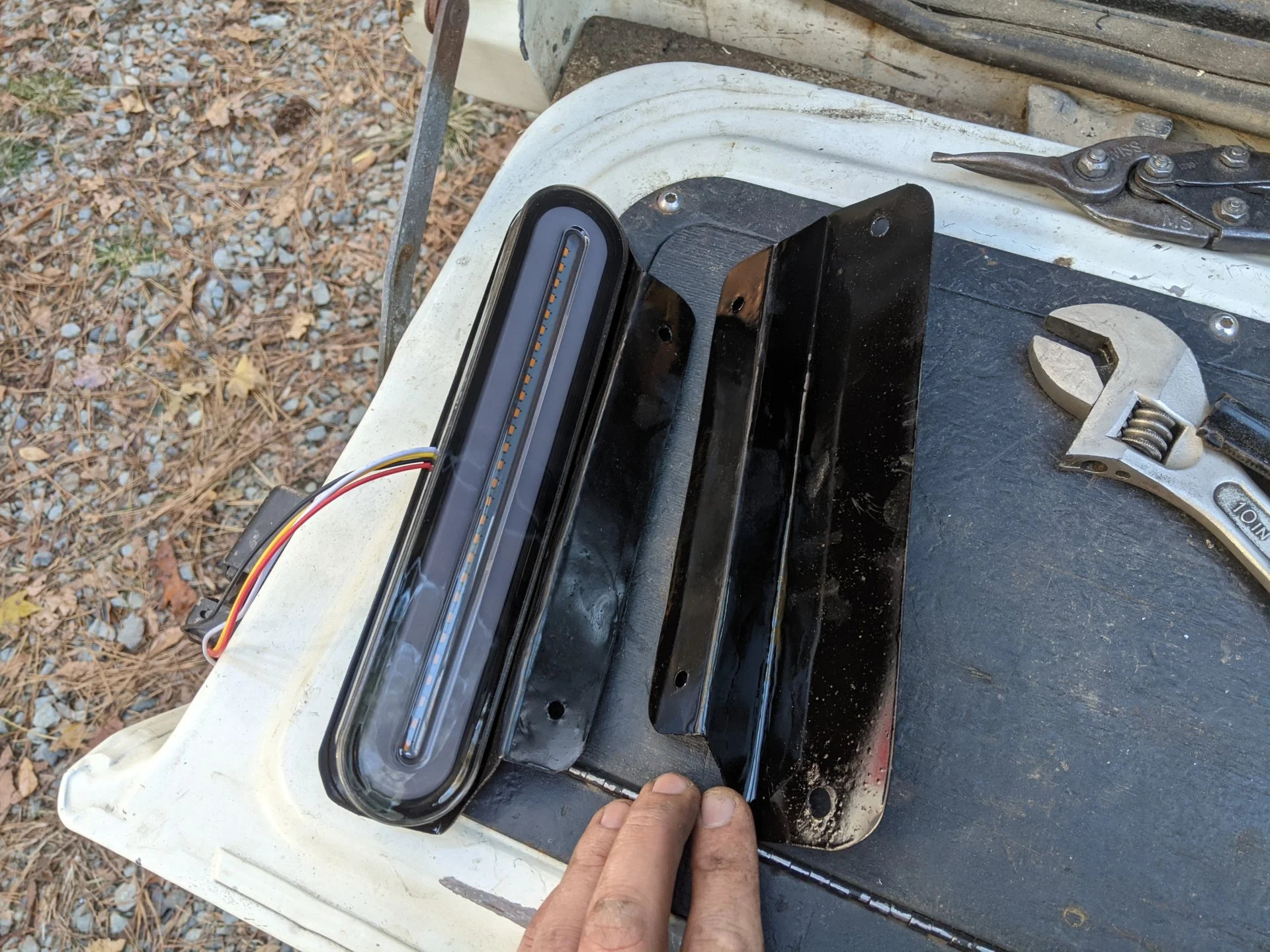

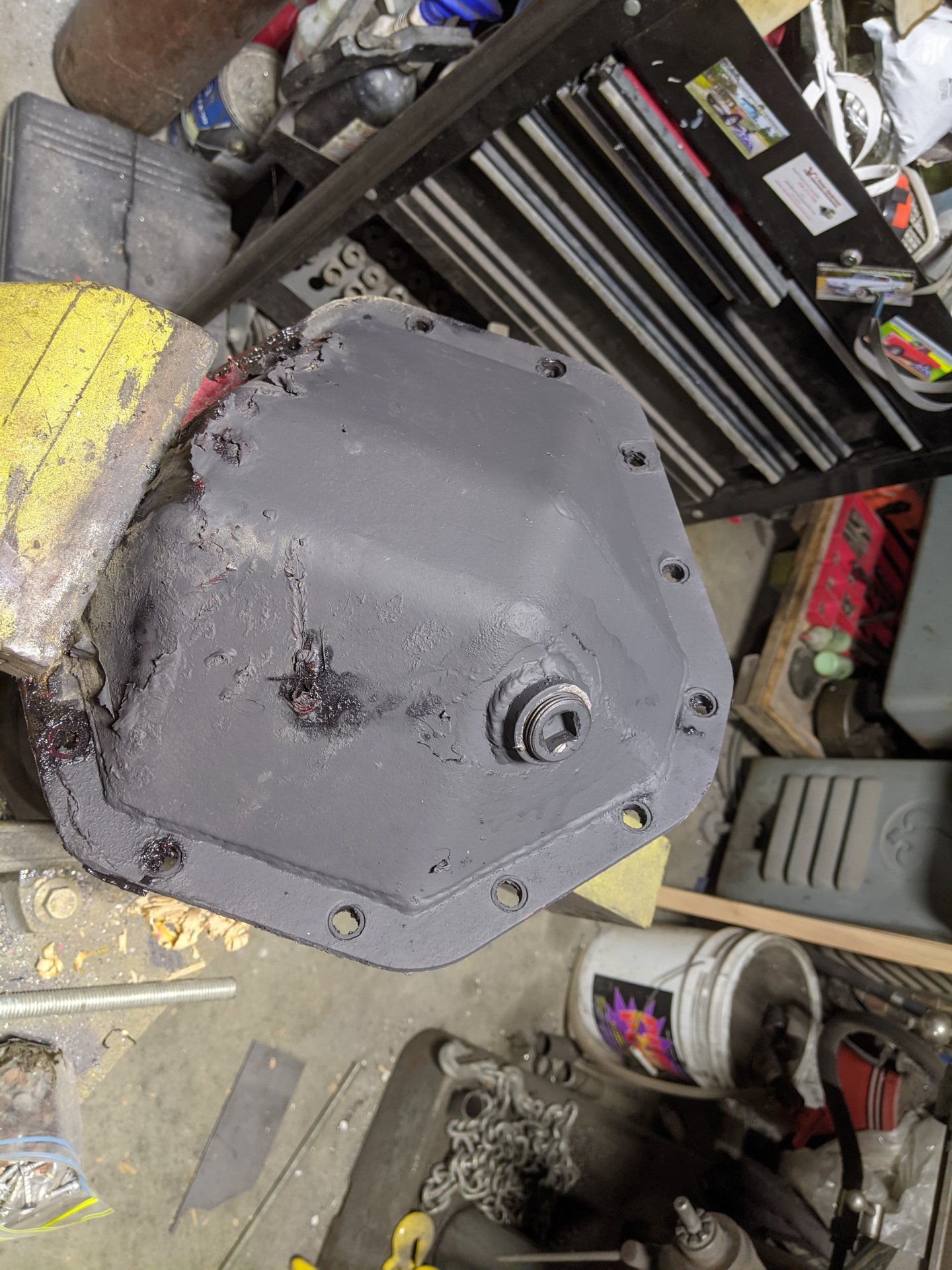

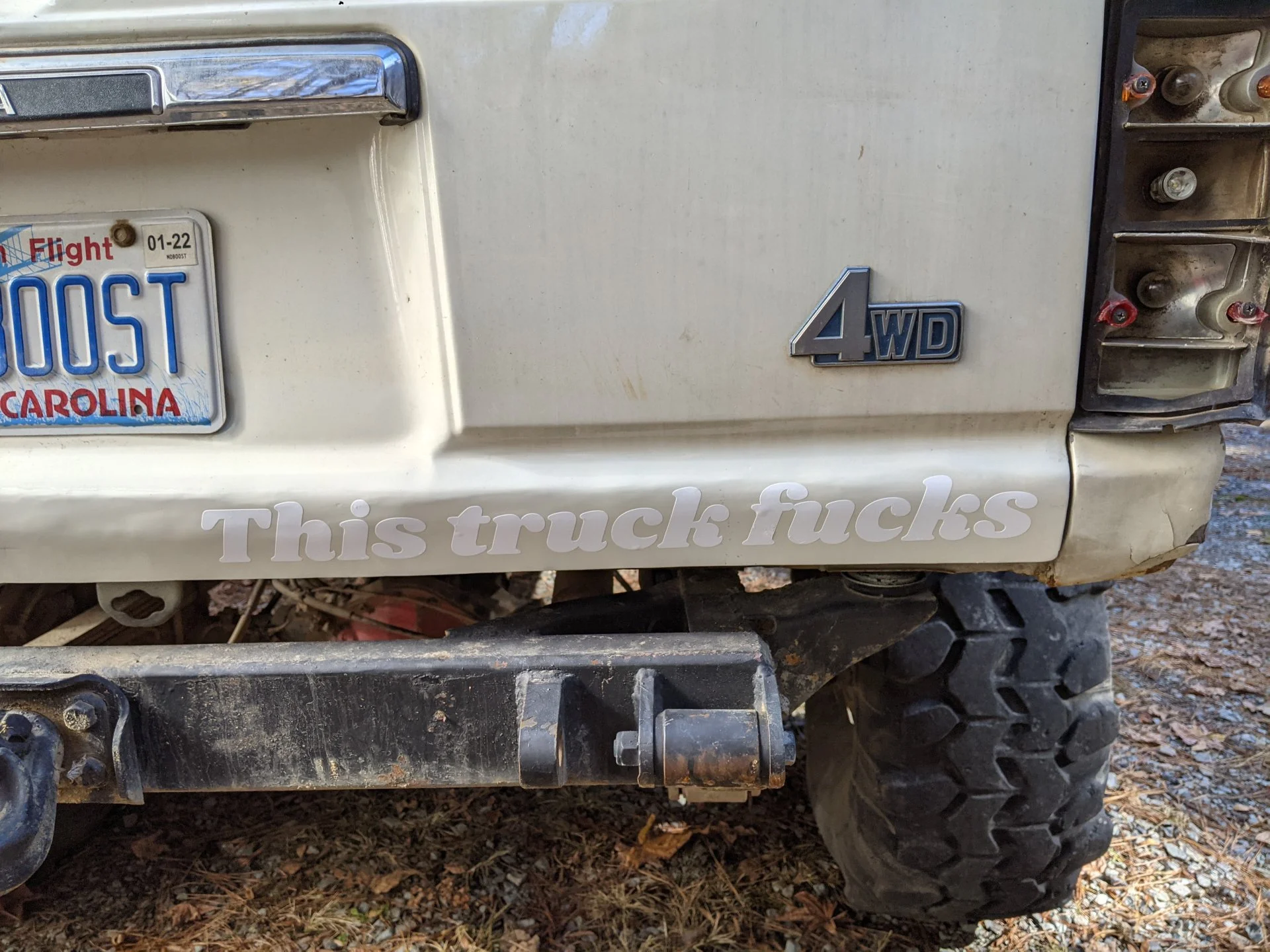

New winch line, new rear driveshaft, new tail lights that will hopefully be harder to smash, flasher speed modified for led bulbs, rear diff cover inspection plug with new gear oil and a new sticker. Just about ready for her next adventure.

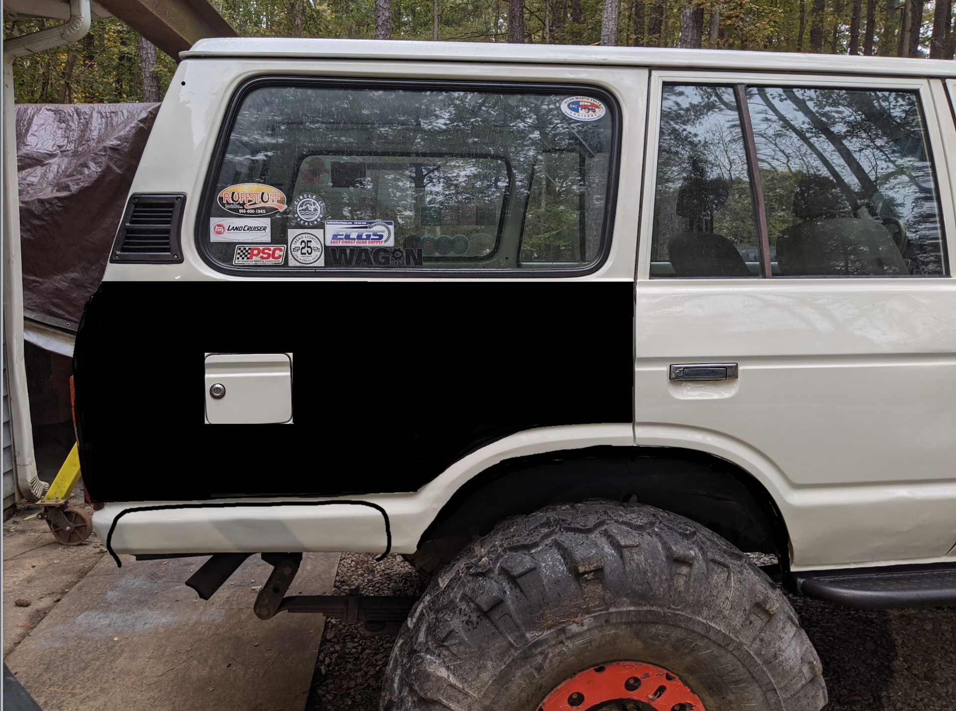

It's clear that it's time to develop some serious quarter panel protection. I have a dilemma, and need some input.
Should I come up with a plate style quarter panel system like @jcardona1 and @actionjackson 's 80s, or should I do a tube style quarter protection like @VCCruzr?
Plate style:
Tube style:
rear-armor-001-jpg.600856
rear-armor-002-jpg.600857
I think I'm leaning towards the plate style. What say you mud?
well, you know what I will recommend... plating for all my friends! and turbos, lol. :cool:
The action jackson style is more visually appealing to me, but the 60 lower quarter panel sticks out more.
How about this. Plated/reinforced on the inside down to the 60 lower body line, then tubing from the (soon to come) rear bumper up to protect the lowest portion of the quarter:
that's what's on mine. good idea.

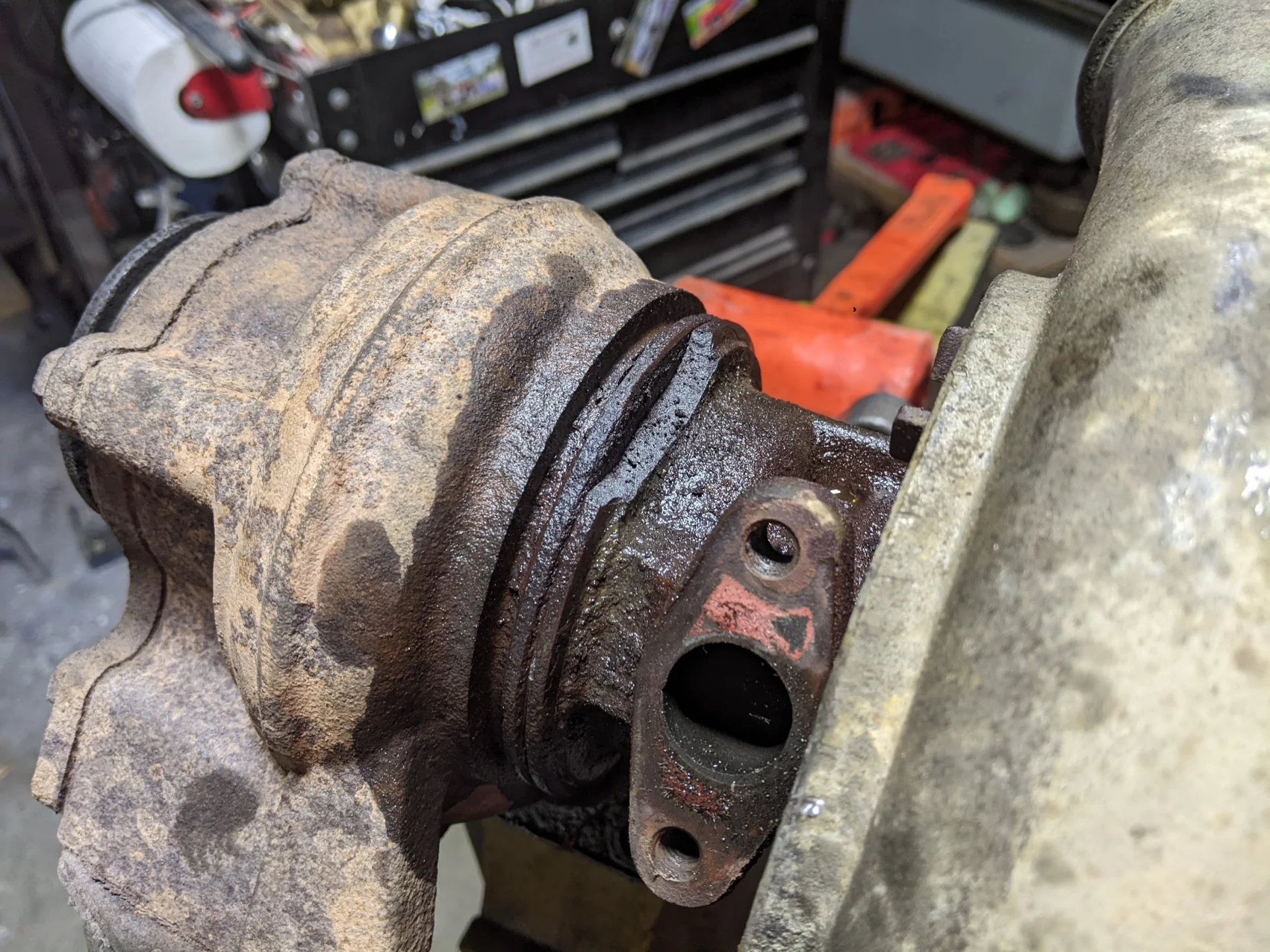

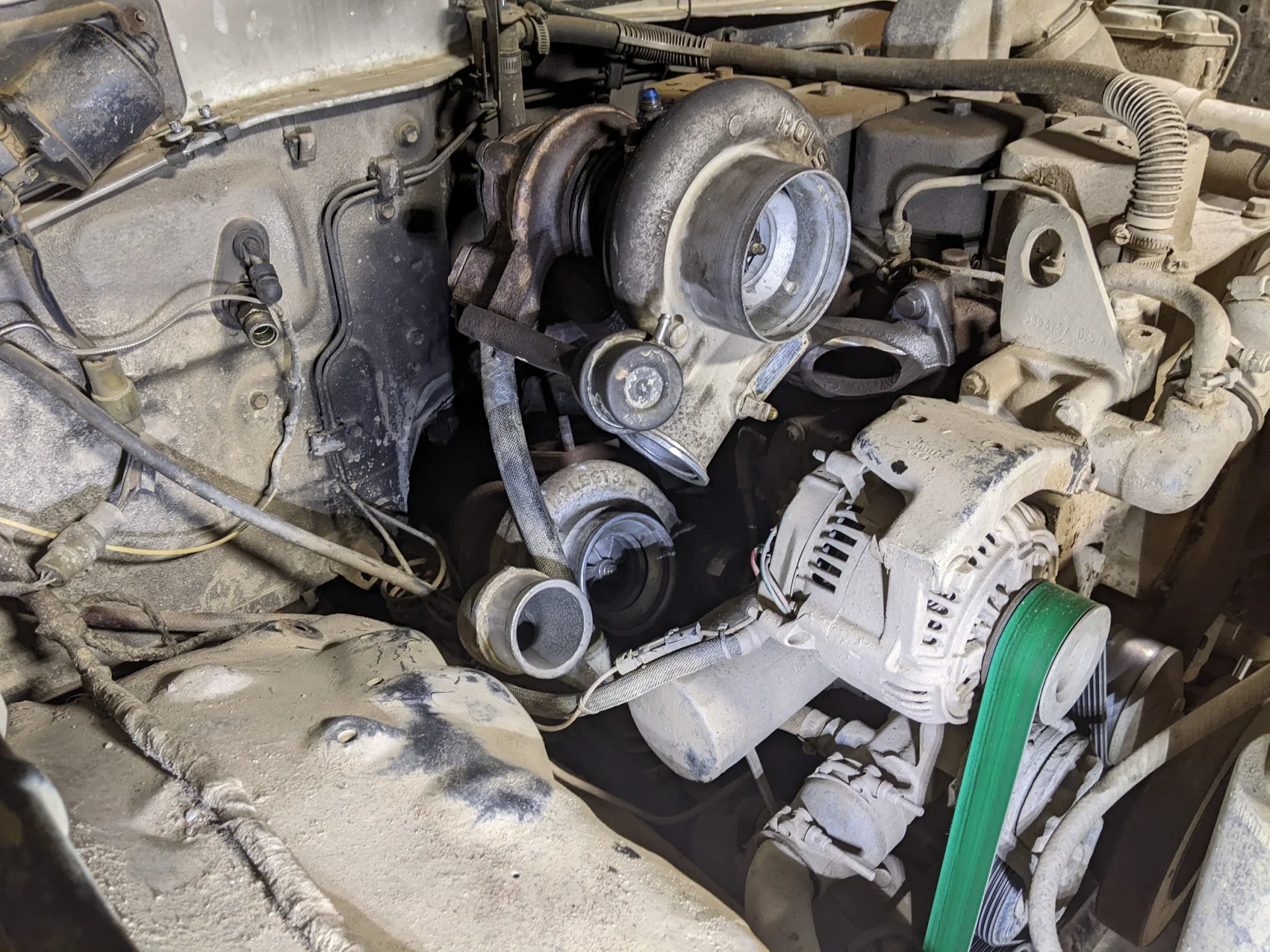

Downpipe rotted apart again, meaning it's time for mo boost.

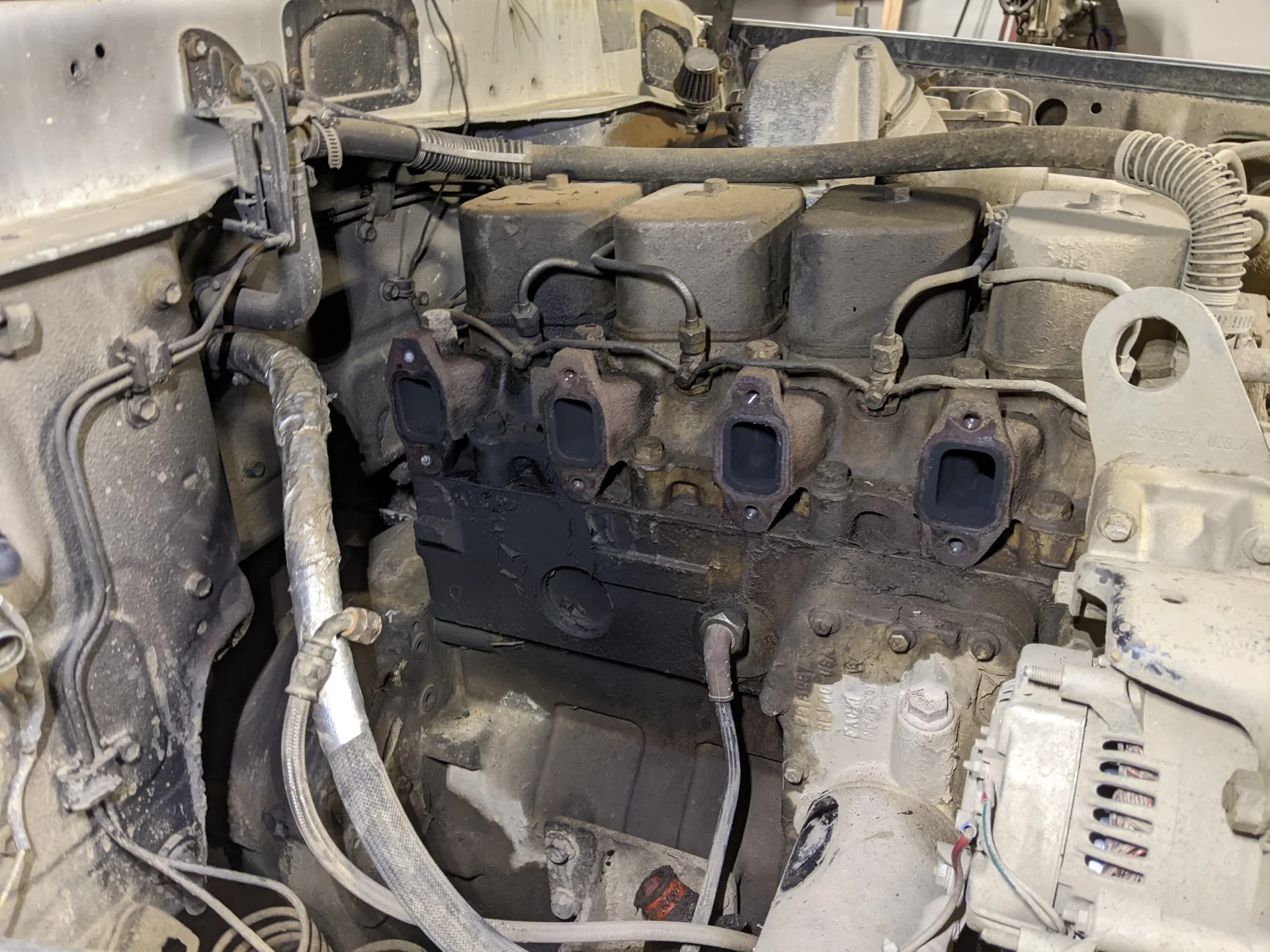

Broke the back two exhaust manifold bolts. Typical.
When attempting to disassemble my hx30 to re-clock it, I broke the CHRA :mad: Guess it'll become a toilet paper roll holder, or maybe a xmas ornament.
Chopped 24v manifold looks pretty, and allows me to use shorter manifold bolts, hopefully preventing future breakage. Plenty of hood clearance, and it gives me more room for activities.
As usual I'm going to copy what @boots4 does on his truck. Should fit nicely.
The tubing can be designed to have more kick out. So I vote tube quarters. Too bad the truck is so shredded now. It was really looking good after all your body work. I always pull the winch line before I shred the body. But I'm a wimp when it comes to body damage.
Yeah, it was shredded before, then I body swapped it with fresh paint, then I shredded it, then fixed and painted, and now it's shredded again. I'll fix it again at some point in the future, but for now it's a blast beating on it. :lol:
My sliders have a pretty big kick out, but it doesn't help when you just about lay it on its side, lol.

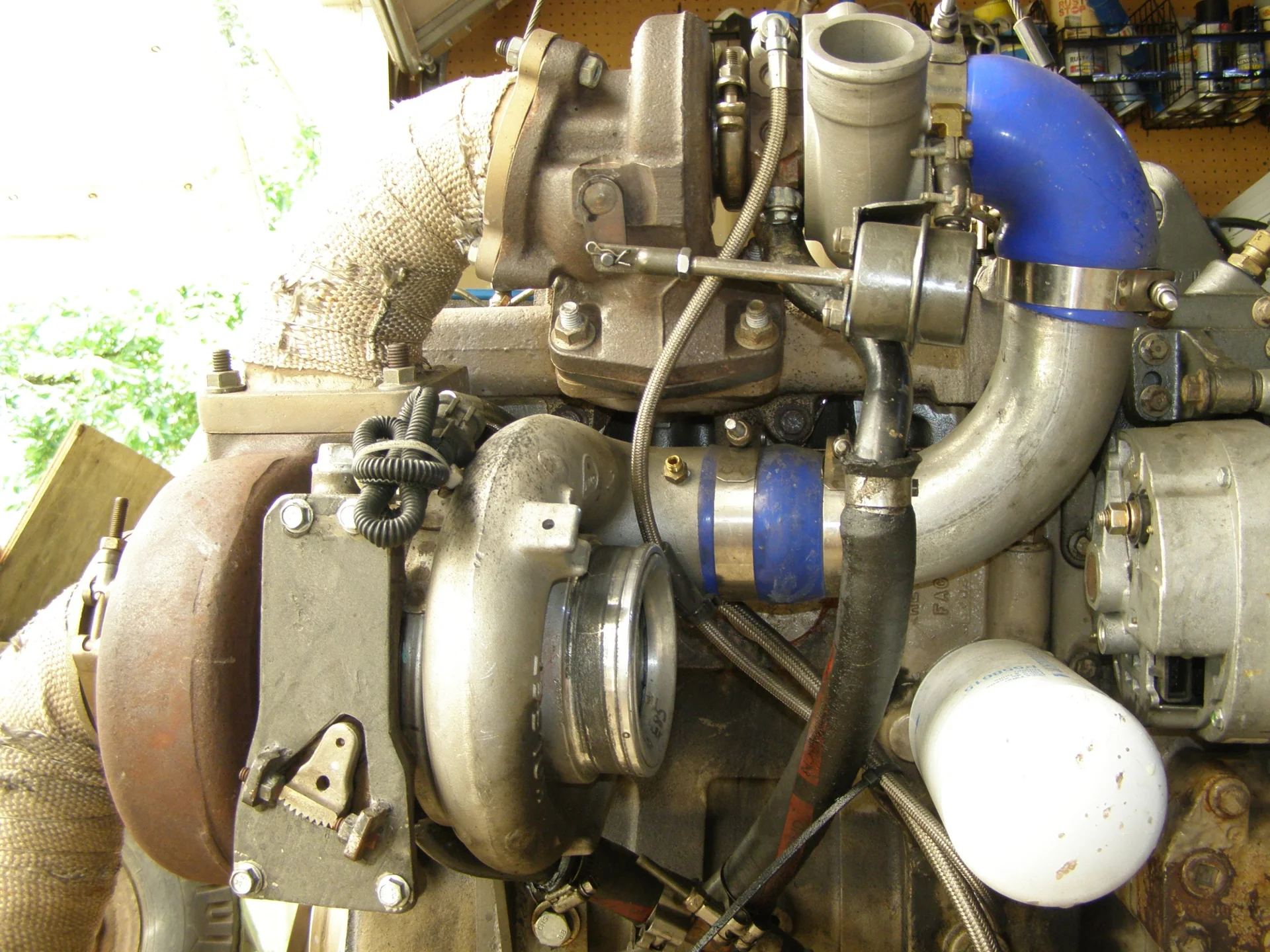

Compounds...love it. Is the 351 gonna get VGT control or live in a fixed position?
