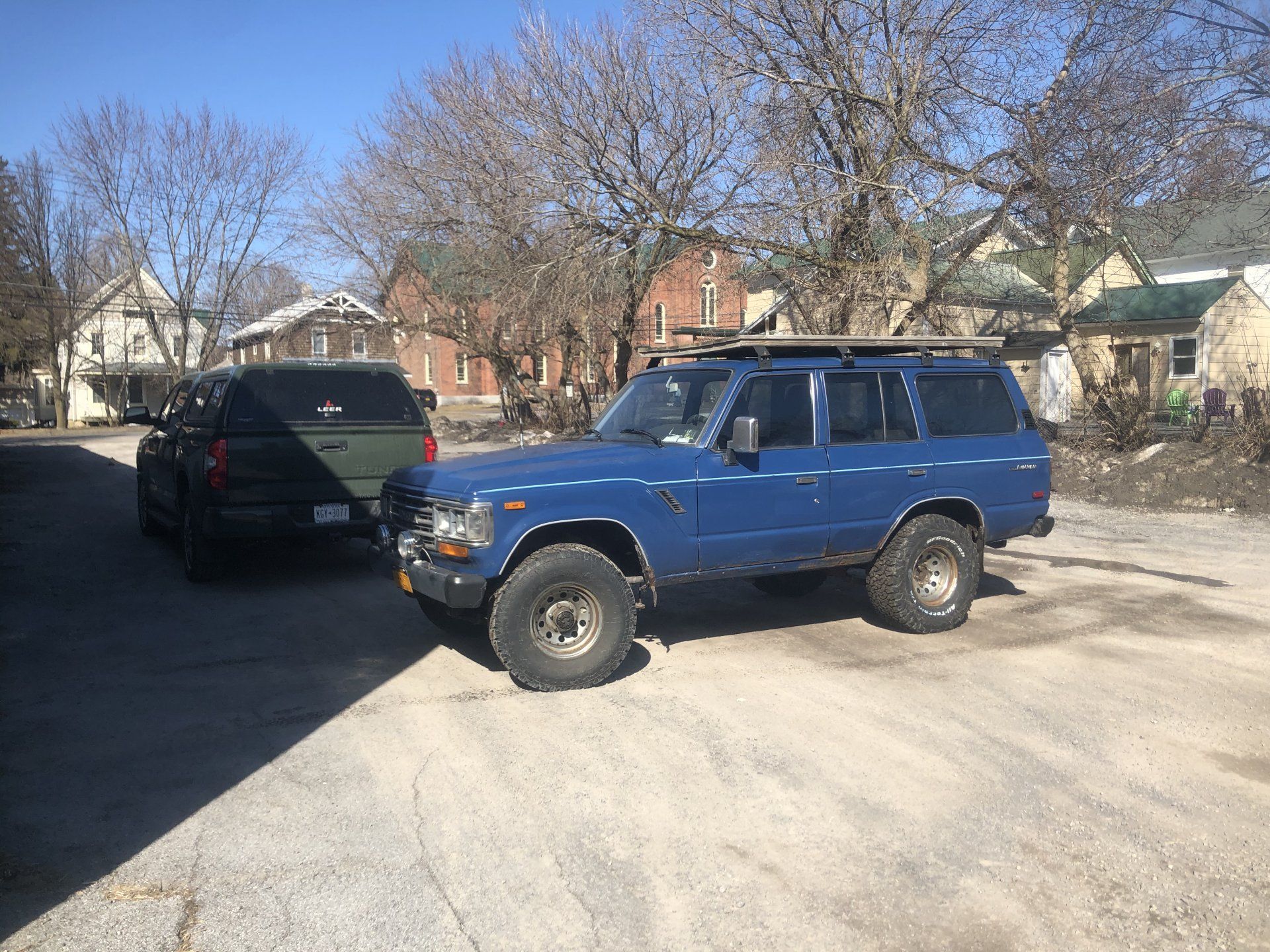

Hey. Remember this?
I got the blue beast out of hibernation this spring. Lots of work getting the brakes back on line, but otherwise she fired right up and is chugging along. A little exhaust work to reattach an 02 sensor, but after that I’ll be inspected and street legal.
I think the biggest problem is that you're keeping your Bud Light at 38*. Waaaay too warm. You need to drop that to 28* right now!
Just kidding (kinda...I like cold beer). Nice job!

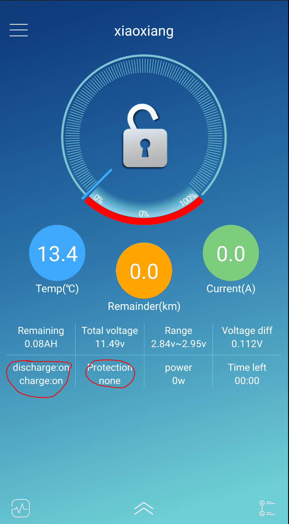

Took the truck for a drive yesterday, and I did find one hiccup. When the array SoC is very low (0-2%) according to the BMS, the array will draw over 120A from the alternator+AGMs to charge when at any RPM **above idle**. This trips the over current protection within a second or two:
This happened while driving yesterday. I noticed the issue because my Renogy monitor showed 0a charging while driving, which I've never seen before.
The lock icon in the center of the screen can be used to disable charging and discharging, which then resets the protection modes. When locked, left for 5 seconds, then unlocked again, the protections reset, and allows the array to charge and discharge again. Super cool unintended consequence of my wiring; due to the fact that I have my vehicle harness fusible link connected to the PowerGate terminal that feeds the LiFePO4 array, the truck can continue running when the LiFePO4 array is shut off / disconnected / broken, as long as one of the two conditions are met:

What's the fix for this condition?
Well, at idle, the array draws ~70A from the alternator/AGMs, and within a few minutes, the array comes up above 5%, and it no longer draws >100A while driving.
Idling at low SOC:
After a few minutes, driving around >5% SOC, the array only pulls 60-70A:
