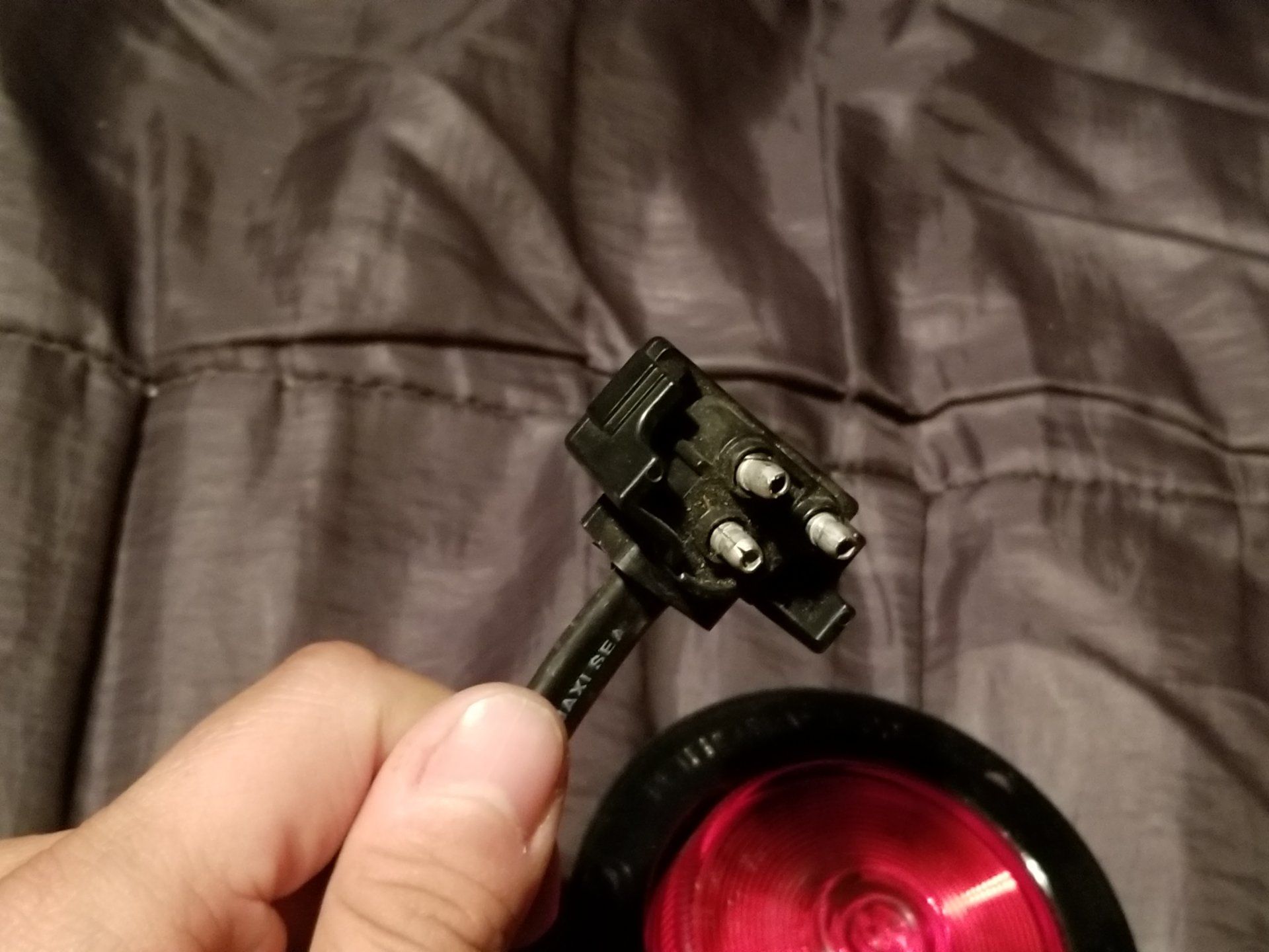

You can find those LED tail lights pretty cheap at most big truck stores/stops.

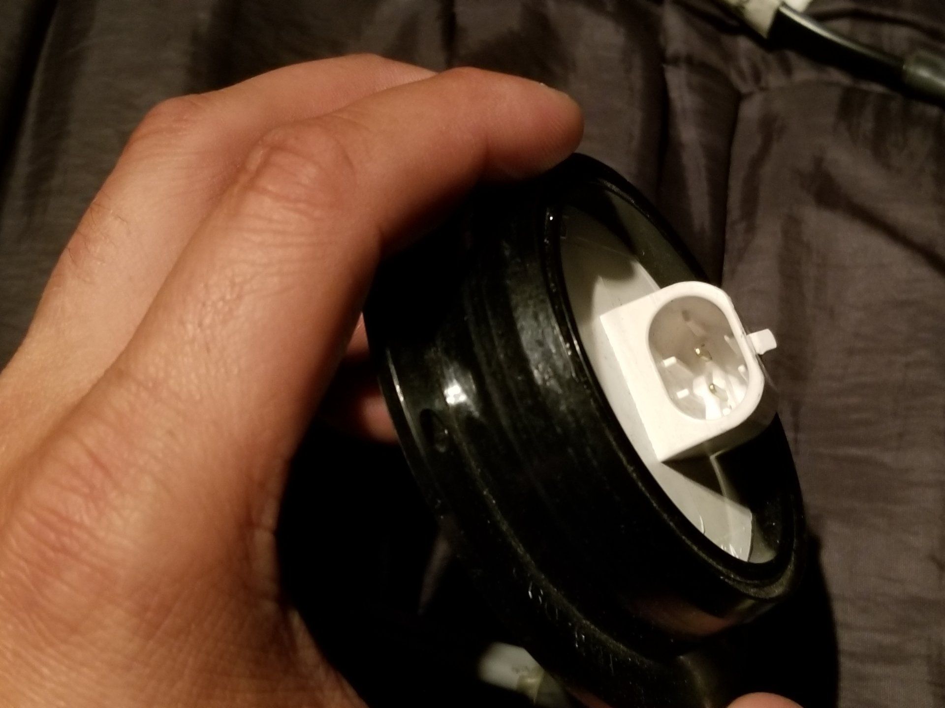

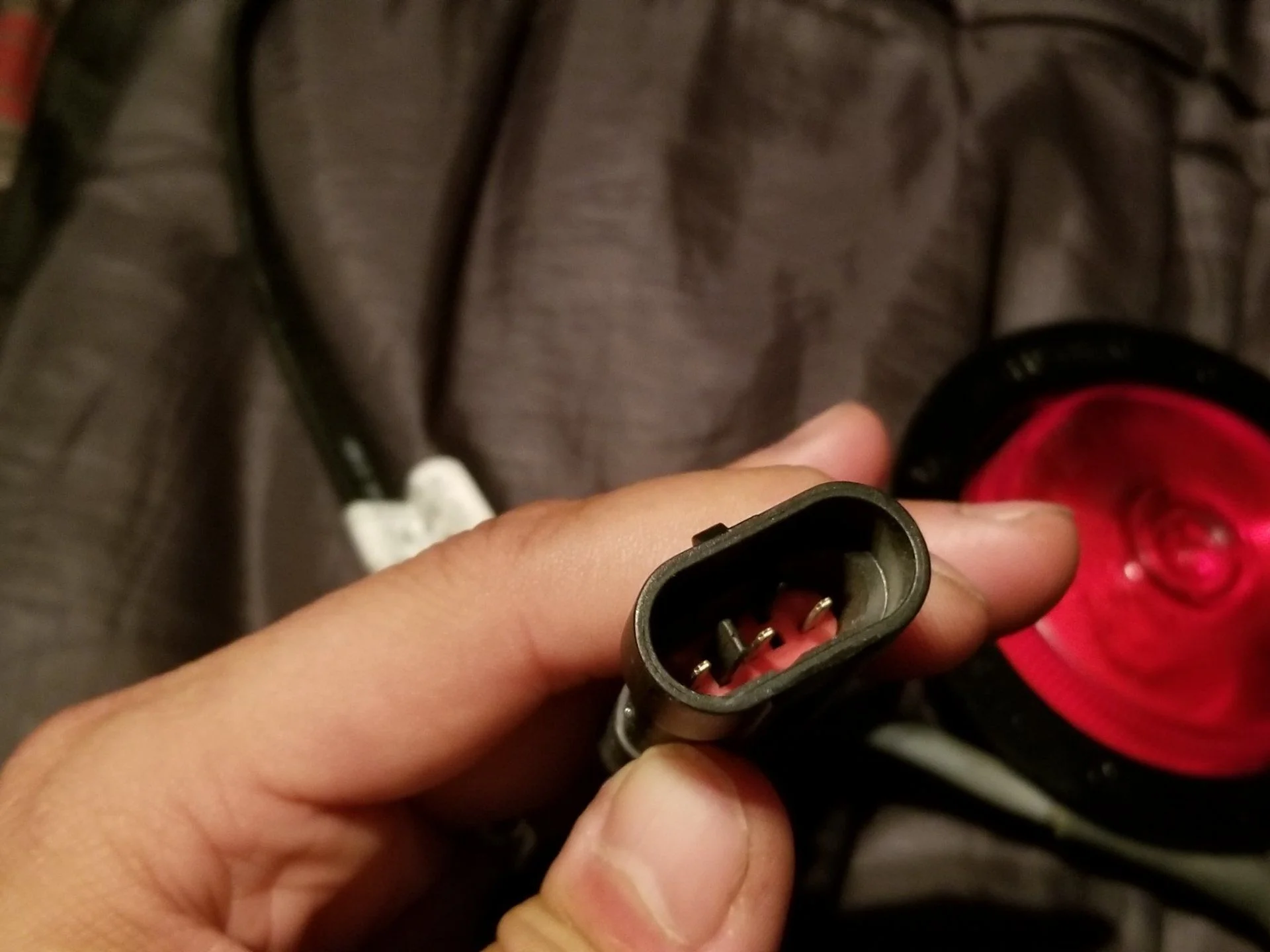

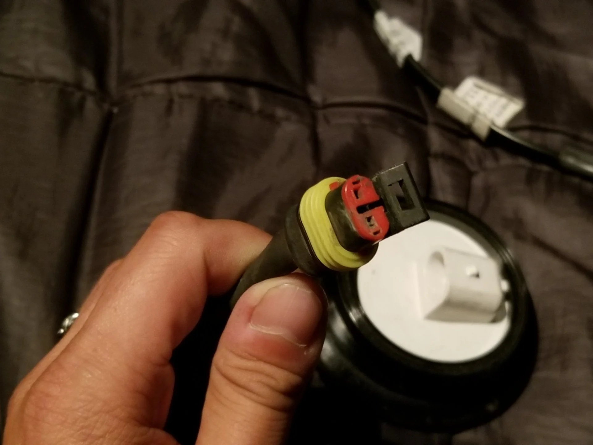

Cheap, but if if you get good ones they can be $$. My Reitnouer trailer runs nicer ones than the run of the mill truck stop ones. They use peterson plugs and are weather sealed. Look waaaaay better than the cheapy ones when Lit up. BUT the size is pretty standard so they are easy to replace and even if you have to change the plugs.
Here is a 2 wire peterson style plug and light.
Here is a three wire female peterson pkug to standard truck stop 3 wire setup.
Note the three prongs have no weather sealing. The extra money on nicer lights makes for maintenance free lights!
And you can add bling rings!
View attachment 1573821 View attachment 1573819

Yea, but the money I saved buying truck stop lights more than payed for a tube of dialectic grease, and a can of liquid tape! :flipoff2:
