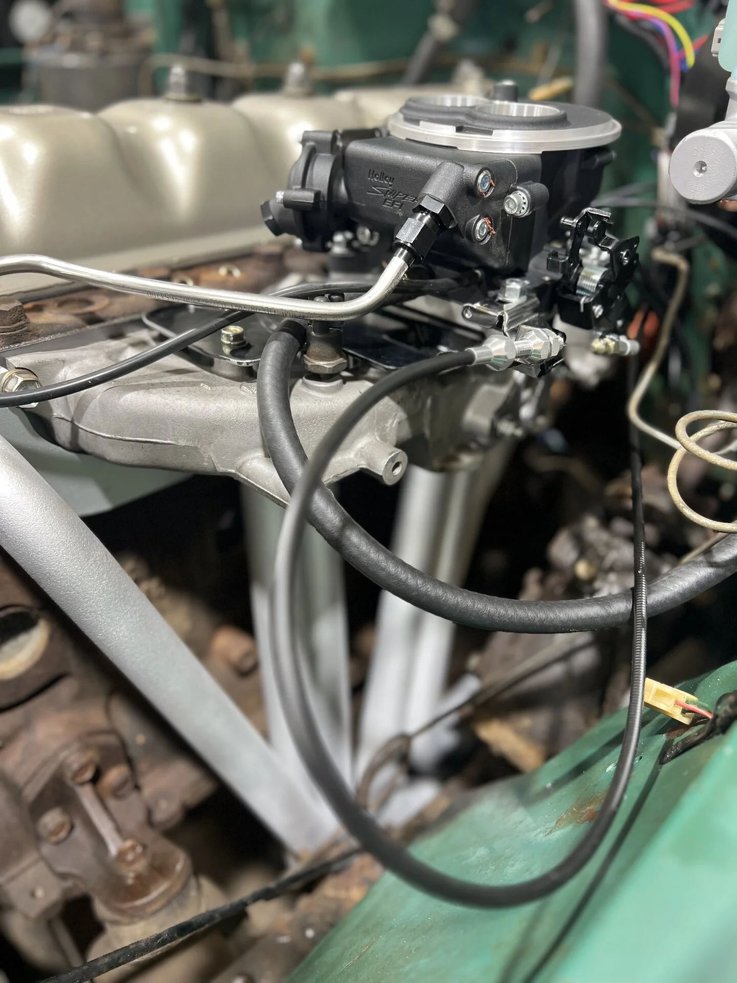

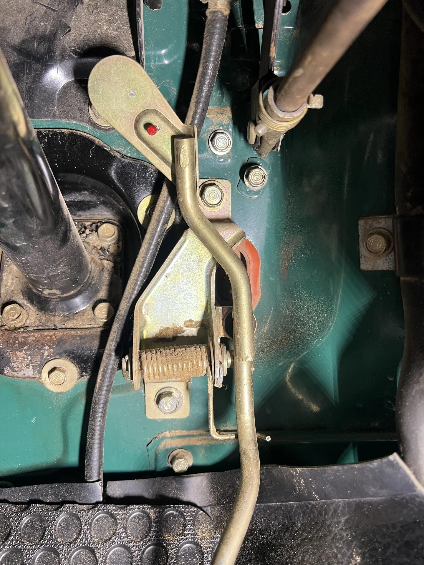

I used this recently when installing my sniper and it is very helpful overall. Mainly in the gas pedal modifications. Only use the indian head if you are chasing air leaks.
Made a couple edits today. Agree on the Indian Head. Rescue only.

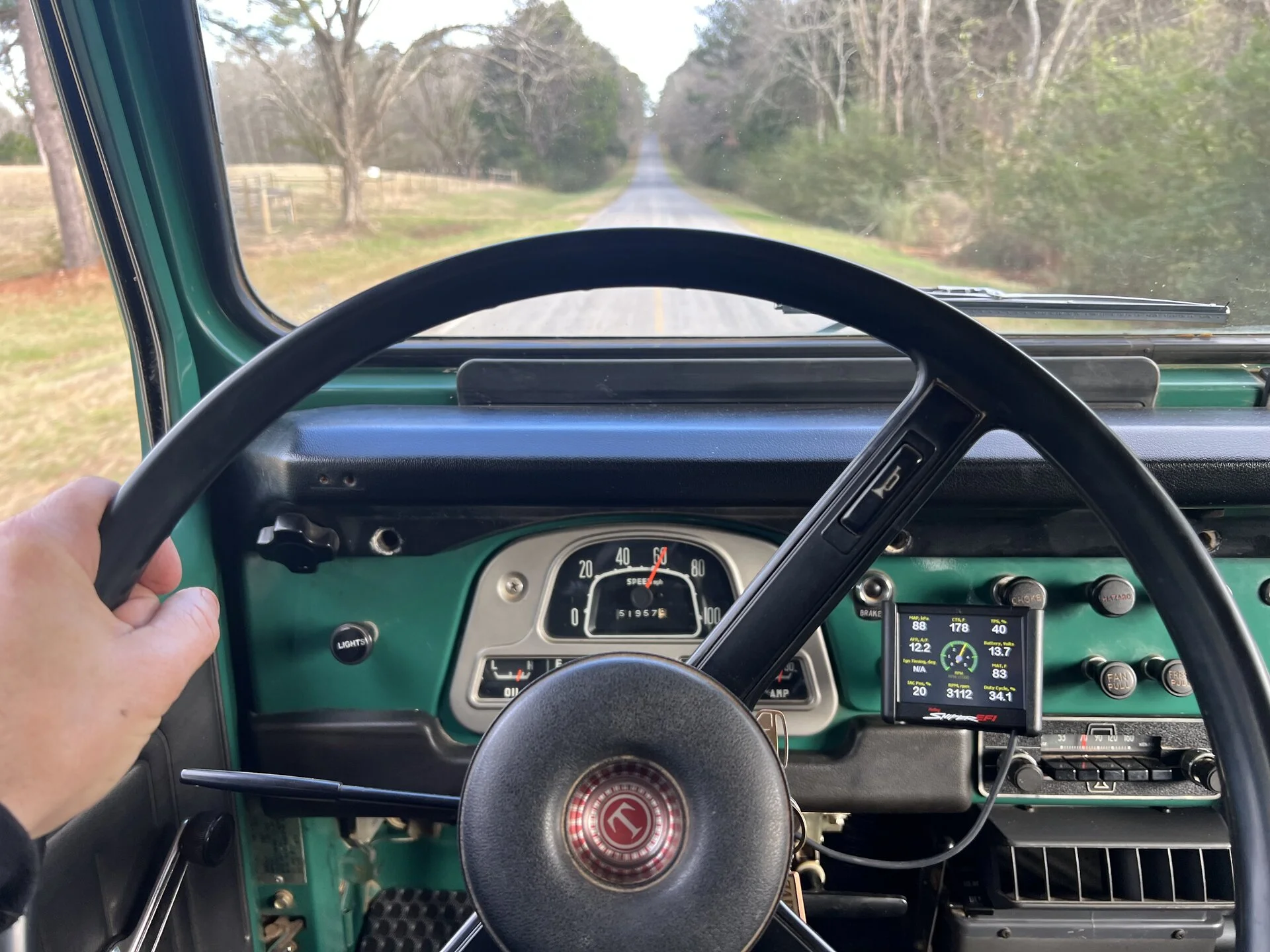

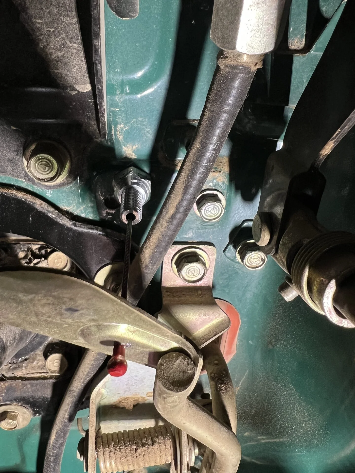

Good morning. Wired it all up in the engine bay and got the Lokar cable hooked up. This style pedal makes it super easy.
Got the fuel pumps and lines all wired up and plumbed into the truck.

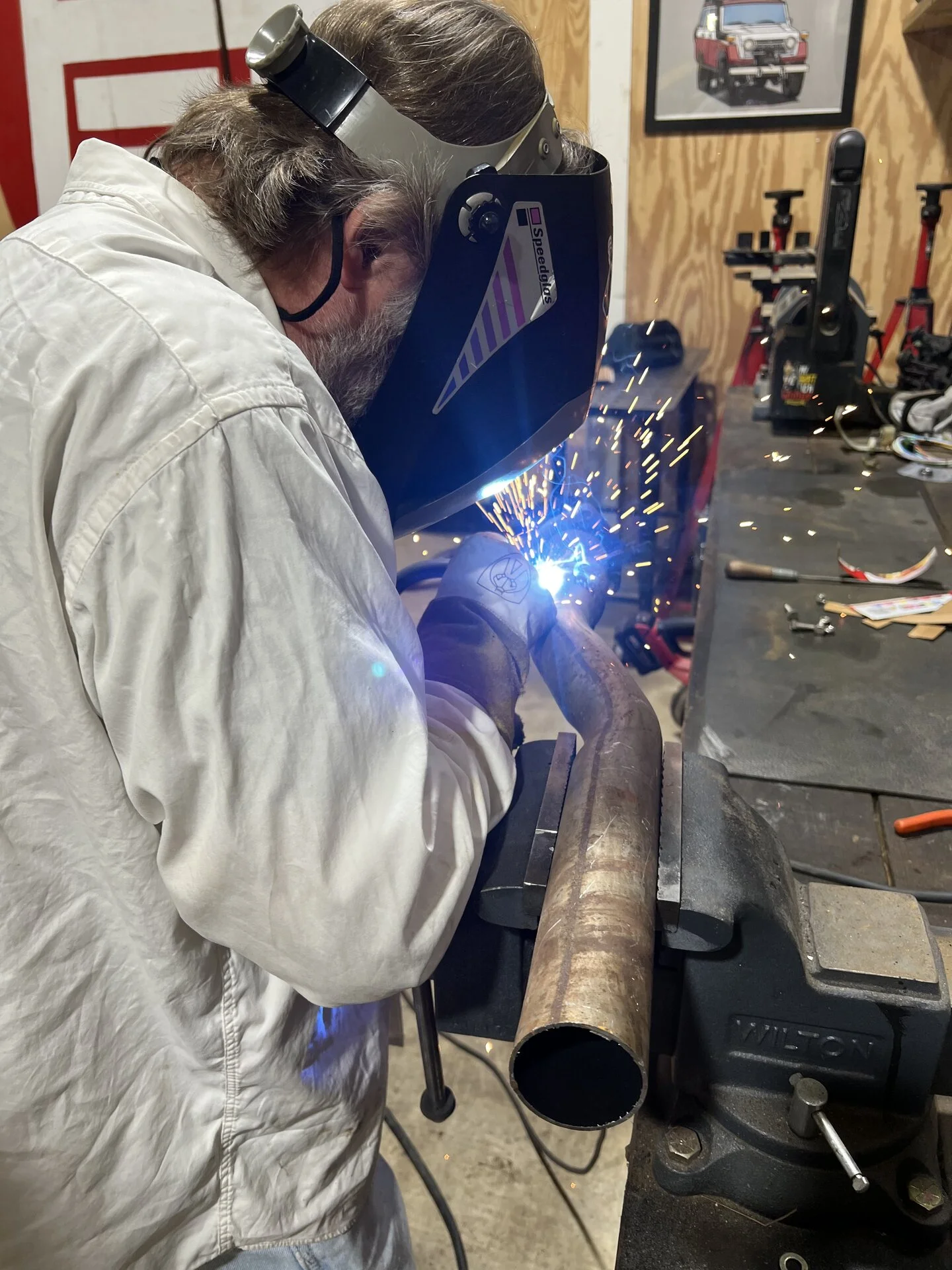

The Wizard came over to put the exhaust above the skid plate while I had it all cut up.

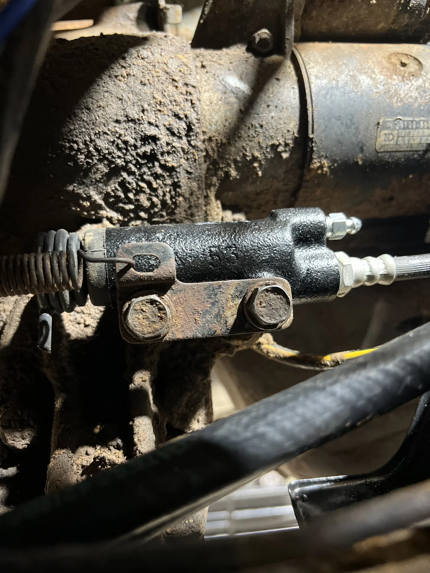

Realized I had forgotten to replace the slave so I did that.

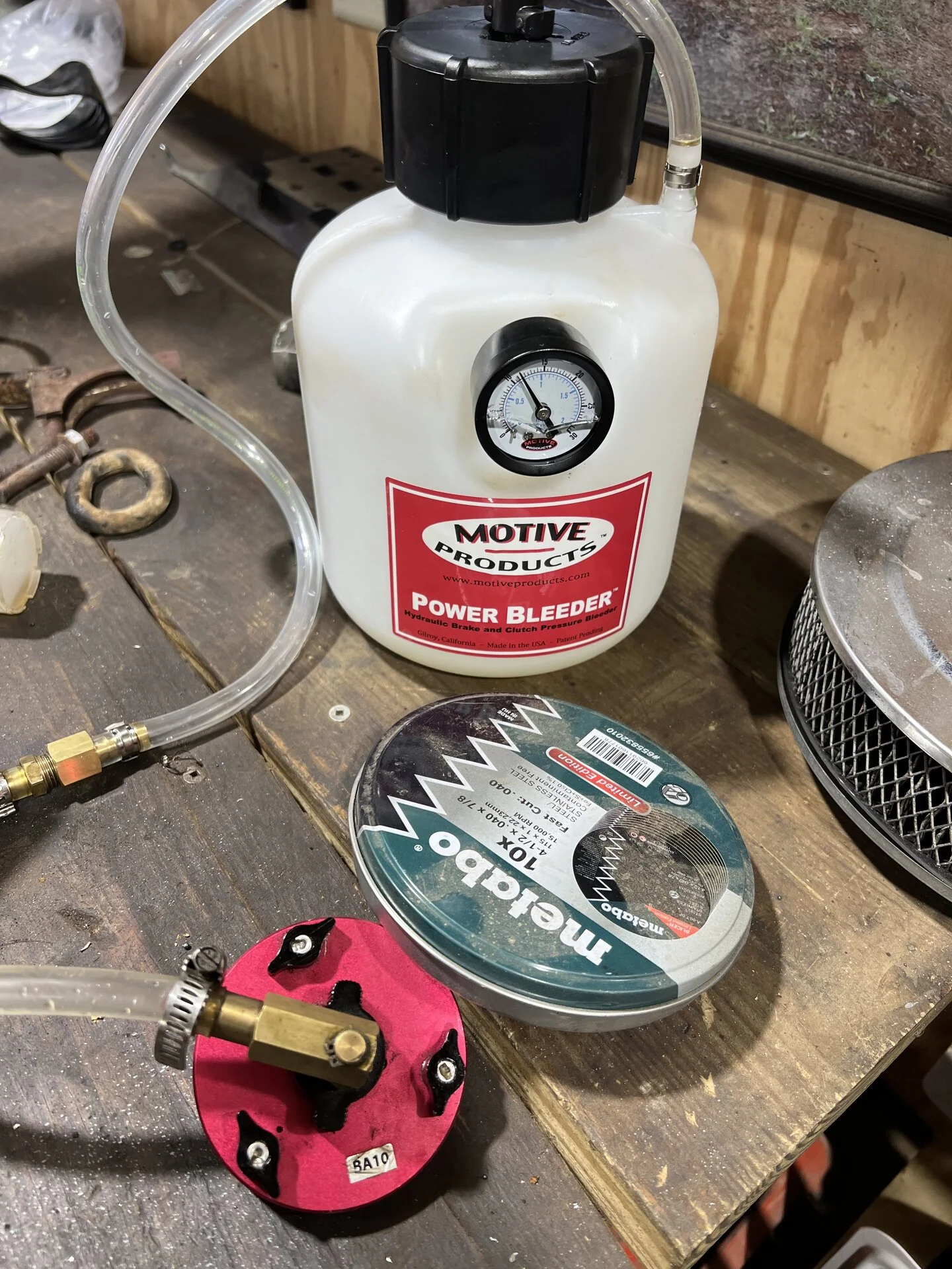

Next I bled the clutch and slave. It’s so nice to have a single cap system and a Motive bleeder.

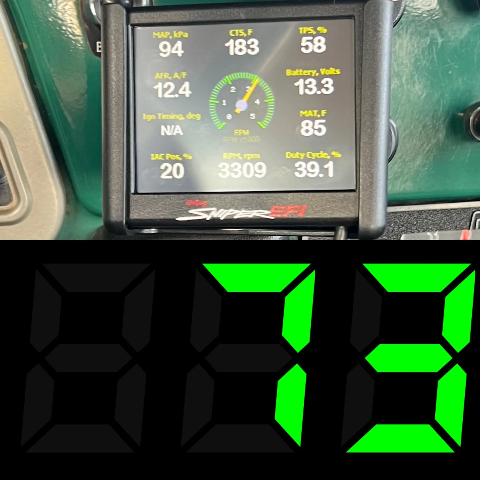

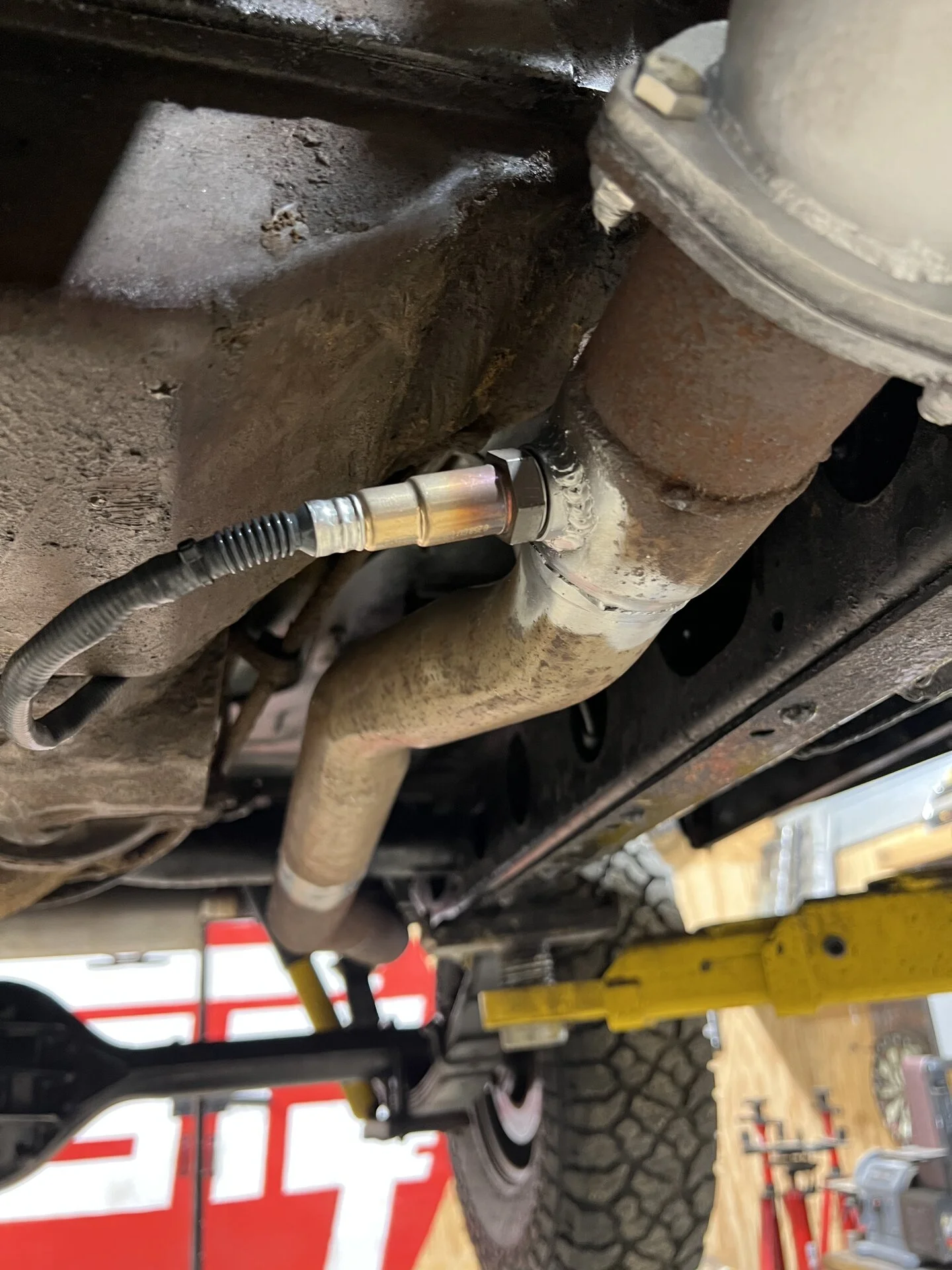

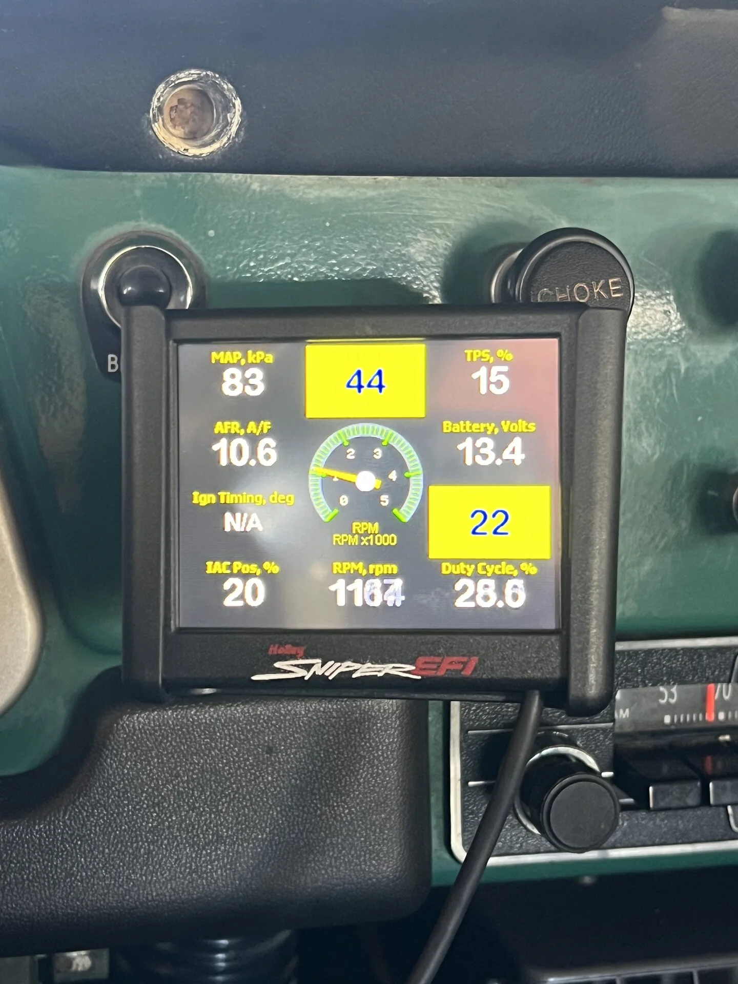

Then I timed it and adjusted the AFR and took him for a spin. Safe to say top speed is no longer 60 mph and the brakes will put you through the windshield.
