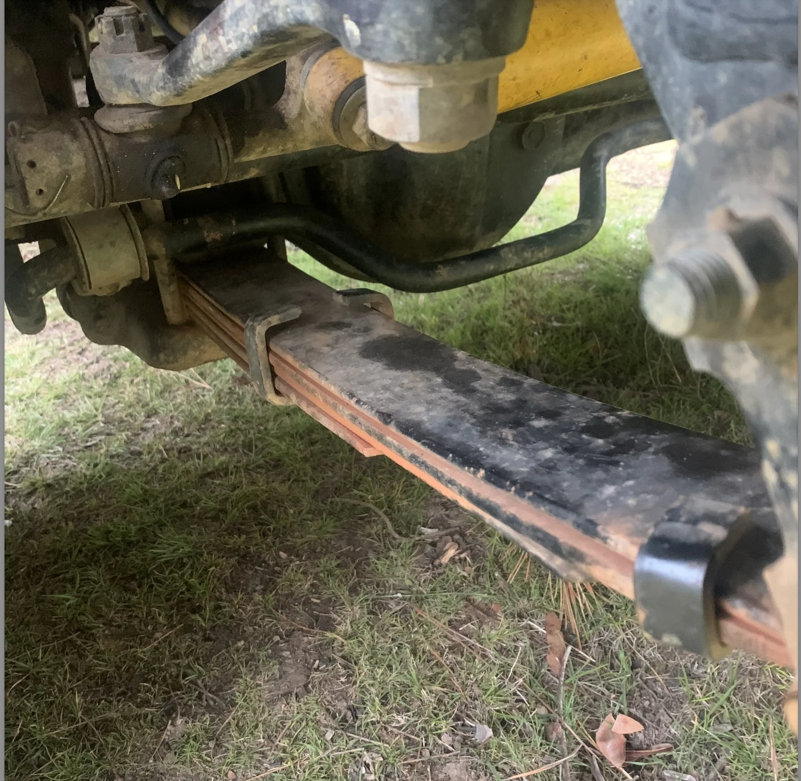

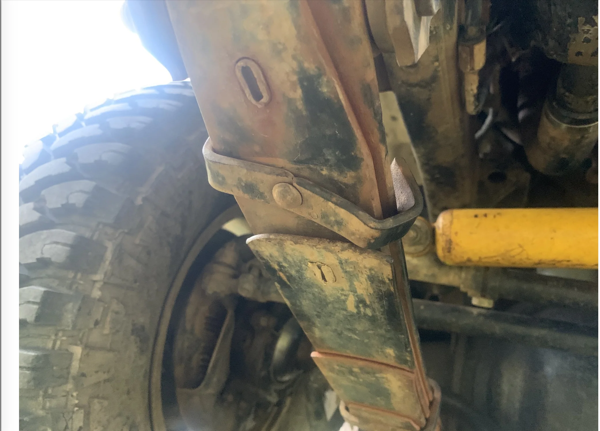

Hey Team,
I noticed today that the clamp on the front drivers side leaf spring is broken, so the top bar is misaligned. Just looking for opinions on urgent this is to repair? I suppose I should replace both front springs, but might try something a bit more ghetto like just tacking it up with a bit of weld....

Have the front leaf springs replaced.
A tack welding will not help much, and may end up causing the leaves to break.

looks like it took a whack on a rock or something,,,, i'm not seeing a replacement issue of yet,,, i'd whack it with a hammer to see if it pops back inline then give the clamp a good straighten and squeeze before buying new springs..
I agree, it does not look too bad overall, but the fuller story of how long have you had it?, does it clunk when slowly turning when it rains?. When were the knuckles rebuilt last? You won't know the extent of the condition until you look at the springs and perches disassembled. A bit goes on with all the components of the front.

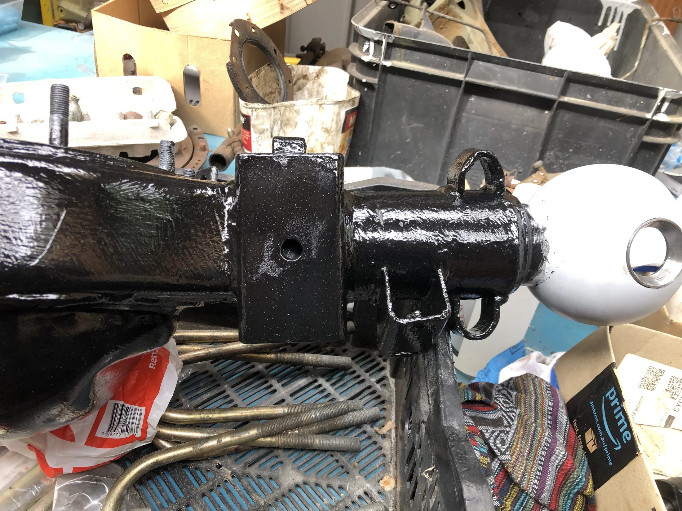

If the front leaves of a 30+ lc is left unchecked due to it's design the holes of the saddle perches slop out as in the nasty picture, from a paddock basher. I have restored the holes and balls on another axle housing, not as well as some on here, it is difficult to find a used one in good condition.
30+ years, one has to go over the whole vehicle really, in time. Not saying yours shall look like this, but they end up this way if neglected. Your plastic grommet does not look 30+. And from your pics, yours looks pretty neat. How are your spring bushes?
