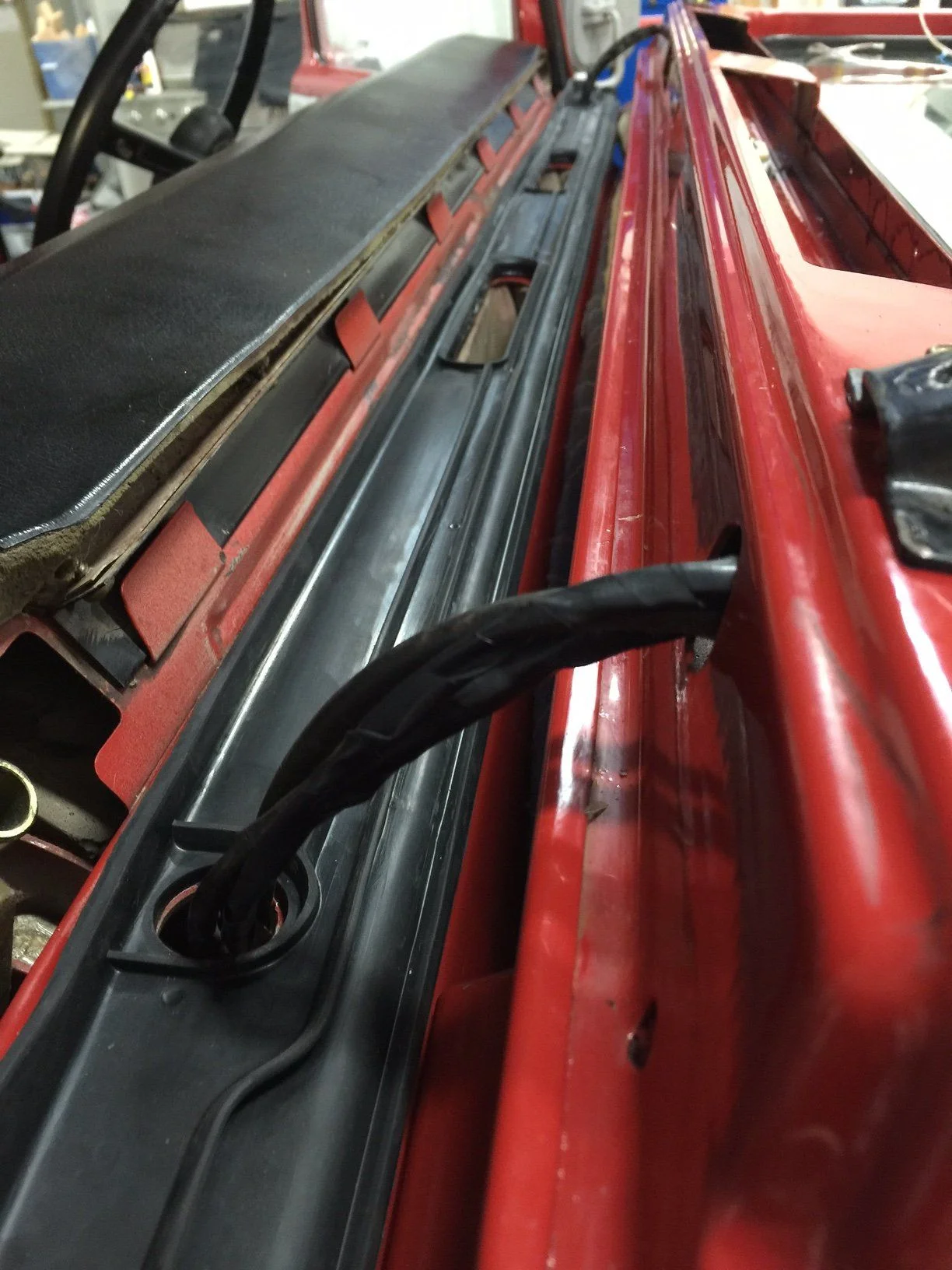

Lower windshield weatherstrip installed, this was by far the easiest upgrade yet, although removing the wiper wires was a pain to get to and disconnect wires.
I had to remove the ashtray and the duct feeding the defroster vent on the passenger side, there were 4 wire disconnects in total. On the driver's side there was only one wire which feeds the courtesy lamp located directly above the driver's seat. Other than that it was a sweet piece of cake. However, the worst part continues to be the silicone the PO used to seal the windshield, surprisingly no rust.

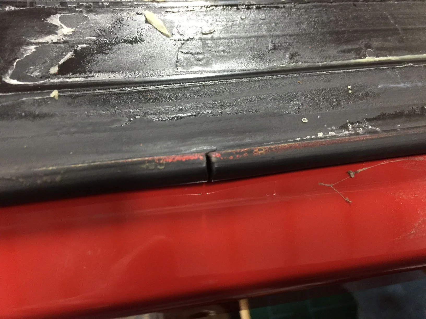

I removed the fiberglass top to access the weather seal for quick removal since it has a multiplicity of cracks all along the perimeter.
Here are the seal cracks which facilitated periodic water infiltration. These cracks appeared every six to eight inches apart.
