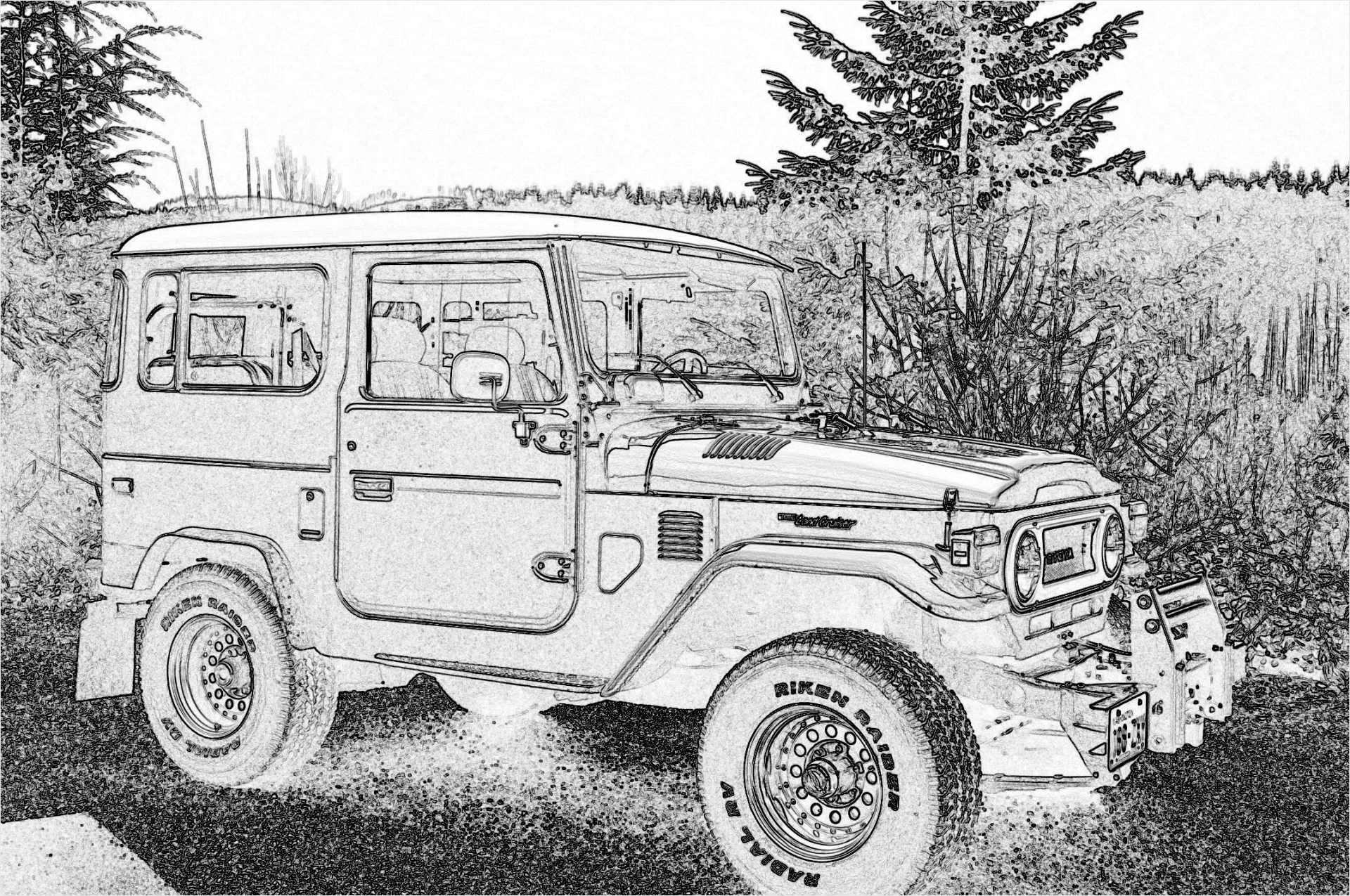

My wife made this sketch of the 40 for me.

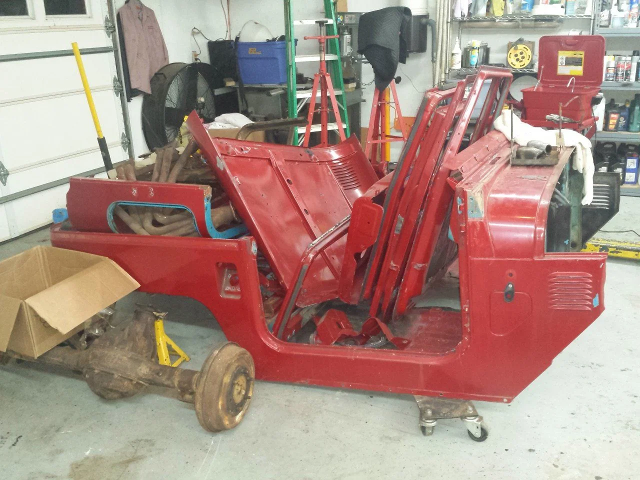

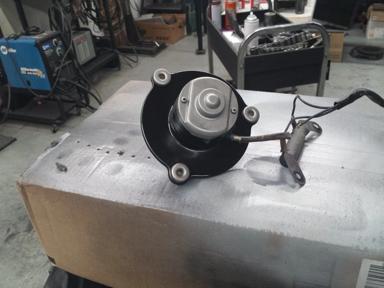

Took some pics for you. First two pictures are of some of the parts I have been refinishing. Everything is getting disassembled, cleaned and painted inside and out. I have been trying to use stock finishes whenever possible. I know it doesn't look like much, but those parts were mostly red when I started. I spent an hour tonight getting the windshield washer motor running. It was rusted solid, but the Kroil oil saved it.
The last picture is of all the body parts waiting for the sand blaster. It hasn't rained much at all the last two months......until I got the body ready to clean. My sandblaster guy has a mobile unit and only works on the weekends. It has rained the last three weekends. He does soda, walnut shell, and sand. The frame is at the powder coater and should be ready next week.
I dropped the engine off to be built yesterday. It is going to be built all stock.No smog, and a trolhole carb and dizzy. I am curious to see what he says about the condition of the motor. Fingers crossed., as I never heard it run.
I would like to have the chassis built with the suspension and driveline by Thanksgiving.

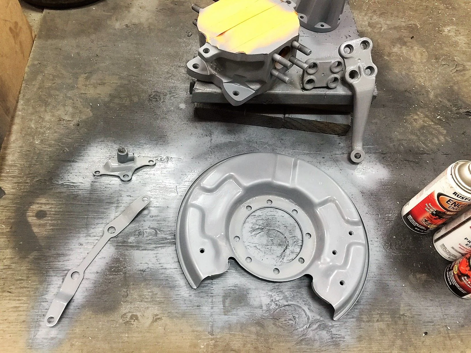

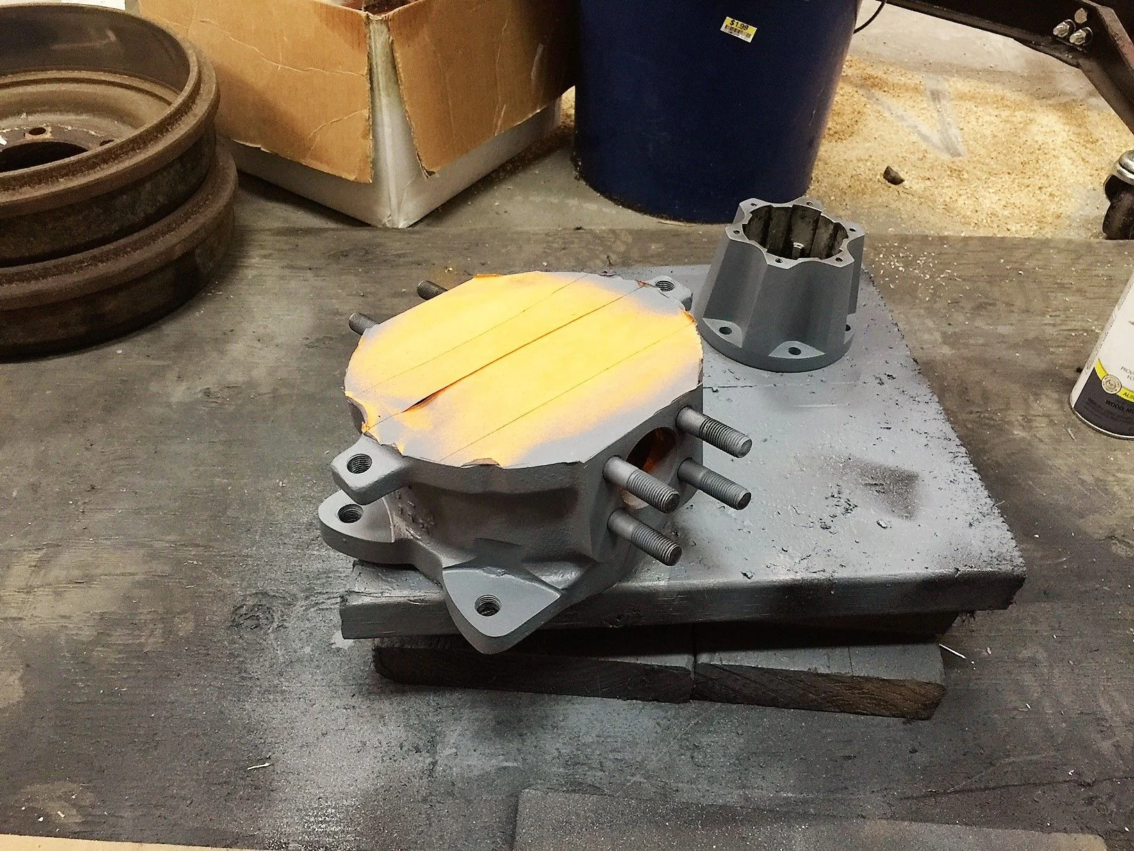

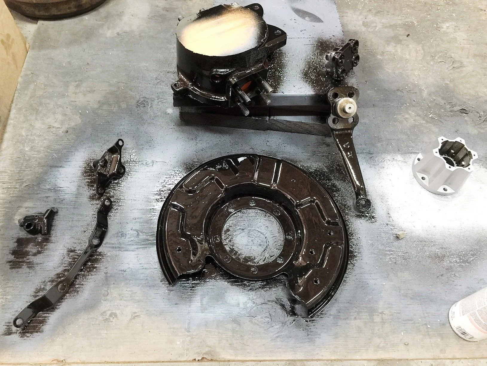

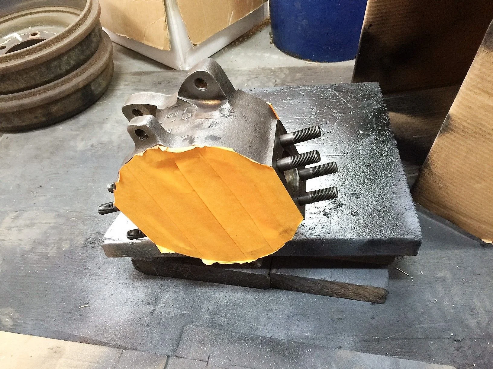

Some progress pics
Painted passenger side knuckle and brake parts
full
full
full
full

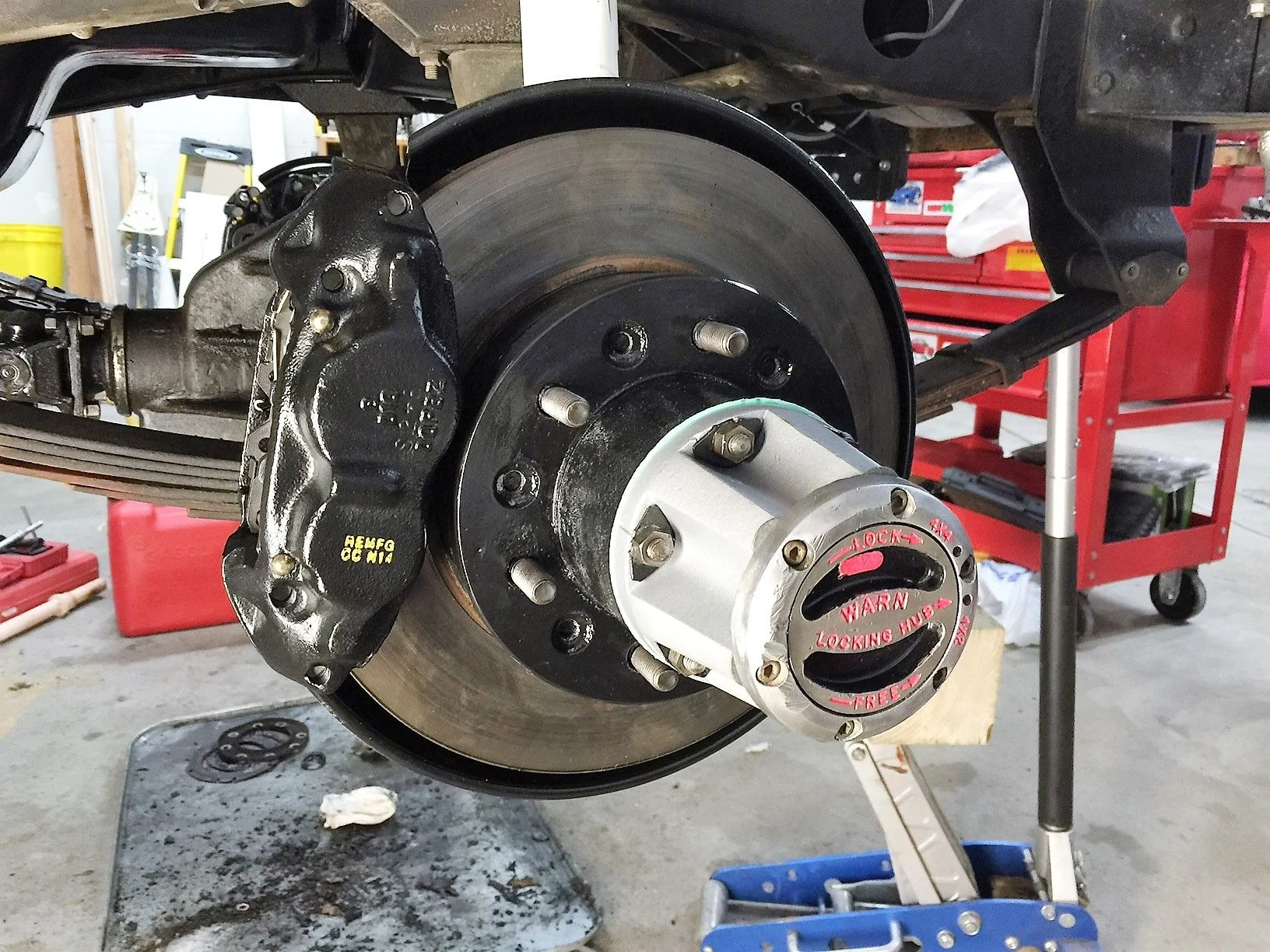

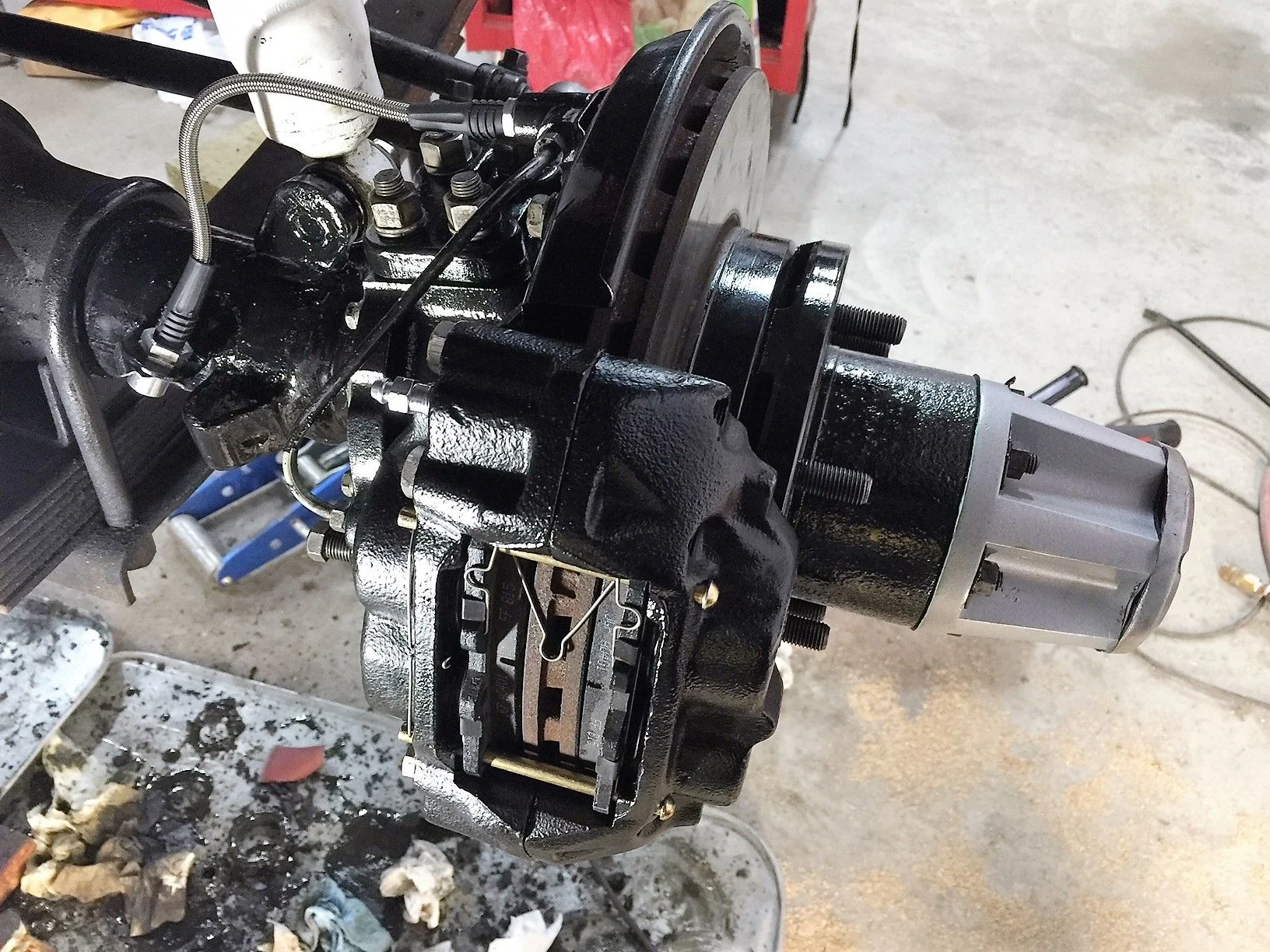

Reassembly
full
full
full
Passenger side is now complete
full
