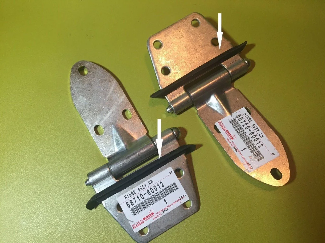

Just a quick question about rubbers. I love all the new rubbers, but what about the rubber seals on the door hinges. Where does one get those??
Thanks Bud!
If this is the rubber you are referring to
full
I got those from @Racer65 here

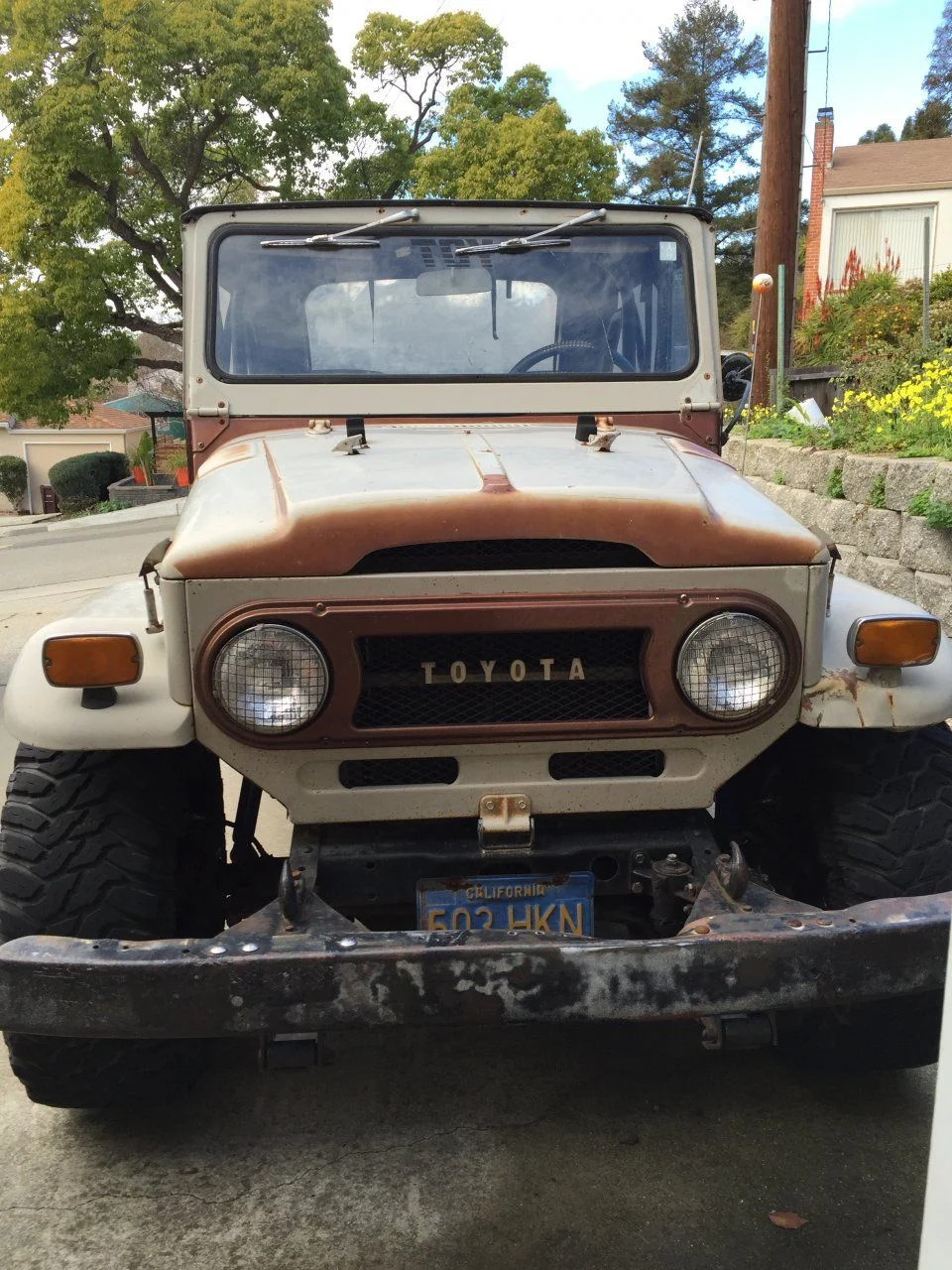

She "Elsey" is all original '73 unmolested except wheels, Carburetor. It's a Calif. car with a min. surface rust. All number matching. Plan on restoring her to her glory day with OEM minor / safety upgrade
