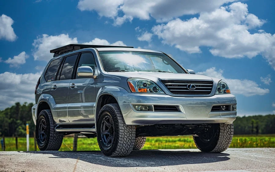

Hi so I just picked up a 2007 GX470 today and I'm gathering up a cart of first mods and GMRS is essential for me since that's what everyone uses I go out riding with. Now first off I'd like to run the power for it through a add a fuse into the interior fuse box. Question is, which fuse would be the best for that? Still learning as I go electric stuff so bear with me please lmao any info is greatly appreciated. Also what would be the best way of running the coaxial cable through the firewall? I've been seeing posts about a grommet but no pictures on where it might be. I'll look in the morning but again any info or help is greatly appreciated!

Thanks for the info! I'll give it a shot and report back when everything arrives. Nice GX btw!
