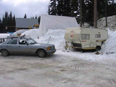

I own an 84 300SD with 280k on the od. I bought it as a winter commuter to take me 170km round trip 5/days a week when I worked at a hill last winter. The car is a tank and absolutley awesome on the highway. That round trip would cost me roughly 30 bucks and I have a heavy foot (and up serious mountain pass roads) Picked it up for $2200 with some dents, but really nice shape otherwise.
Whichever car you look at, have an inspection done of the tranny - even though a rebuilt is about $1500 Cdn, I would pay close attention there. Other than that, the motors are commonly seeing 4-500 thousand without major work.
Nicest Hwy car I've owned and great in town too. I used to own a 64' 190D Fintail - sweet little car too, but not even in the same galaxy for ride and handling.
Good luck.
