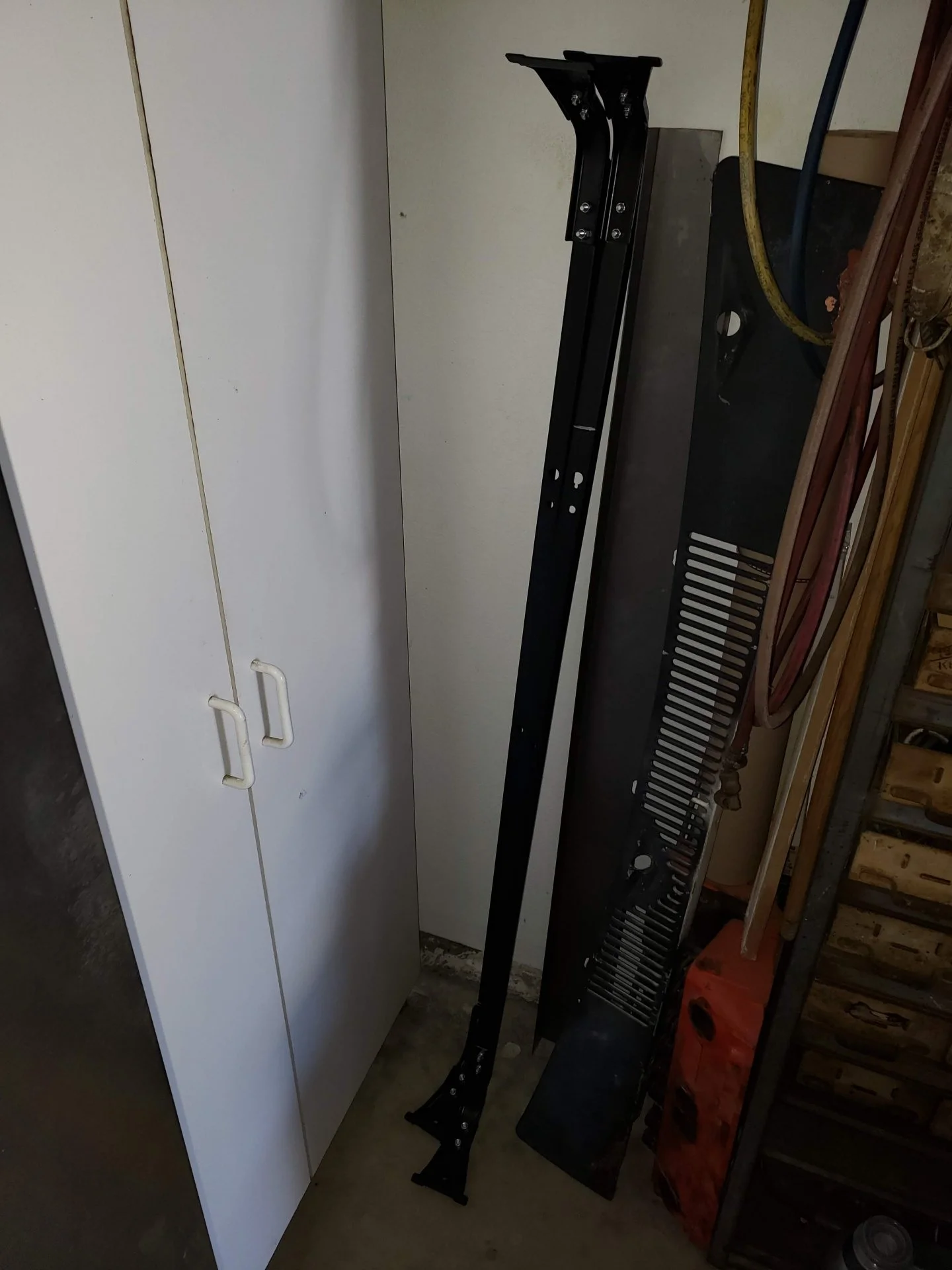

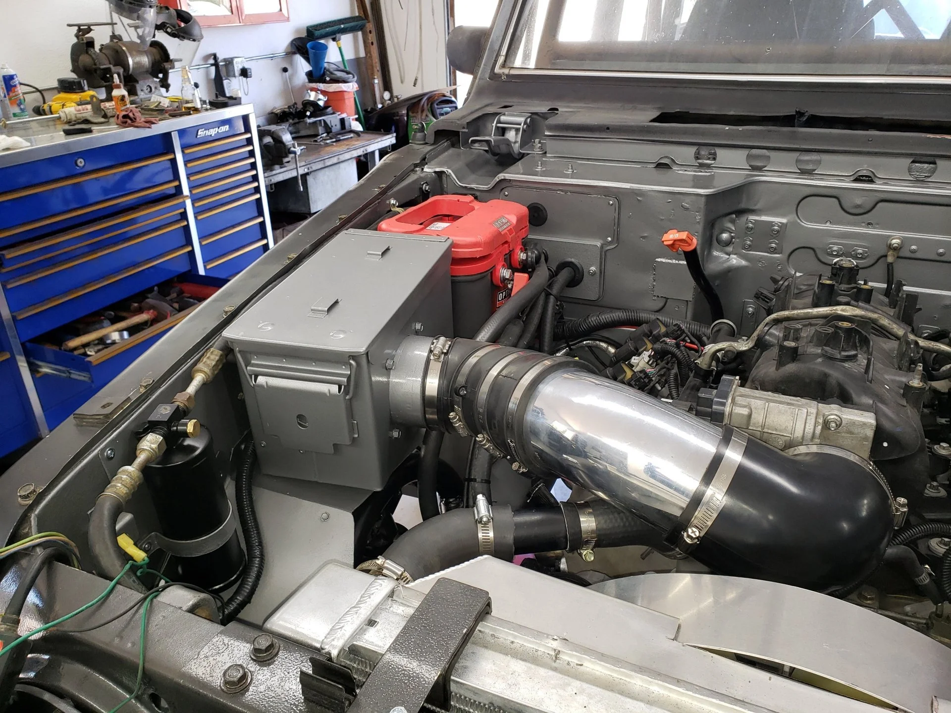

Busy week. Work, second work, home, Pig. Let's see... We put in the rear drive shaft and Steve took it around the block early in the week. Back springs were all bound up and he said it was undrivable. First thing on Sat we pulled the leafs out and took 1 leaf out of each and it is way better now. New AC lines were made and plumbed. Compressor clutch does not work. So I ordered a new one :confused:. Intake is complete, thanks again to @Calgary40 for the idea. Mounted the shock reservoirs and painted the under portion of the fenders. We plumbed the shower but I realized we had it so hot water was going thru the pump. I would rather it run thru cold so we switched it up a bit but I need some more hose. Don't we all? Fab'd up 2 of the roof racks. 2 more to go.

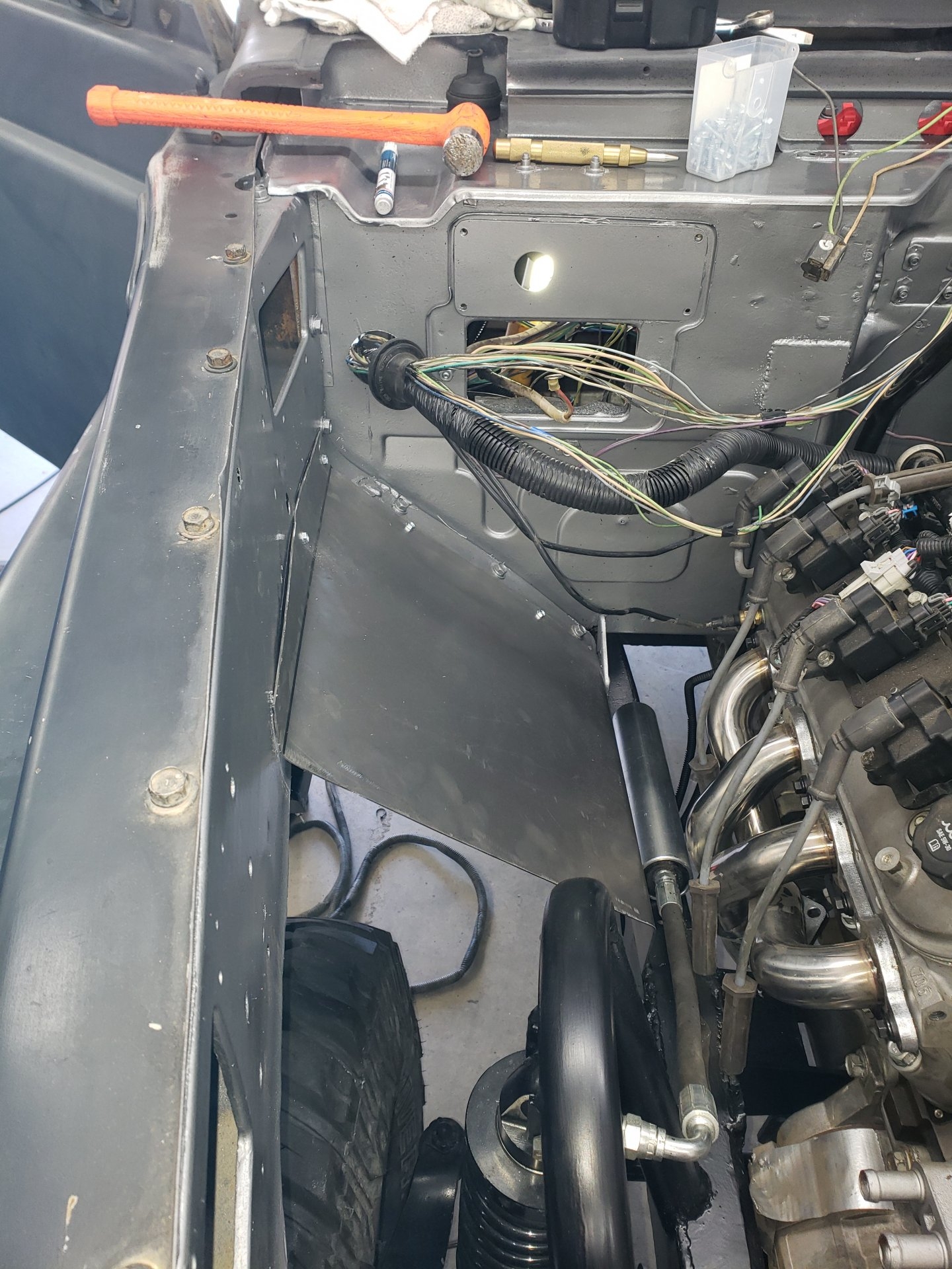

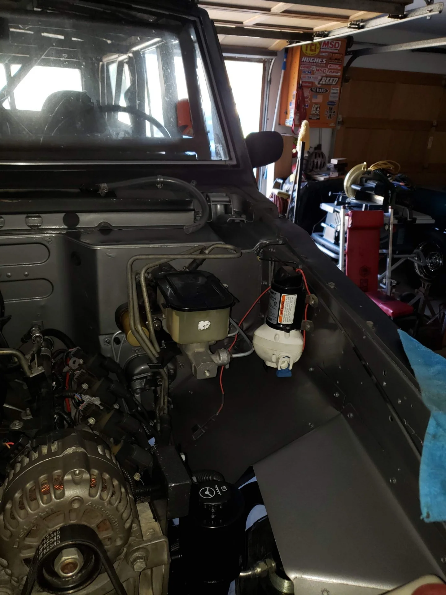

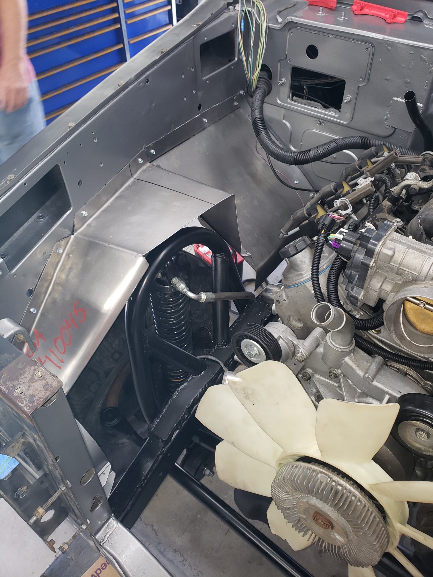

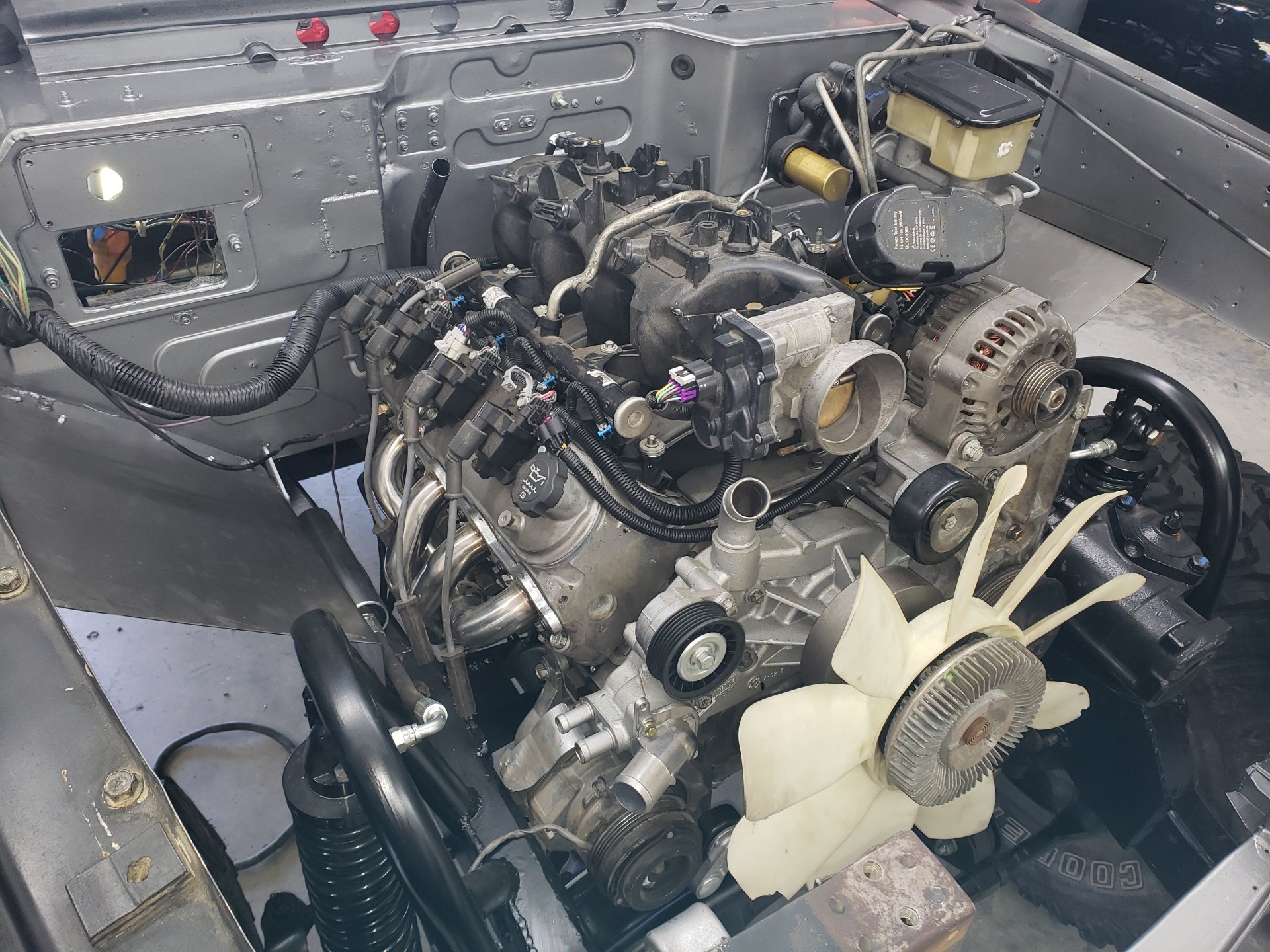

Wire loom is in. Still integrating to the rats nest under the dash. Started on the inner fender fabbing. Almost done with the passenger side and have one part of the driver. The drive by wire gas pedal is in. Hydroboost is plumbed except we need to mount the remote reservoir. View attachment 2669197View attachment 2669198View attachment 2669199View attachment 2669201View attachment 2669202

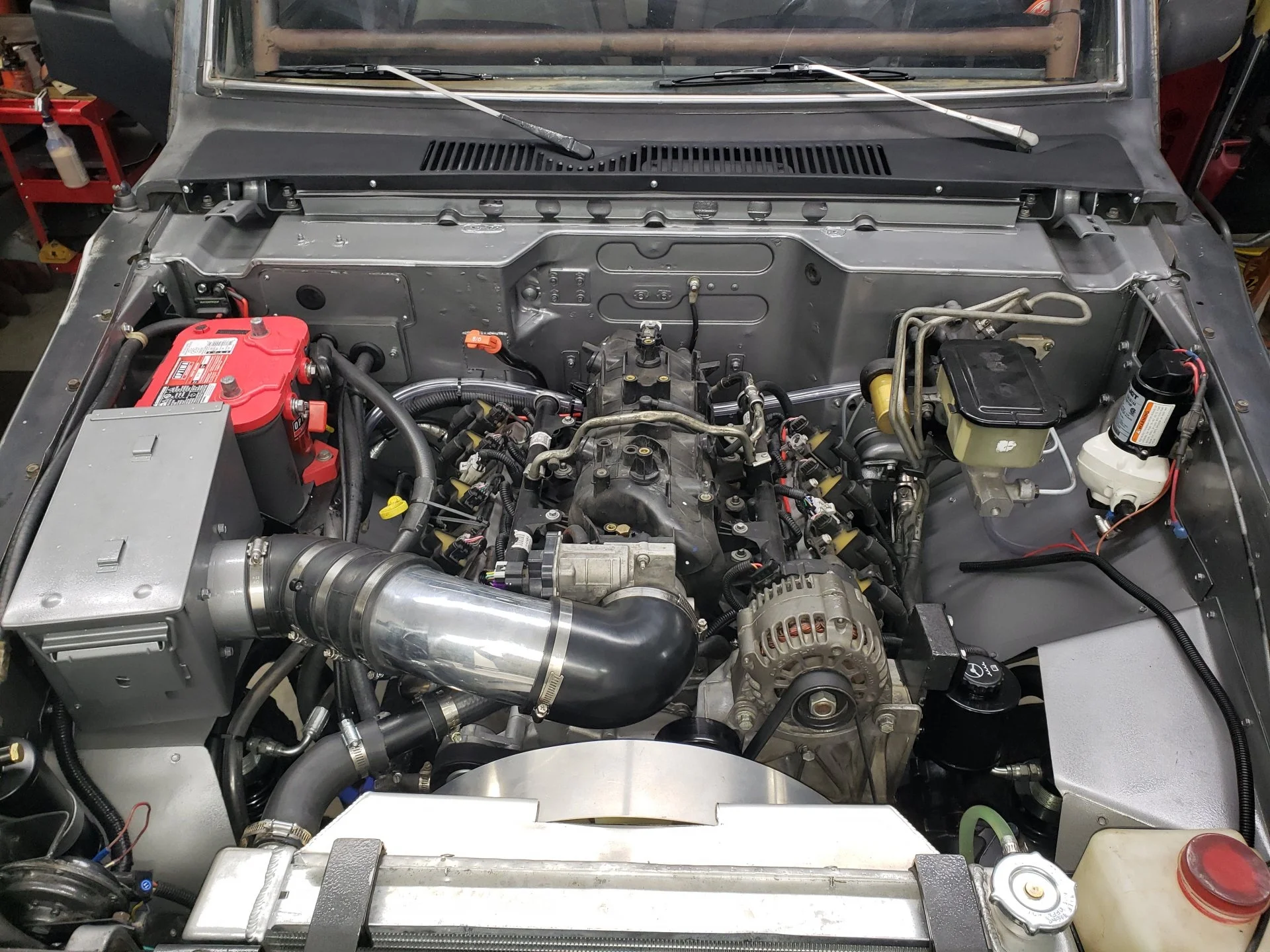

Got the ac compressor in. Wasn't easy. Had loosen up the radiator and pull it up to get the compressor in and out. Filled it up with the cold juice and we have A/C.

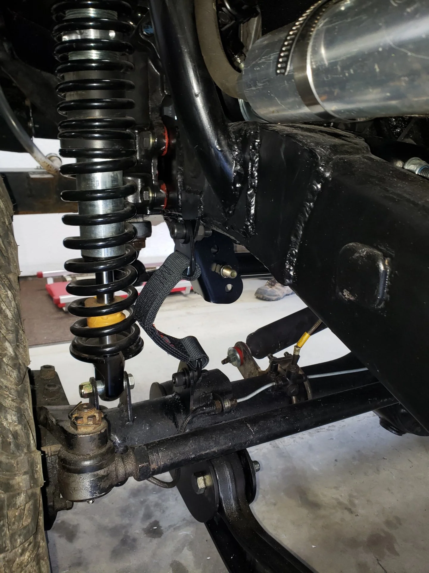

Got the limit straps in. Wasn't easy. Actually it was stupid because of things just in the way the whole time.

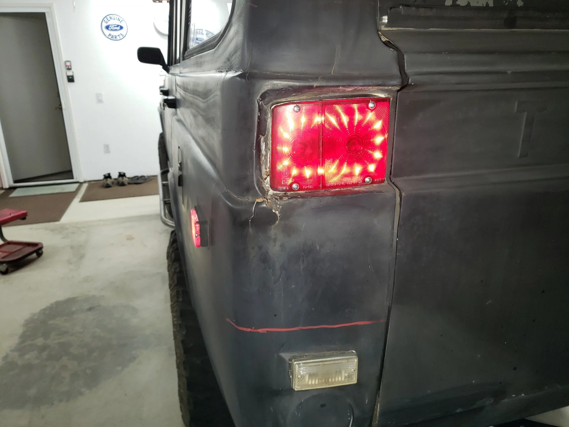

put the custom tail lights in.

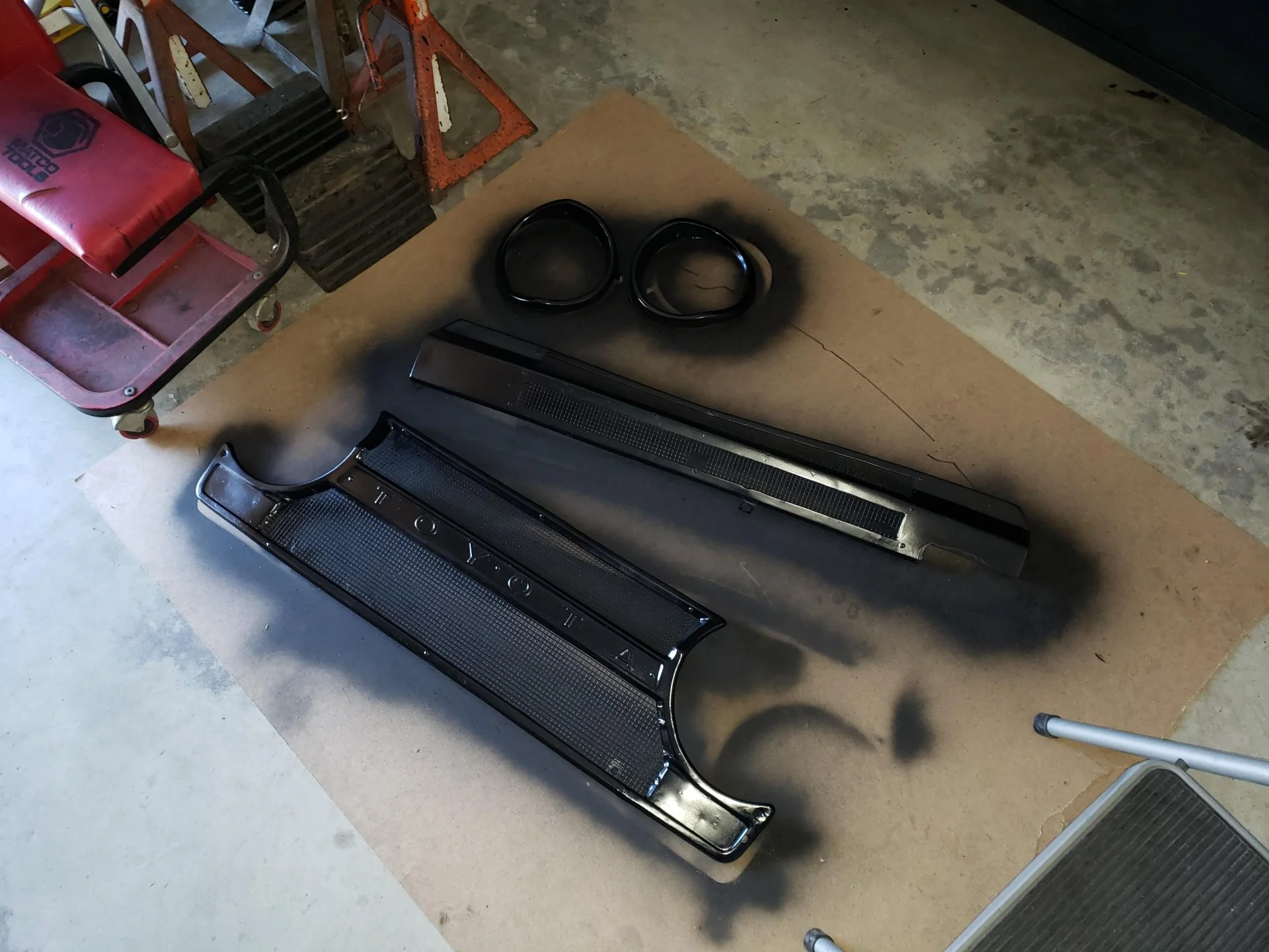

get the rest of the grill and light rings on.

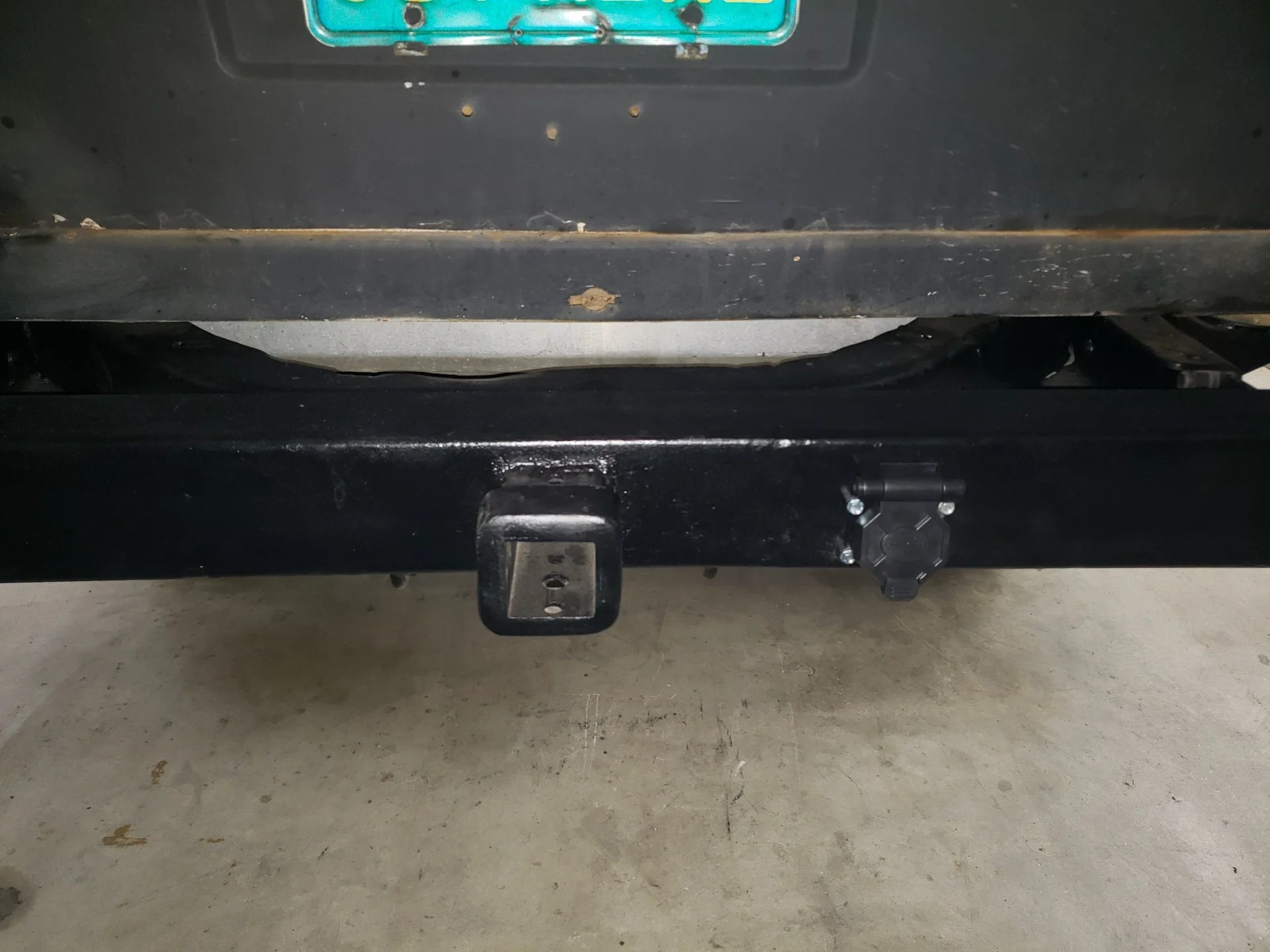

Trailer plug wiring

Drove it a bit today. About 12 miles total in town. Had some hesitation on WOT. Turned out to be a MAF code. So I went and bought another one. When I took the old one off there was a pin bent back. Straightened it out and code was gone. Took it back out and rompt on it and it runs pretty good now. Im sure I had a 💩 eating grin the whole time.

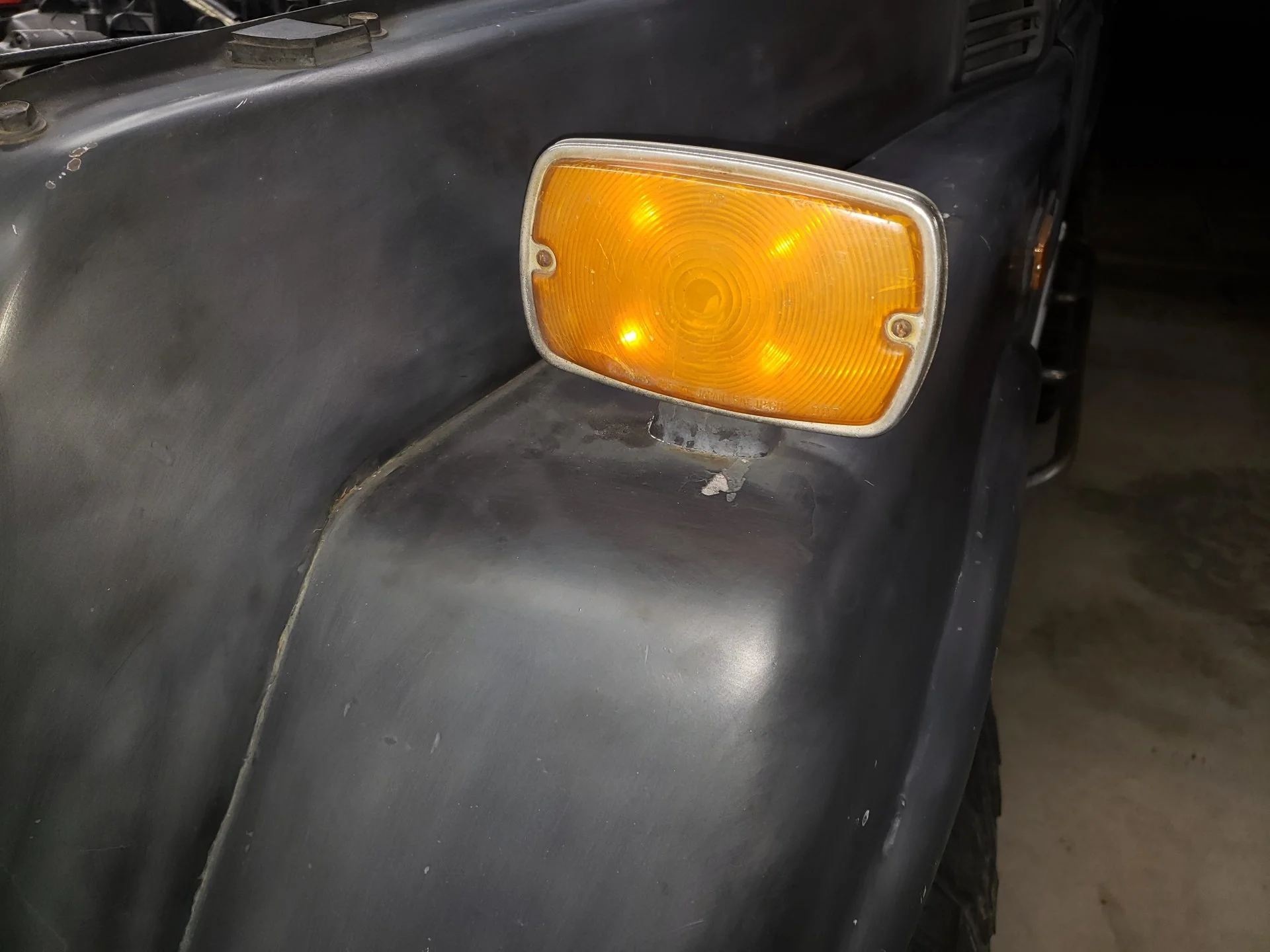

Here are the parking lights.
