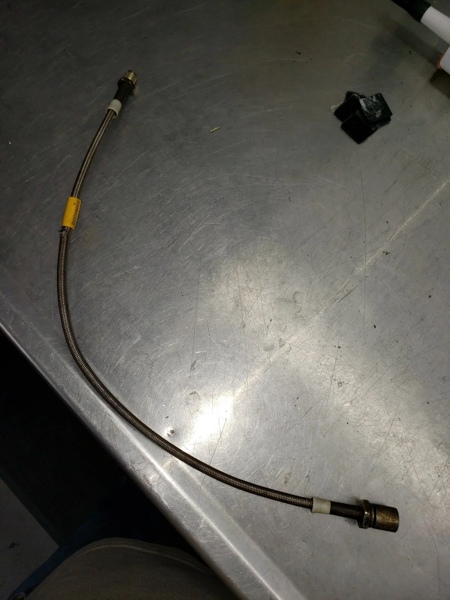

This MF broke today
It's the front brake line extension. It decided to burst just in the driveway. We were about to put some miles on it after a few other things were complete. Luckily I was driving, but is happening on a Saturday at 6pm really screwed me.
Crown is right down the road and will see if they can make one on Monday. It is probably the fastest way short of someone around San Diego with one hanging out.
The pig is basically complete. I just was hoping to put some miles on it. Haven't been on the freeway yet.
That line came with the pig. It is the one part of the brake lines that isn't new, and it had been fine with hydroboost for 2 or 3 years.
So it is not all doom and gloom. We will try to get a line made tomorrow morning. Steve will put it in and get the neighbor to help bleed. Hopefully he can put around in it until I can sneak away from work.

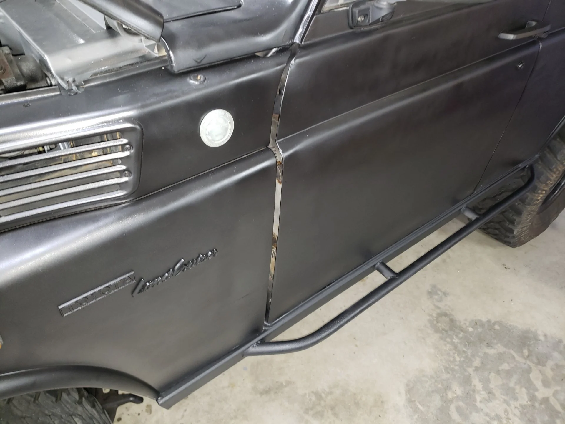

The pig is essentially done. On Saturday we put in the hand brake. Was a ball ache but it works well. Raptor lined the floor board repair and the sliders. Put a sweet $40 paint job on the pig. Put the hood on. another ball ache. I have noticed the last few weeks the tasks that seem like they should be a slam dunk are really challenging for some reason.

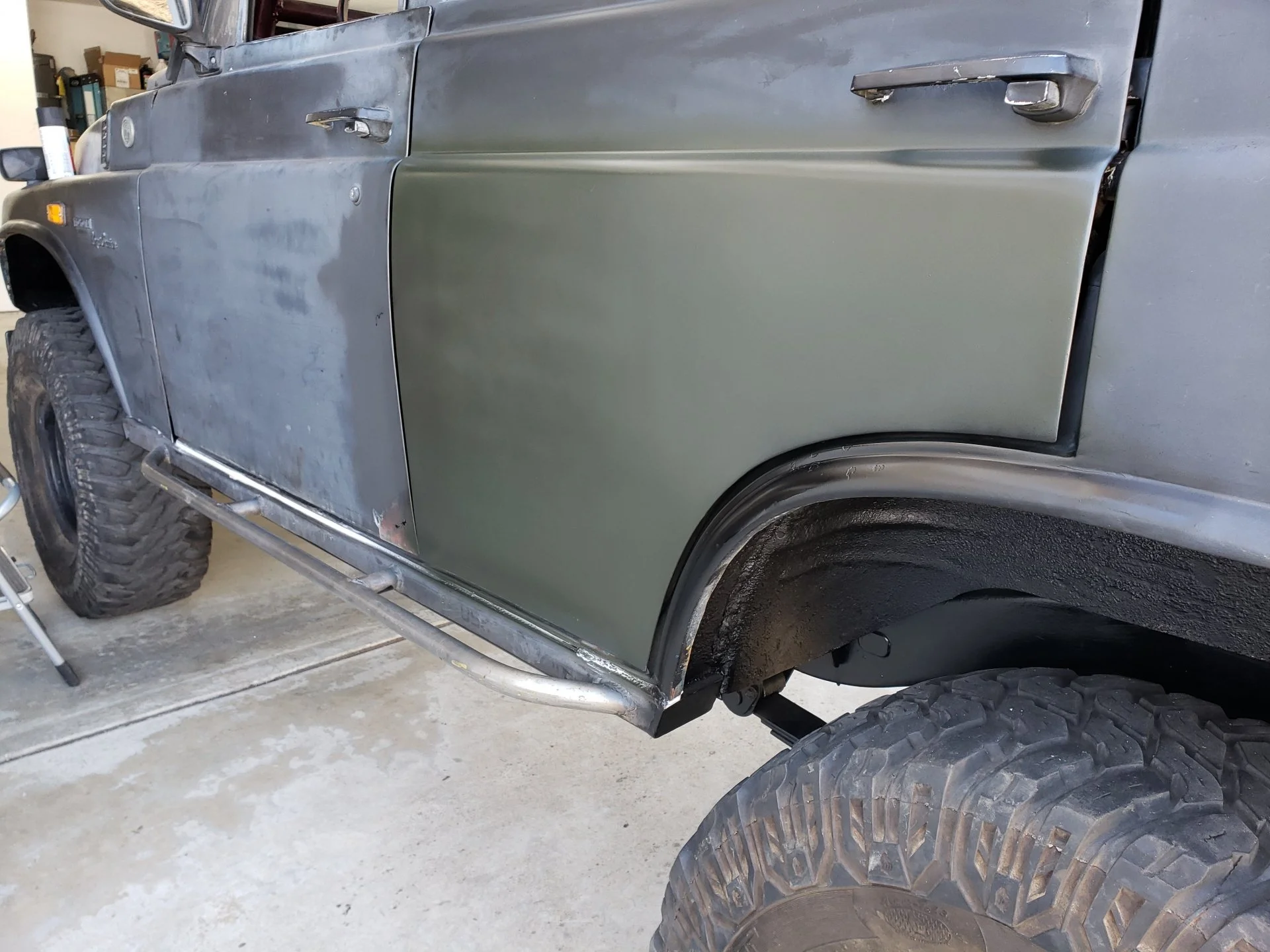

He's holding back to debut the new green paint job at the party, right?

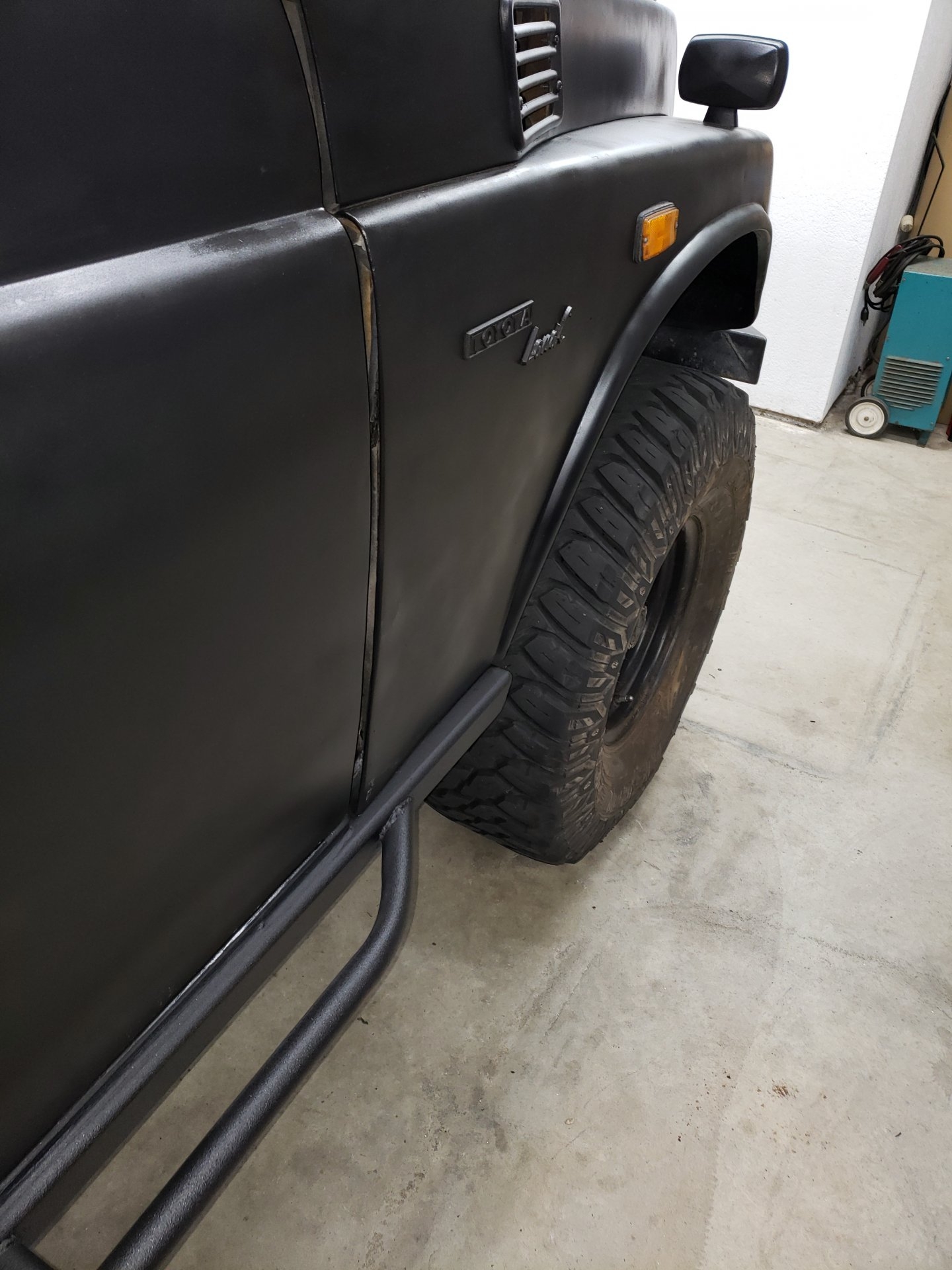

You are almost correct. I bought some paint that was supposed to be matte black for rally stripes.
It's effing green!!!🤮
It went on nice and had a great sheen to it. I thought about it for a bit and decided it was not black enough. That paint in the sun was way more green than what you see there.
I bought satin black from the same company and the sheen is inconsistent. So now it's black but looks s***tier. I will get a better paint after the party.
Sliders look good tho.

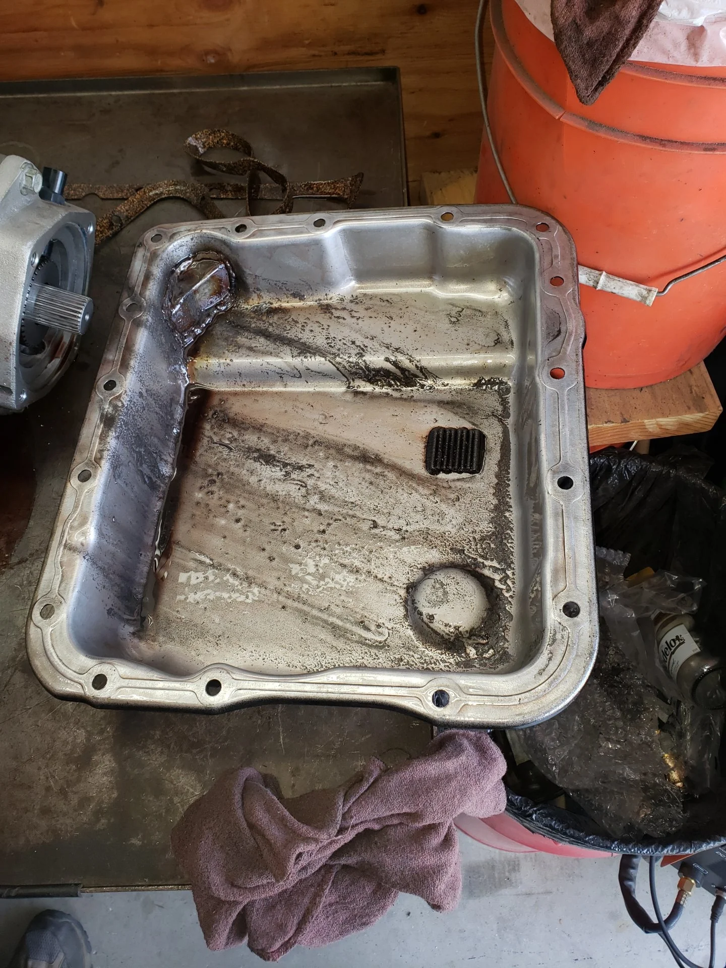

For those not following the Pig Party thread. I got to Steve's house, well within 500 feet and the transmission stopped working. I was able to limp in to the driveway and by then it had zero motion forward or back.
Went to harbor freight and got a transmission jack and dropped it down.
First inspection showed some signs of wear. Haha

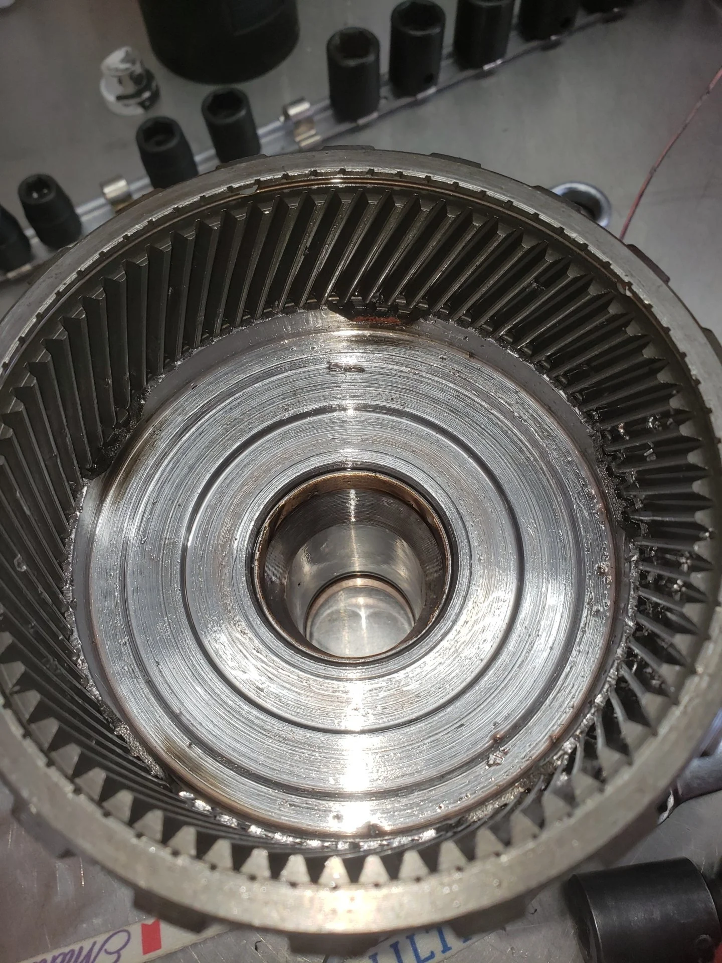

Got it apart and the thorsen bearing on the front planetary let loose. Planetary is toast.
Picking up parts tomorrow. Going to put in a new torque converter too.
Transmission is in and a run around town was successful.

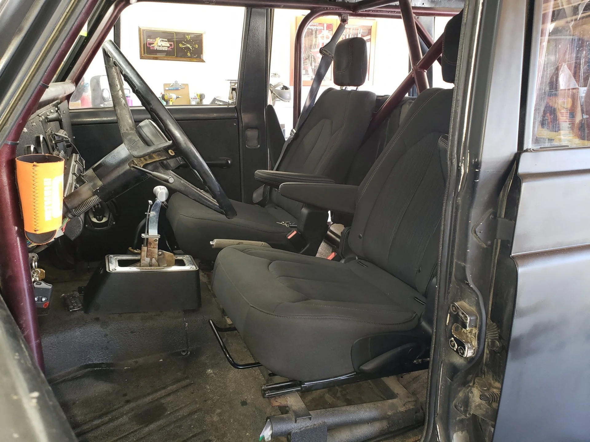

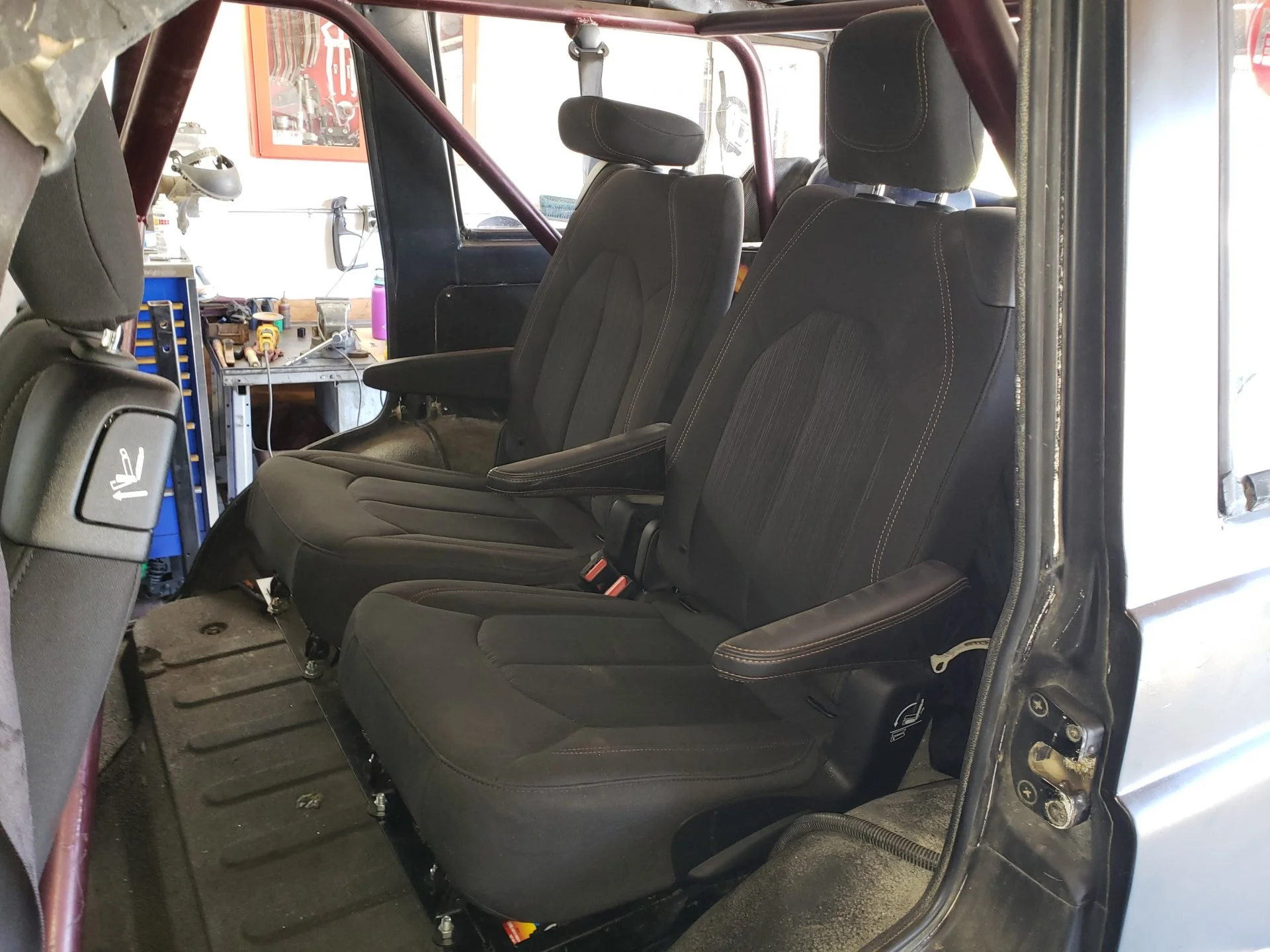

The rear main seal was leaking and so was the output on the np205. Got those both changed. Even put 1 more of the seats in. Two more to go.

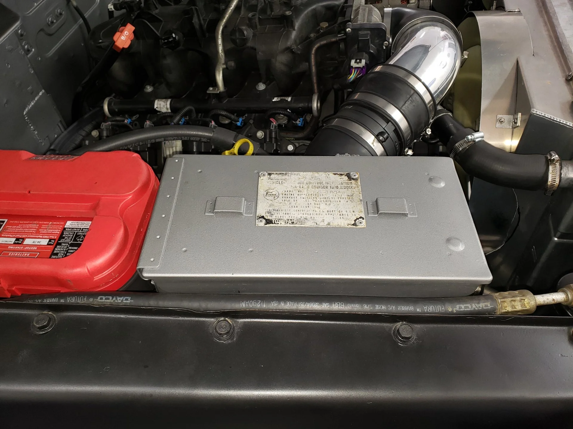

Had a run around town again and got some donuts for the family. Drives nice still. Took the time today to finish all the seats and modified the skid plate on the transfer case. It didn't quite fit after moving everything back 2 inches. Added a little touch to the air box.
