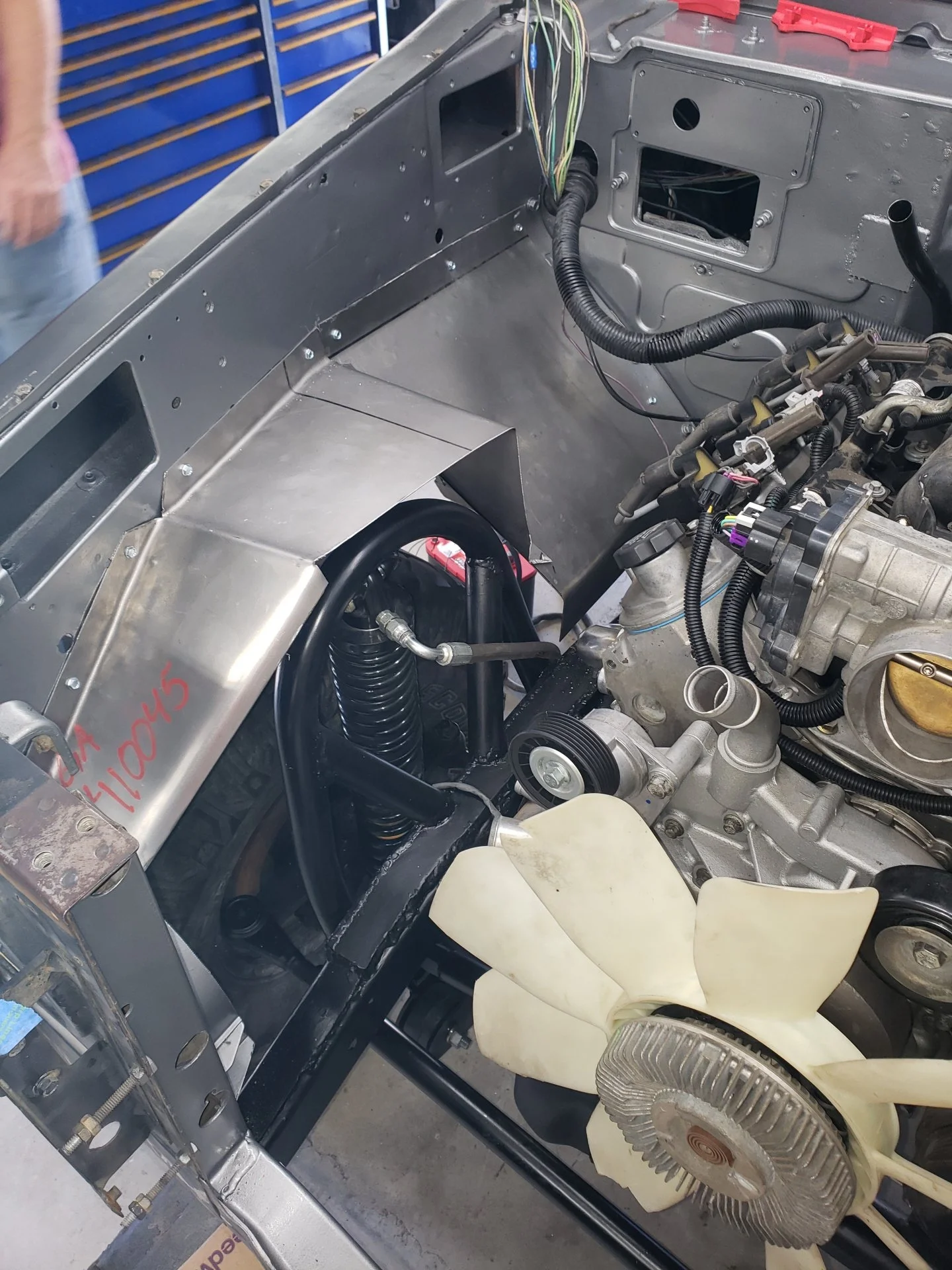

Wire loom is in. Still integrating to the rats nest under the dash. Started on the inner fender fabbing. Almost done with the passenger side and have one part of the driver. The drive by wire gas pedal is in. Hydroboost is plumbed except we need to mount the remote reservoir.
Bought a new radiator, got all the fluids for the engine and trans, bought all the fuel lines and fittings.
Looking great. You gotta love checking things off the list.
I had seen that you cut all that inner fender out. I was thinking it looked preety cool, thought you were going to leave it. Guess one needs to have some protection throughthere.
Nice work. You always see the guys on the shows doing inner fenders.
I learnt quick that not having inner fenders is messy on the motor. I am going to drape some rubber sheet to fill the gap between the body and frame.
The shows make it look easy. That was a pita and didn't turn out how I wanted it too. Not bad enough to do it over. Specially since I still have to do the driver.
