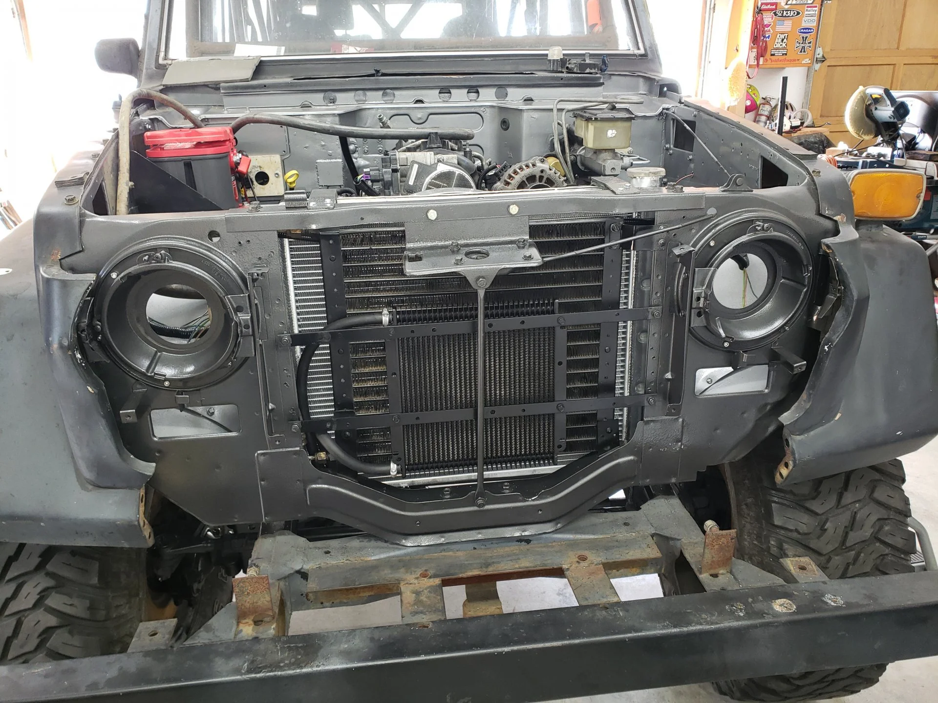

It is a kit that was made for the radiator I bought from speedway. I got their 24 in core and the shroud kit. It was a bit of work because the vortec fan is bigger than flat spot on the shroud.

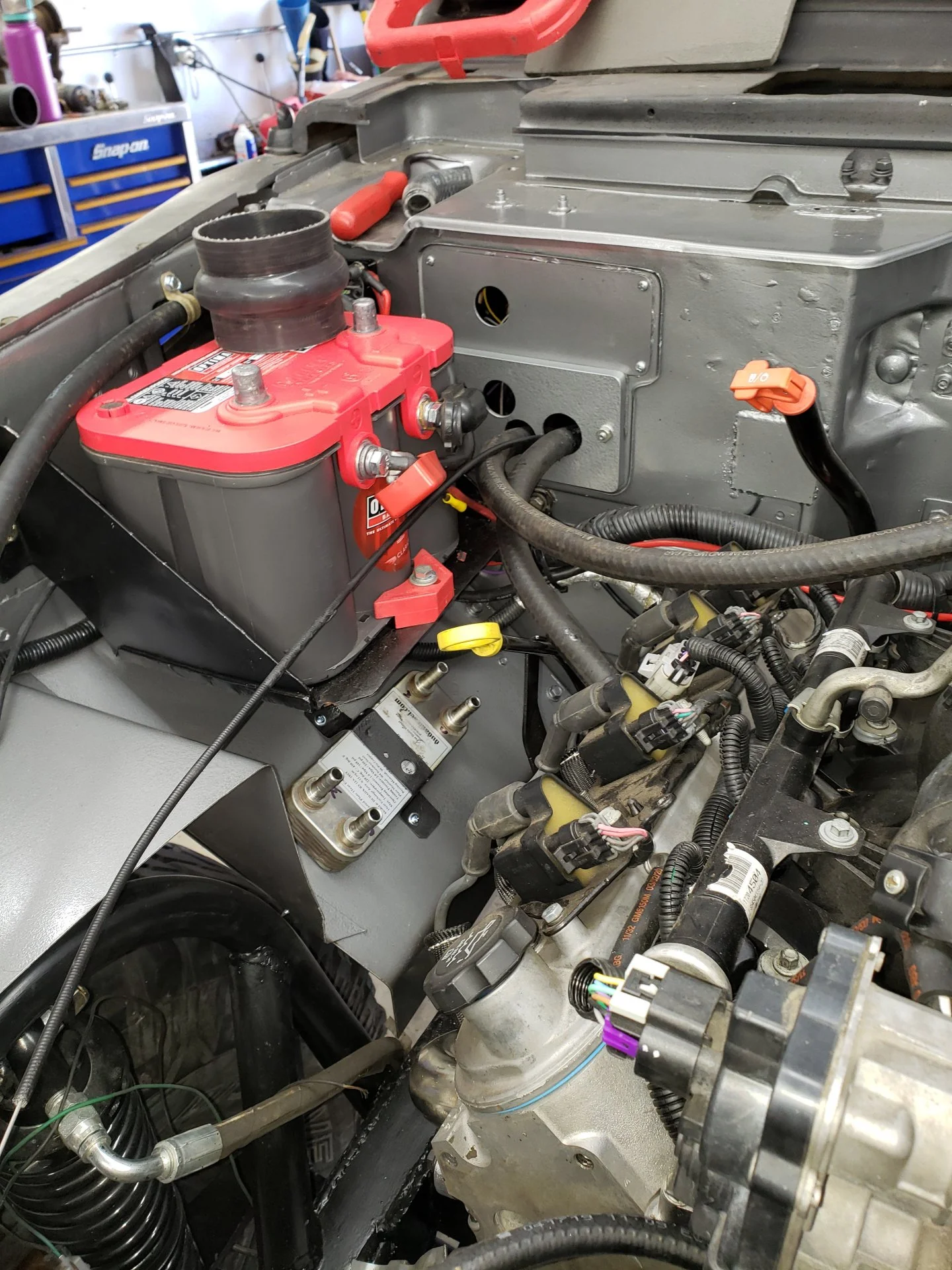

Thank you but there is still stuff missing. Heater and a/c not plumbed and the shower is not in or the intake. It will be better than before but probably not as clean as it is now.
A rare mid week update. Stopped by to drop some parts off and Steve has been busy. Condenser, trans cooler are in. Cooler lines are plumbed. Radiator hoses are in. He was mapping out the a/c lines and waiting for a new dryer from me. I am waiting on a cold air intake that I am going to butcher to fit and a few a/c fittings to come.

Most of the a/c is in. Need to get 1 hose shortened and another made. Heater hoses are in and we plumbed the heat exchanger.
Exhaust is all cleaned up and put on. Had to cut 2 inches because of the motor going back. That pig is super quiet at idle.

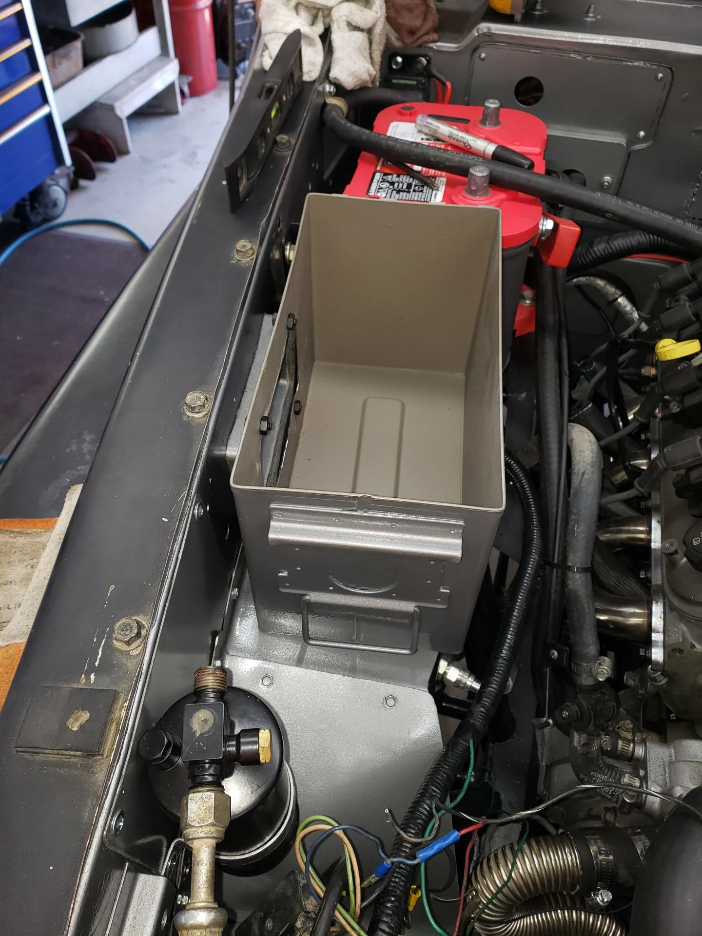

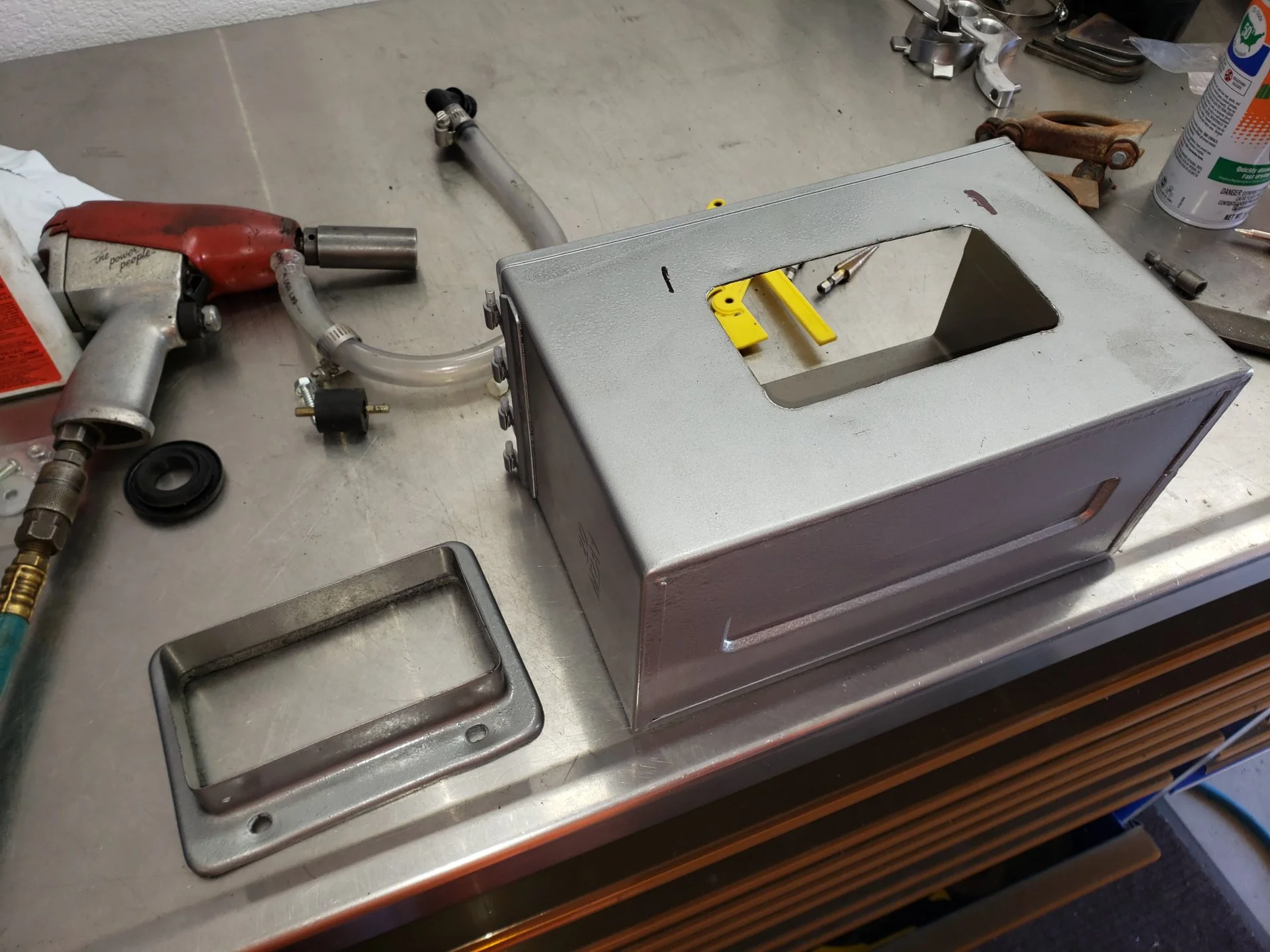

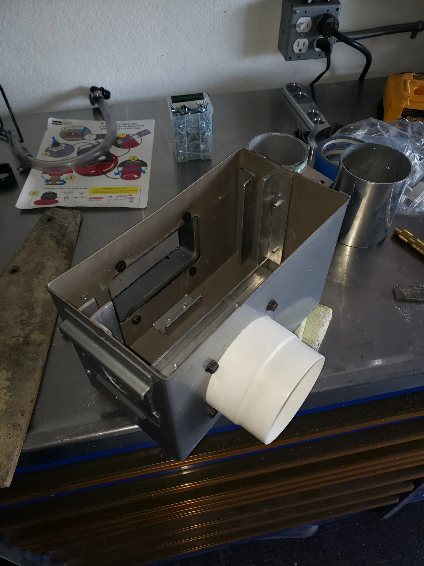

Almost got the intake complete. Shout out to @Calgary40 for ammo can idea. I bit off him big time. It saved time from having to make something but still took a long time with all the mods. I repurposed the stock heater duct to draw air from the fender. Wanted to drive the pig around the block but the ujoint straps were wrong so I have to deal with that. It's coming together.
