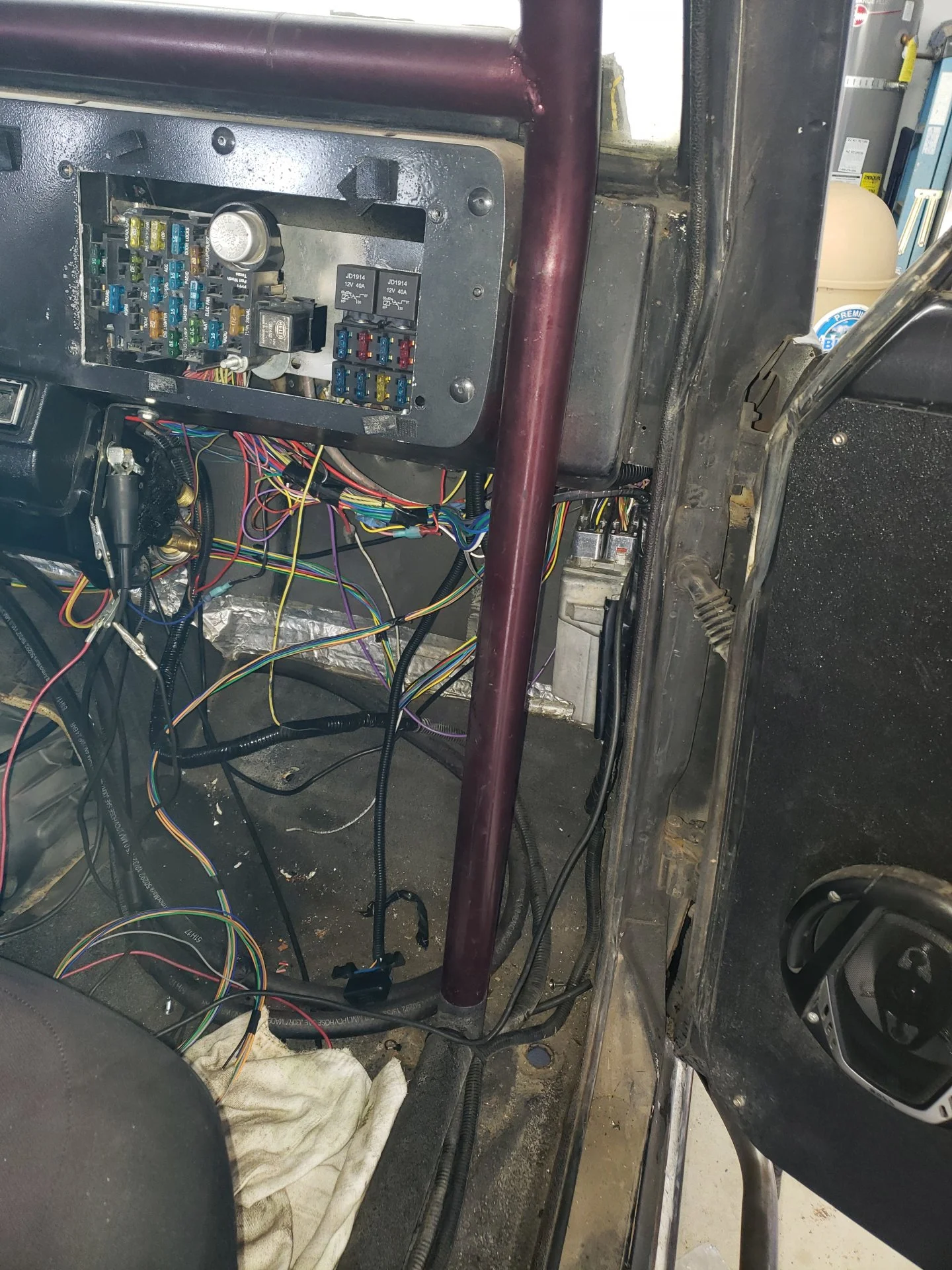

Steve got all the under dash wiring sorted during the week. We got the fuel line installed. Transmission cooler lines are installed but not the new cooler yet.

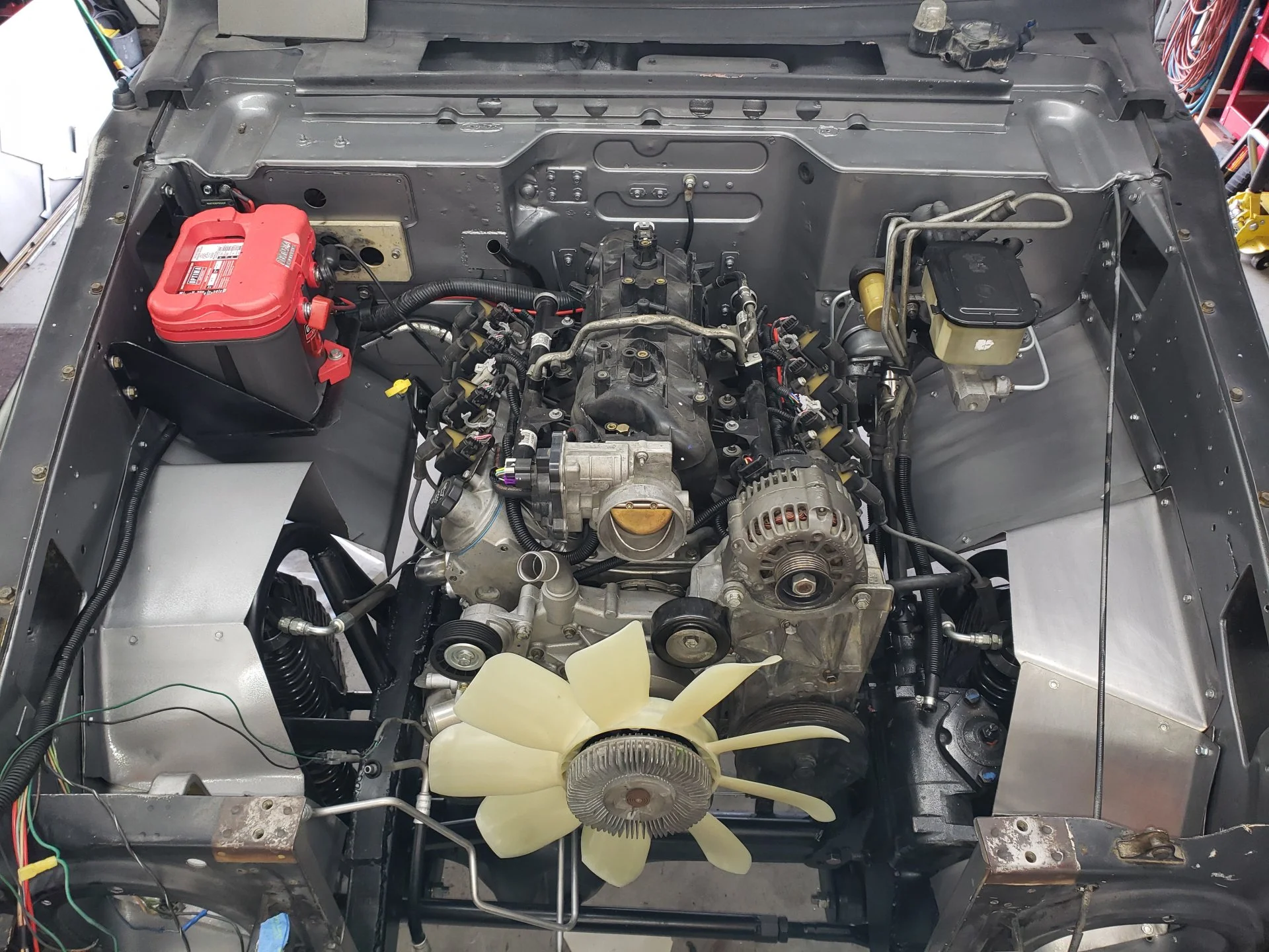

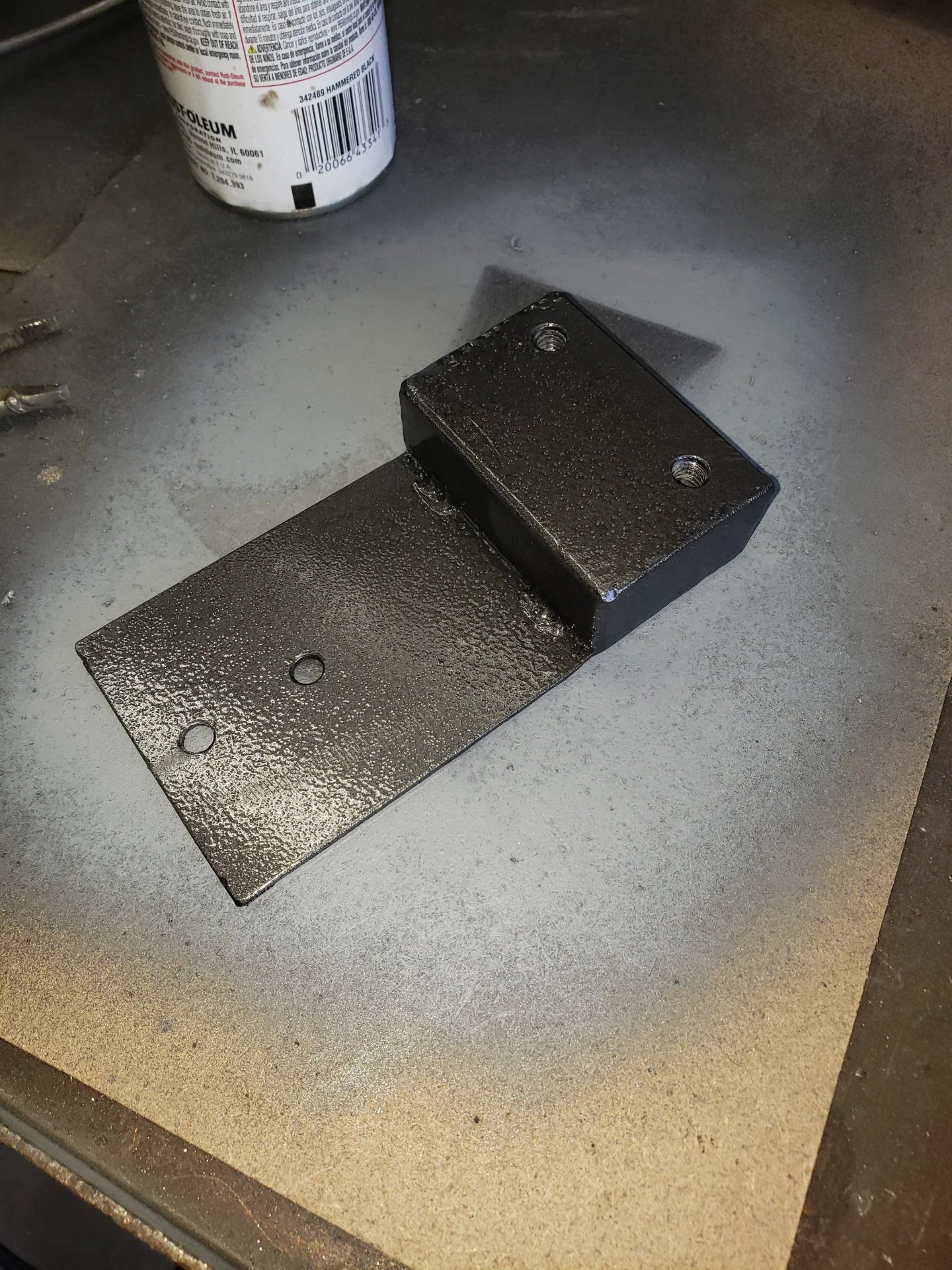

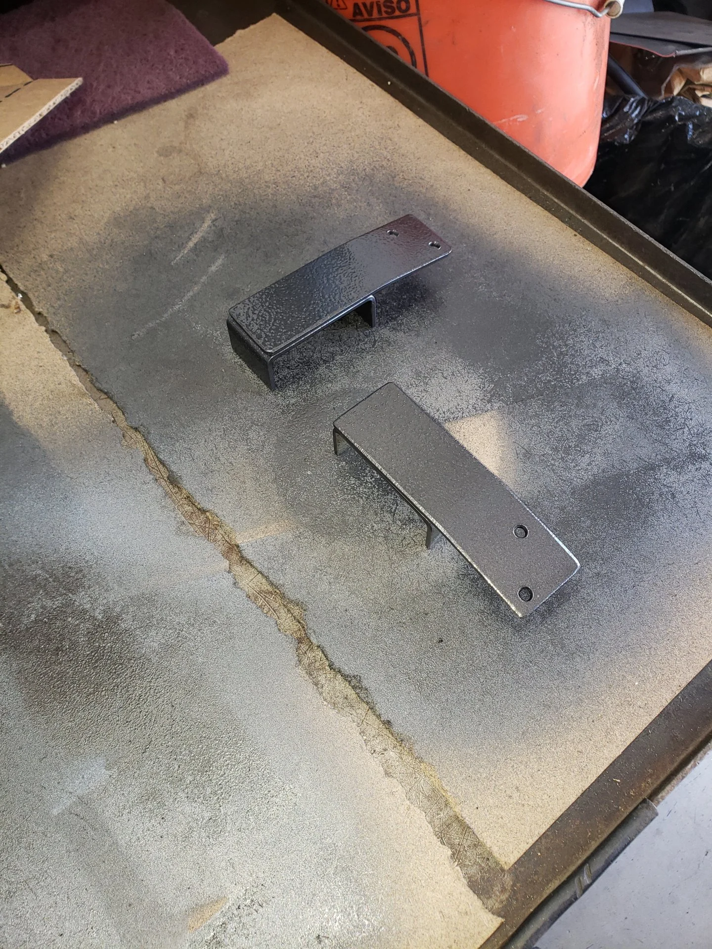

Got some work in today. Made some brackets for the ecu. It is mounted and plugged in. Finished the driverside fender. The passenger got painted.

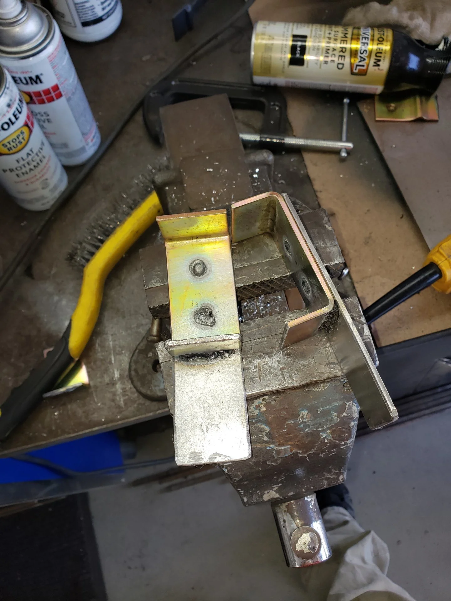

I spent an unusual amount of time with the battery tray. I tried to make one and pulled out of that pretty quick. Decided to use the original tray but it needed work. The PO bent one side to fit a larger battery I guess. So we flattened it and put the old bend back in. It was crusty too. Lots of sanding and painting. Then I got the bright idea to alter it a bit to lock down the battery. We made a lip in the back to lock it down and flattened the from to add a nut so I could use the fastener that Optima gives you. Then repainted it. I like it but man it took some time.

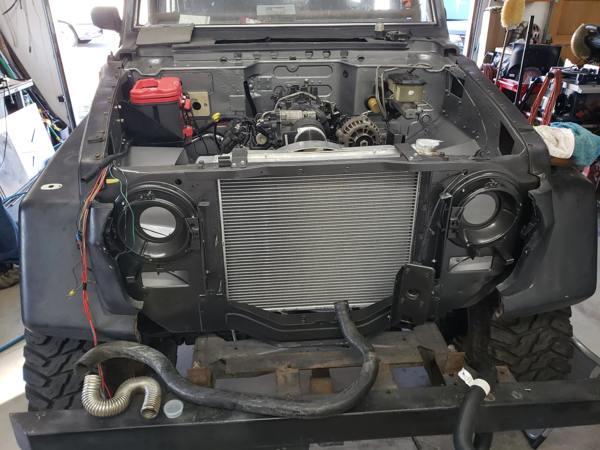

All the battery cables and grounds are in. The front part of the exhaust is freshened up and the new O2 bugs welded and bolted in. Added oil and tested the starter. Cranked it a bit to get the juices flowing.

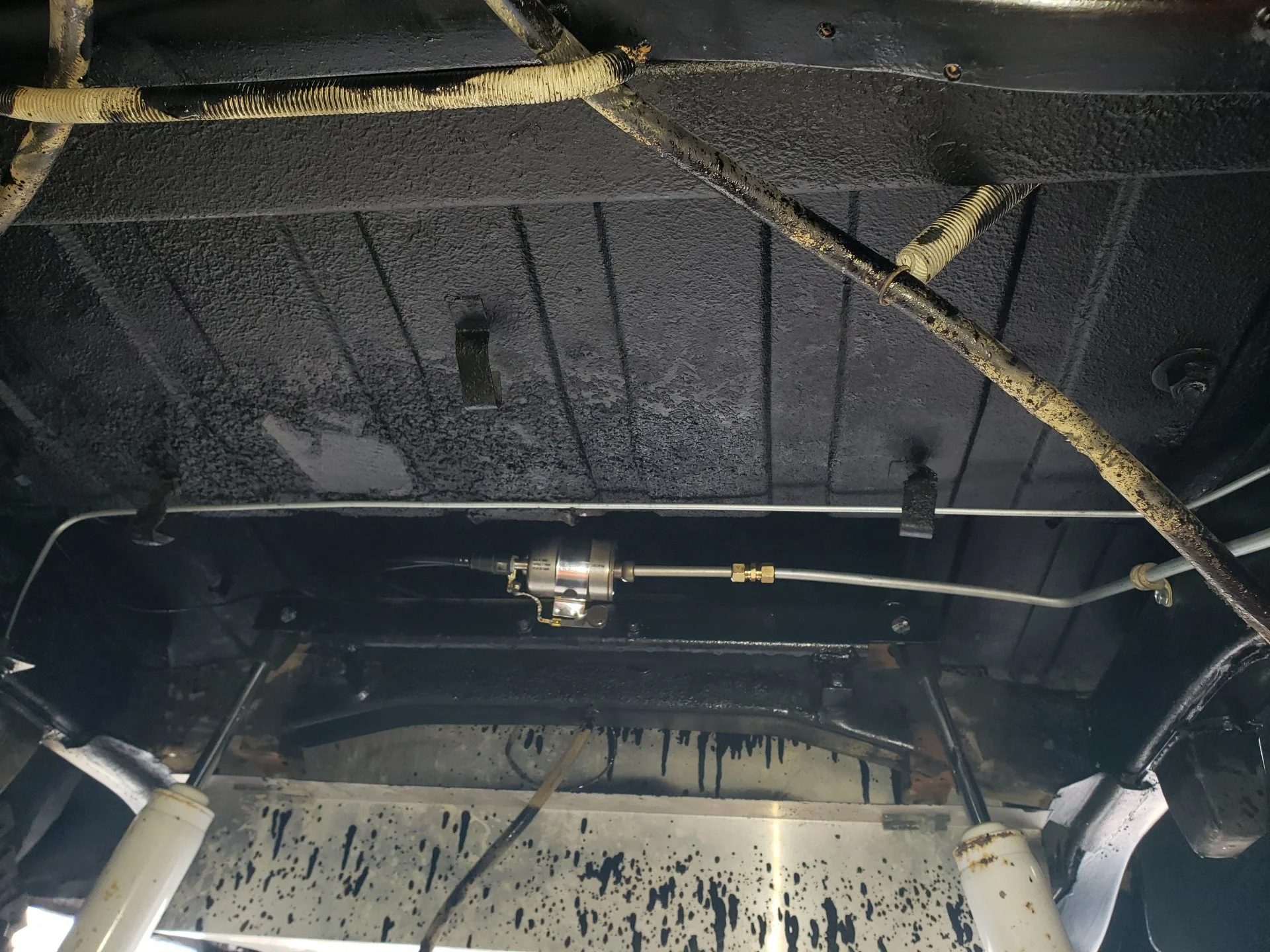

I have to paint that aluminum shield on the gas tank. That is where we had an explosion of underseal. It was about 30 secs into laying it on and then a clog forced the fluid out of the breather holes. It was everywhere and kinda set the tone for the rest of the task.

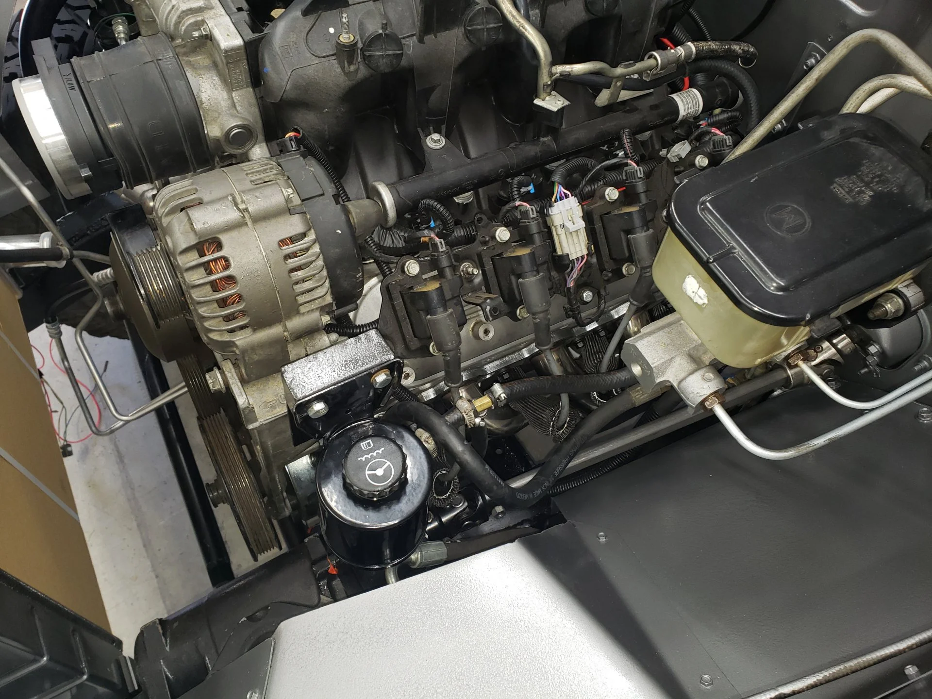

Well it runs. It wasn't a sweet turn the key and rumble. Ignition was bad. Had no spark because brand new crank sensor was bad. Then it would start for a split second and die. Power to the fuel pump cut off after you cranked it. Sorted that out and vroom.

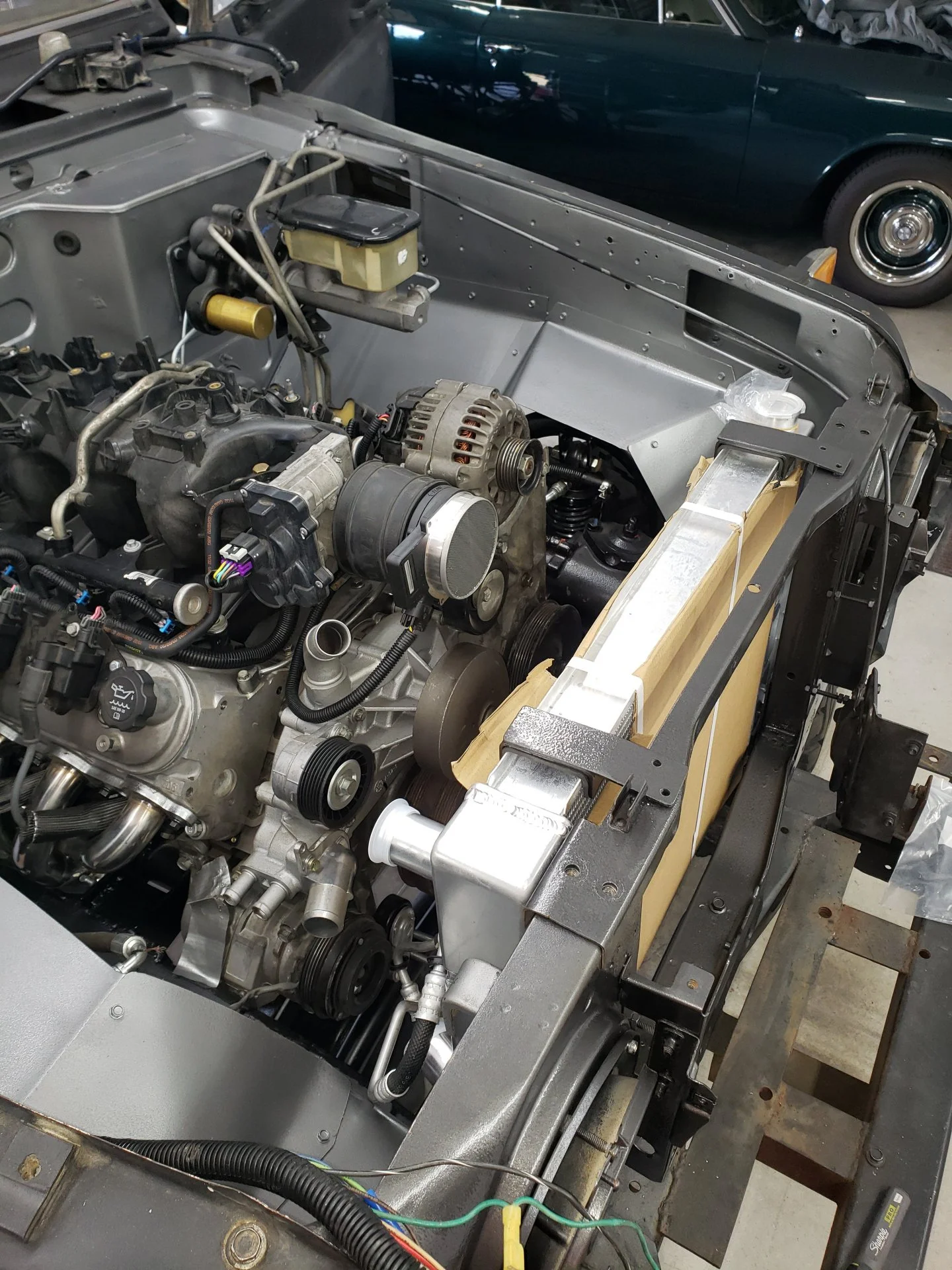

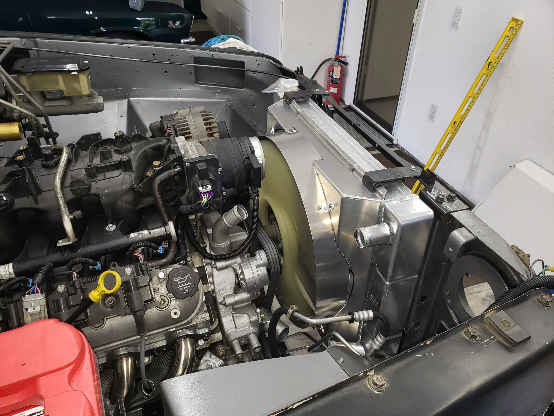

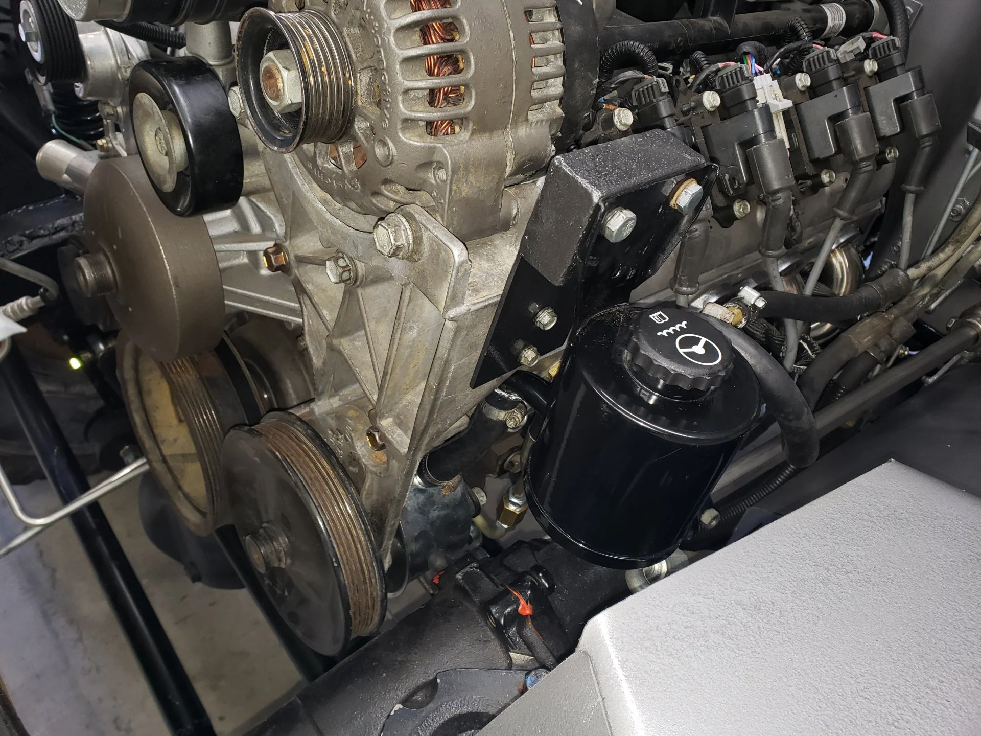

Painted the front clip. Mounted the radiator and made the fan shroud. Made a bracket for the PS reservoir and finished the plumbing. Got makings for the radiator hoses.
It is a sweet sound when you turn the key for the first time and things work. Even if they need a little tweaking.
