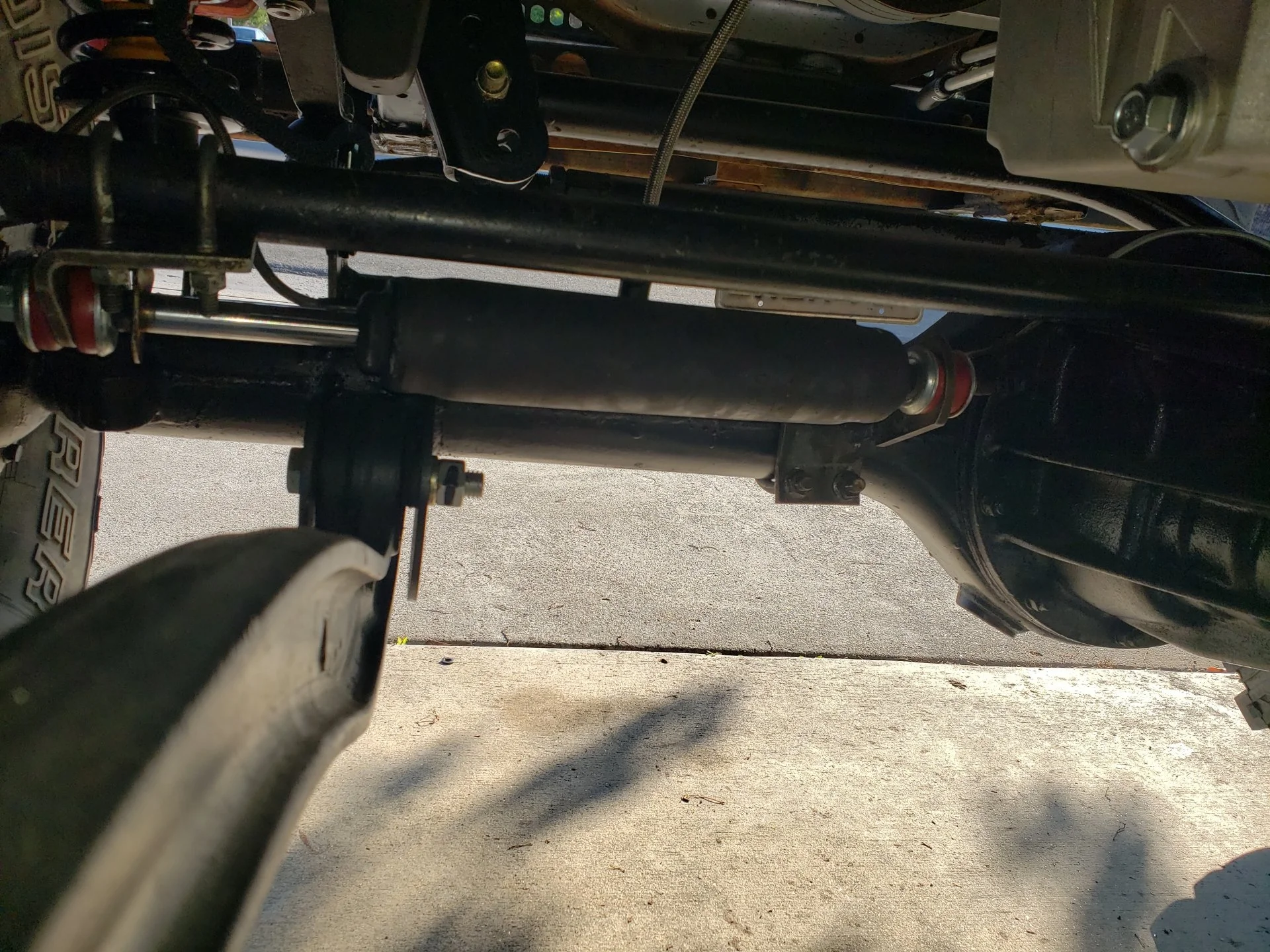

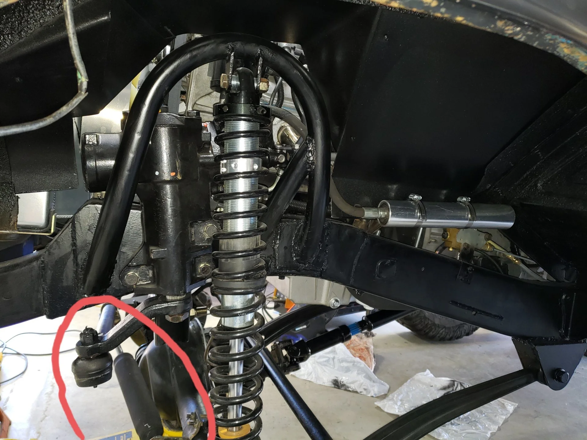

I moved my stabilizer to the rear of the axle. I wanted it on the back and out of the way but couldn't make it work. I put it on the front and attached to the drag link. It was at a weird angle and the angle would change as I steered or as the axle articulated. On the freeway in a slight right turn, if I hit a dip or bump it would over steer abruptly. I didnt like that one bit. Didn't seem as bad in a left turn.
Only pick I could find of the way I had it.

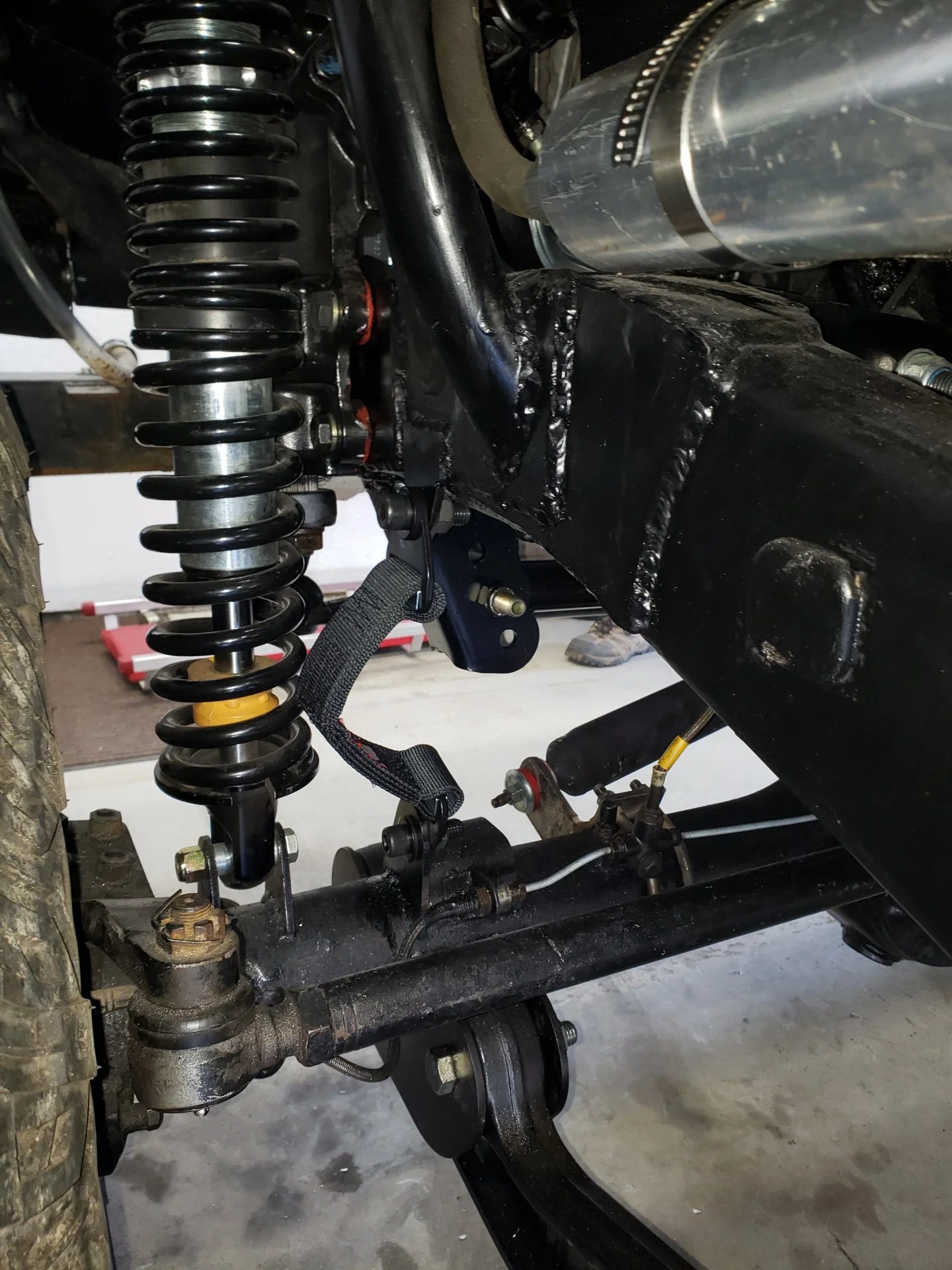

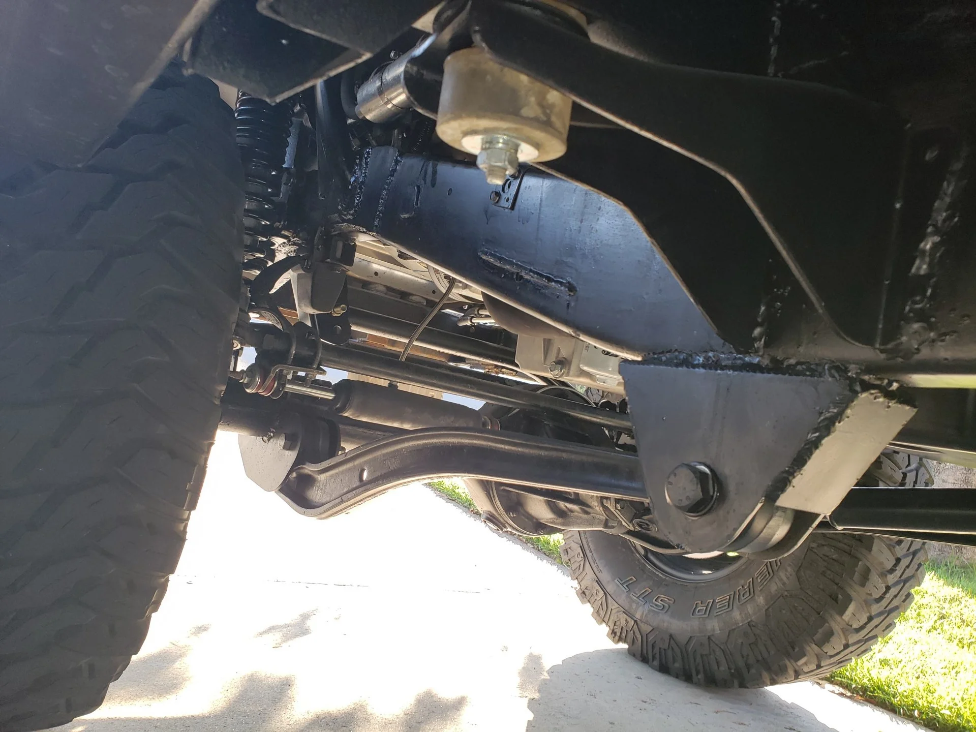

I had to think out of the box and turned the shock around and it misses the brake lines and has a decent angle. I may need to make the bracket longer to get it closer to parallel. A little drive seemed better. I didnt feel the same issue but may not have recreated the situation as well. We will see.
