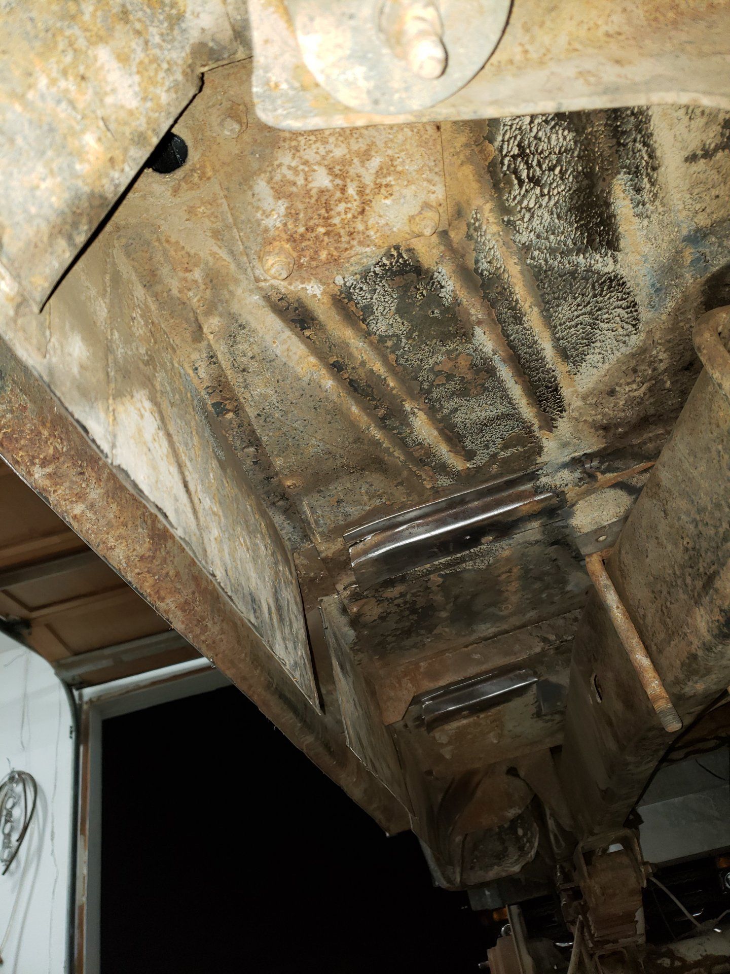

We pulled the engine and trans out, hopefully for the last time. Decided to address the rear body mounts. They basically were not doing anything. I made some 3/16 plate patches. That whole area is not great so instead of rebuilding the back end I'm going try out corroseal and some paint.

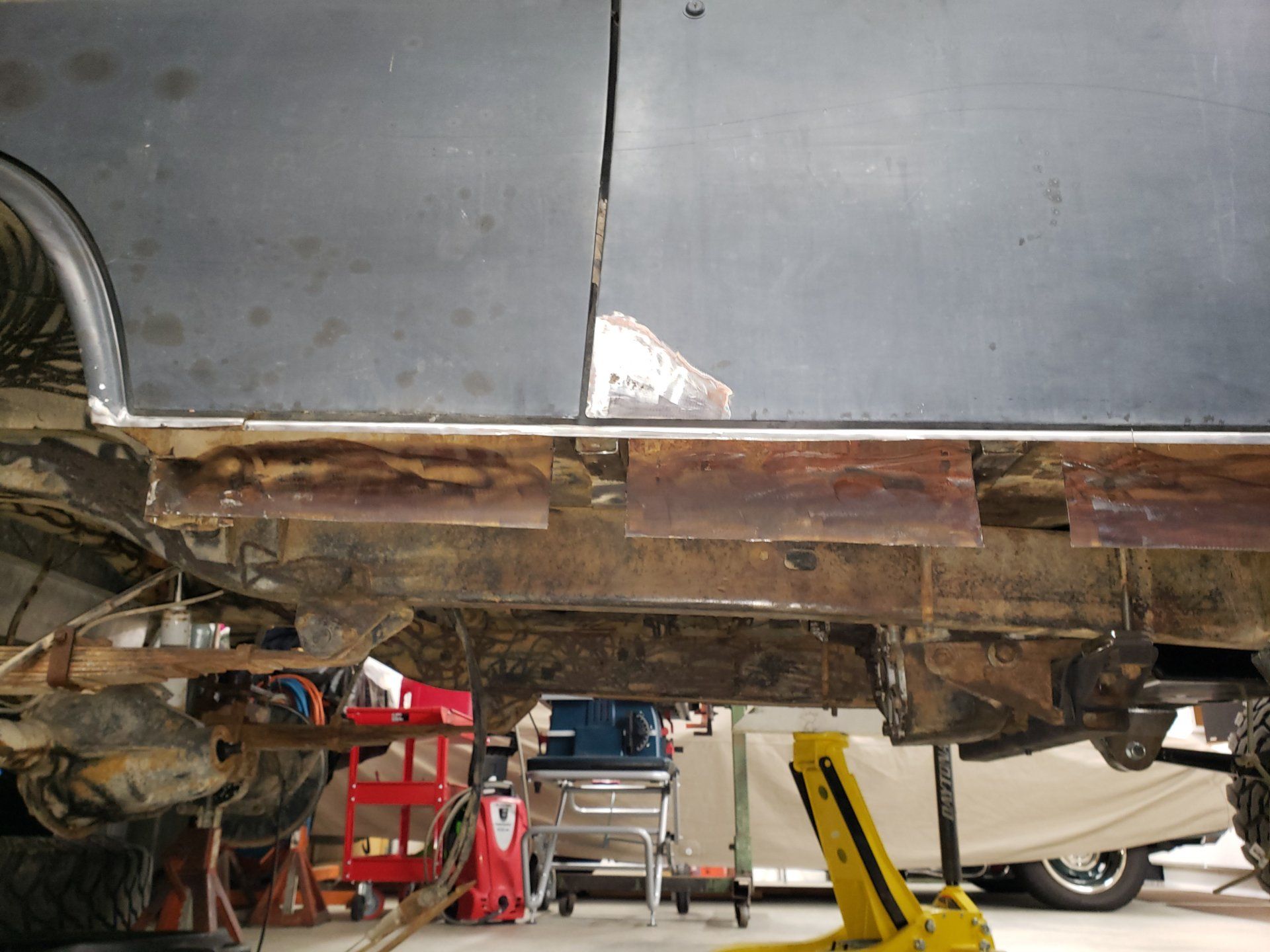

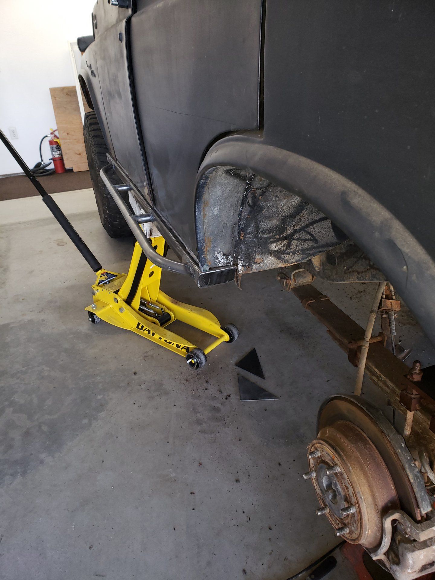

So the pic above of the little patch I made got bigger. And I made an add on piece I was pretty proud of and then we went bigger than that. The BobM mount was helpful but it was not as plug n play as I wanted. I think it is more my floor than Bobs parts. The roll cage is bolted to the floor right at the drain hole and I think the weight of the cage has made the weak metal bow a bit. I was chasing my tail trying to monkey with the body mount. This is why I went with a bigger patch panel.
The rear mounts were terribad too so I made some 3/16 plate pieces to weld back there. Not much to weld too but I might have a fix for that. I am going to do kind of the same thing I did to the rockers and extend that line to the rear lower quarter. The metal there is mostly bondo and rust.
With the drive mount all in and good I was able to put the rocker on and get it welded in place. I took some DOM and some big body washers and made a support piece to smush between the floor bottom and the body mount. I made this thing a few times to get it right and in the end I got the size perfect and never took a pic of it. I assure you it exists and is epic and perfect in everyway.

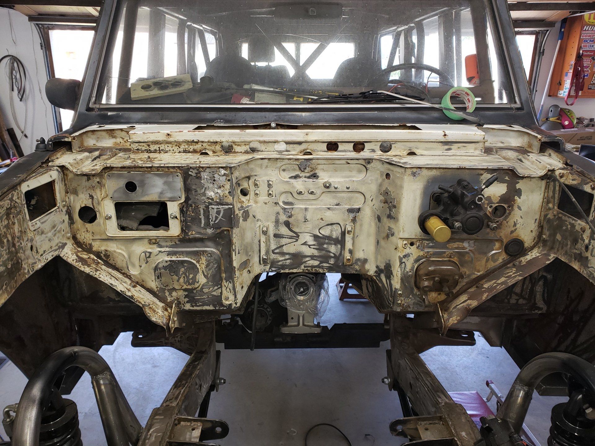

I cut off all the bendy tabs in the engine bay and filled in a ton of holes in the firewall. Hit it with a bunch of abrasives and put some primer on it :cool:. Not sure what color to do the engine area. I mean black probably but I was entertaining other ideas.

Fire wall prior to filling holes.
...with primer and then painted.
It's Rustolium grey hammered finish. I will probably put another coat on it. I chose grey because the motor is black and aluminum and thought it might accent well.
Nice color choice. I use that Hammered Grey a lot...not on the Cruiser but on other vehicles. Firewall, rockers and mounts look great.
