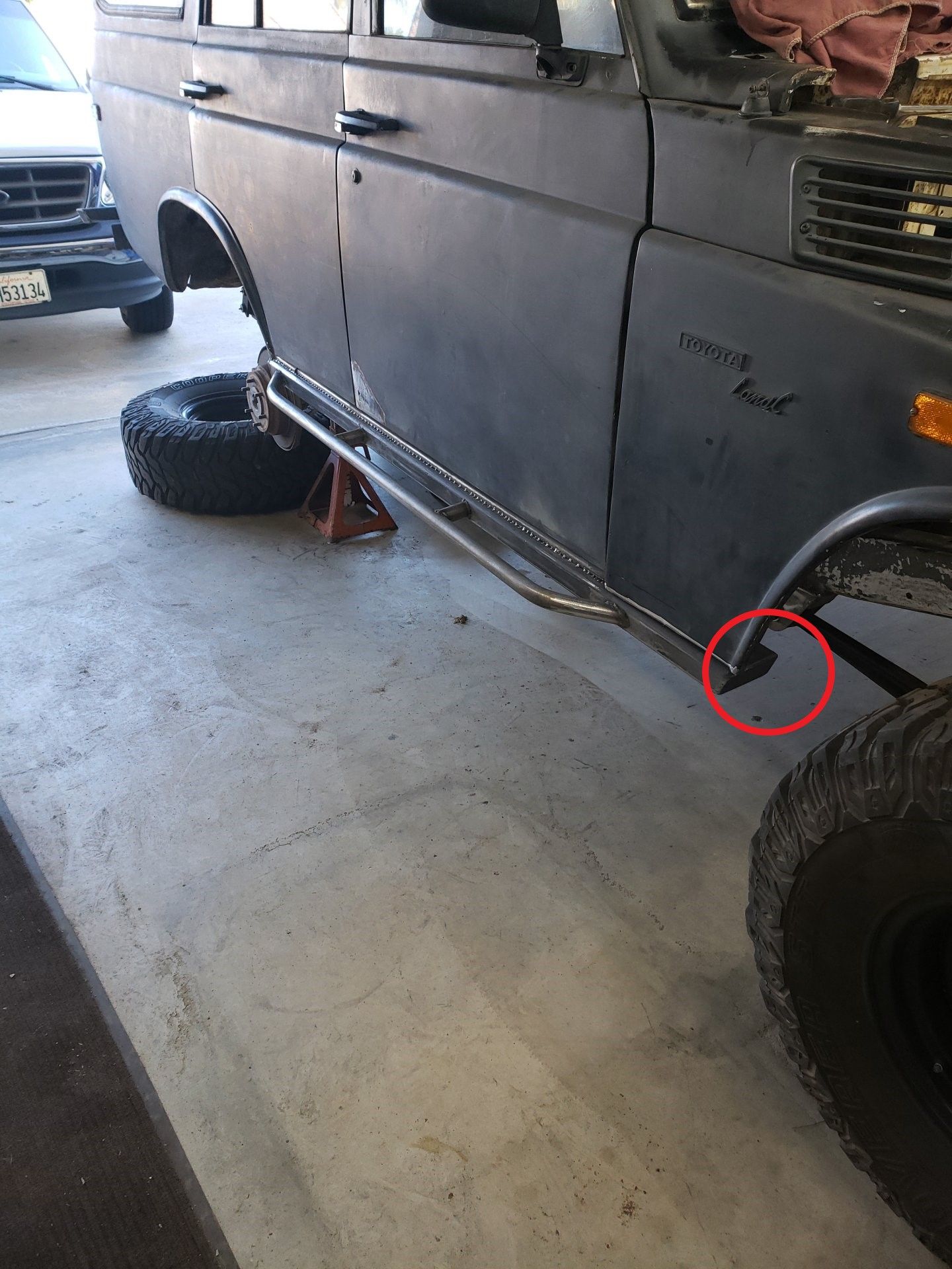

Yes I am going to make them permanent. I dont think I will need to repair the sliders being 1/4 steel. There are some drain holes above near the B pillar that I need to figure out how to drain. My original plan would have sealed that area.
Top of the 2x4 is 69.25". It will have a 3/16 cap on front and rear. I followed the angle of the fender arch and got 22.5 degs in the front and 20 degs in the back. The step is 1.25 dia 5 feet long. I bent the ends at 30 degs. I need more tube for a couple supports in the middle.

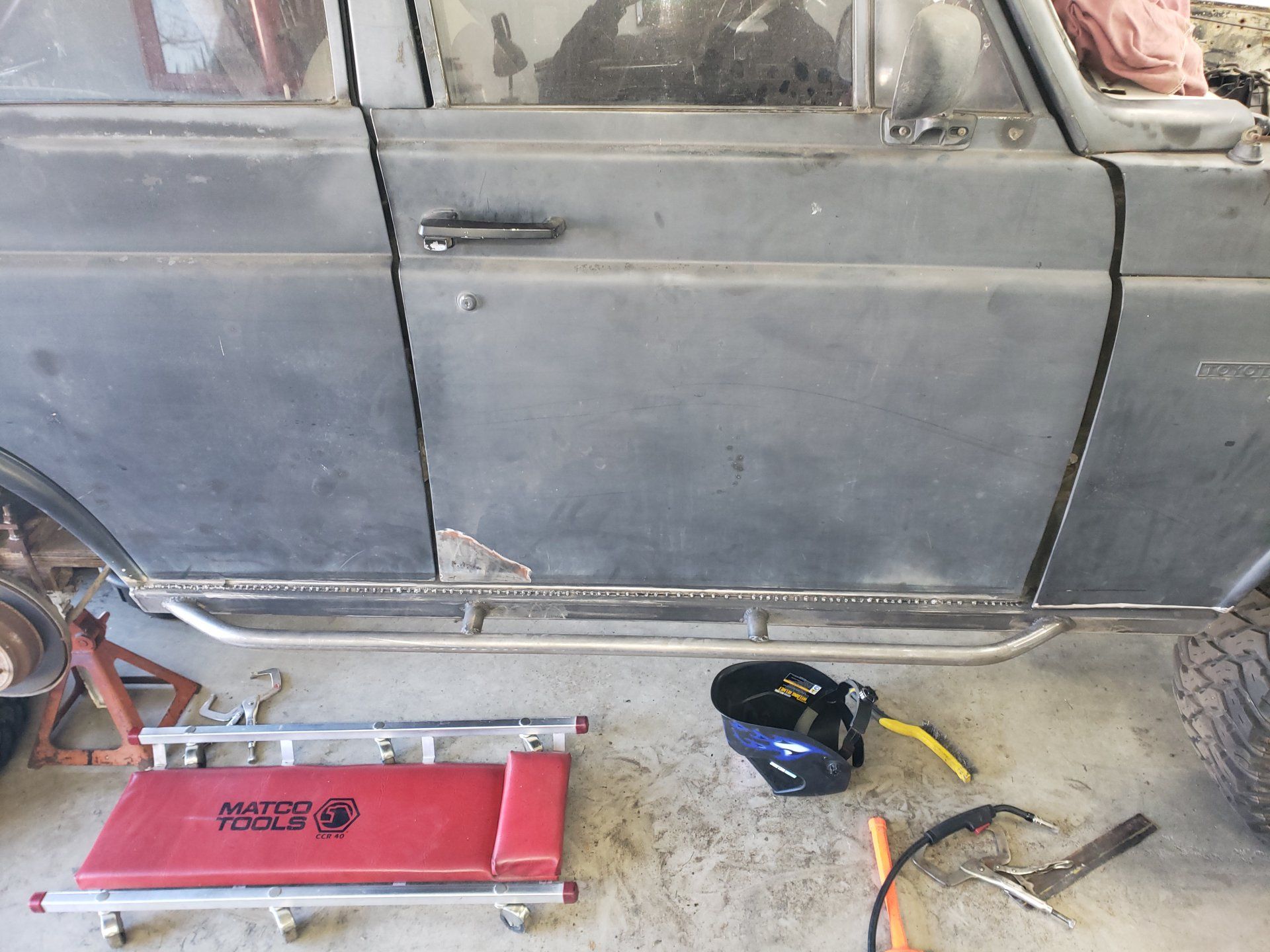

What do you think is the best for the outer seam? I have it spot welded pretty good. Do I need to finish it off and grind, or a seam sealer or body filler? I'd like a nice radius in there but a little nervous about grinding since the metal is so thin.
I like 3M Heavy-Bodied Seam Sealer, 58308 for stuff like that.
I will check that out.
my OCD would require me to fully weld it in and lightly grind and fill.
I was feeling that too. Or at least what I imagined before making those 200 spot welds. It is definitely strong. Steve jumped up and down and I didn't see or hear anything.
I fully welded mine, but it was not really needed. I decided to back-cut the front edge of the 2x4 slider...the part that you see inside the front fender. By lopping off the inside corner, you don't see the square end of the slider. It just looks a little less intrusive...and I am OCD too, so take it with a grain of salt.
