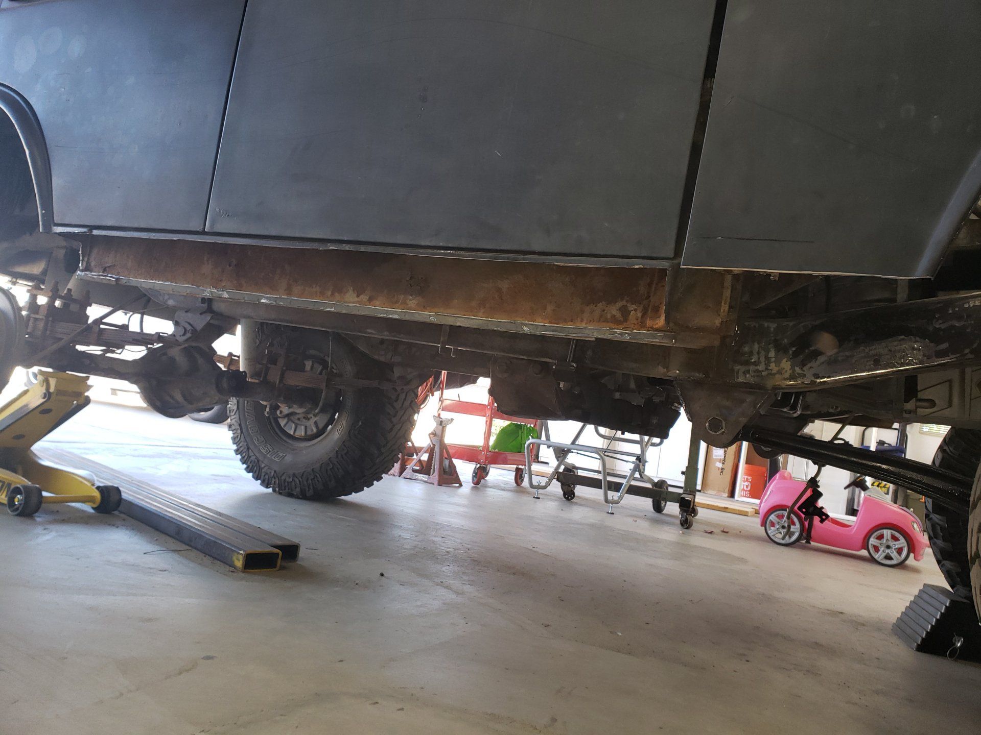

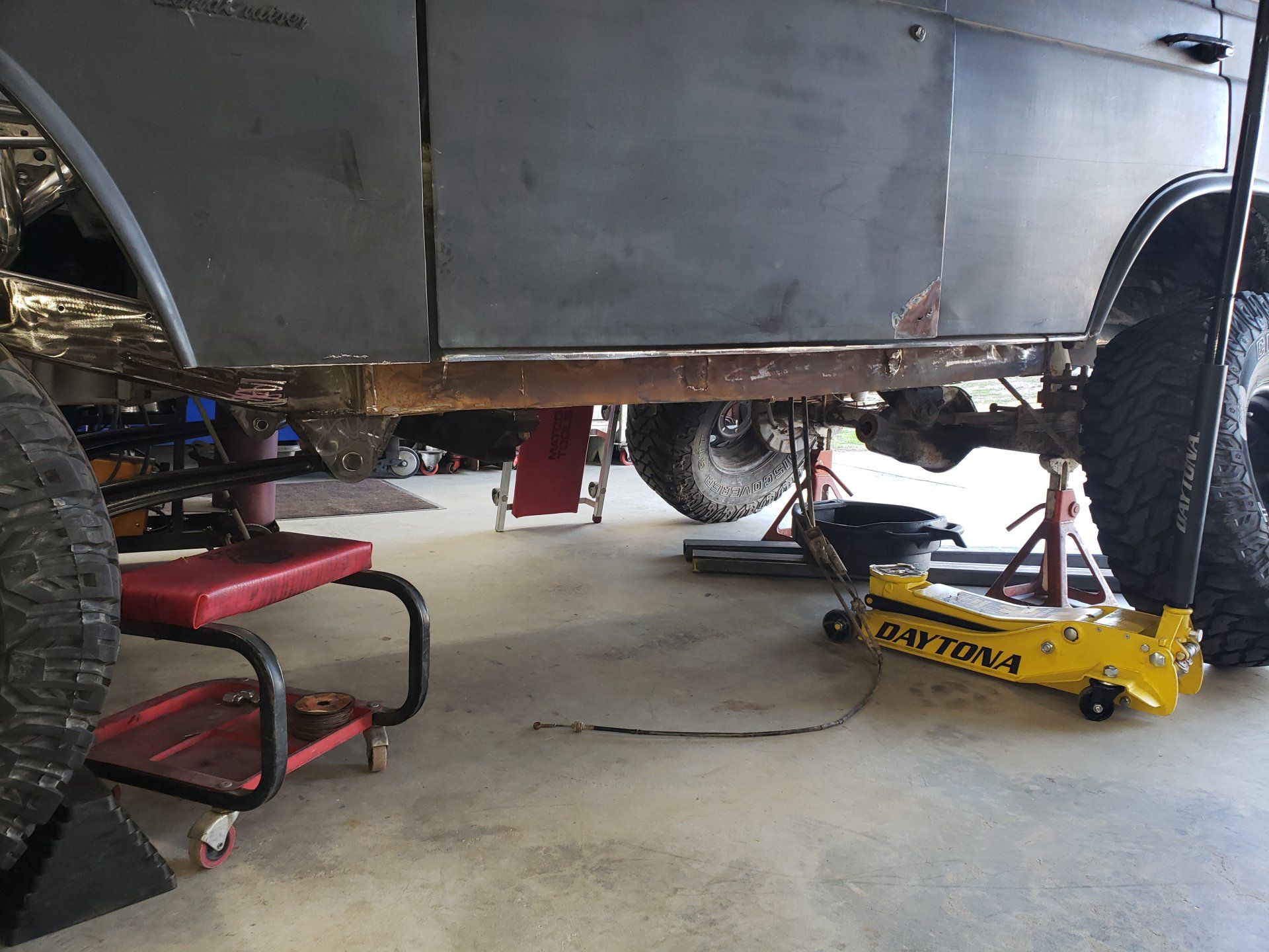

Holidays, work has been crazy, side work is crazy. Those are my excuses for a crap update. Sunday I messed around with the crossmemember and got it adjusted, cleaned and painted. Also cut my rockers out. I need to clean and prep the metal before putting the 2x4 tubes on. I will be putting 1.5" round tube step. View attachment 2550837View attachment 2550838

Got a little time today. I was working alone while Steve is up north visiting a new grandmonkey. I was focusing on the sliders and got the 2x4 cut to length and the step bars bent and cut.
I was poking around the body supports that attach to the rocker area
They are bad, and its a terrible design. They were full of rocks and dirt. I am going to cut them out and make my own. It will be nice to weld them directly to the 2x4. I know I'm adding weight with the sliders but I did drop a few pounds out of the supports.
Looks great! What is the total length on your sliders?
Top of the 2x4 is 69.25". It will have a 3/16 cap on front and rear. I followed the angle of the fender arch and got 22.5 degs in the front and 20 degs in the back. The step is 1.25 dia 5 feet long. I bent the ends at 30 degs. I need more tube for a couple supports in the middle.
