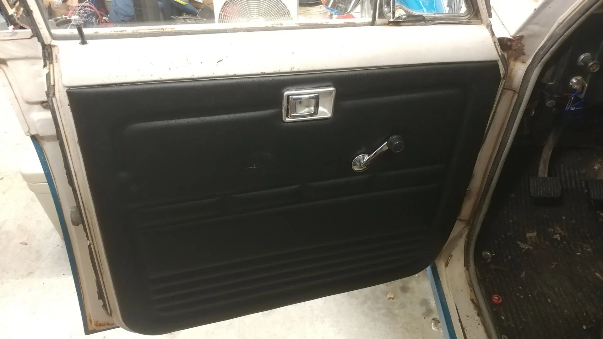

Also started installing the new door cards.
The ole boy is starting to come together.

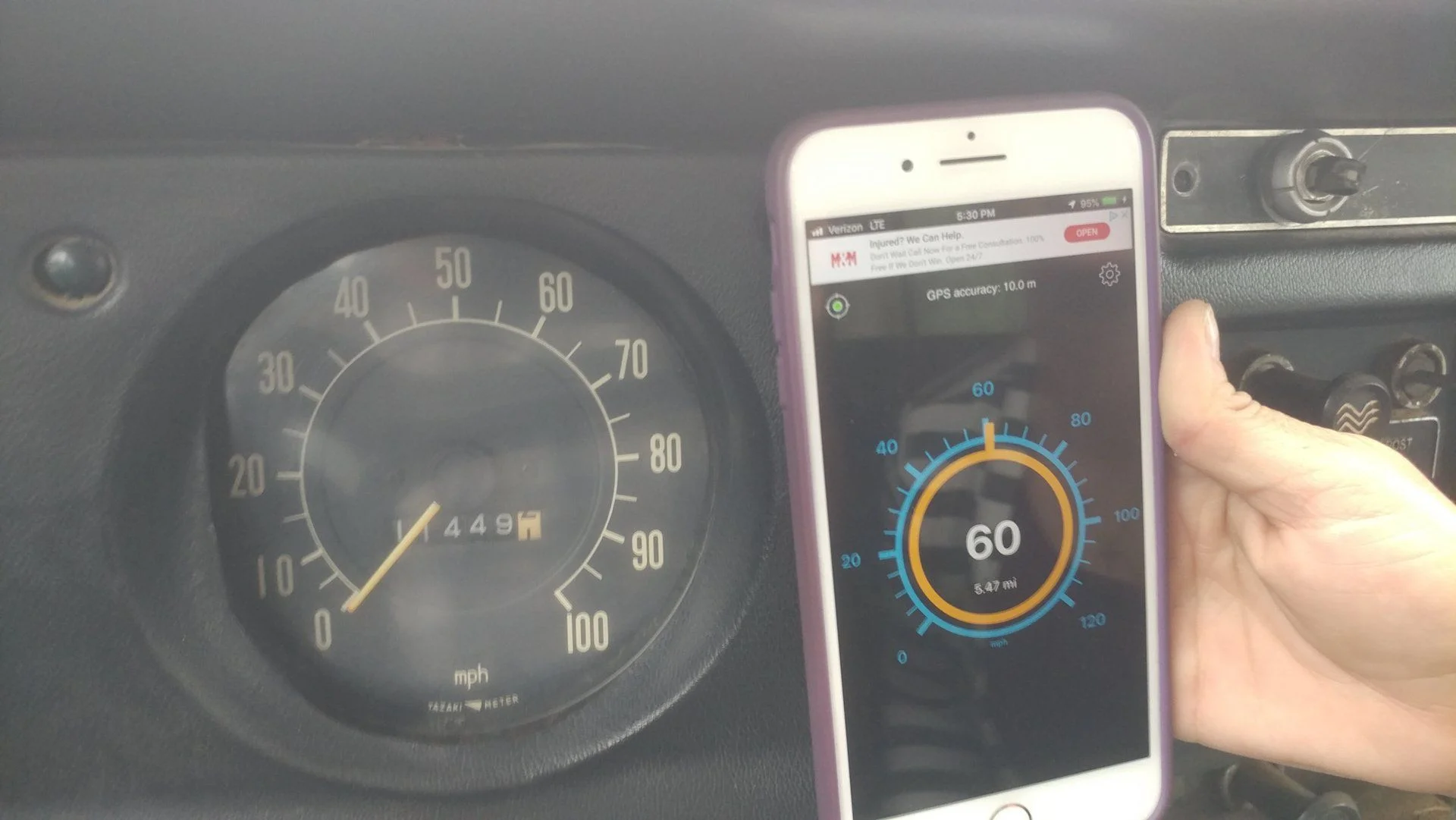

Speedo was working til the dash was swapped, so gotta figure that out.

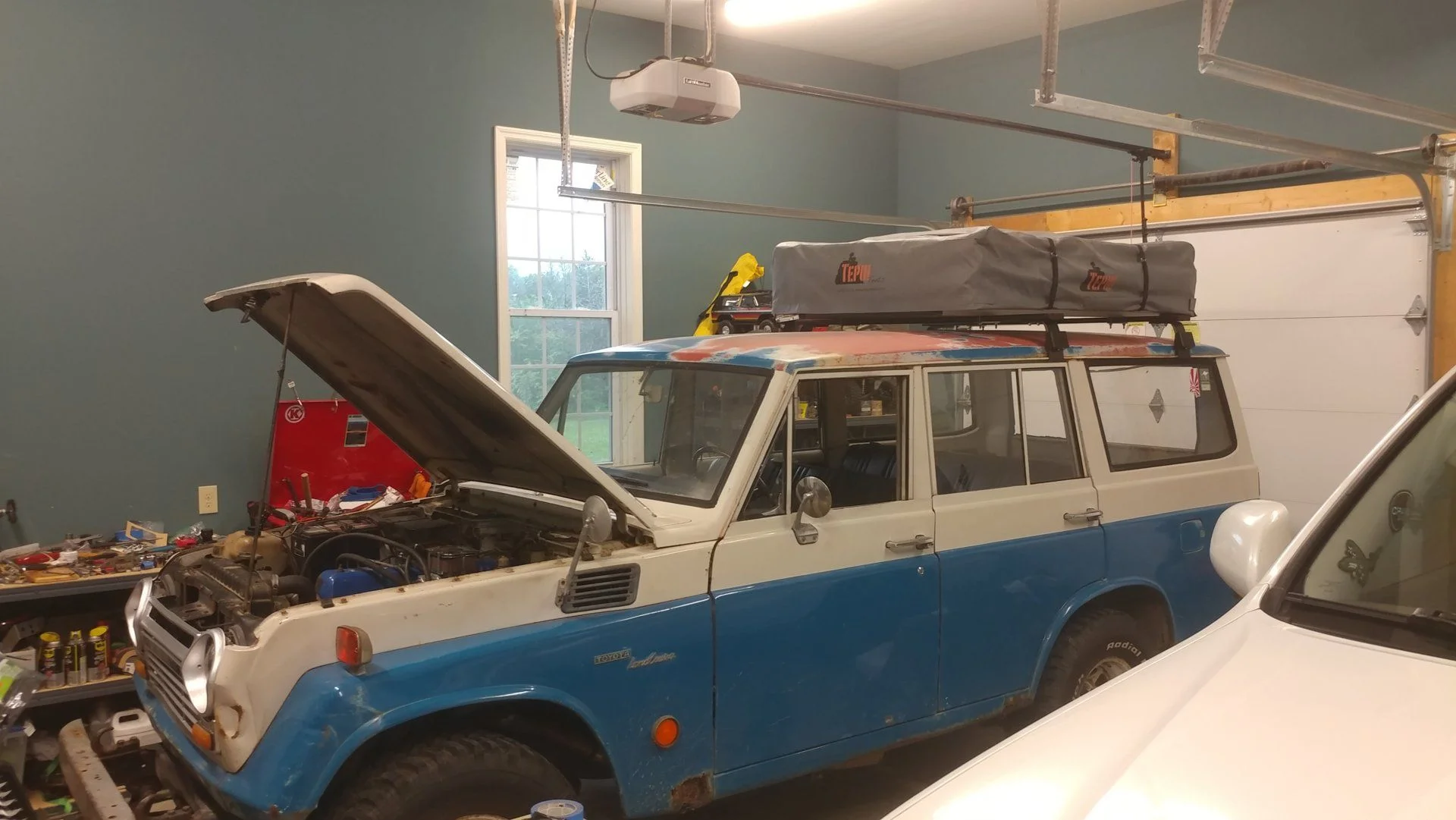

Mounted the RTT on the front runner load bars.

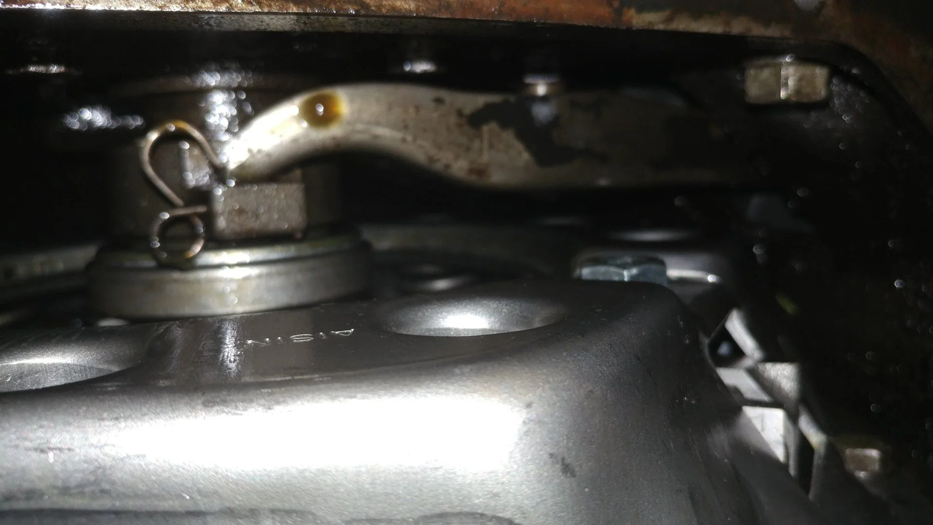

Picked up 2.5 gallons of Rotella and a filter this afternoon along with a set of plugs. Will knock out the engine oil and diffs tomorrow. I bolted the front driveshaft back in and buttoned up a few more things while I was under there. Noticed oil on the floor and noticed this before I put the lower bellhousing cover back on.
I installed a new rear main while I had it out, and did new output seals on the t-case with the e-brake, but never thought to replace the front input seals while the trans was out. Well I guess that will be for another day, but if that thing comes back out, a 4spd will go back up in that hole cause it needs another gear real bad for highway driving.
