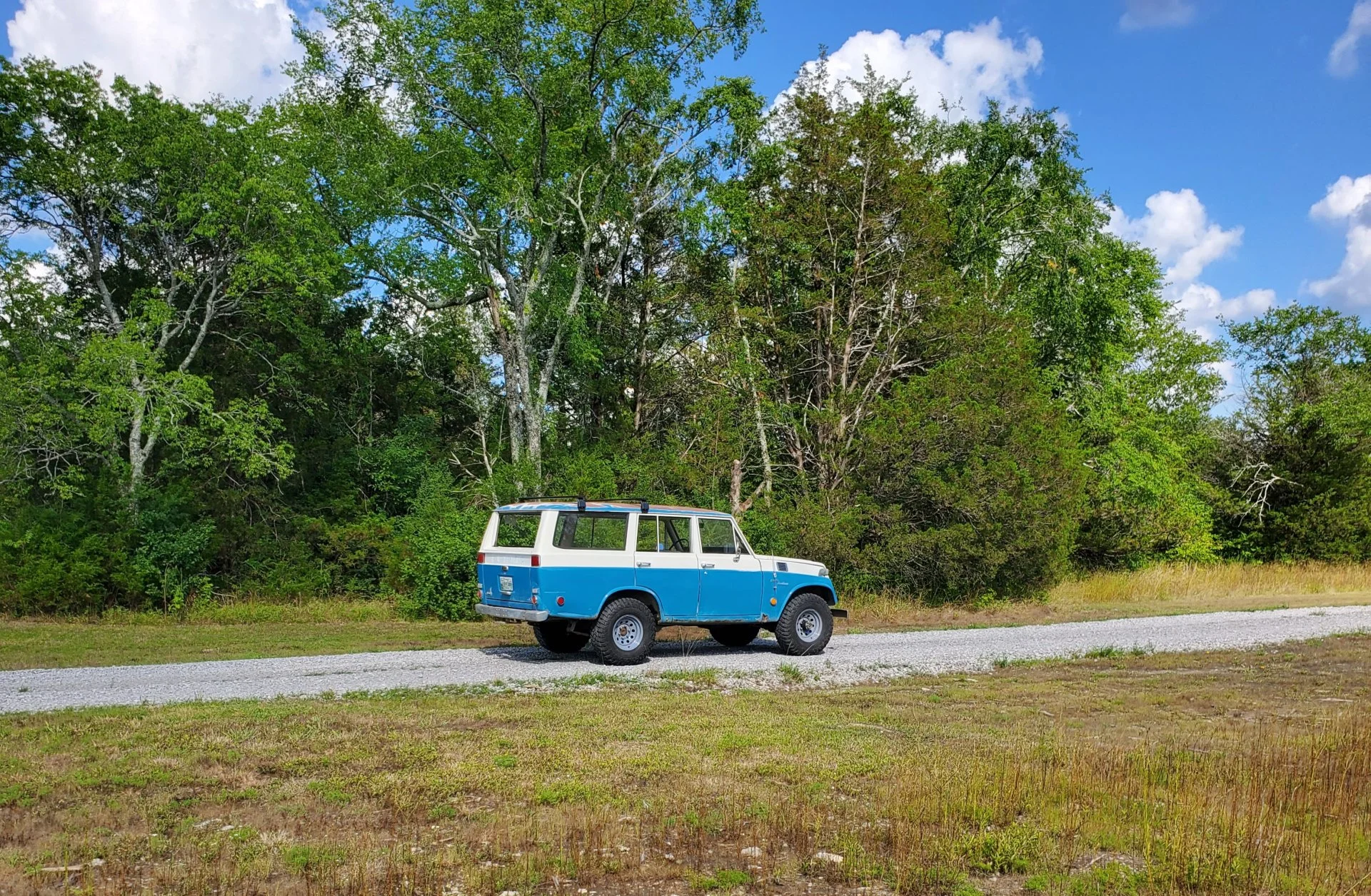

Meet Moose, our 1969 FJ55

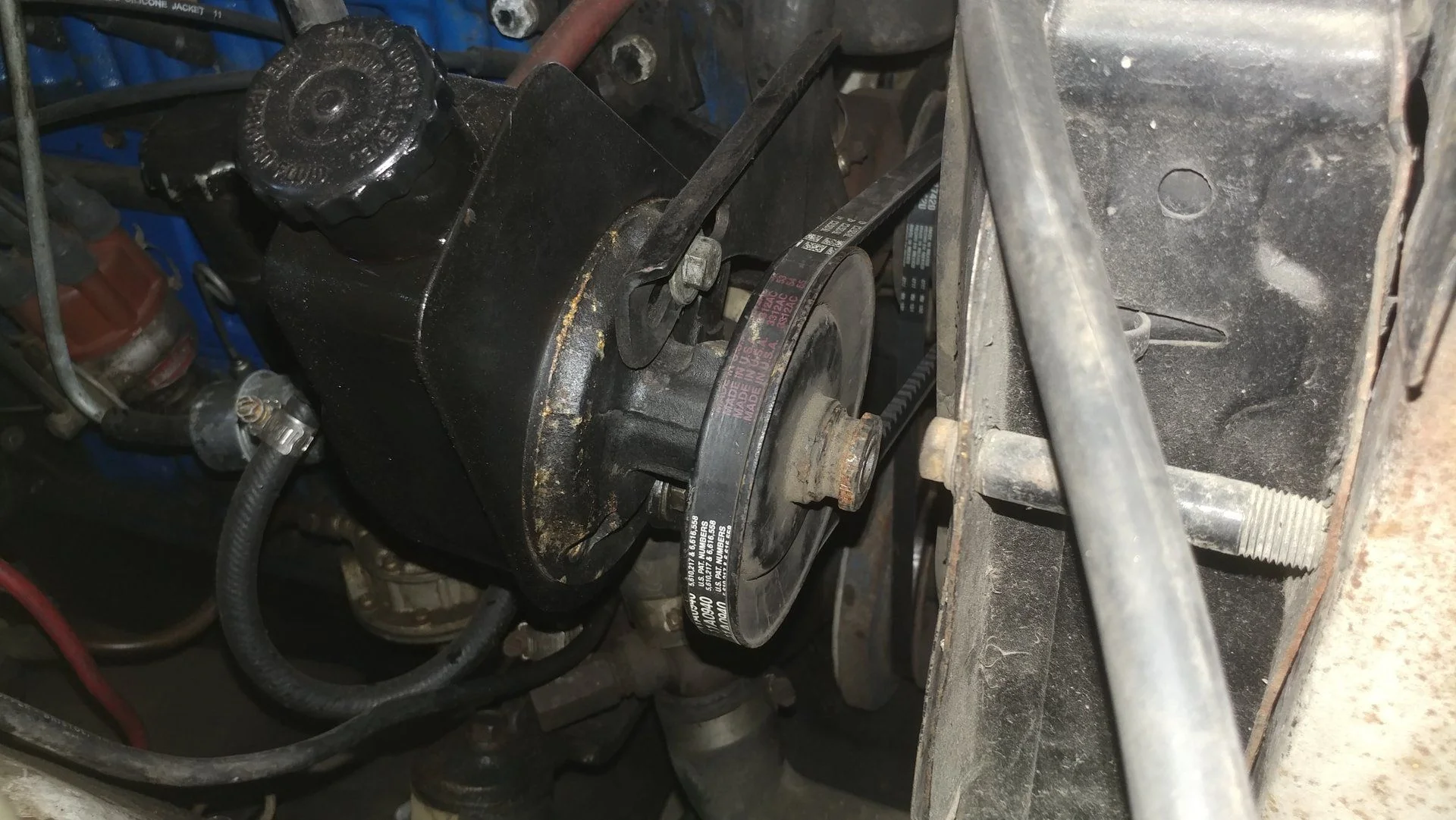

Well, after an email exchange with @orangefj45 today, we have a plan for fixing the power steering...
Rip it all out and start over!
Not wholly unexpected.
I mean here is the box hiding behind this awesome shock mount.
And the pump.
So verdict is to start over. So I'll start sourcing parts this week.
For reals. The pump bracket literally looks like they bolted a piece of plate to the head, took a pump bracket off of something and held it up, eye-balled lining the belts up and welded some braces up. It is super jank, but very stout and crooked.
Cutting off the shock tower will be very satisfying :smokin:
Ok, so after some reading, it looks like the IPOR box mount uses the mini-truck box and the old push pull setup, correct? Since Moose doesn't have any of that stuff anymore, I think what i'd like to look at is a 60 box mounted in front of the shock tower. I found an older thread about it and I actually kind of looks like that is what was attempted here, but with a homebrew shock mount.
So I'm currently thinking I will pull the current pump setup off, then cut off the shock mount and see what I'm dealing with. Thinking that a frame plate with some sleeves might be good, then locate and mount a 60 box and then mount a new cleaner shock mount for the DS. New pump, mounts, pulleys, hoses, etc. to make it work and roll on.
I could pull most anything needed from the parts pig to make whatever work, but I'm leaning this direction. Curious what others might think.

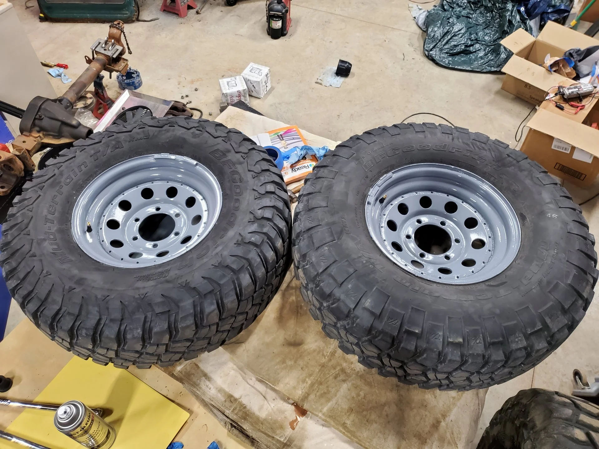

I had some machine grey paint laying around and de idea to see if I could spiff them up a little. First test was a success, so I'm working on the rest. Finished 2 more today in the nasty humid heat, i e left, but may have to sand these 2 since the finish is a little rougher than I'd like.
Before: 31x10.50 bfg km1 on old wagon wheels
After: 33x10.50 km3 on a machine grey steel wheel
Wheel 3 prepped for primer
Wheel 2 and 3 drying
One more to go then I can bolt them all up and see how it looks.

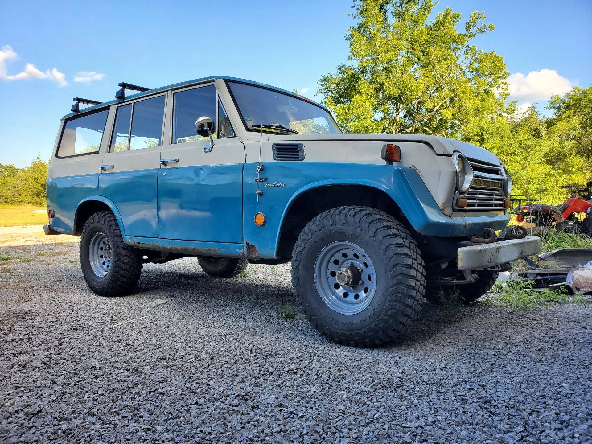

Got all the wheels mounted today and backed him out for a spin around the block.

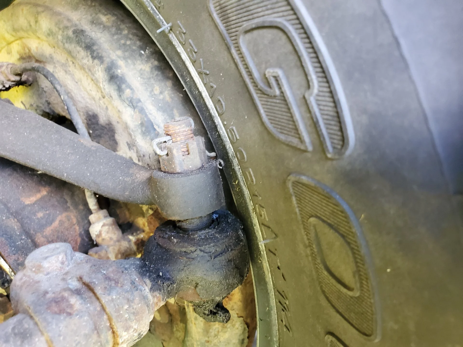

Found that the old drum steering is a little close. It self clearance the 3 weights off the front wheels.
And spit out what was left of the boot.

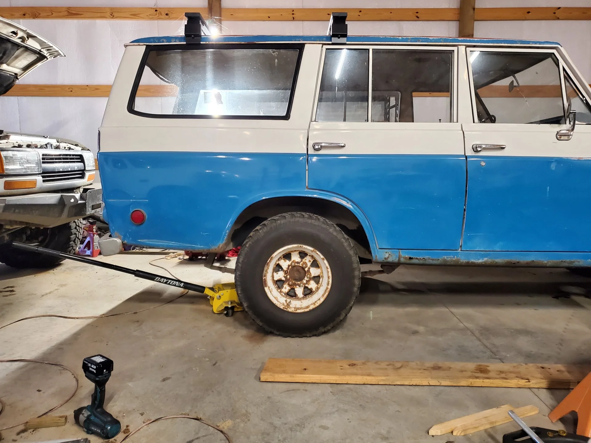

The rear driver inner fender had apparently been bent up a little and I had to use a BFH and a pry bar to convince it to got back home.
Otherwise, these tires fit perfectly. I guess a small 33 is just right for stock height.
