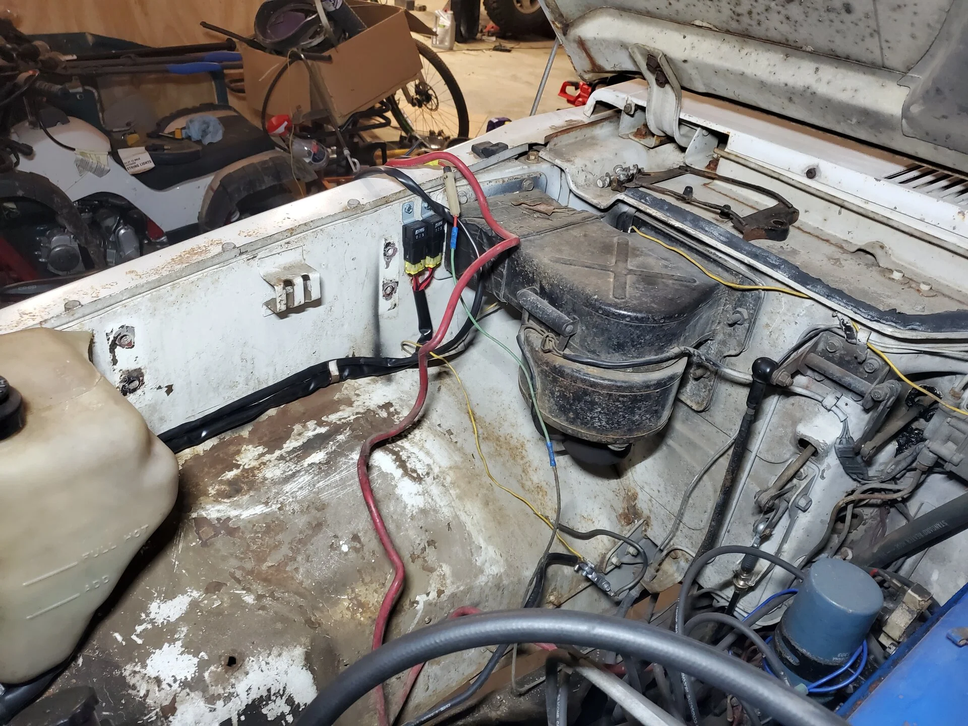

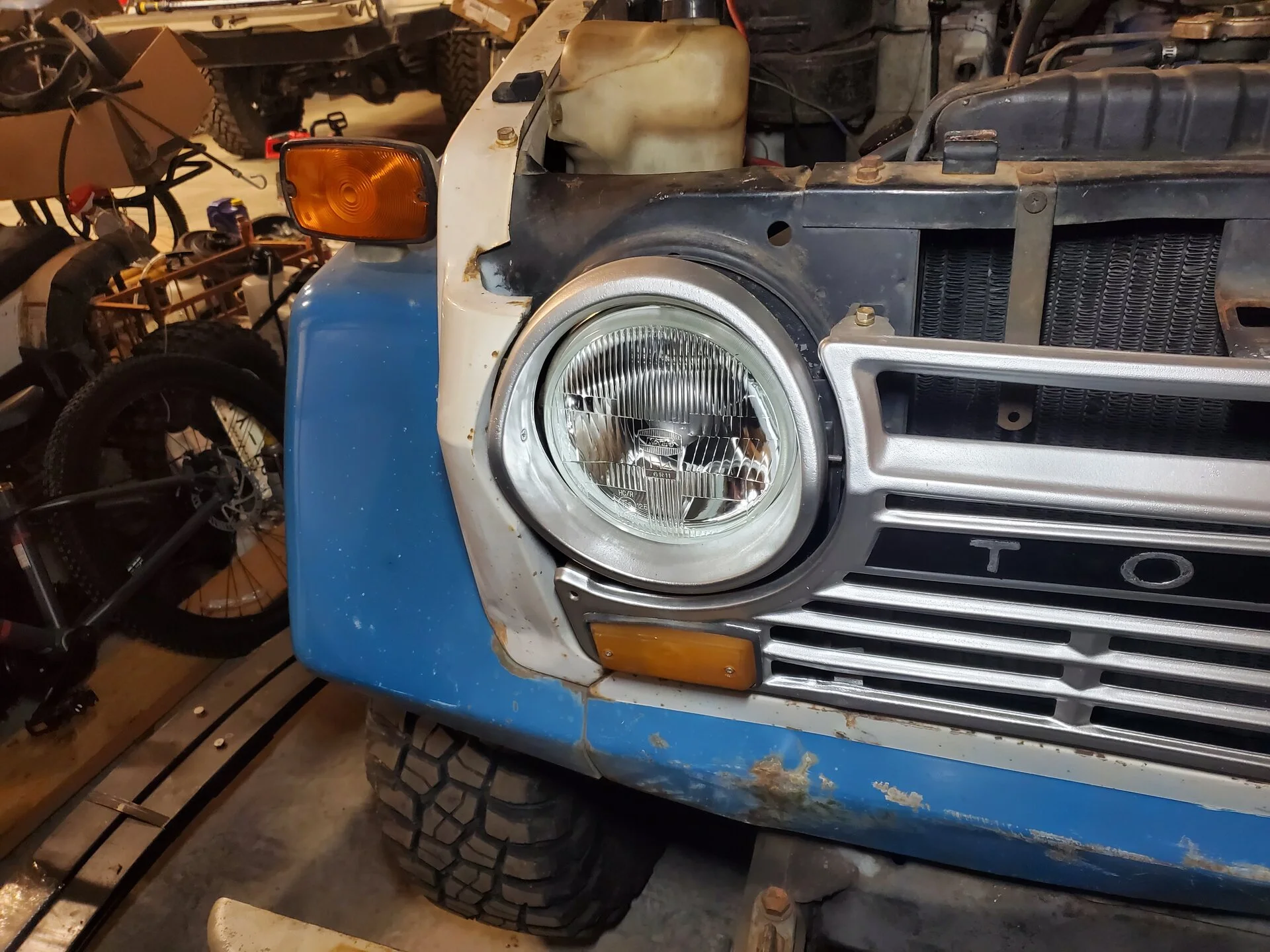

Well, I figured I'd give a quick update. I need to finish up the headlight upgrade. Got these fancy OE conversion bulbs installed a while back but never finished the wiring because I wanted to clean up the battery wiring.

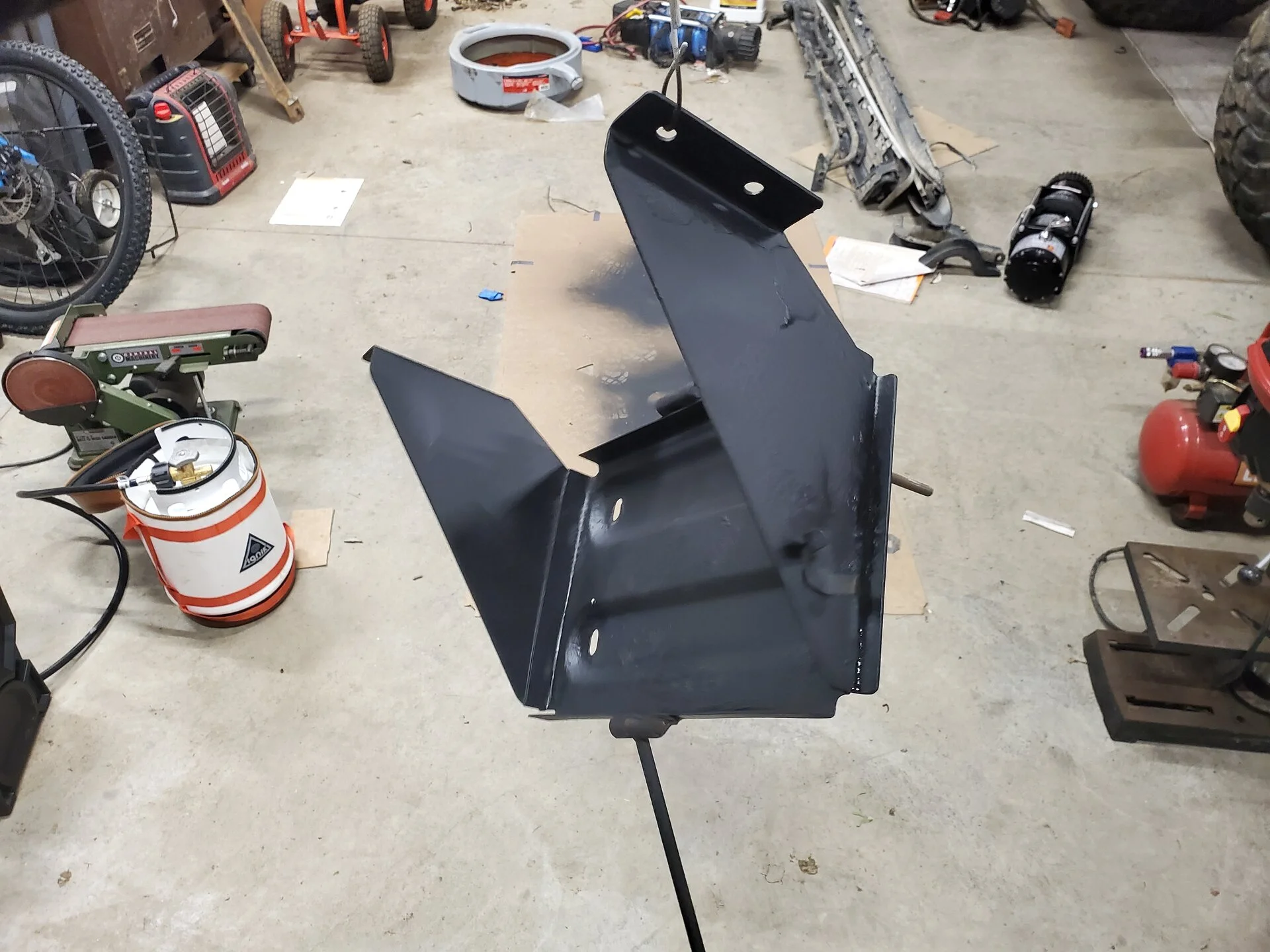

Today I pulled the box off the fender and hit it with the wire wheel and a little 150 grit and then put a coat of primer on it.
Now I need to make new + and - cables and get the battery back in. And clean up the fender a little.
The positive cable is about 6' too long and it needs new terminals. After I finish this I'm gonna do a little investigating on the charging system.

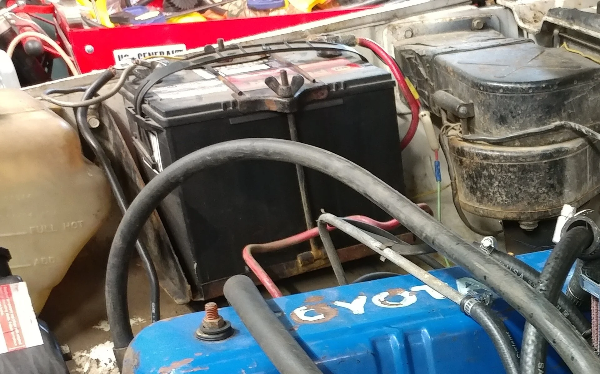

Long bolt for the retainer on top of the battery fits in those slots. Adjustable, I guess, for battery size. My '73 body has 'em.
^^ What he said
Not sure why there are 2 slots unless there is a different box made because to use the other slot I would have to make a new mount since mine are the ones that pivot but are in a hinge on the box.

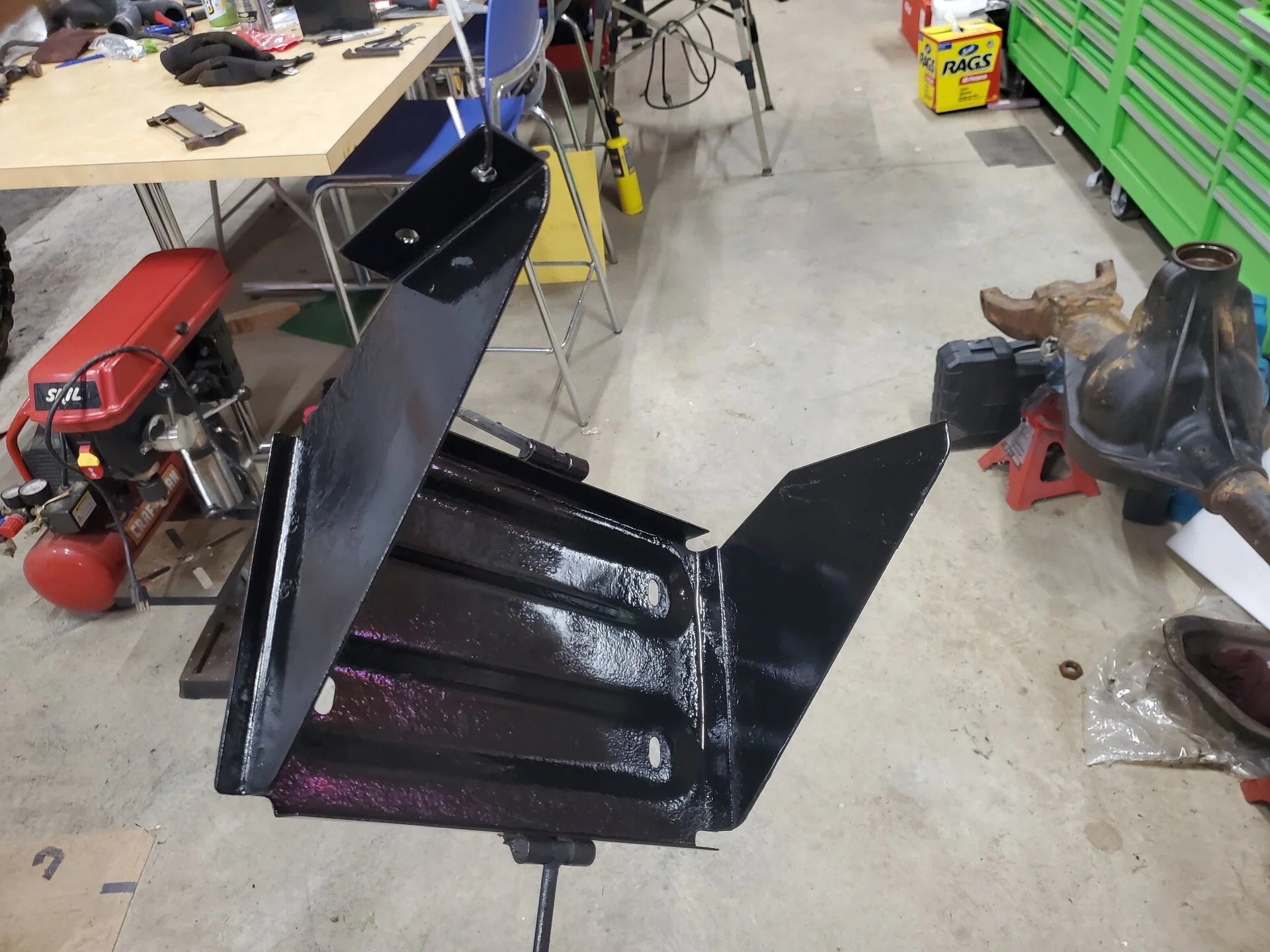

Put a coat of gloss black on the tray.

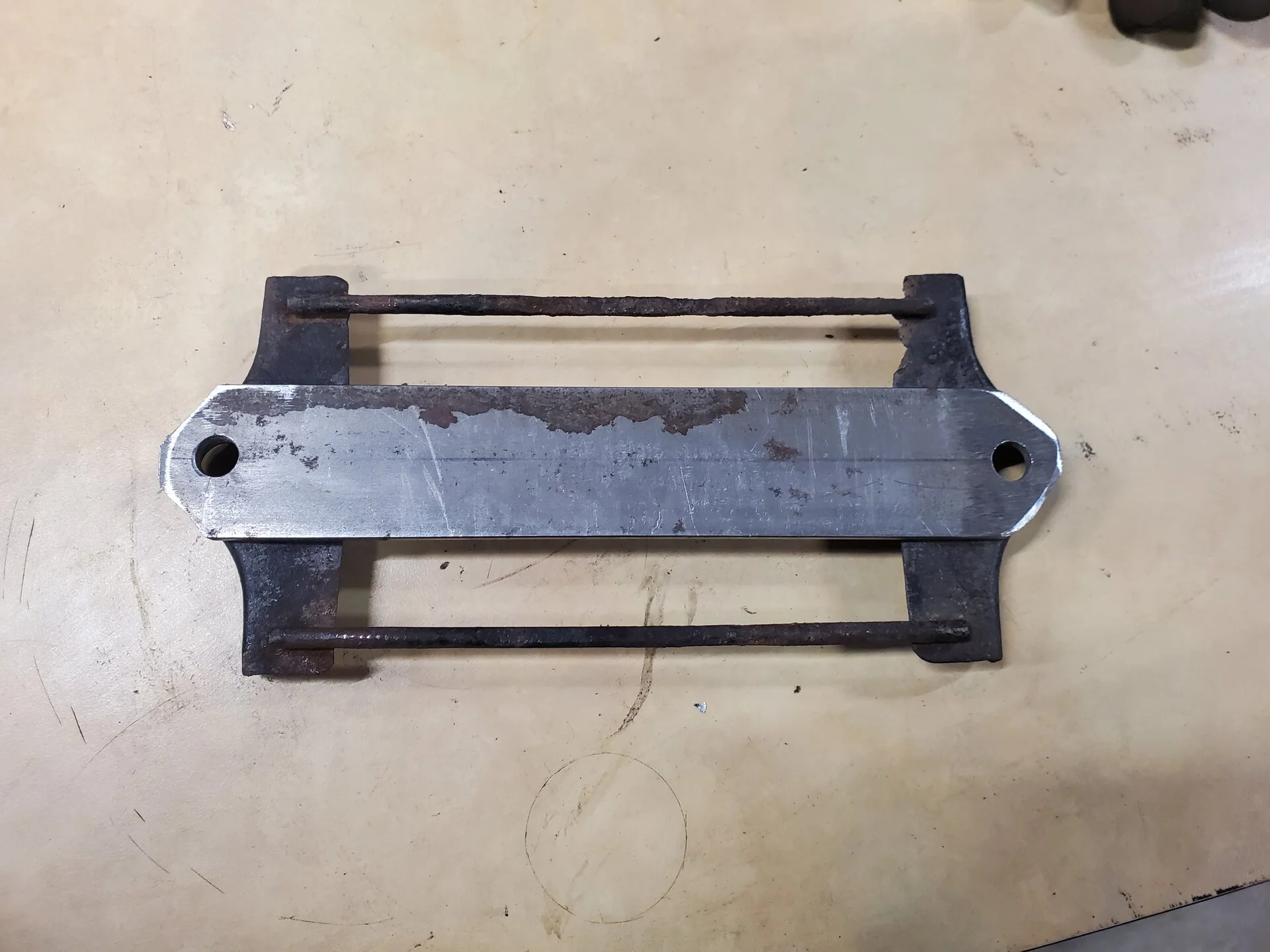

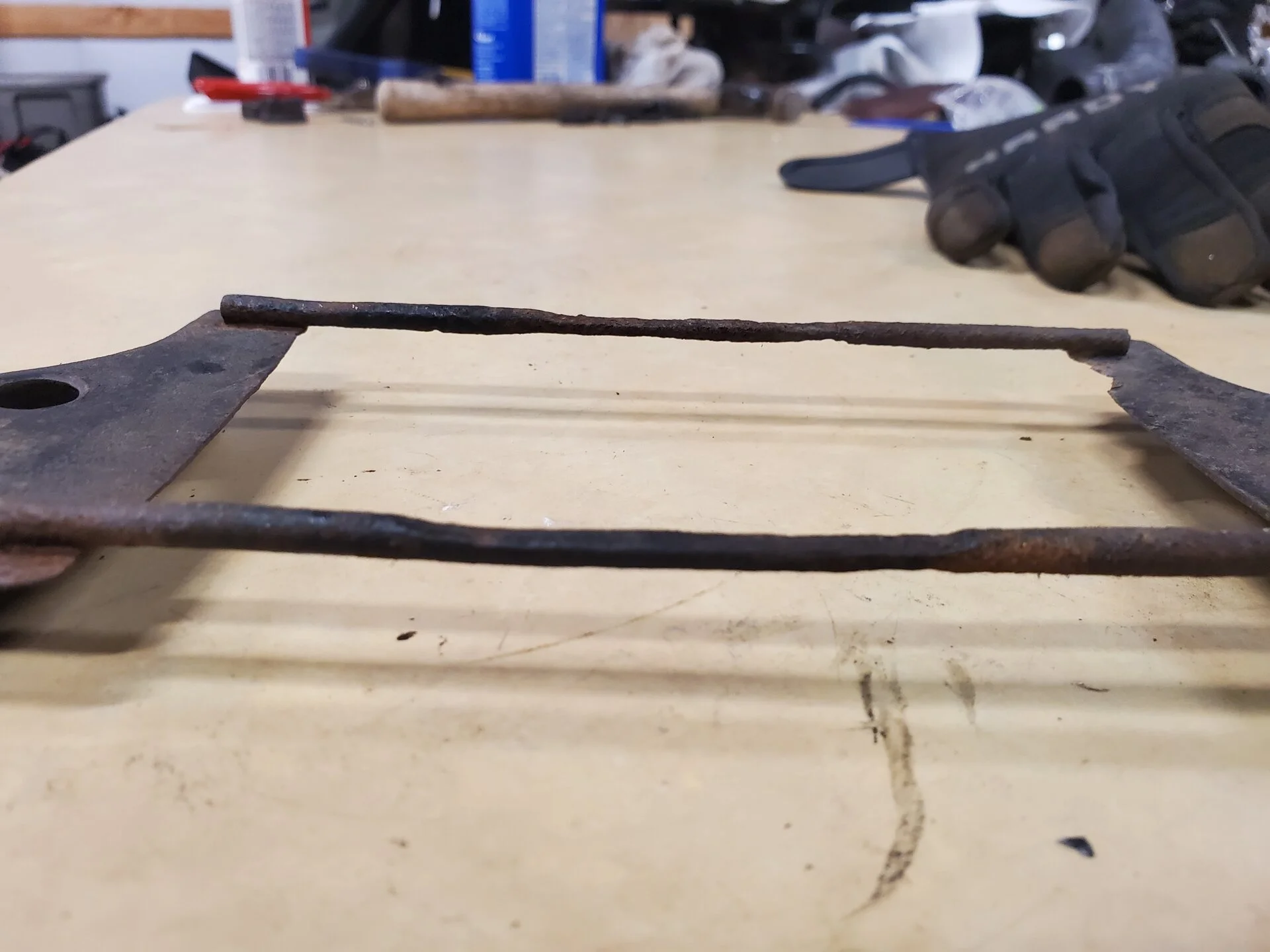

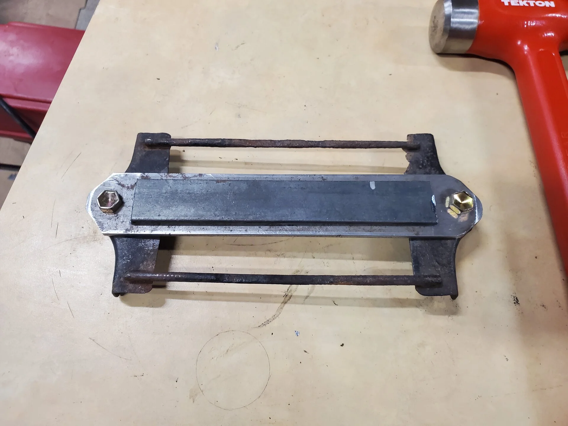

Then started to clean up the hold down. No idea if this is the oe top, but the little connectors are a little corroded, so cut a piece of flat bar to reinforce it.
If I feel froggy, I might add this bar to the top.
Probably won't get to the welder til this weekend, but we'll see how it goes.
Depending on the Batt you choose that strap will interfere with the cell caps?
It actually goes across the short distance.
Old picture, but you can see it goes across the battery, not long ways.
Should be ok.
