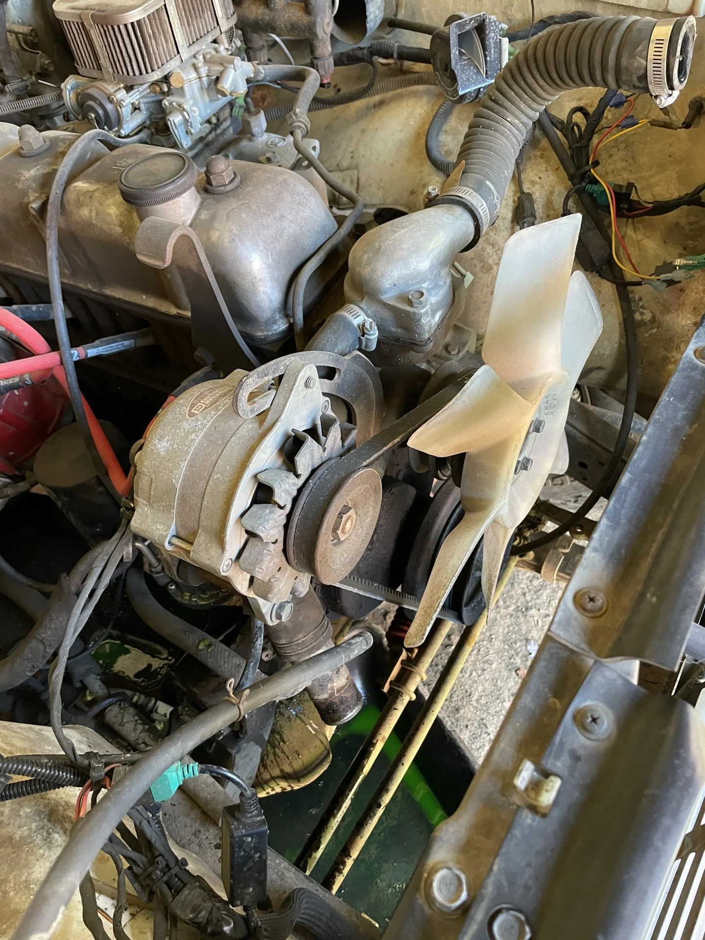

It had been a few years since I changed a water pump and the last one I did was in a 60. Realized quickly that in order to do this job without cursing too much the radiator was gonna have to come out. So out it came.

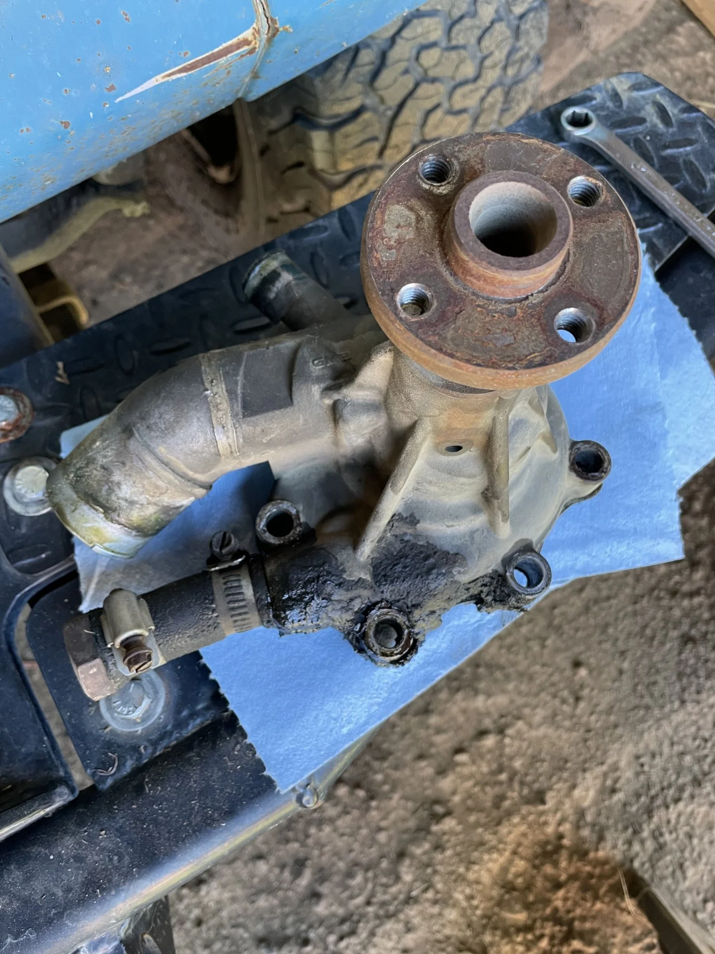

The old water pump looked pretty nasty. Nice little plug in the line that I’m assuming used to go to an oil cooler? If that is in fact the case I’ll be putting an oil cooler back on Marge when I get rid of the monstrosity of a distributor that’s currently in her and go back to OEM. Yes I’m a Toyota purist. If I can get OEM the OEM will be used on Marge.

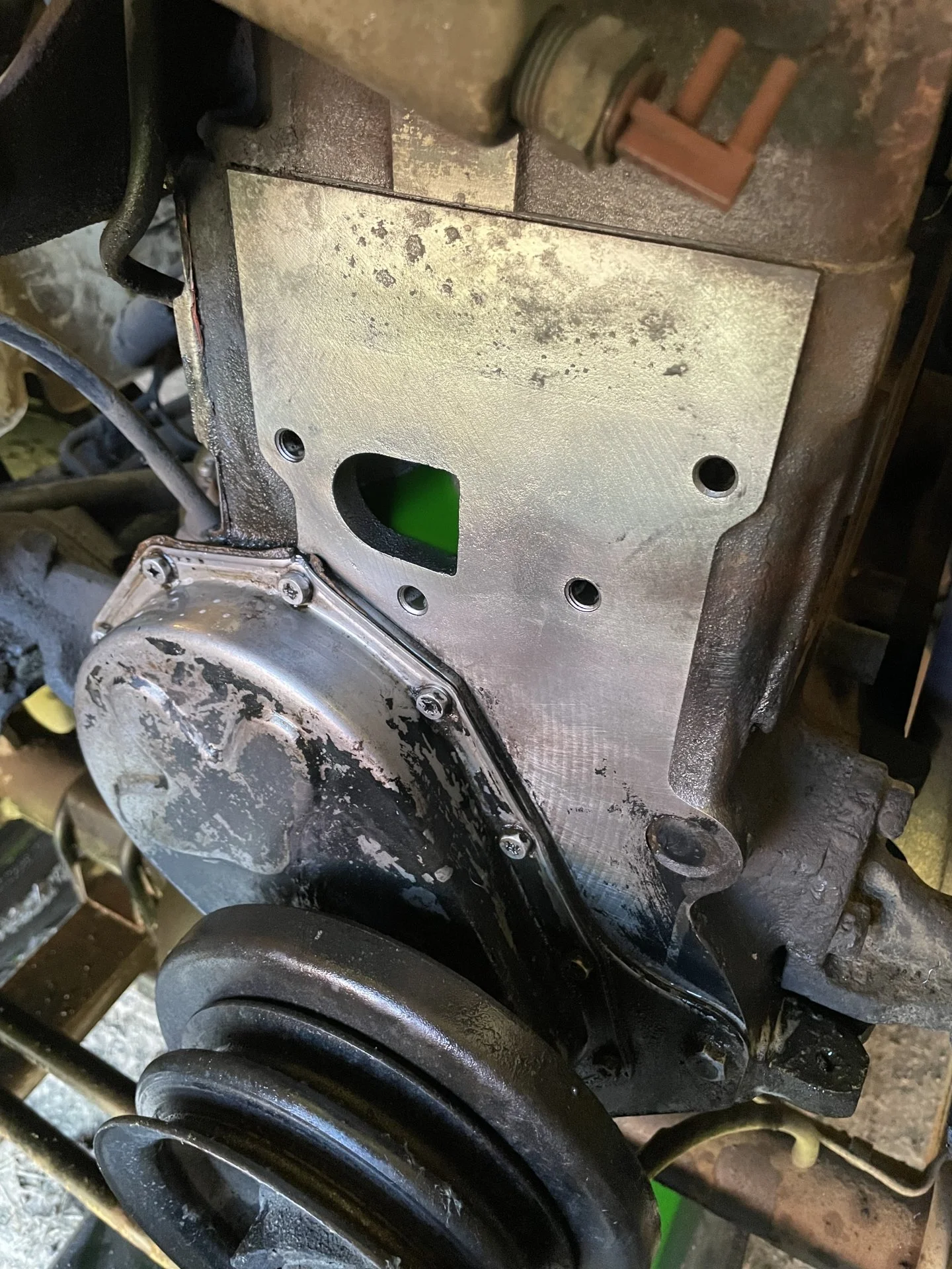

I couldn’t not clean everything up the best I could so I got to spraying, scraping and wire wheeling as best I could.
Looked a lot better when I was done.
thanks to cruiser outfitters for the new pump, city racer for the bolt kit and my kinda local Toyota parts guys for the gaskets and form in place gasket juice.

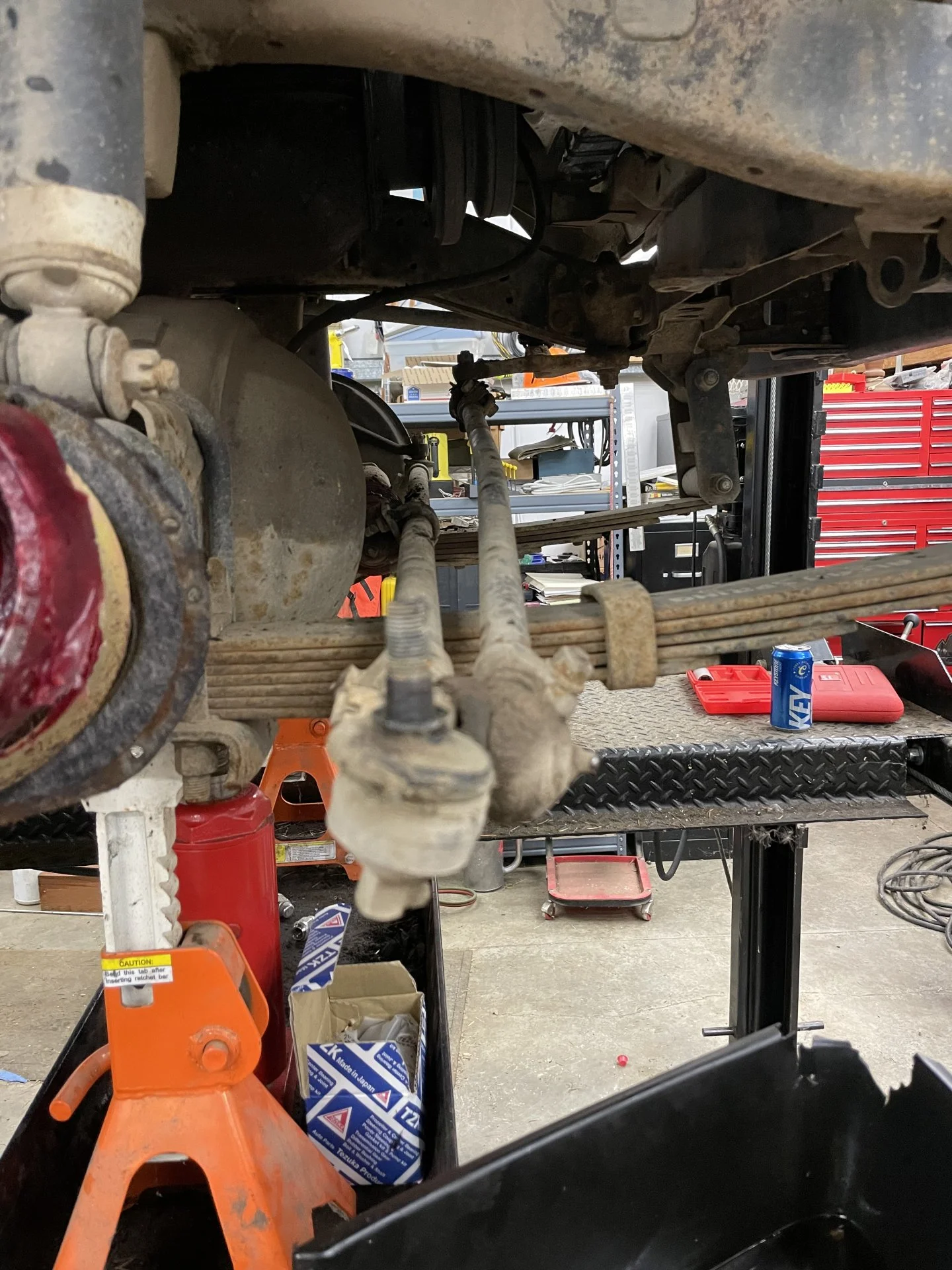

First up total steering refresh. Decided to start out with the Ol’ knuckle rebuild. Man I forgot how nasty this job was…
Noticed this not normal angle when I got to looking up Marge’s skirt. Glad I got a new one sitting in the shop!
Had a blast wrenching again. Can’t wait to drive her with the steering all tightened up!
