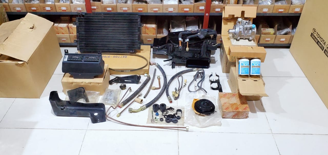

251:
Correct! @WarDamnEagle. @PabloCruise I read through your posts on AC and decided I may as well just pull the trigger on an entire setup rather than try and piece one together. I plan on driving up to 4 hours maybe a bit longer to camp starting in a couple months and AC is going to make it much more comfortable when the temps start to rise. I think I have officially exceeded the 5K build limit….
