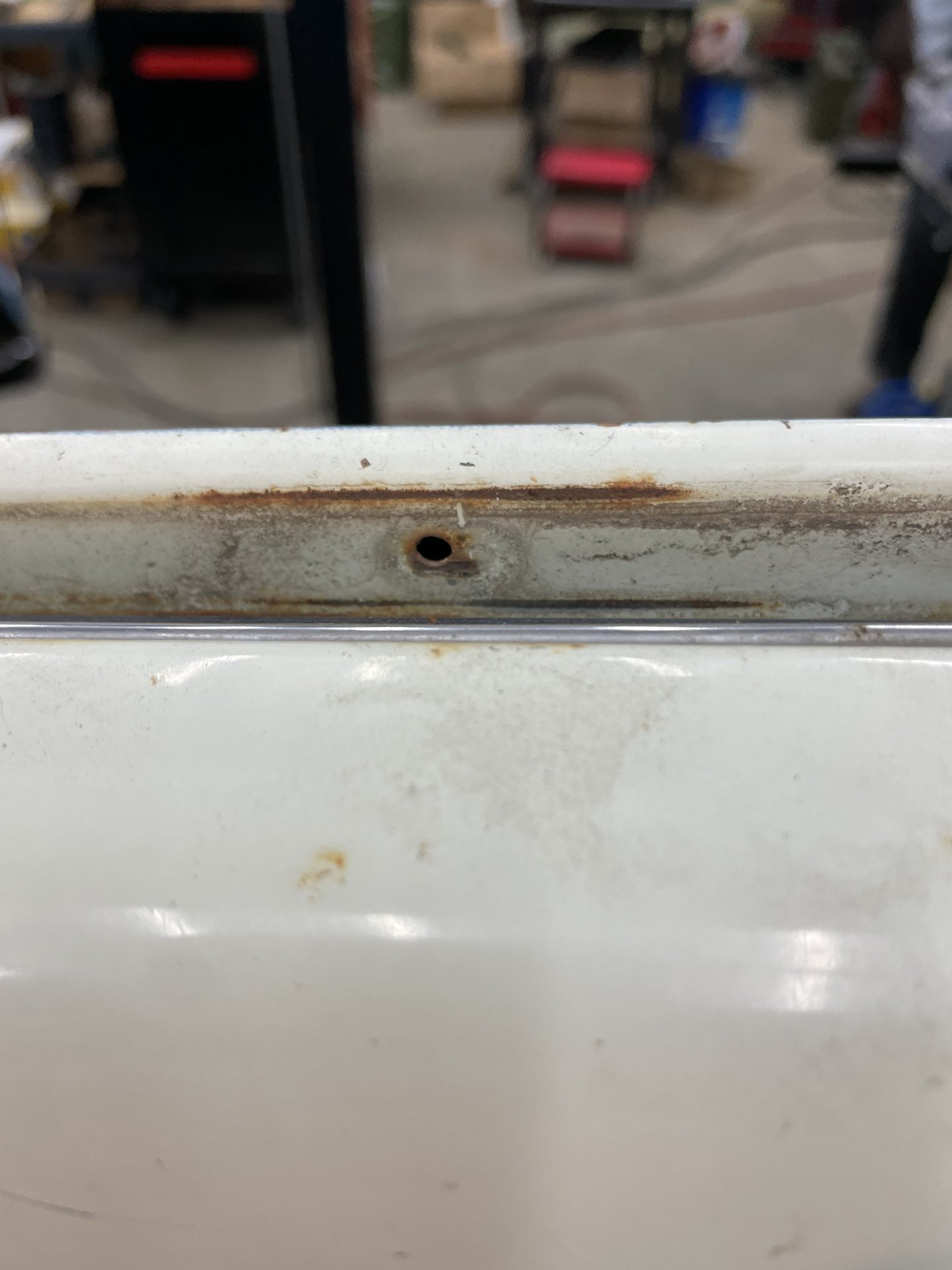

Took out the piece of metal in the door that used to have the window squeegee/felt attached to it. Gonna give Steele Rubber Products a call Monday and see if @NikP parts numbers are still good # 70-3804-61 Outer Beltline and 70-0961-60 Weatherstrip Beltline from Steele Rubber Products.
Nik if you are still around the sty can you comment on which part number you used for the outside? I’m assuming “outer” is for the outside and one the inside?
Also has anyone found replacements for the metal clips?

Yep, the outer beltline part number glues to the outside of the door panel. Mine are still holding up and haven't come loose.
