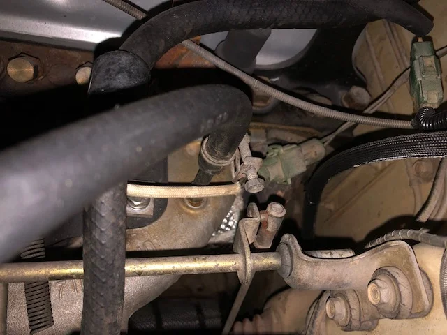

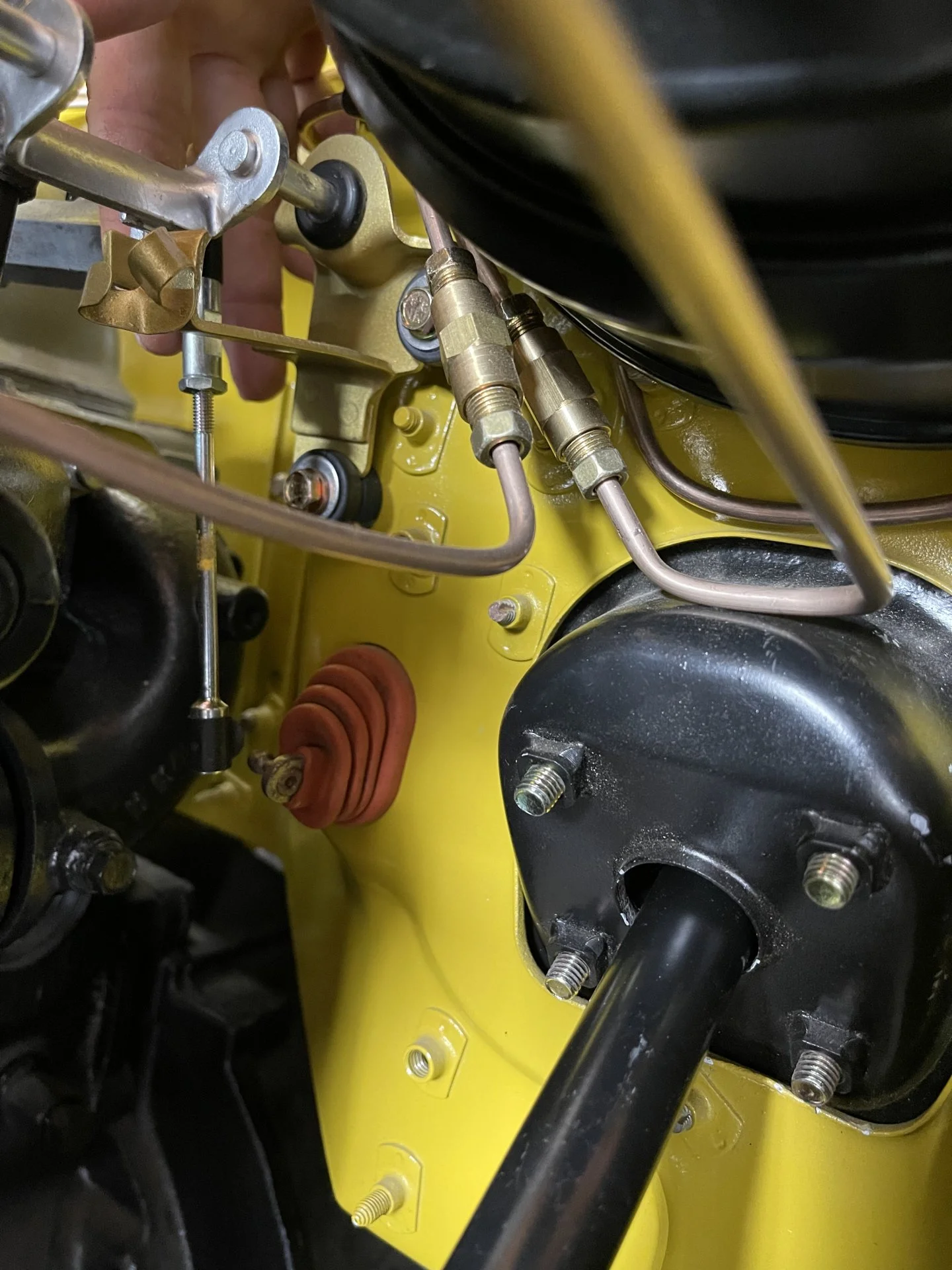

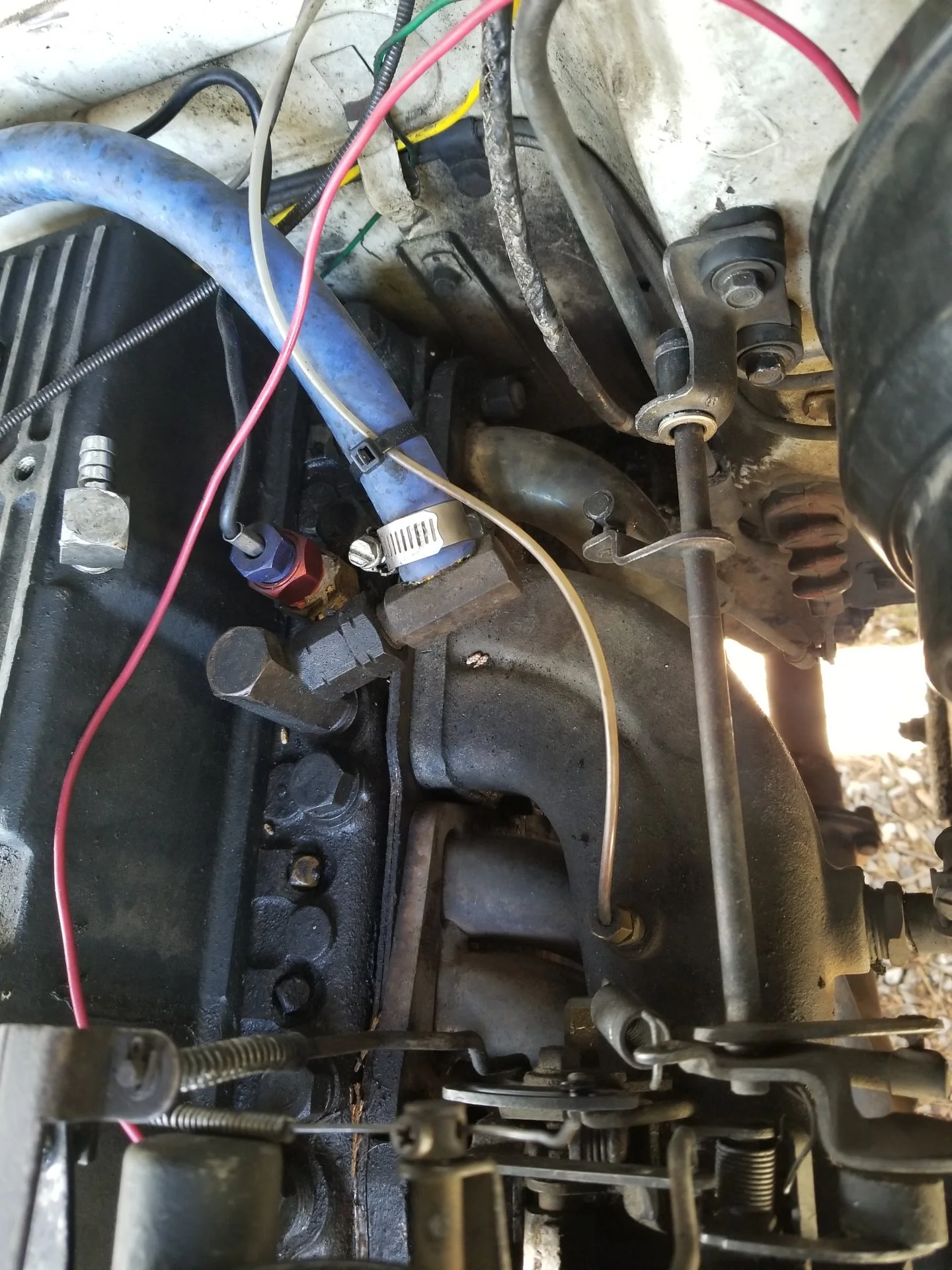

Thanks for all the help guys. @bobm here is an overhead shot of how that attaches.
The rod from pedal to firewall pivot point is a skunk works custom repop. I believe all of the other linkage is original OEM.
Everyone, as usual the mud community have again proven to be rock stars. Thank you for all the parts offers! Matt and I are working to figure out what the heck is going on. Multiple theories and I’m positive we’ll find a solution. Marge ain’t my daily driver so not pressed for time. My only hope (other than getting this right) is that this will help out another 55 owner if they go down the path of going back to an OEM carb and linkage setup.

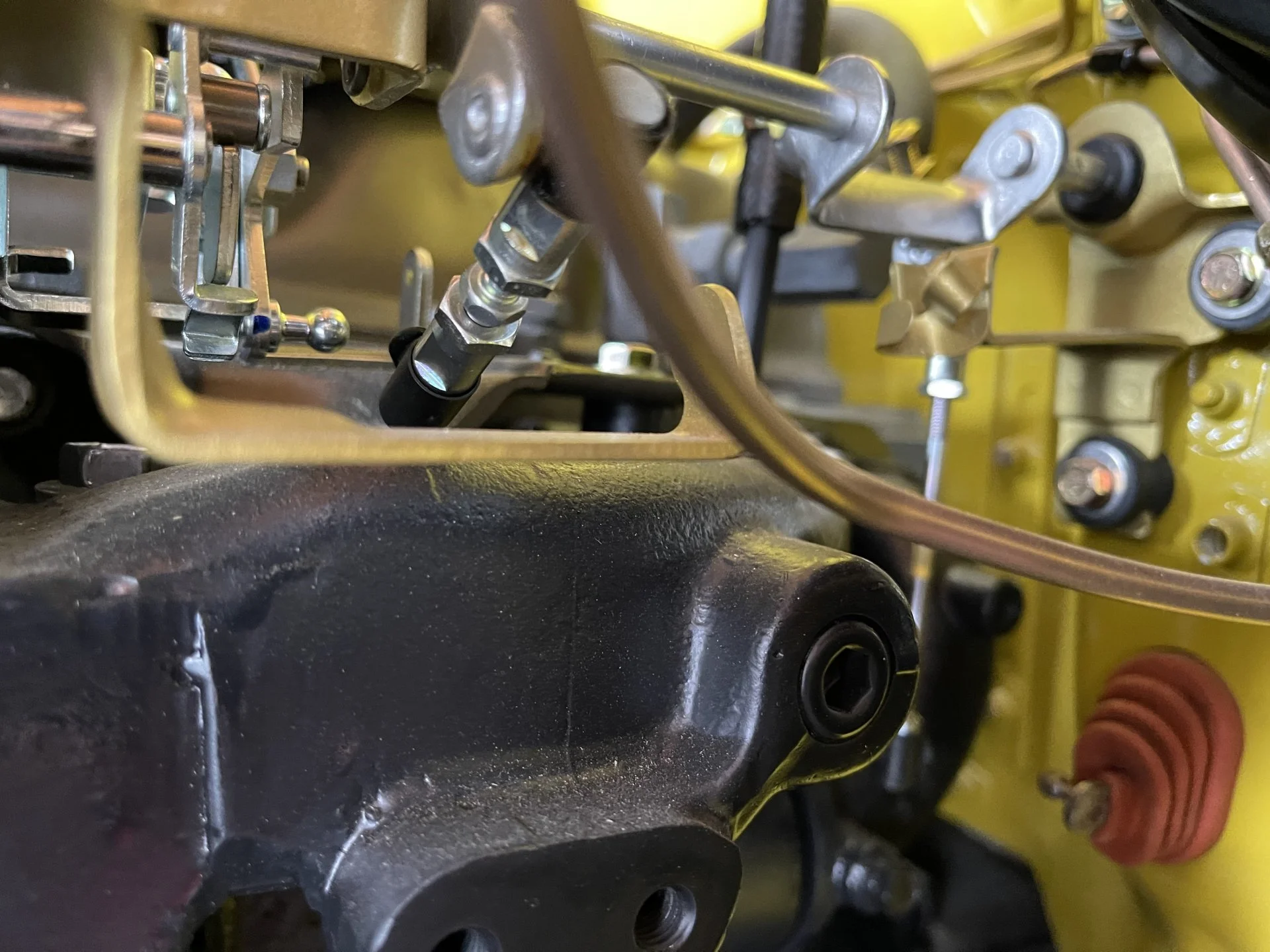

So I will chime in with my .02
If this was my issue I would take the linkage off, and at this spot here, I would grind that inside nub off the shaft where it goes through that bent section and pull the shaft out. Then I’d reinstall everything and get it setup in the ideal spot that satisfies every little function, mark the shaft in two spots, remove it and weld it.
Done.

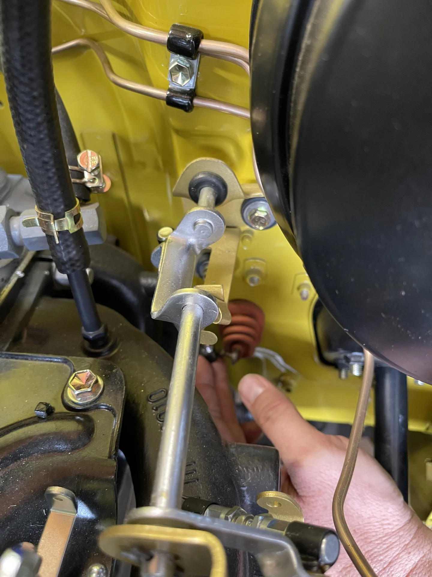

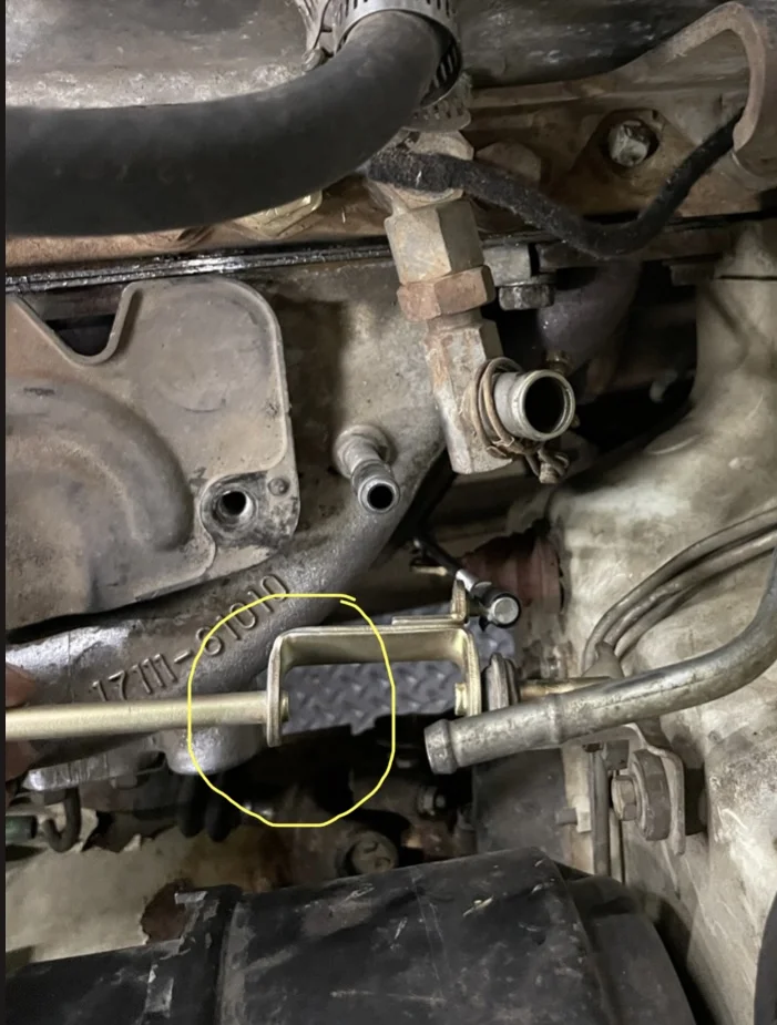

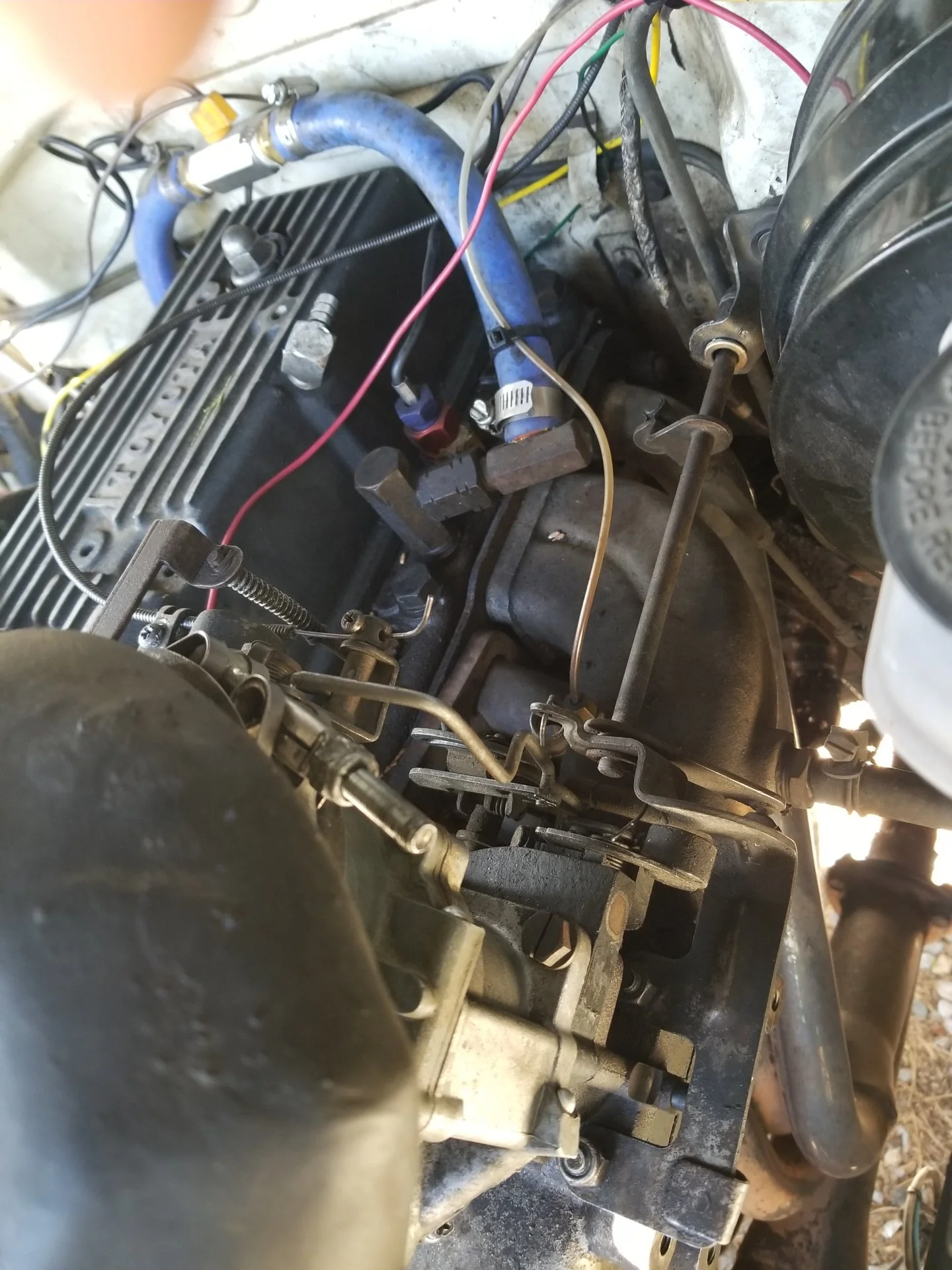

Ok moved the vertical rod that attaches pedal to the pivot point on the firewall from the driver side to the passenger side. No dice. The entire linkage is still to long to fit on the carb studs. I’m out of ideas.
1. This rod is too long.
2. Manifold is wrong for this year/setup? The part number of the manifold is 17111-61010. Production date of 55 is Nov 77’.
3. I have no idea 🤣

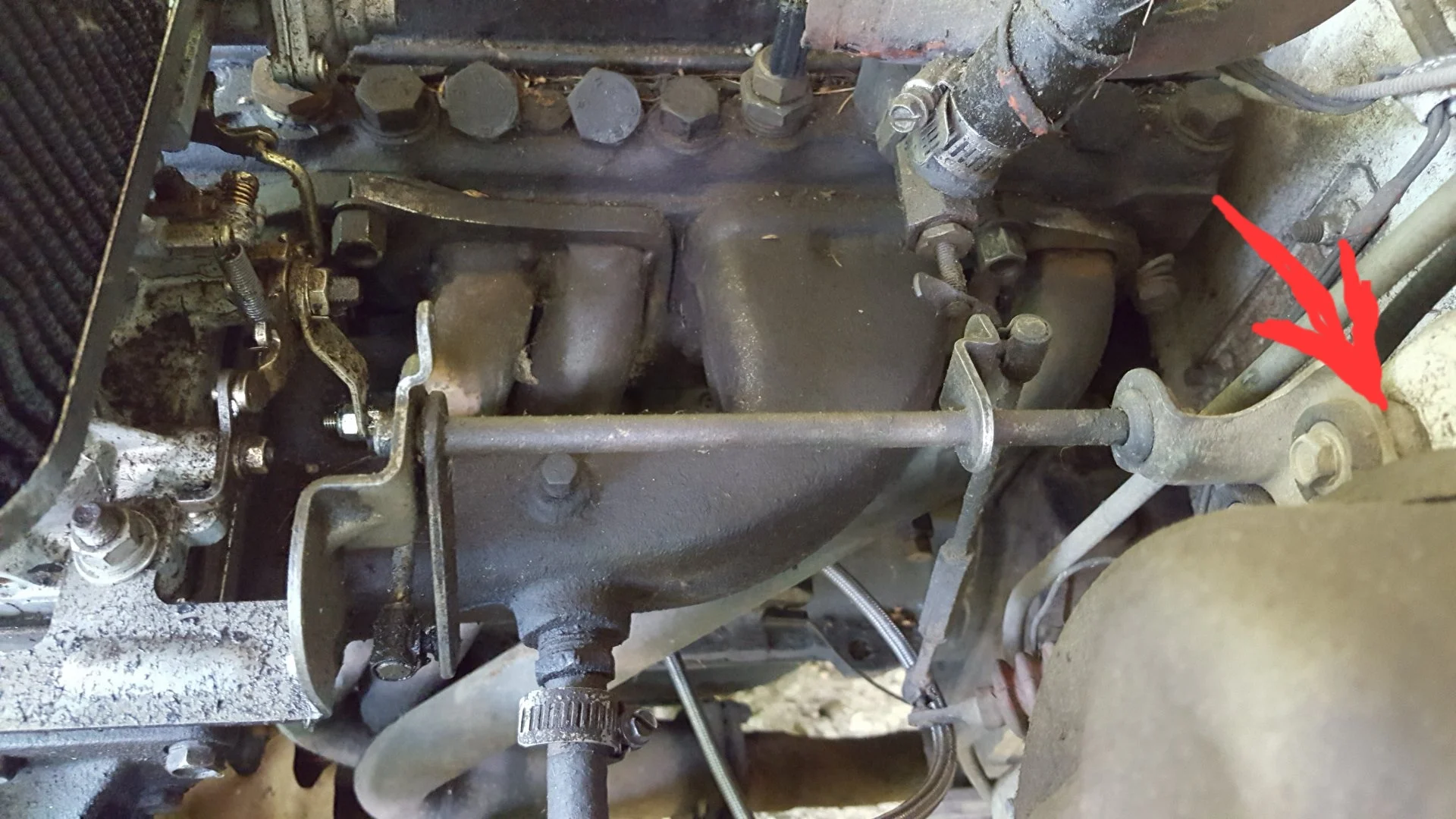

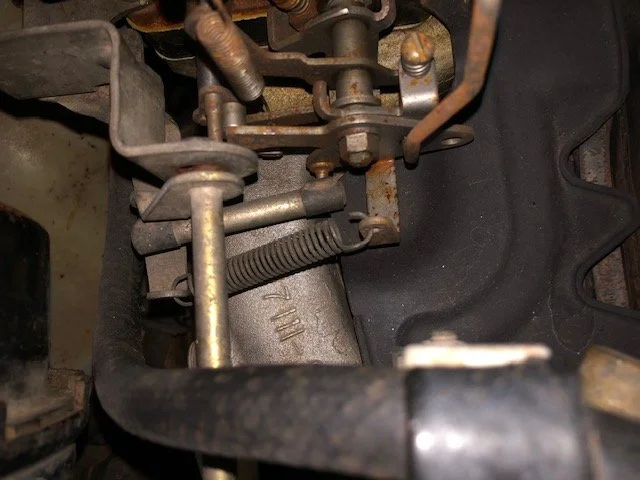

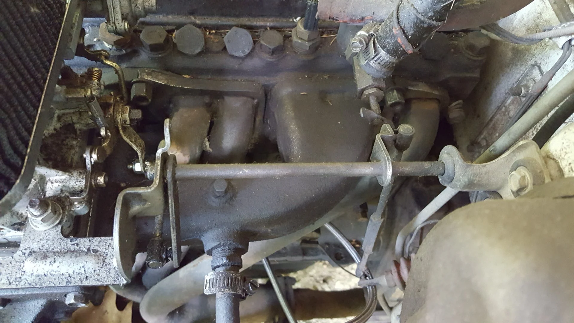

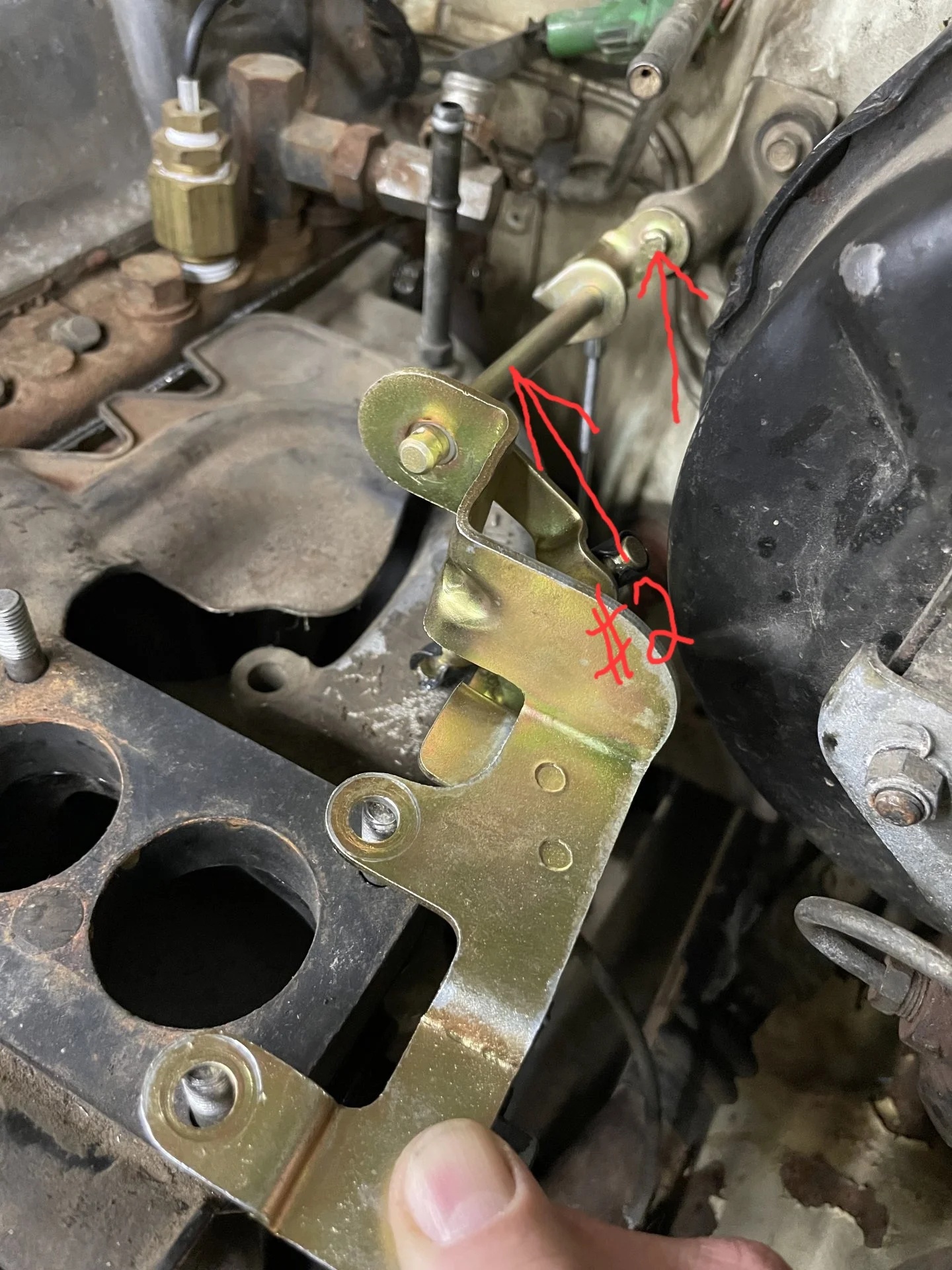

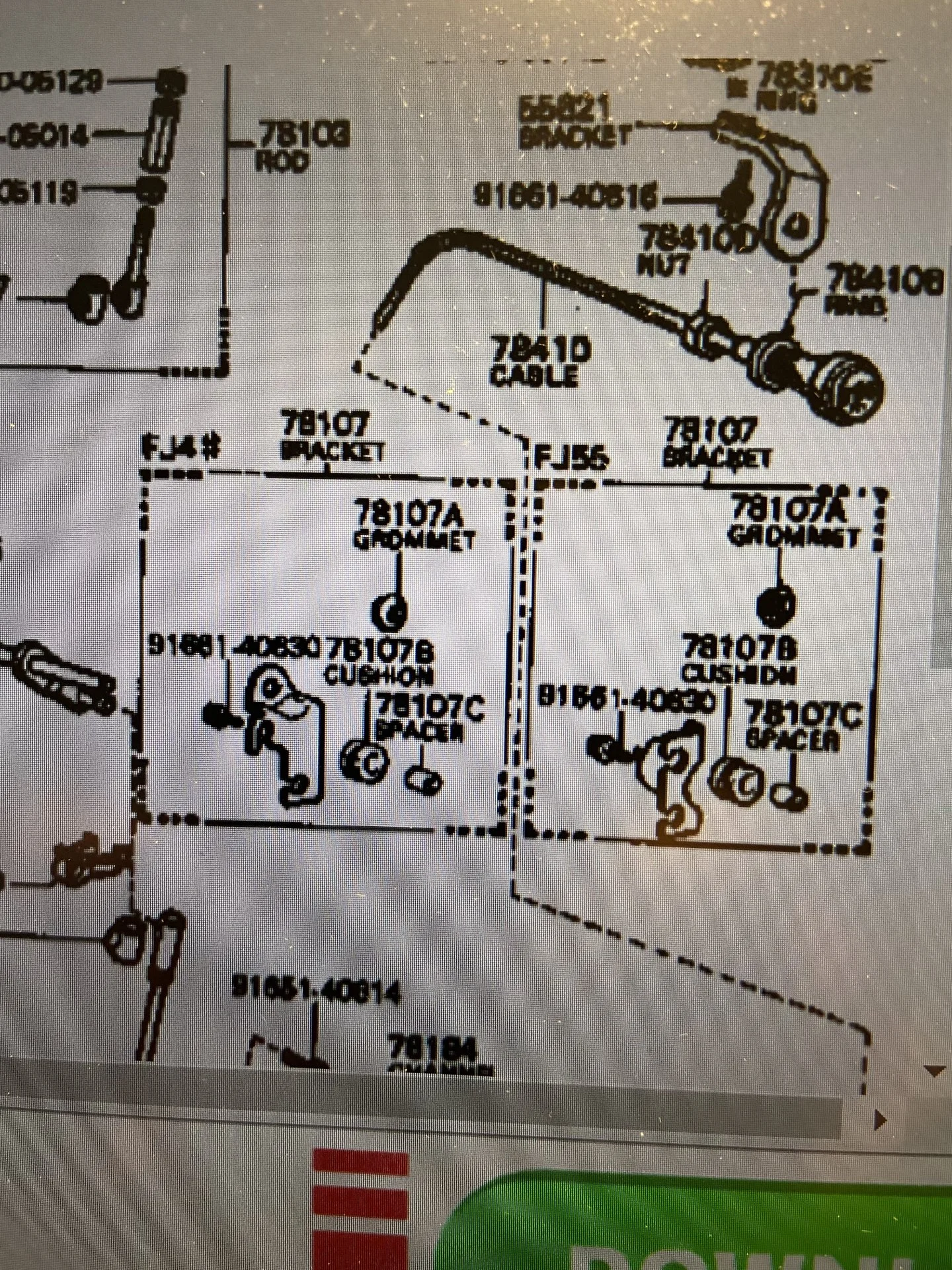

So maybe this information will. The parts diagrams show different brackets for FJ4x vs FJ55. The 55 part appears to be thinner overall which would make up for the room that you are needing. I haven't figured out how to effectively cut and paste these diagrams so here's a photo:

PLEASE DO NOT cut and weld here in any way shape or form !
that approach is a 1 way ticket to a very very dangerous situation , imagine stepping on the gas and letting off the gas peddle only to find out fast a 78 FJ55 will not stop
and we can all imagine was happens next !
NO WAY !
i will SKUNK-WORKS and T-TEN out this matter with @jestlurnin using UN-MODIFIED OEM TOYOTA Genuine Parts
- there is one single un-known right now , and when him and i know what that is , we will report back .......
- i have never seen this or come across it before even in the slightest ?
- so a careful study begins to confirm and verify tech spec data , and using a focus points approach one by one eliminate the possible causes = finding the cause
SAFTEY is JOB 1 here and nothing supersedes that when i am involved ,
thanks for your understanding here
matt 😇

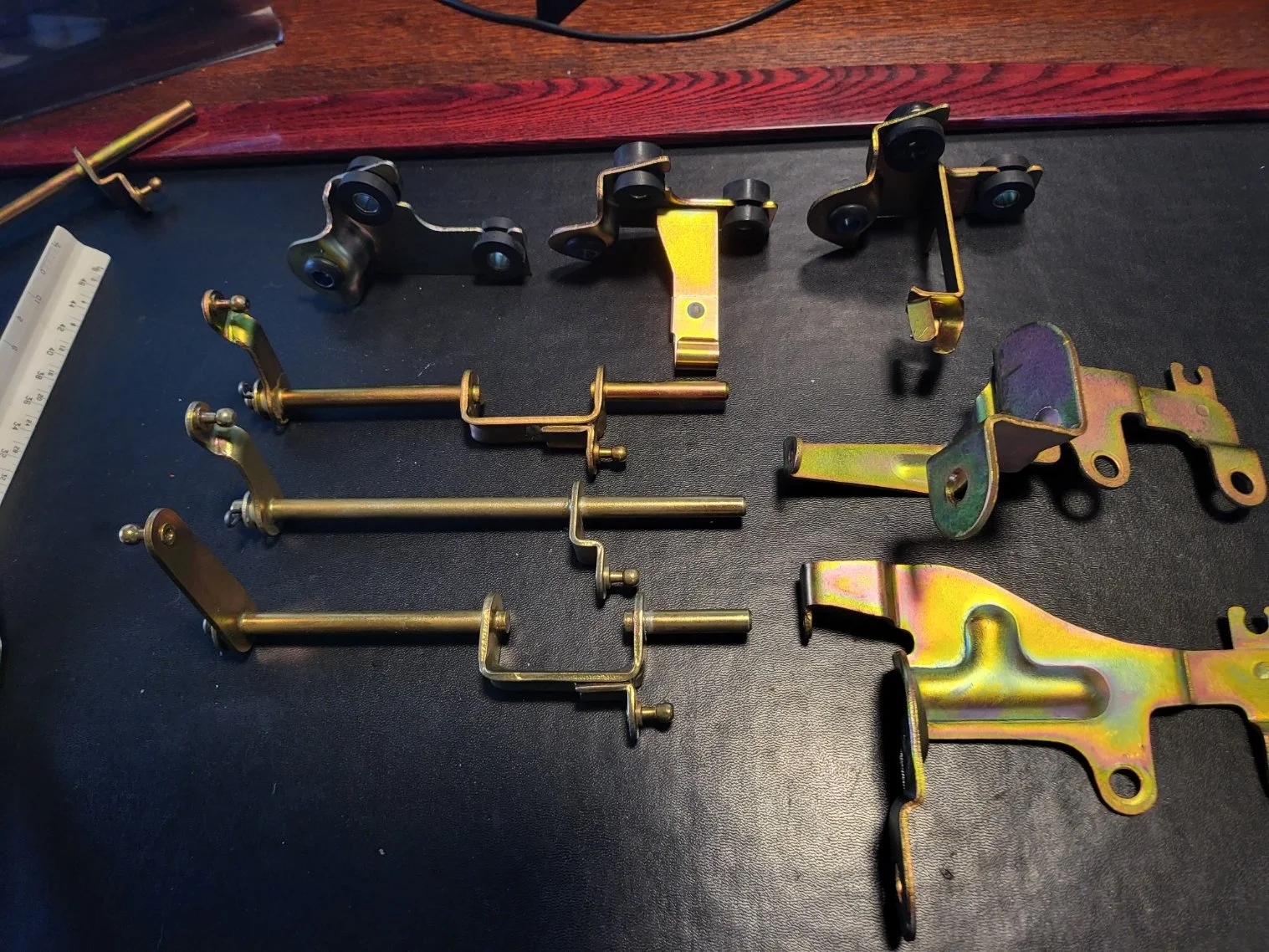

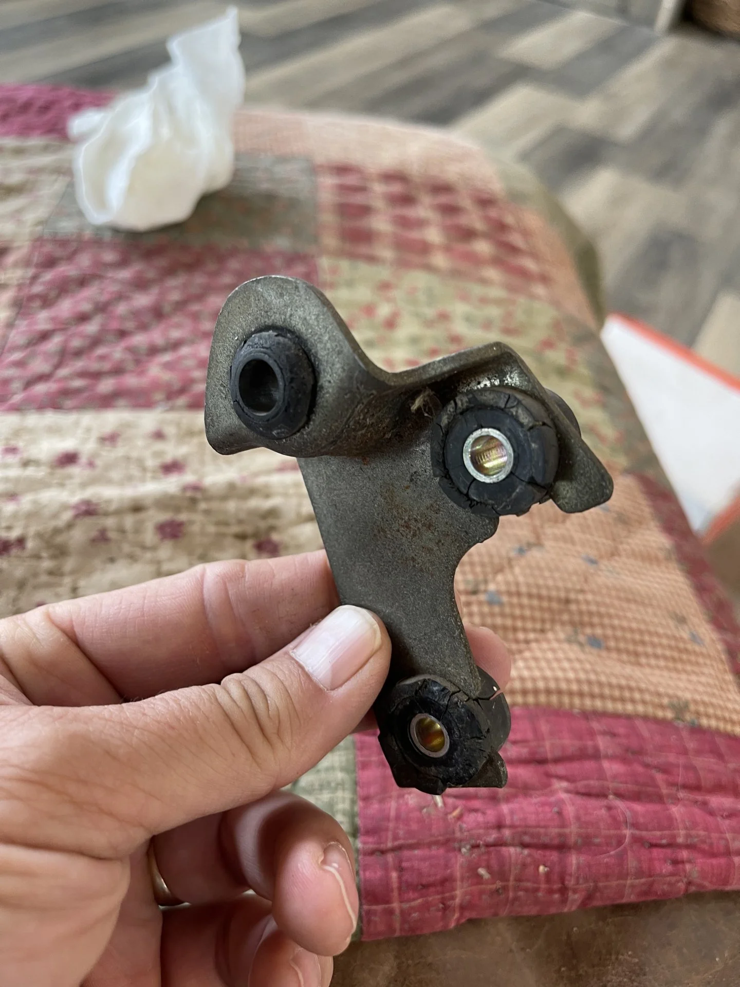

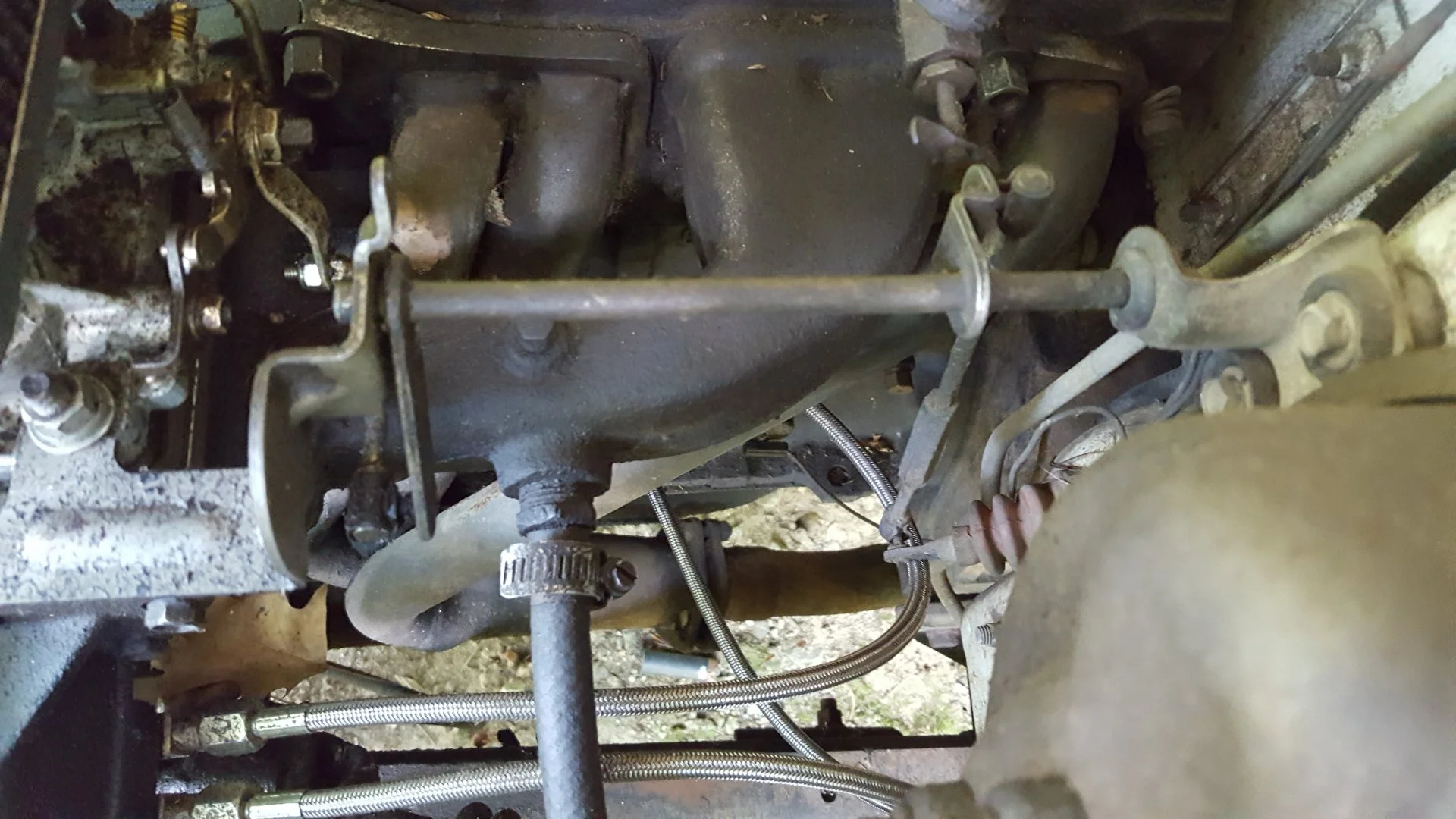

Not sure if this helps, and I have not done the research to see which go to which vehicle, but there are differences, pretty sure these are FJ40's though, but I could be mistaken.
