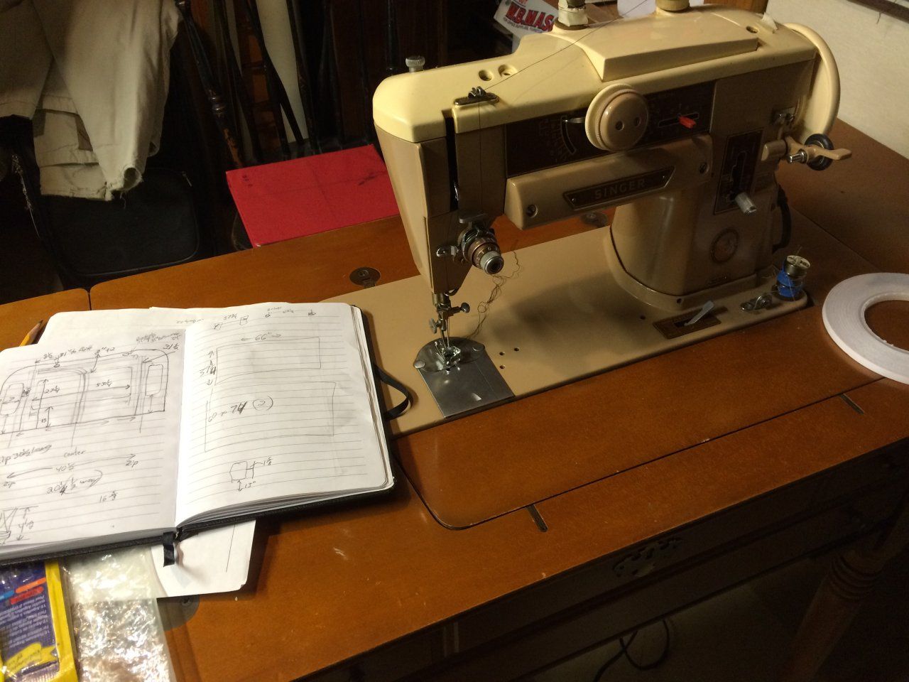

I've had some of the same issues - no two batches of canvas are the same . I've ran the T70 thread through my old 1955 Singer model 66 with an 18 size needle - it ran it pretty good but sure complained about it , finally knocking it out of time a little which is easily fixed . Screwed up big time a few weeks ago and missed a deal on a Sailright II for $500 , still mad about that one . Picked up a slant-head 500A Singer Rocketeer - might try it with some light canvas work as it seems to have more punching and feeding power but in all honesty a walking foot is the only way to go . Just don't have the room here for now . I did finish my recovery strap toss bag like the one offered from that internet company out West - it turned out nice and works great !

@Weber Sarge the slant needle singers seem to have an issue with going into webbing correctly and bite the webbing slanting the needle too far slamming the needle into the plate... I had recently done this on my 401a
They have plenty of power that's for sure... I broke two needle plates lol
I have a third coming in the mail as we speak... Straight stitchers are better at the webbing (if your stitching thru multiple layers of webbing like I was doing)
I have welded the two plates that I have and one I created a heavier duty straight stitch plate but groved the front to compensate for the 18 needle bending... It's better but ... Still an issue ... A size 19 needle is a tight fit (had to sand down the shank to make it fit) and has helped a bit as well

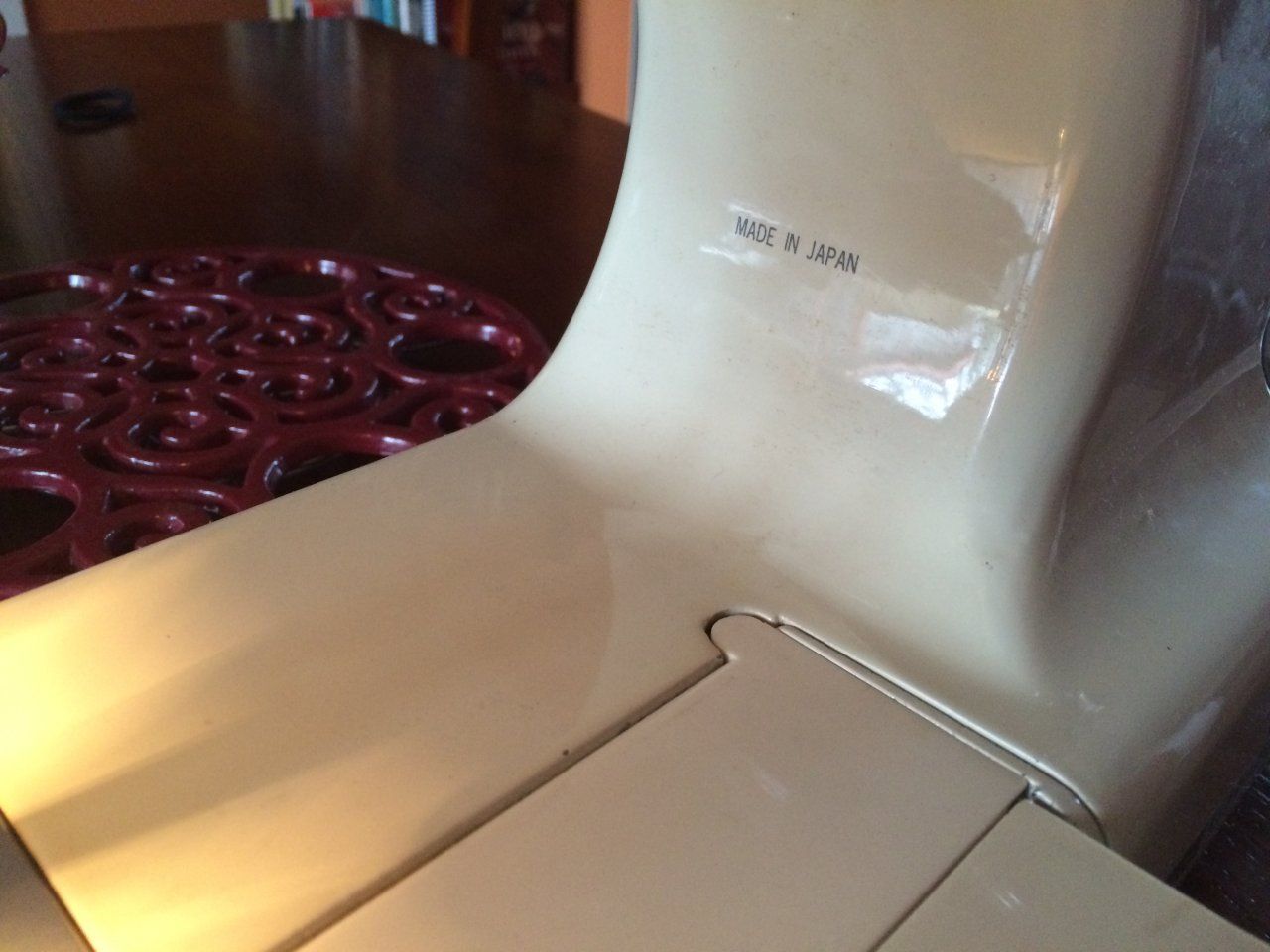

Recently picked up a portable machine for my daughters birthday... Can you guess who made the internals of her machine? Lol
Thanks for the welcome JonnyC, nice machine....I initially tried to use my home Kenmore machine, was breaking needles all the time, even the ones rated for jeans, also bought a cheap walking foot adapter, lasted about a day...

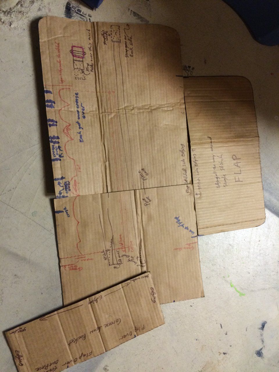

Here are what I used for cutouts, my templates.....The slots in the card board mark position on the canvas for the straps and pockets, see next pic, much faster than measuring each strap and pocket,

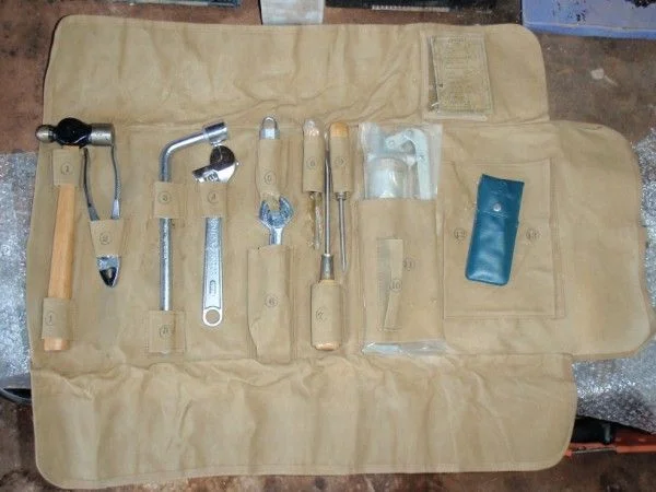

I guess I need to also explain which tool rolls I am making, the first is the standard one with straps and pockets, I had to borrow the pic,

Believe it or not the medium tool roll is a more versatile tool roll

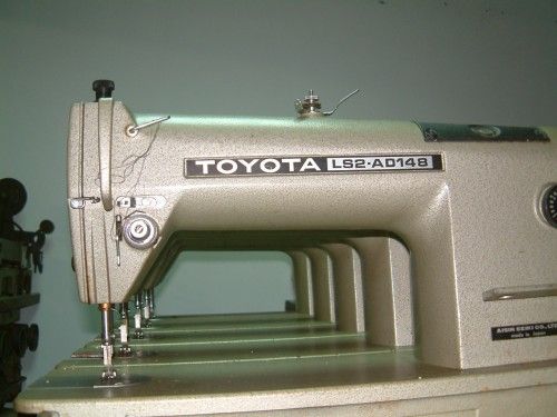

Have any of you used the older Toyota machines ? I can't remember the model now , but some marine sewing guys seek a certain one out for doing canvas and it does do several stitch types with a walking foot if I remember ....
Sarge
I have not used the toyota... however one lady in the guild had a Morse at one time... and said it was a 'wonderful' machine
'very' heavy

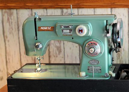

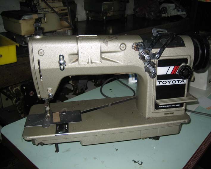

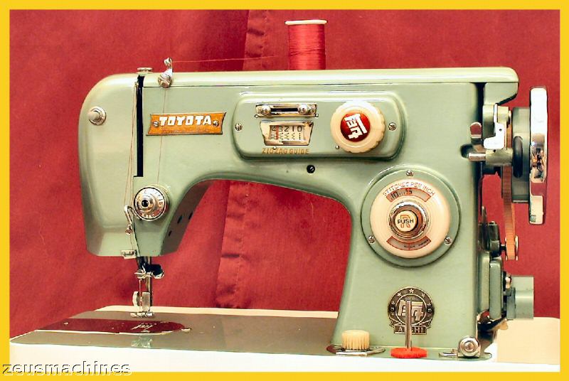

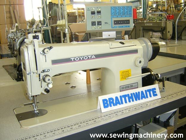

the Morse is Toyota
newer morse: About Us
here is a pic of the Toyota and Morse... you can find Morse machines all day long at a decent price ... there are plenty of industrial toyota as well .... i also hear GREAT things about them... heres a pic of a few as well
'very' heavy
the Morse is Toyota
