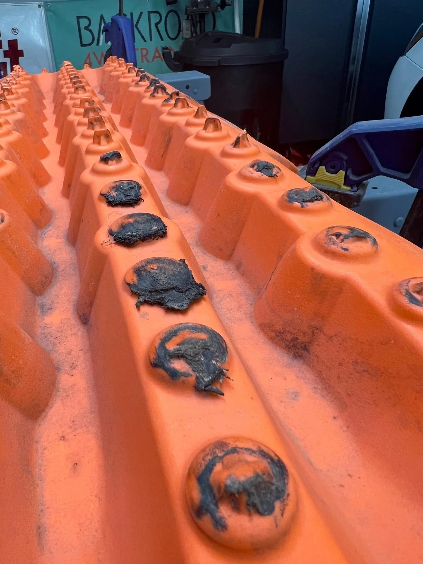

The past few years training has been hard on my Maxtrax. The traction teeth have melted off two of the 4. Maxtrax makes replacement teeth for the extreme boards and figured these were no longer under warranty so I would try to get a little more life out of them.

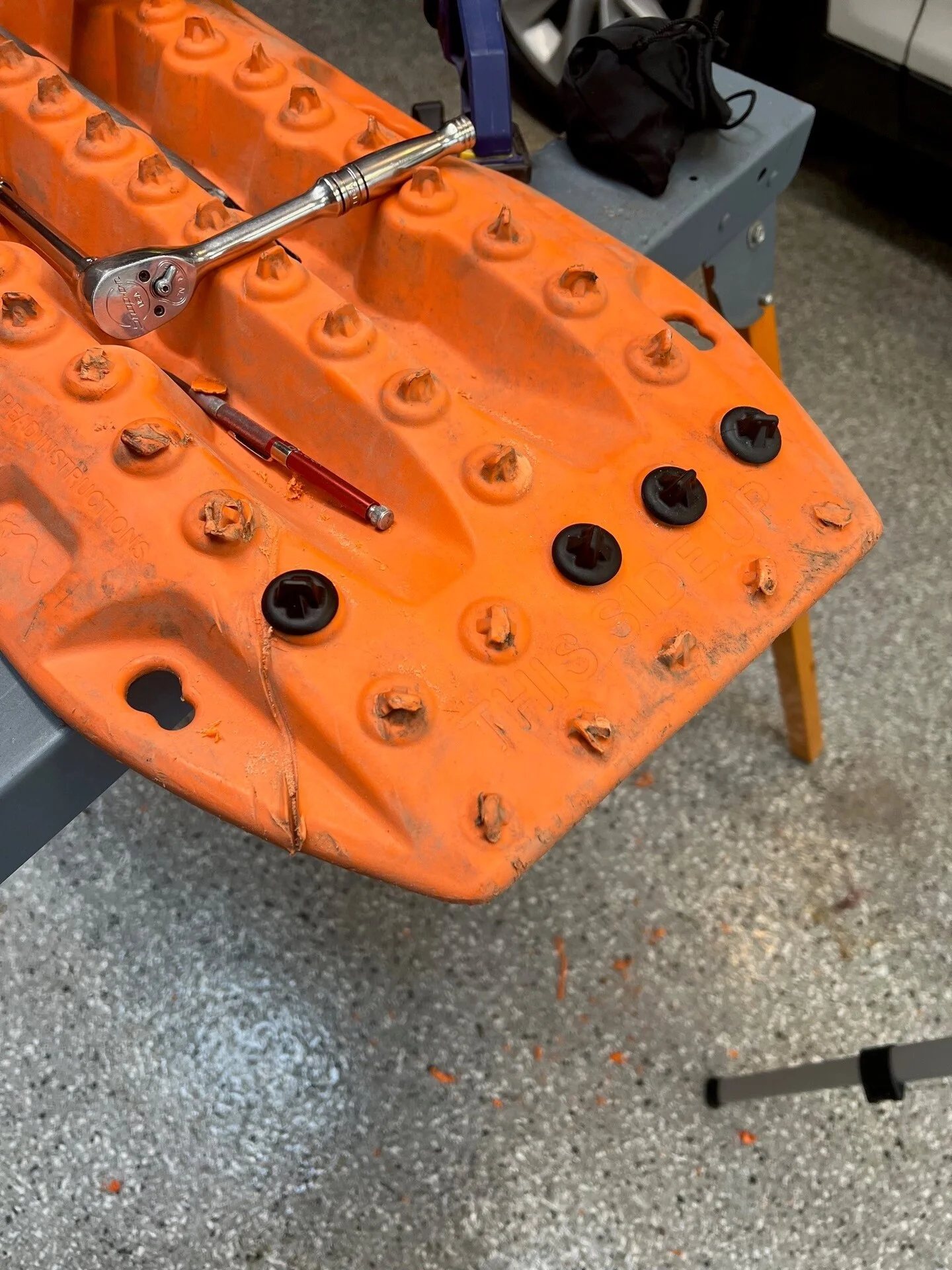

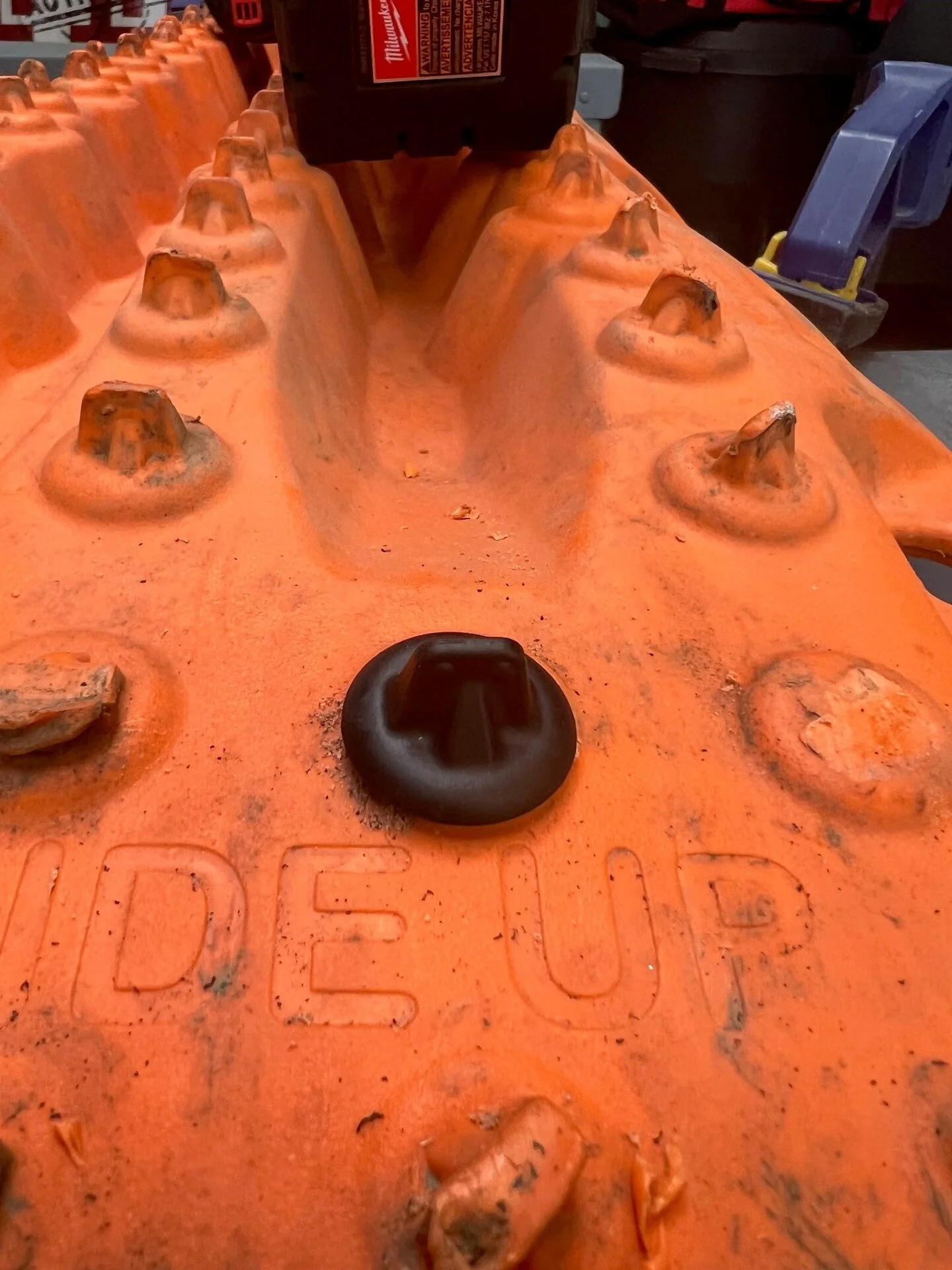

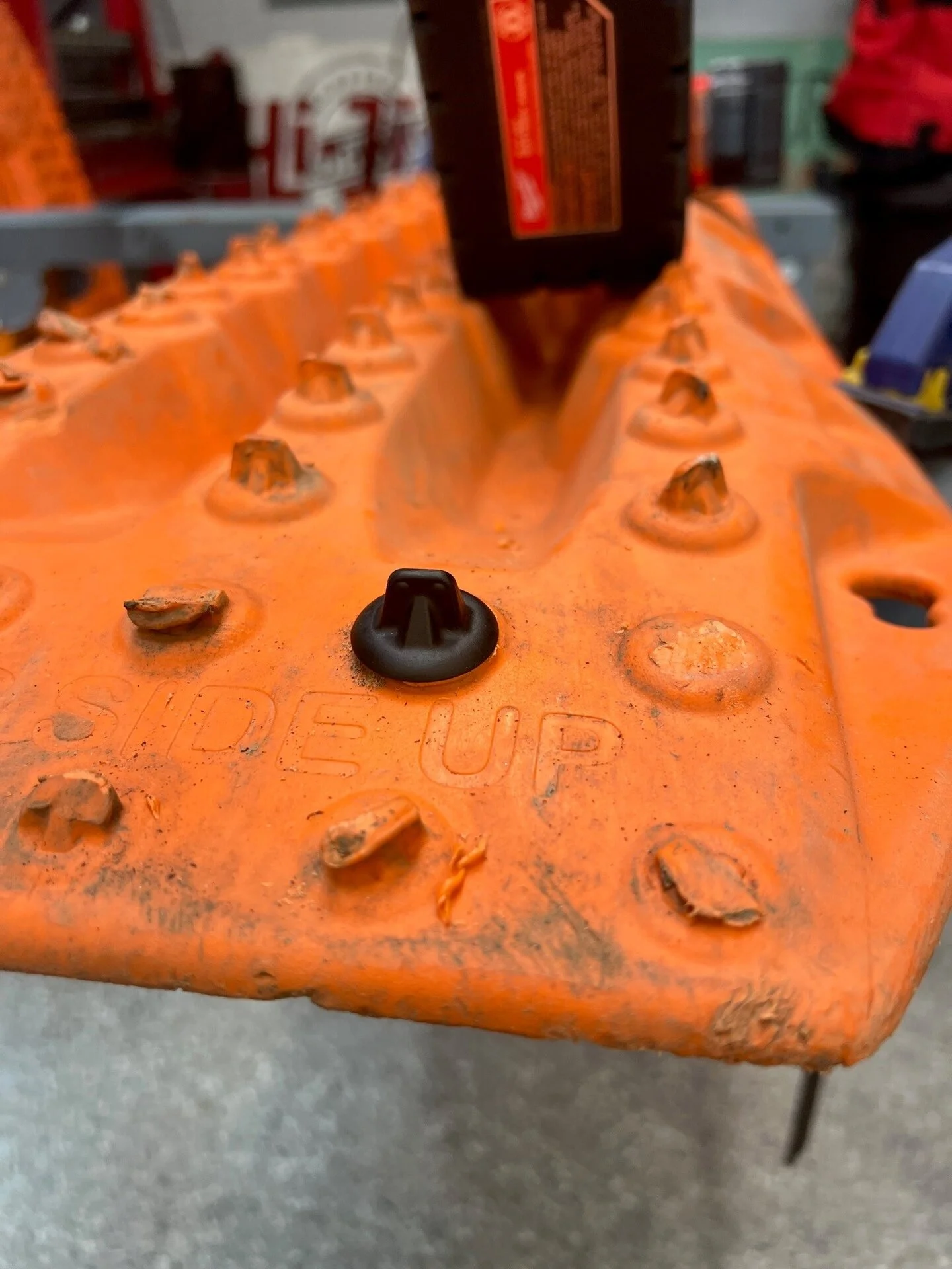

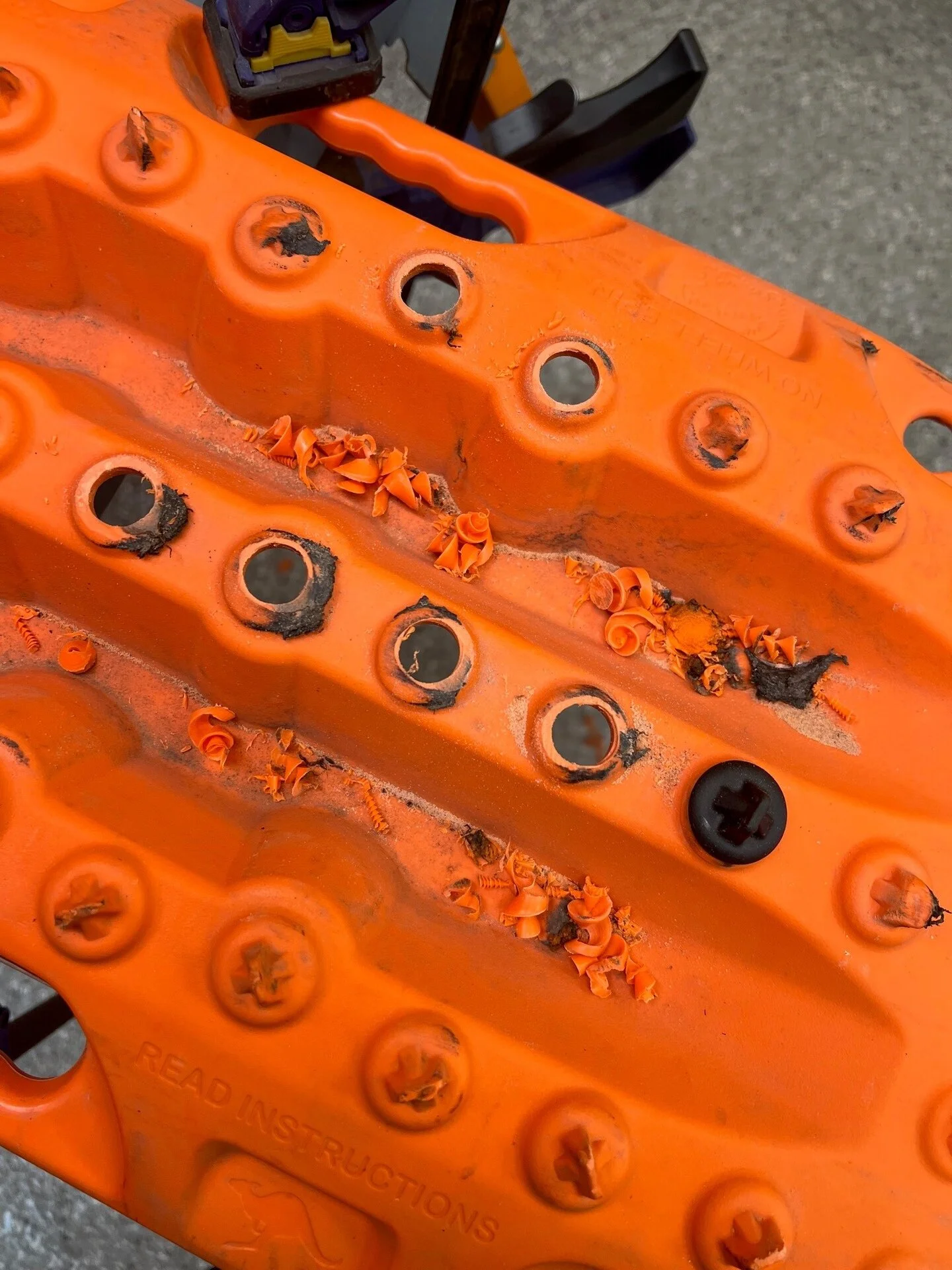

I first cut the melted plastic off with a oscillating tool, then filed flat, center punched and drilled a pilot hole, then drilled a 9/16" hole. Next I pushed the extreme traction tooth in and threaded them in with a torx bit.
