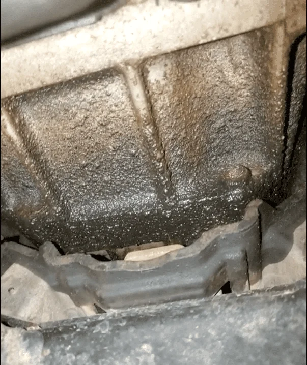

I took my 2010 LX570 with just over 100k miles in for service and they found a leak between the transmission and transfer case. Luckily I have an extended warranty through Lexus so the repair is covered. I'm curious to see if any others have experienced this leak on their 200.
Had a slight ‘weep’ at the same spot in my 13. Hasn’t progressed in the approx 12 months I have known about it.
I just found the same problem on my 2008 LX. how big of a job is it to replace the seal between the gear box and the transfer case?
Luckily my LX was still covered by an extend warranty but it was a fairly big job. They replaced the transfer case input seal and transmission output seal. It was billed out as a 17 hour job for about $2500. I had the work done at Kuni Lexus.
Just picked up my 2010 LX570 with 154k miles from a hail auction and it has this same leak. Cleaned up the spot and changed out the T-case oil, going to monitor and assess how serious it is then act based on how quickly it appears to be draining.
