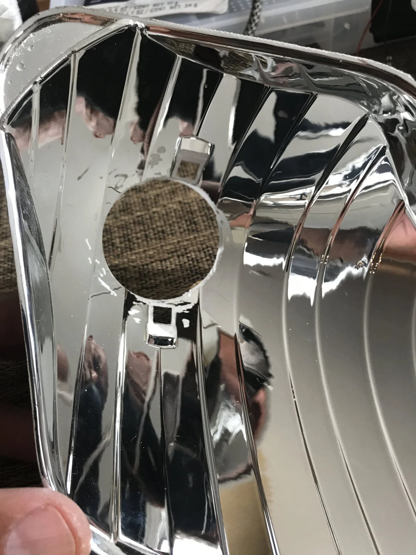

Halo's... can you find the right size? How to mount them? wiring?......will they look good? .. If you really want them... mount your projectors..do not seal the lenses and take or send them to one of the many custom light shops. I really don't have the expertise in that department but I'm sure some one can find a size a look you'd be happy with. I do know that halo's are easy to install when you're adding a new shroud.... there are shrouds that have the halo's attached but that application will not work in the LX low beam side but the high beam side is another story... I'm working on installing little Matchbox projectors in the high beam side
but I'm not a fan of the Gatling shroud. I ordered a set of shrouds from a company that makes custom micro shrouds that have halos
The first picture is the Gatling shroud
