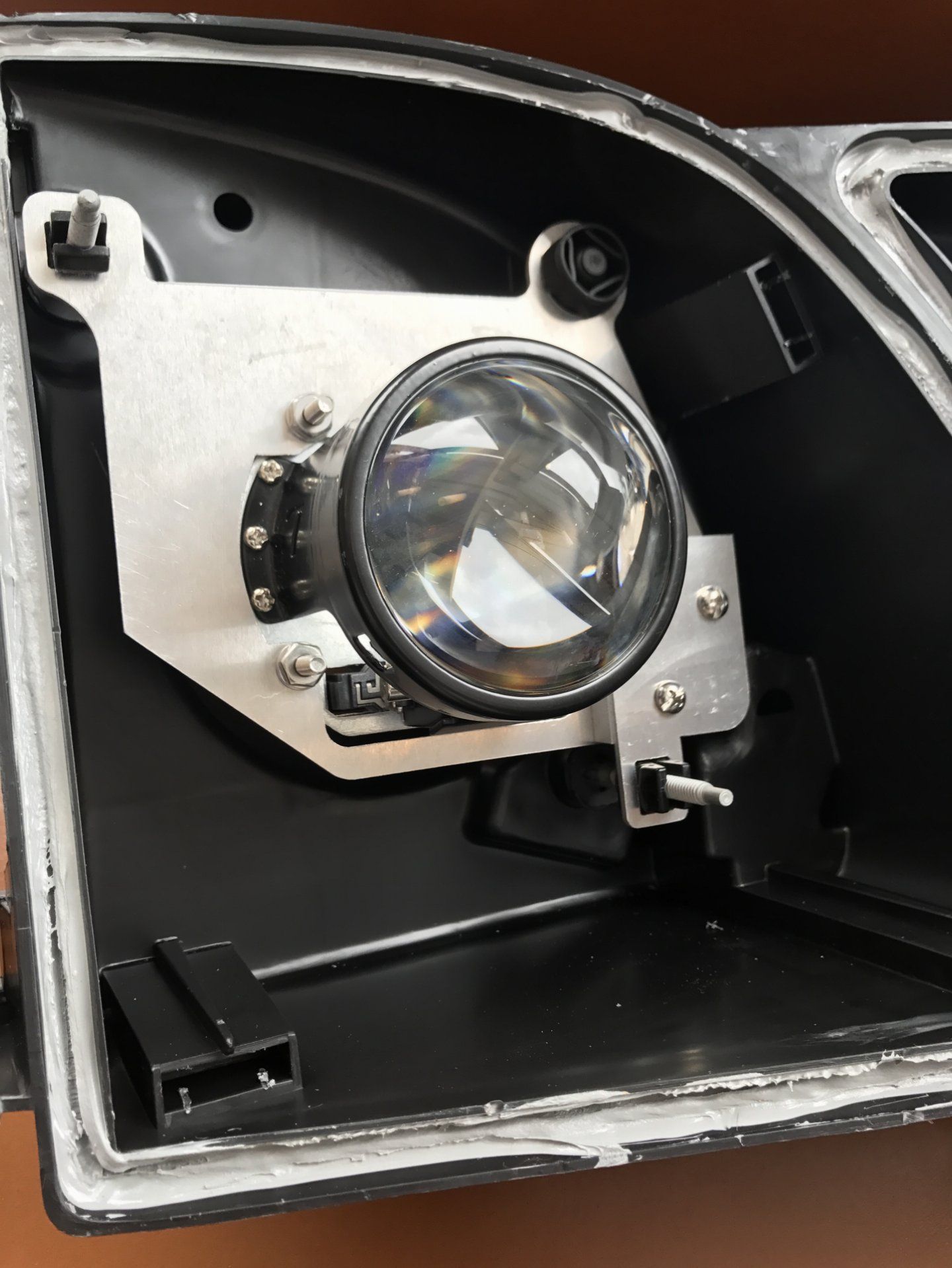

Coupler and ball snaps arrived and the brackets are getting cut Thursday. With the addition of the two extra pieces I should have a price for you by late Monday. Setting up a vendor account and a few small business details so I should be able to start shipping the first week of August. I really appreciate the input the suggestions and your patience. With the projectors mounted to the brackets you'll be able to install your new setup in 10 minutes per side.

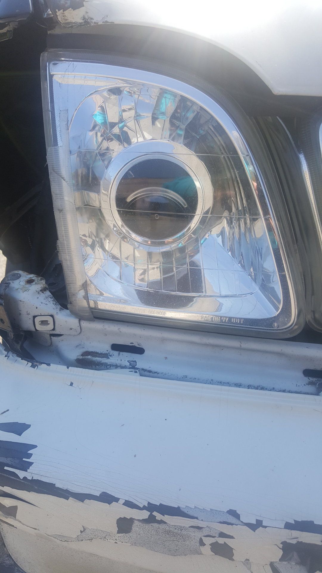

That's the factory headlights. Not modified. Busted loose from an accident. Figured I retrofit the new headlights before I install them.
OK I thought you'd already retrofitted your headlights so you're actually going to order new OEM lights and open them up? I have a brand-new set sitting in boxes in my kitchen right now. If that's the case let me know what pricing you get for the OEMs because I work for Lexus and I may be able to source them a little cheaper. My cost is approximately 10% over actual dealer cost

I ordered the brackets on Friday. There will be 50 pairs of the Mini H1 brackets and 10 pairs of the D2S 4.0 Brackets. On Tuesday I should be a vendor and set up a new thread.
Pricing: Mini H1 Brackets and hardware $95.00 pair pair
D2S 4.0 Brackets and hardware $110.00 per pair
Shipping is included for US and Canada
The D2S brackets cost more due to the small run

There are picture on Page 6 and pricing is 6 post up on this page. I will create a thread where you can buy them as soon as I'm a vendor. I'll post a few here for you. The thread is pretty informative as to why I decided to have these made the process and all the great suggestions from fellow members
