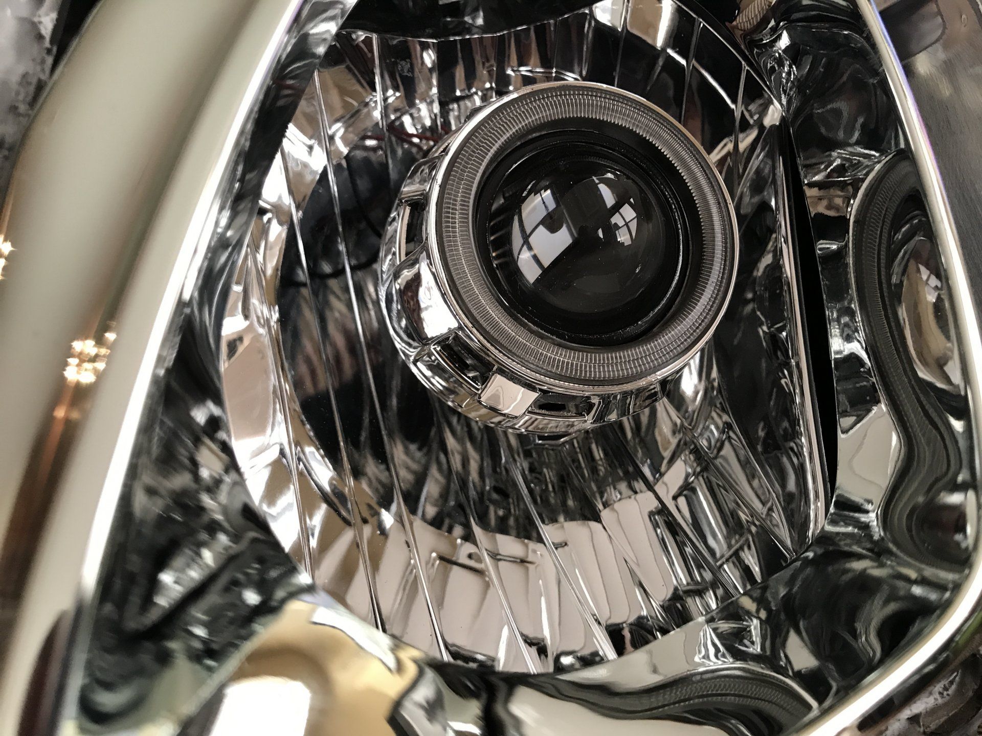

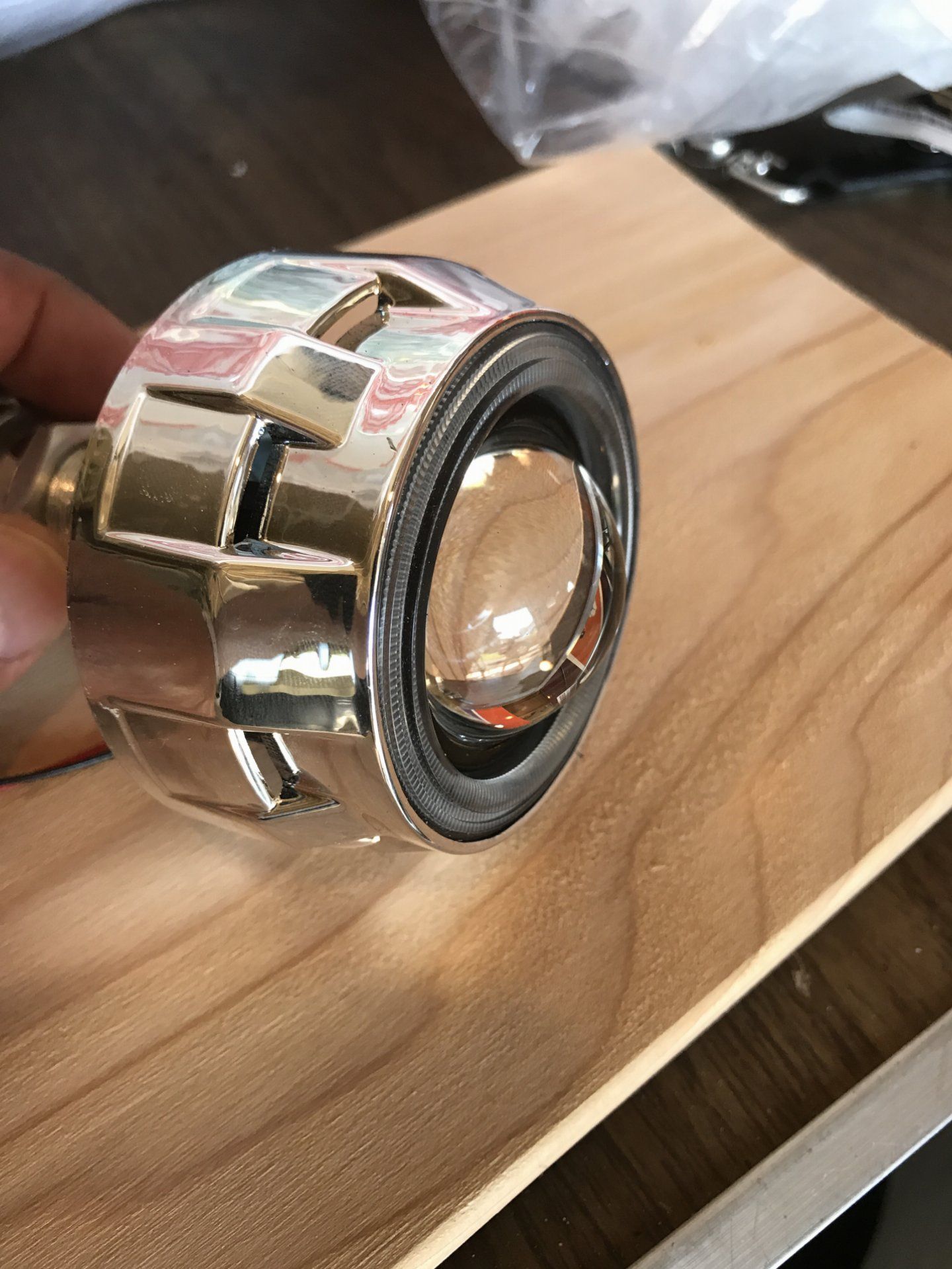

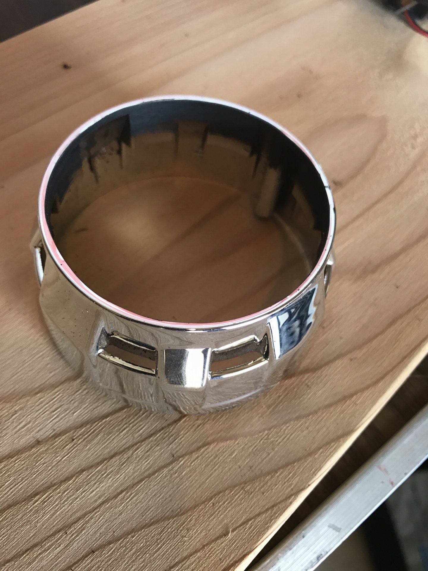

I decided to try and finish up my Matchbox high beam setup. As I posted earlier I purchased a different micro shroud with a halo ring from a company called Klearz. The shrouds did not come chromed and once in hand I was informed by a chrome shop the plastic compound of the shrouds would not be a great candidate to be chromed so looking at the micro Gatlin shroud I whipped out the Dremel and opened up the Gatling shroud to except the halo and it worked out perfect.
Then I went to work on the factory shroud open up the hole, cut about a quarter inch off the the rear and inserted the Matchbox projector and bolted the projector on.
I have a set of matchbox projectors sitting in my garage. Did you have to cut any to fit them and are you using HID or halogens bulbs in them?
