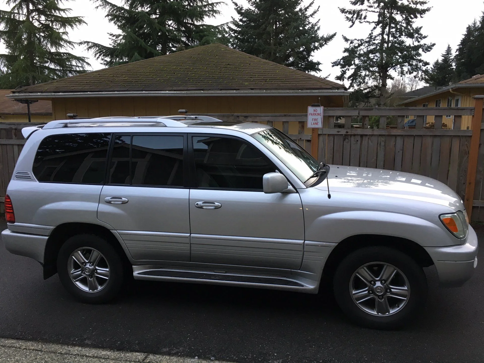

I recently purchased a 2007 LX470 and just this weekend went through a front brake job. Thanks to this forum the process went very well, even the cone washer part. I decided to try the StopTech Cryo Rotors (non-sloted/drilled) along with the 7000 Green Stuff pads from EBC brakes. Fit of both was very good and so far I'm very impressed by the quality of the StopTech Rotors. I'm hoping they last for a long time while trying to stop this tank.
After driving this truck for a couple of months I find myself liking it more and more each day. I'm coming from an Acura TL so this was a big change but I'm glad I waited to find the right one in great condition. I honestly think this must be one of the best cars ever built in terms on quality. Gas mileage is what it is, I got 18.3mpg (manually calculated) driving it back from Oregon, and now typically average between 14-15mpg in mixed driving.
Can't wait to take it up to the mountains and really see what she'll do!
