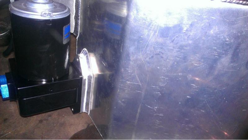

Water Box is 100% complete. On the right you can see the 20gph water pump and the loop on the left will hold the stock windshield washer pump. The whole reservoir will hold 5+ gallons of water and ethanol i.e. blue windshield washer fluid. The whole system with the intercooler and heat exchanger and hoses should be just shy of 6 gallons.
