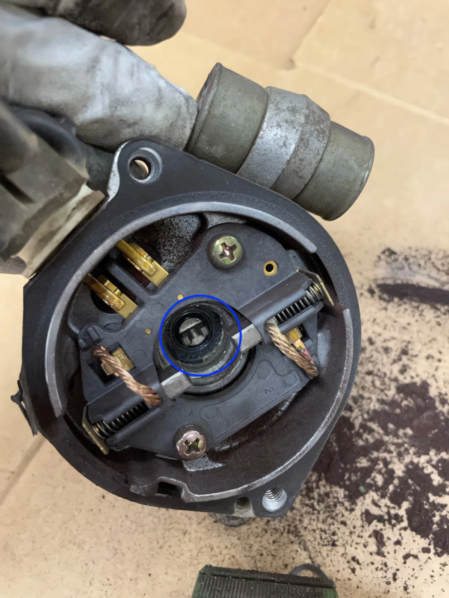

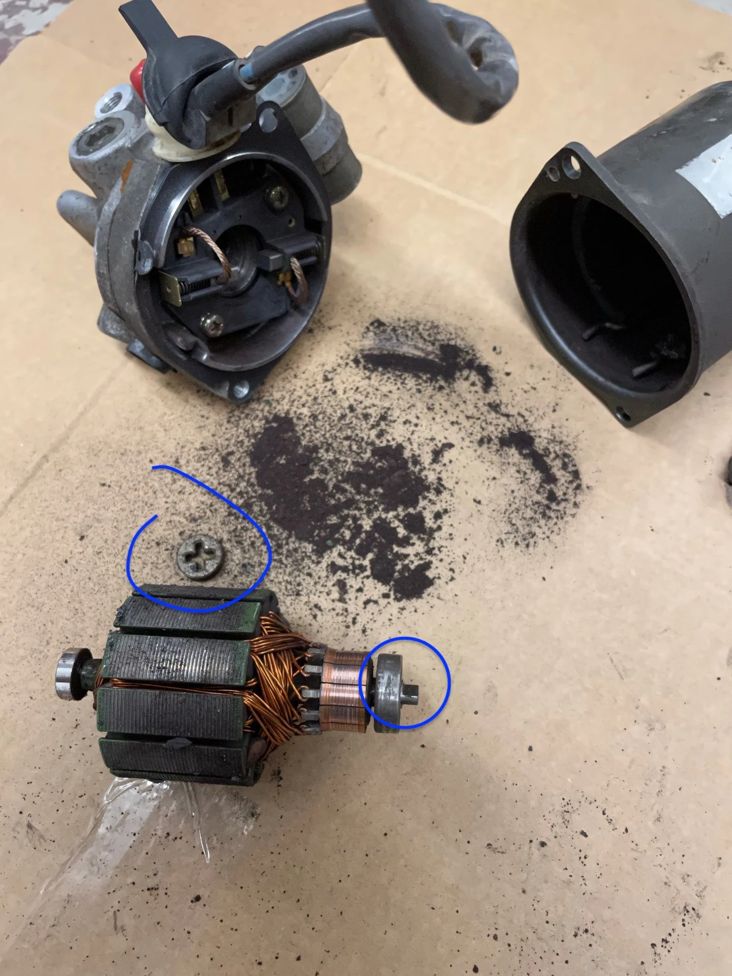

I took it apart awhile back.... it looks like the Lovejoy/coupling goes between commutator and the pump.
