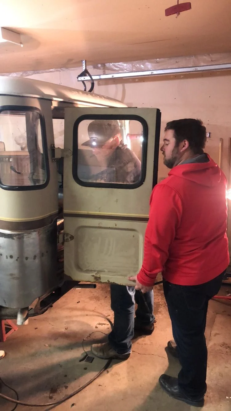

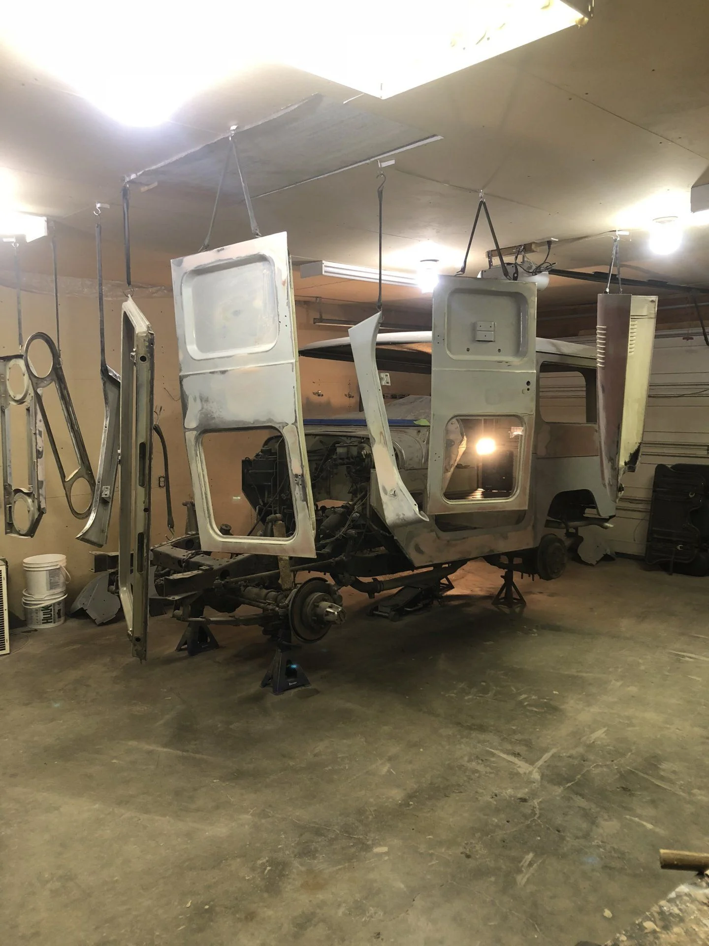

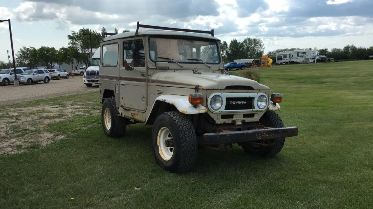

brother and father came over and helped me get the hard top on, and mock the ambulance doors into the new steel!

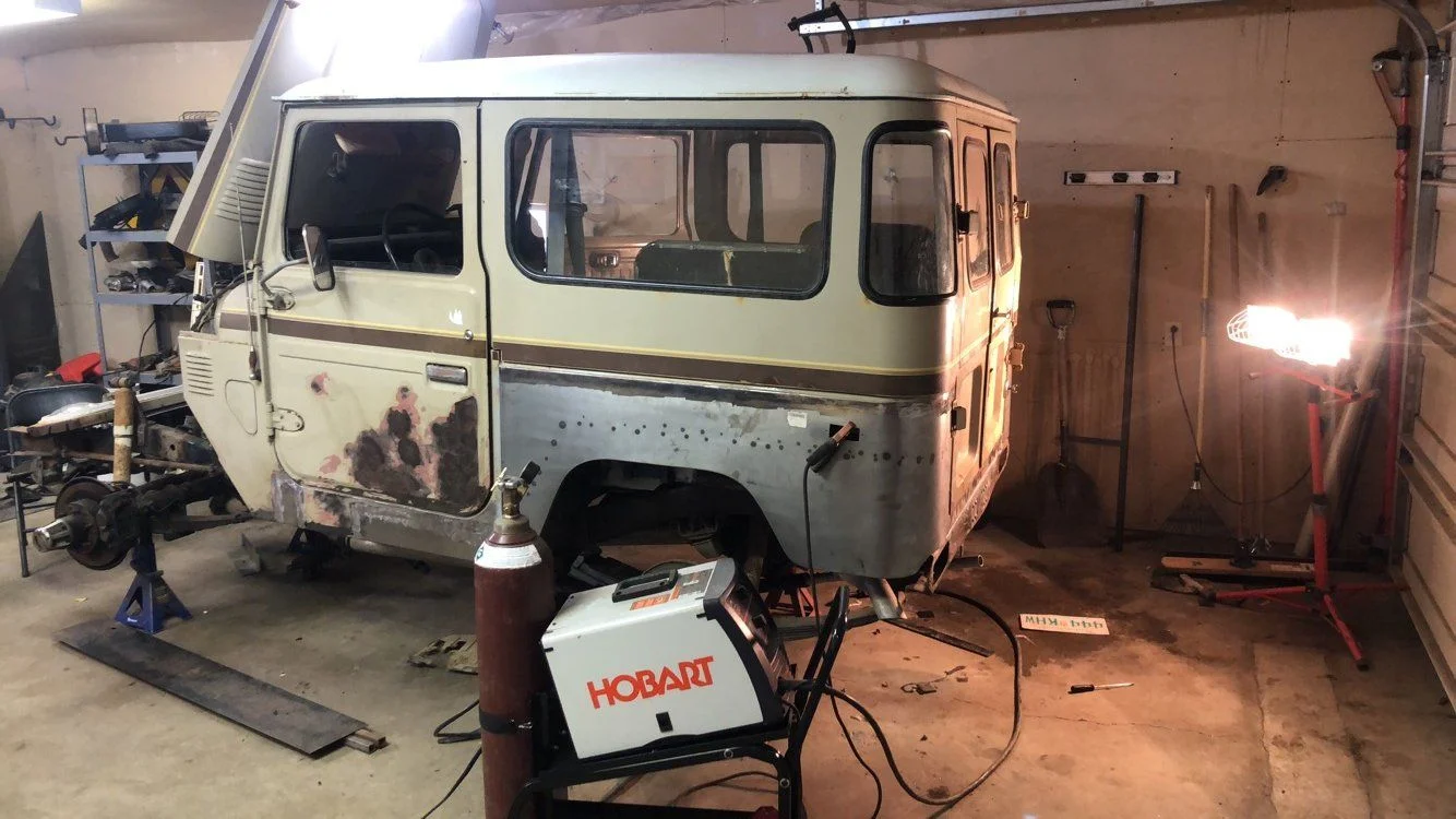

I’ve been slacking hard! Sorry guys. Damn summer, life really gets in the way. Got a tv in the garage now for when I start putting it back together. I have documented photos of everything.

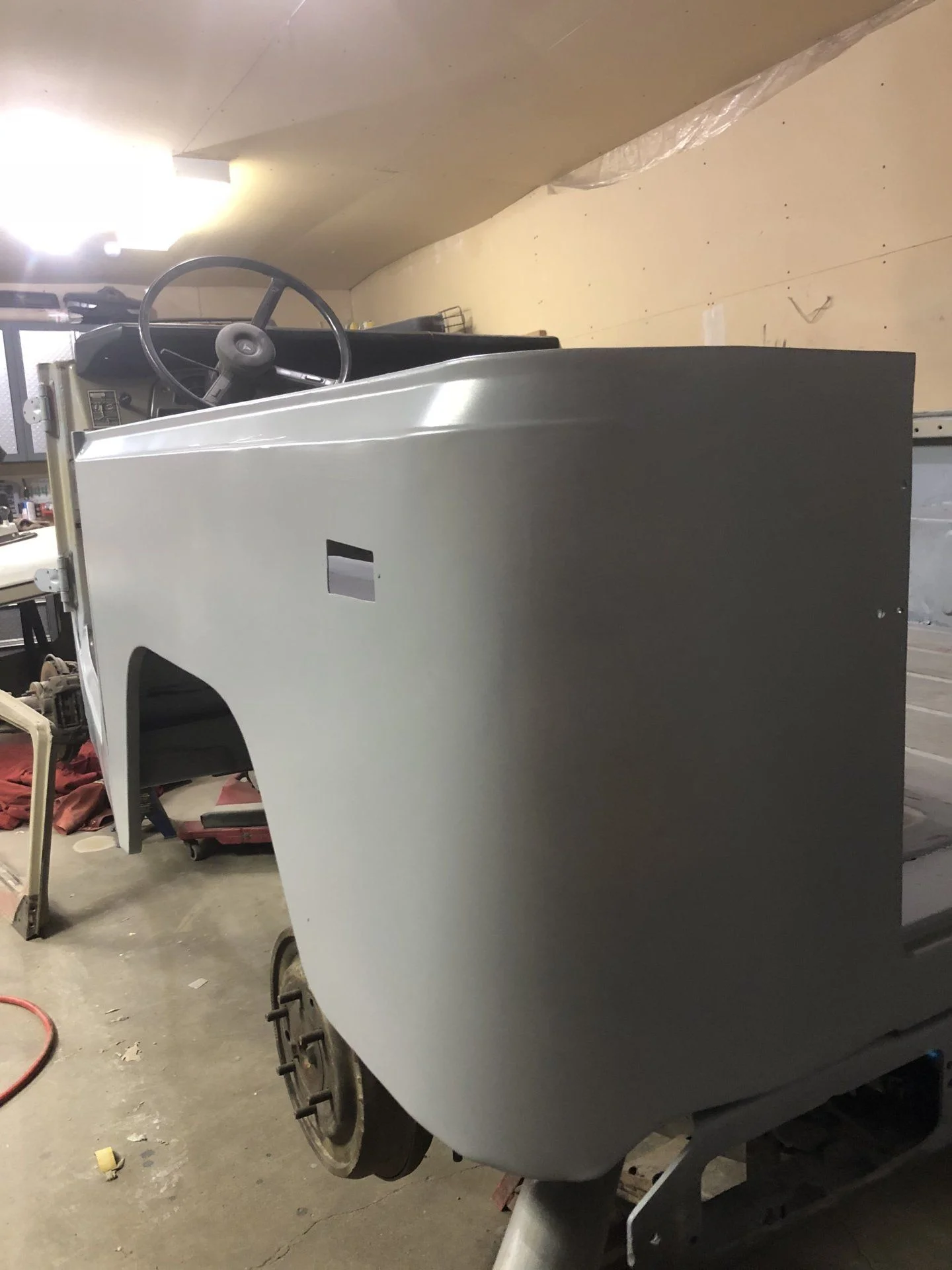

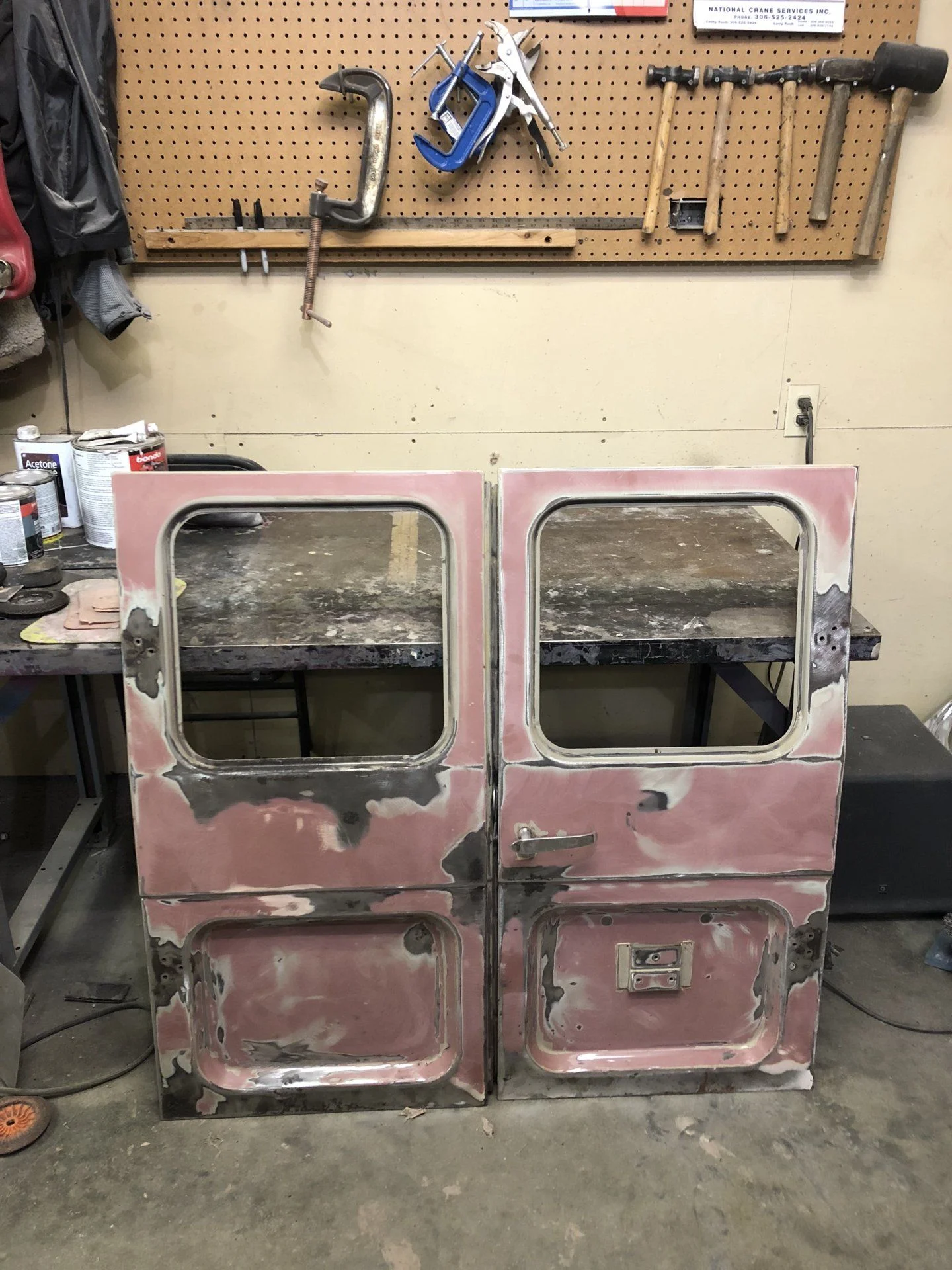

Damn near ready for paint! Small odds and ends, also need to setup air dryer onto air compressor and do some kind of paint booth!! I’ll start updating more often again lol

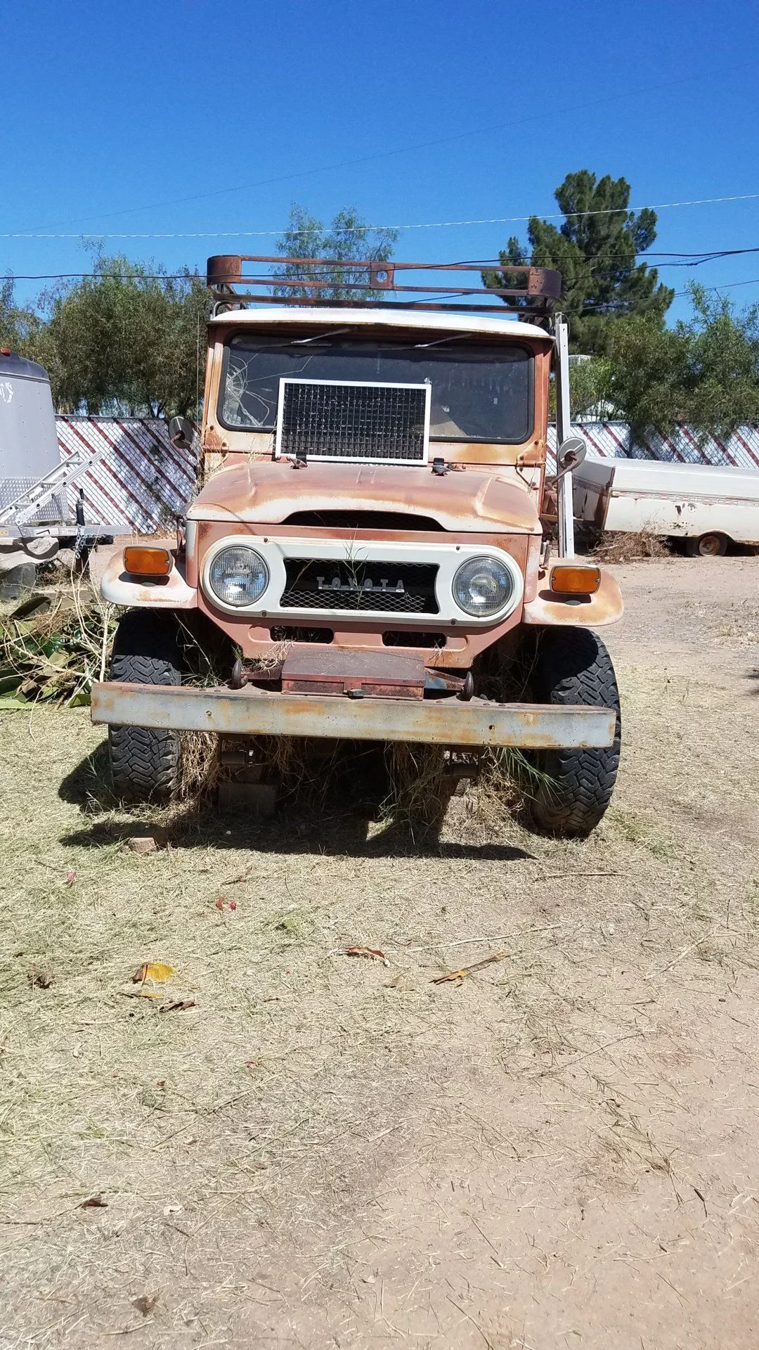

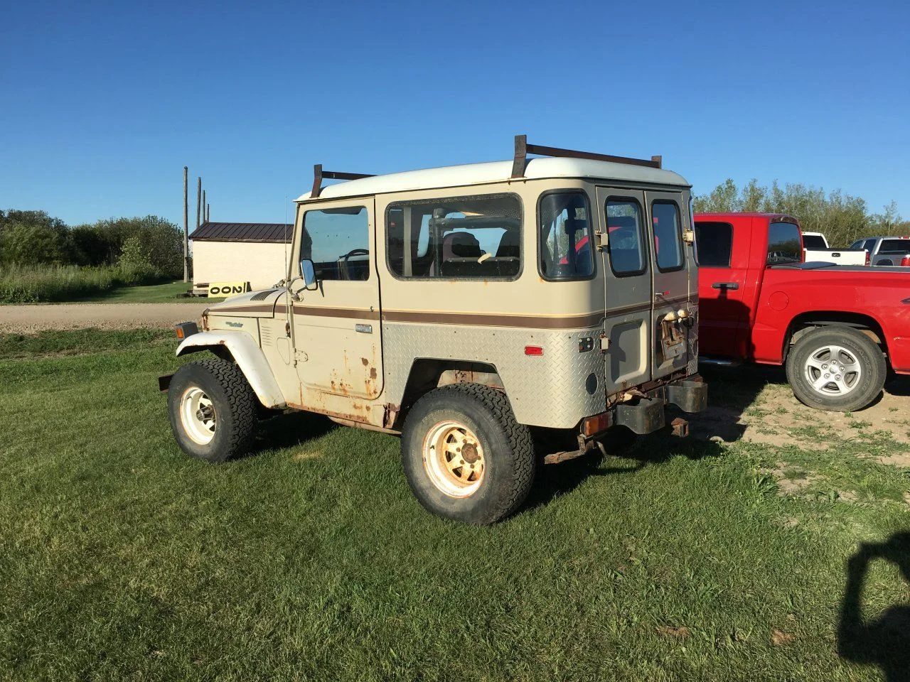

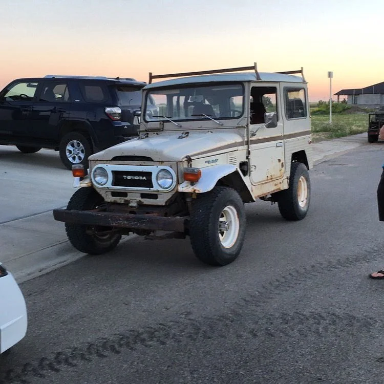

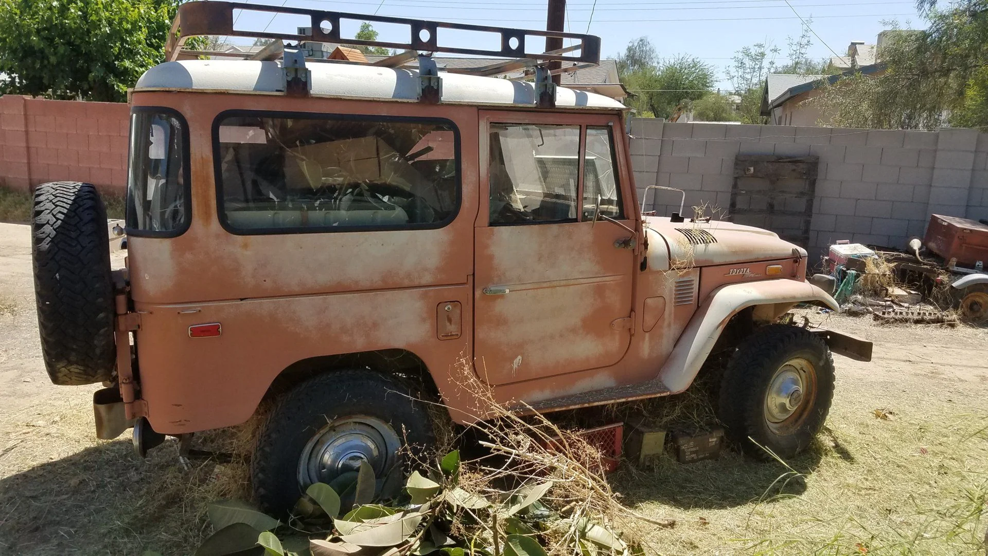

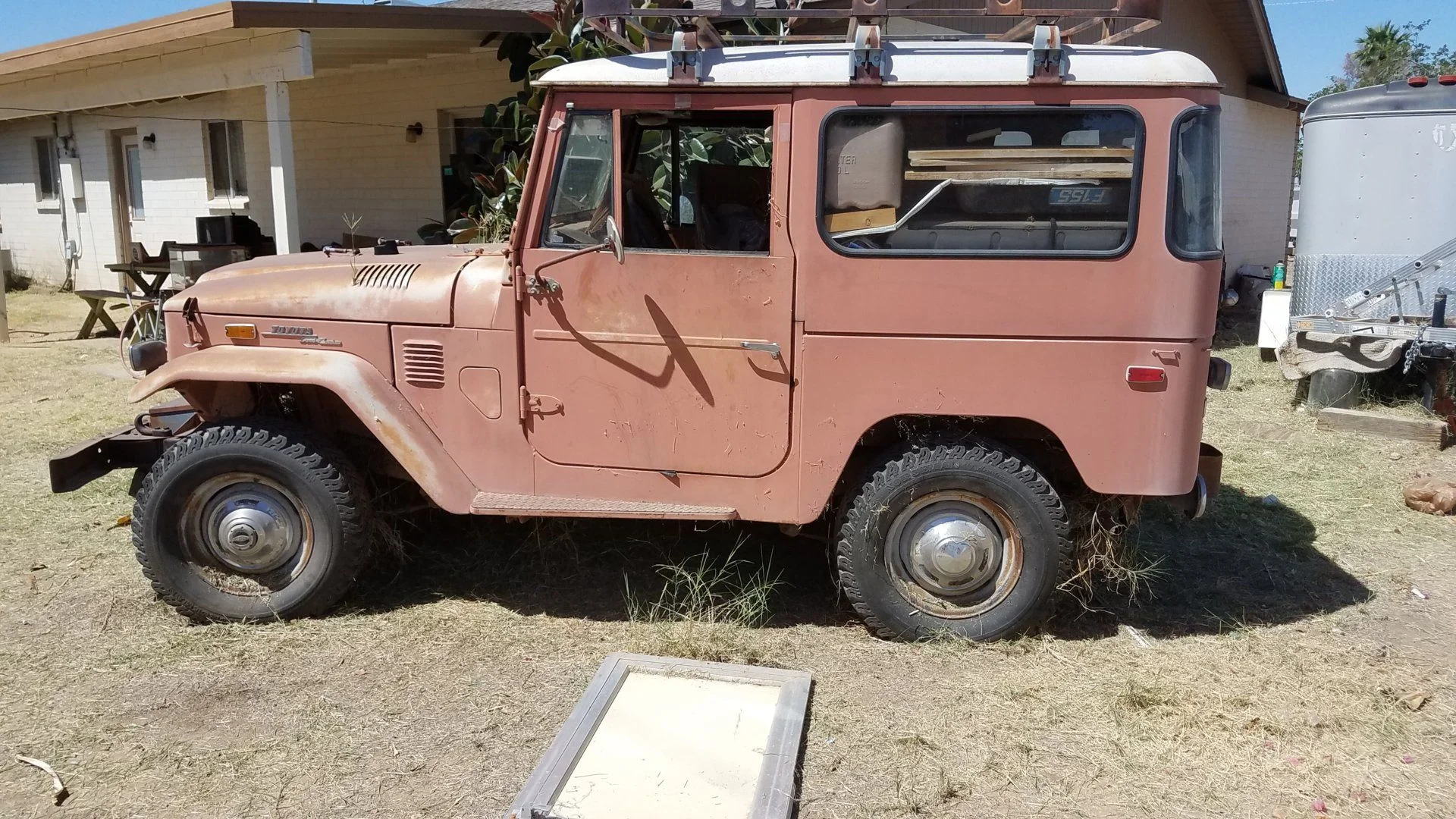

I would of never thought that I would buy an fj40, I always had plans of maybe some day getting myself a little 80's pickup. After golf one day I came upon a 1976 land cruiser parked in a field with a for sale sign in the window, I thought it was the coolest thing I ever did see. I hopped out of my 4Runner to check it out and take pictures, my wife could tell how awesome I thought it was. Couple days later I gave him a call and asked how much he is asking, the price scared me away a bit but I still knew I had to have it, i felt like this was my only chance to ever own one of these. A week later I talked to the owner again and he said he must of had close to 40 phone calls, that's when I withdrawn the money from my account and asked to take a second look. The fact that it actually ran and drove was just a bonus to me. The Now previous owner was so upset to sign the papers over, but he had too due to a farm full of vehicles and his wife over his shoulder. Long storey long, I absolutely love this thing and love tinkering with it and poking at the rust and envisioning what some day it can become!
This was my first in counter with the fj40 and it took 8 years to get it but i own it now.

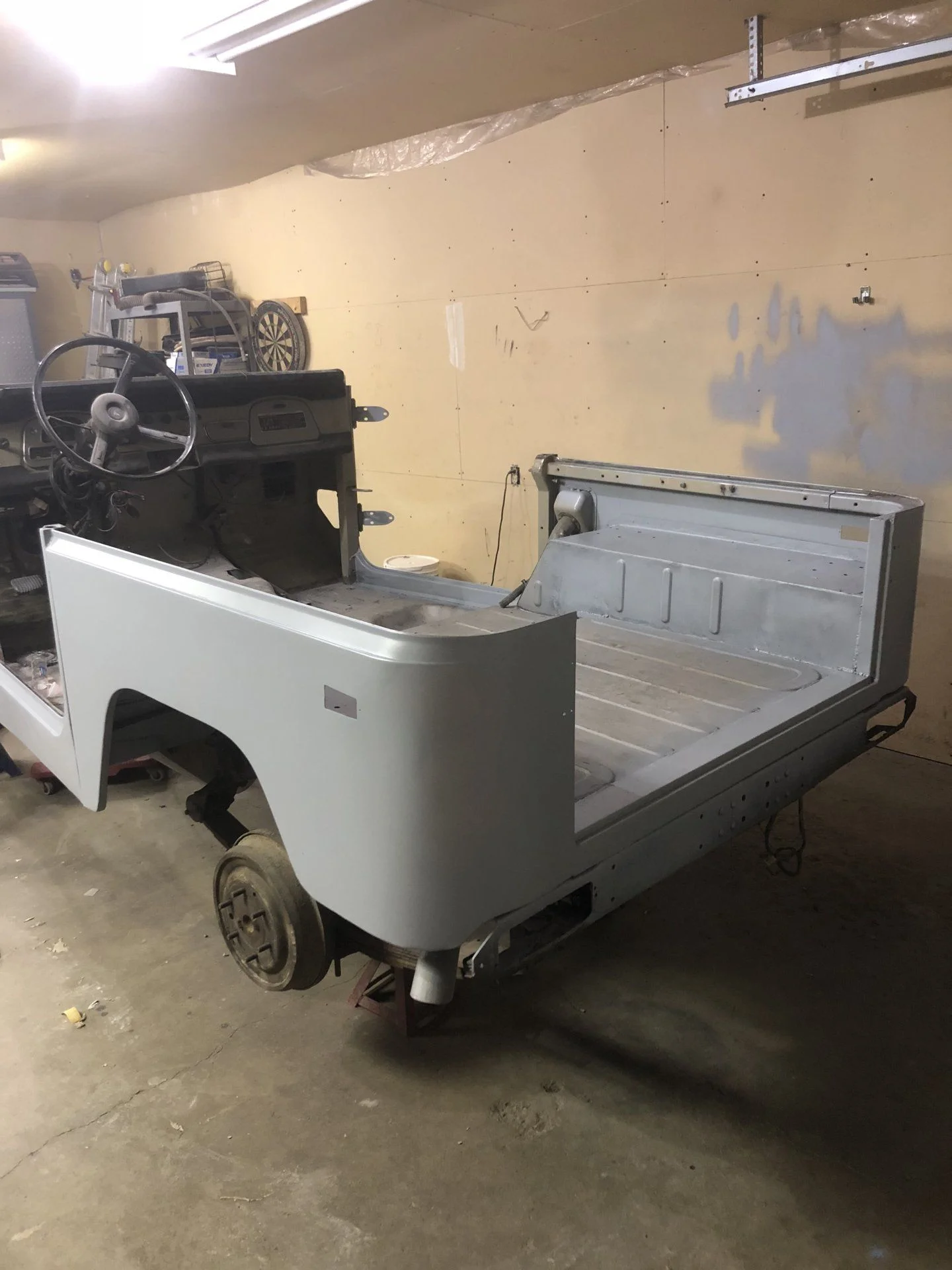

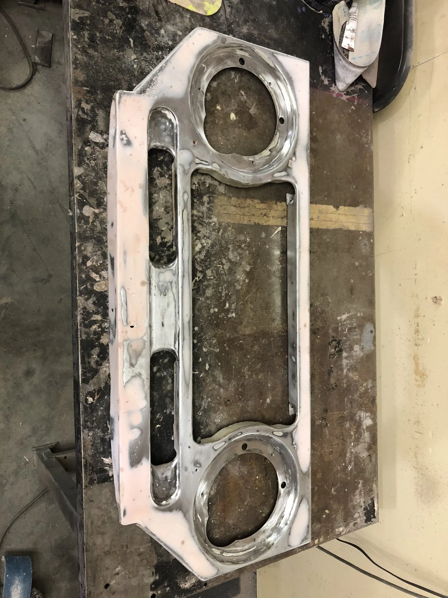

This is what my father and I needed to kick start us and keep this restoration going! We both work lots of hours at our day jobs and didn’t know what the next step should be. Luckily my father just started spraying self etch primer to the bare metal and now we know what needs extra work. The paint really brings out any imperfections that we couldn’t see before.

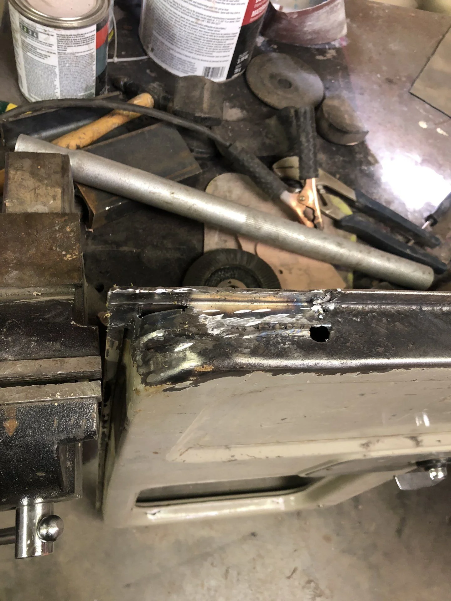

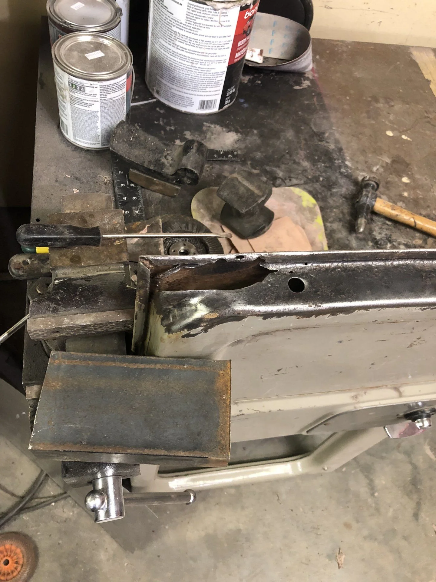

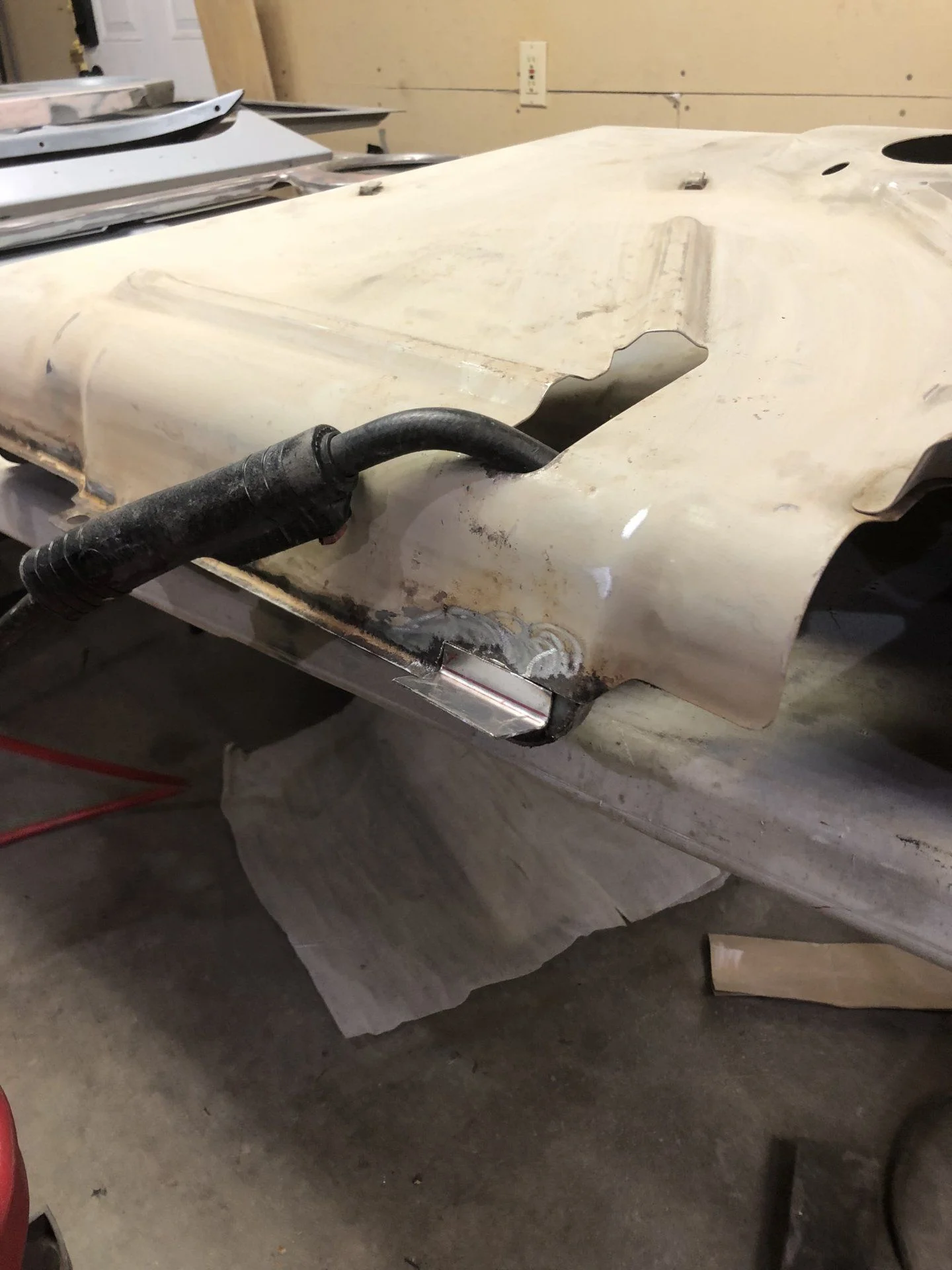

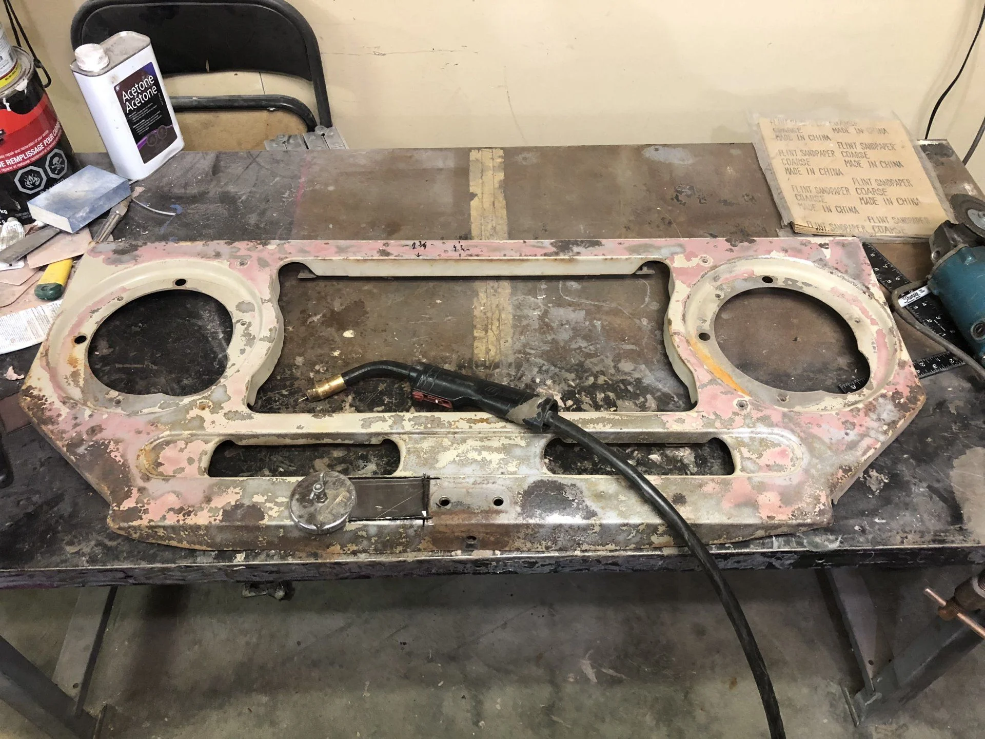

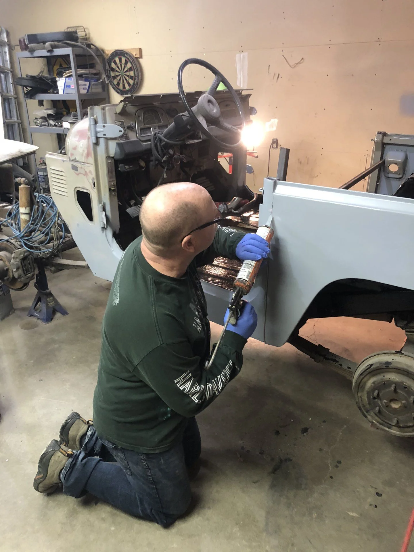

Hey guys and gals! During the past 2 or 3 weeks we have gotten this much done! We did POR15 on the floor, seam sealed the appropriate places, sprayed on a rocker paint on the inside fenders to hide some ugliness, welded in some
New steel on the gas tank cover, and also hung mostly everything to get ready for primer . I’ll try and keep up to date on this page.
