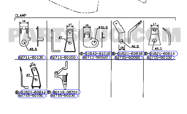

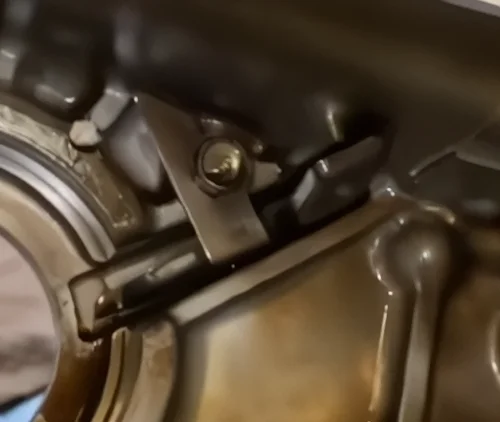

1. There are six bolts that attach the front extension housing to the front case. On one of those bolts, there is a small bracket for an electrical cable. I forgot to take a good photo of this area during disassembly, but I think it is the bracket in the photo below. Can anyone please confirm this? Also, I cannot find any reference to it in any manual or part diagram, so might someone have a part number for it?

I believe that bracket holds the wiring harness for the speed sensor.
Thanks! Can you confirm that the bracket shown is the only bracket attached to the front extension housing? Might you also know the part number?

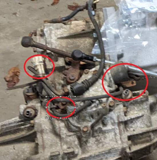

I think this is the bracket. It is attached to the bottom.

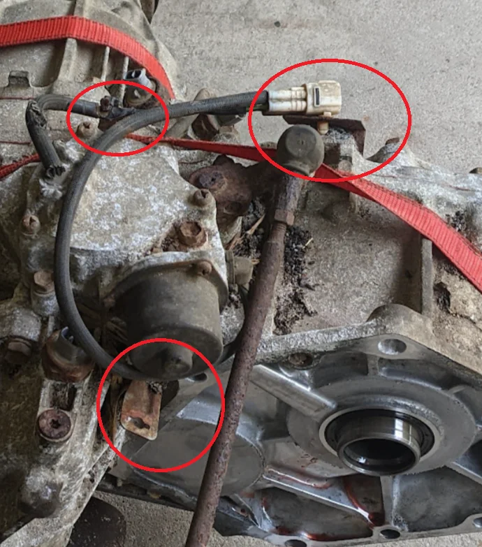

There are other brackets on the front top, and on the rear top.
Different angle
These maybe the brackets

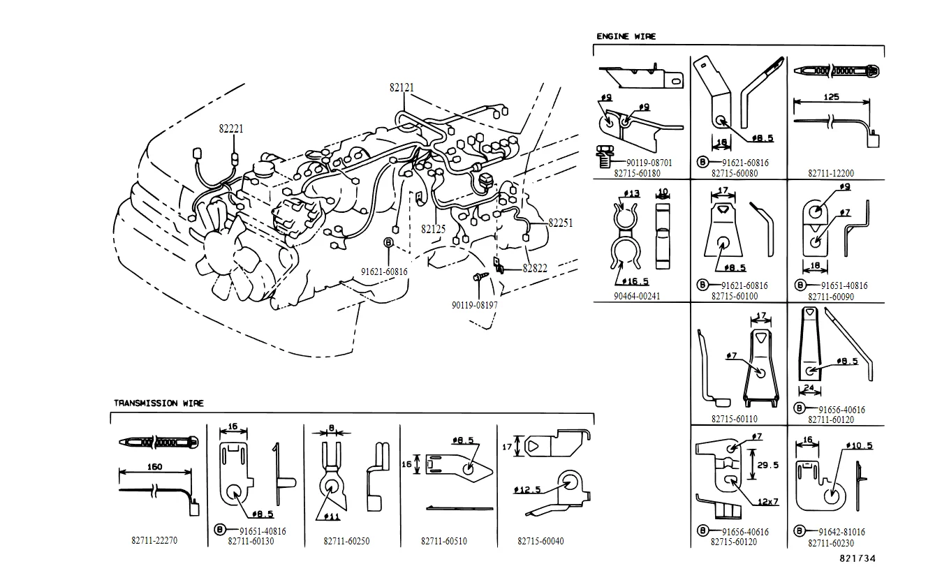

Regarding the bracket, I am pretty happy with what NeverFinis sent. Thanks for that. The whole bracket thing started while watching Georg's Valley Hybrids 4-part Youtube series on the HF2AB rebuild. In that video, the bracket on his front extension housing is different from the bracket on mine and also different from the one in NeverFinis'a photo. That caused me confusion, but it seems Toyota must have used two different versions of that bracket over the years. OK, fine.
I will say that Toyota's documentation for brackets is not the best, but I guess it does not matter so much since most of them are NLA.

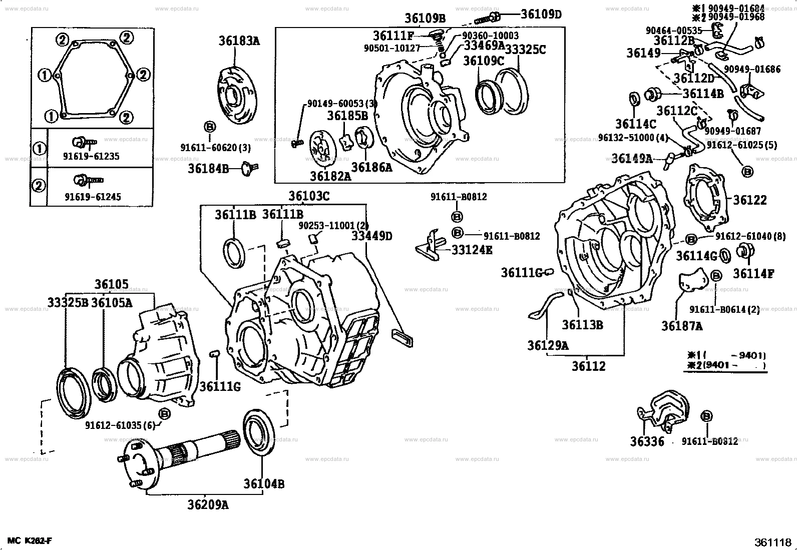

I was going off the parts diagram for the transfer. If you look below, it is labeled as part 33449D, which translates into part number 33449-60010 and is described as, magnet for transfer case. It appears rectangular. Other than this, I cannot find a reference for it.

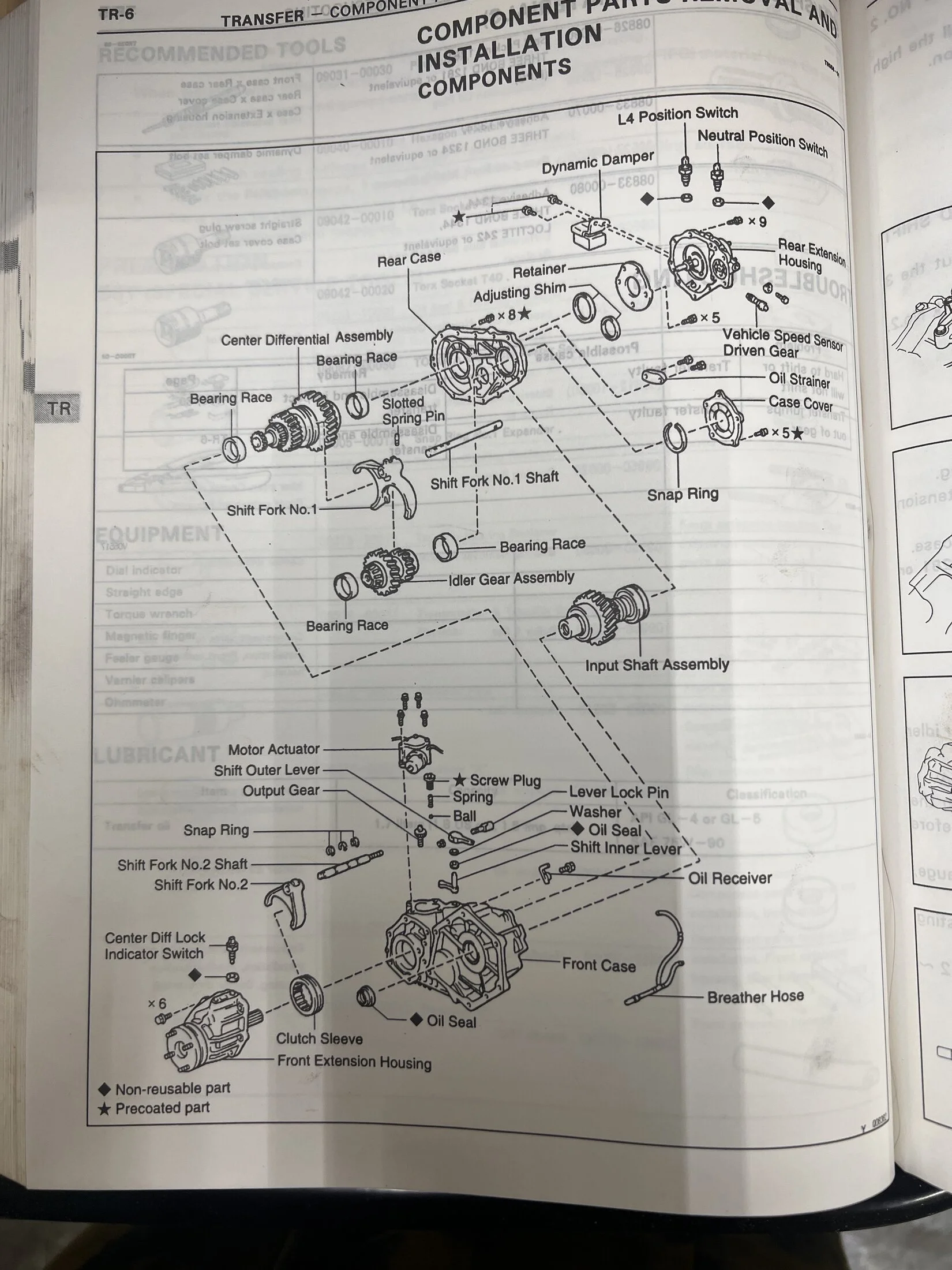

This is from the 1996 service manual and does not seem to show a magnet. Perhaps a parts guru can chime in about that part number.

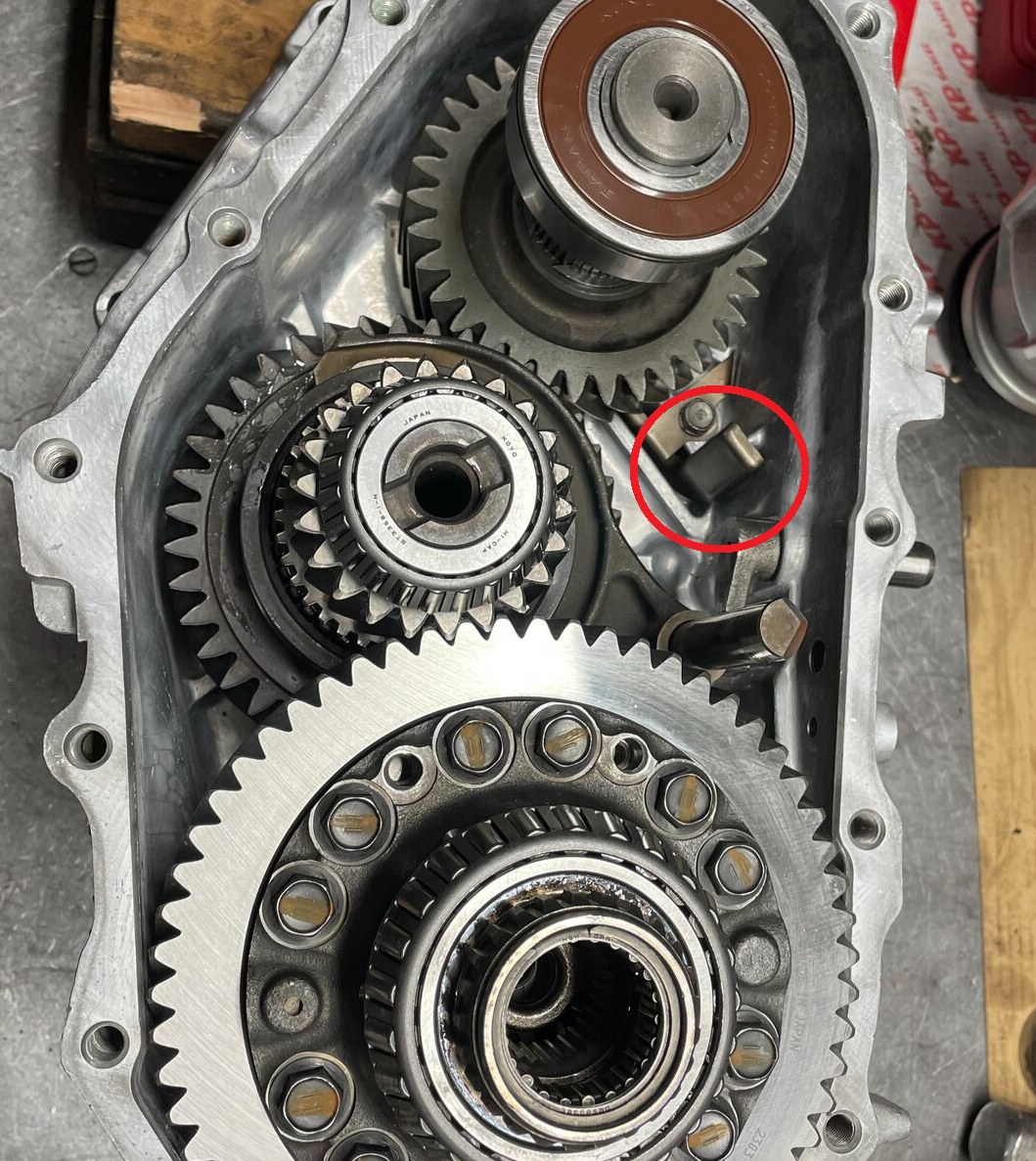

It could be inside the circled metal box? The part near it is called "Oil Receiver".

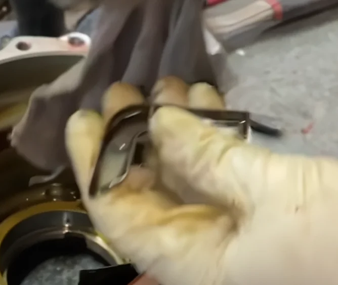

George shows it, and it doesn't appear to have the magnet in it.
Maybe they did have a magnet there at one point...

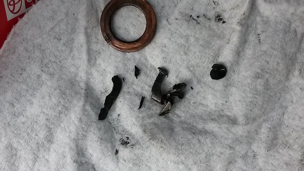

If you look at this previous thread, the original poster talks about finding metal around the transfer case plug magnet. That would give you the idea the magnet is located in one of the plugs, but that is not consistent with the part number and image from the above parts diagram. In addition, none of my plugs, which are new OEM, have a magnet in them.

The parts diagram is wrong and who knows what part number 33449-60010 actually is.
