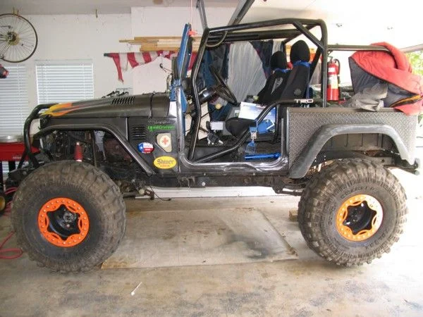

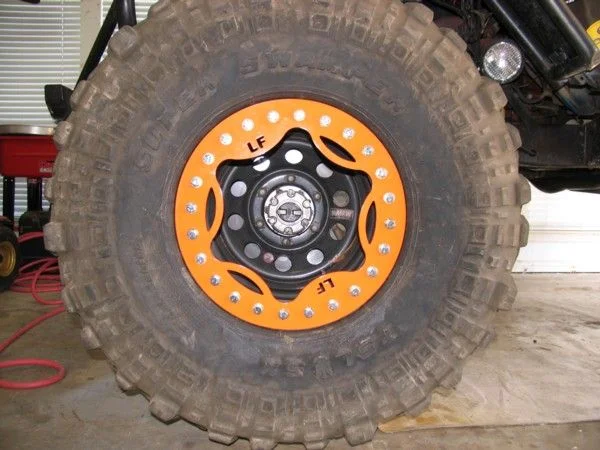

Before the Hammers - they aren't quite so pretty now...
15x10 MRW wheels, 38.5x12.5 TSL-SX's, 2.5 backspacing.
Something to think about... With the backspacing that I have I blew an inside bead at about 4psi. These are reverse cut wheels.

Rascal - are those the 4" TJ flares? I GOTSTA get one of those yellow stickers too :beer:
