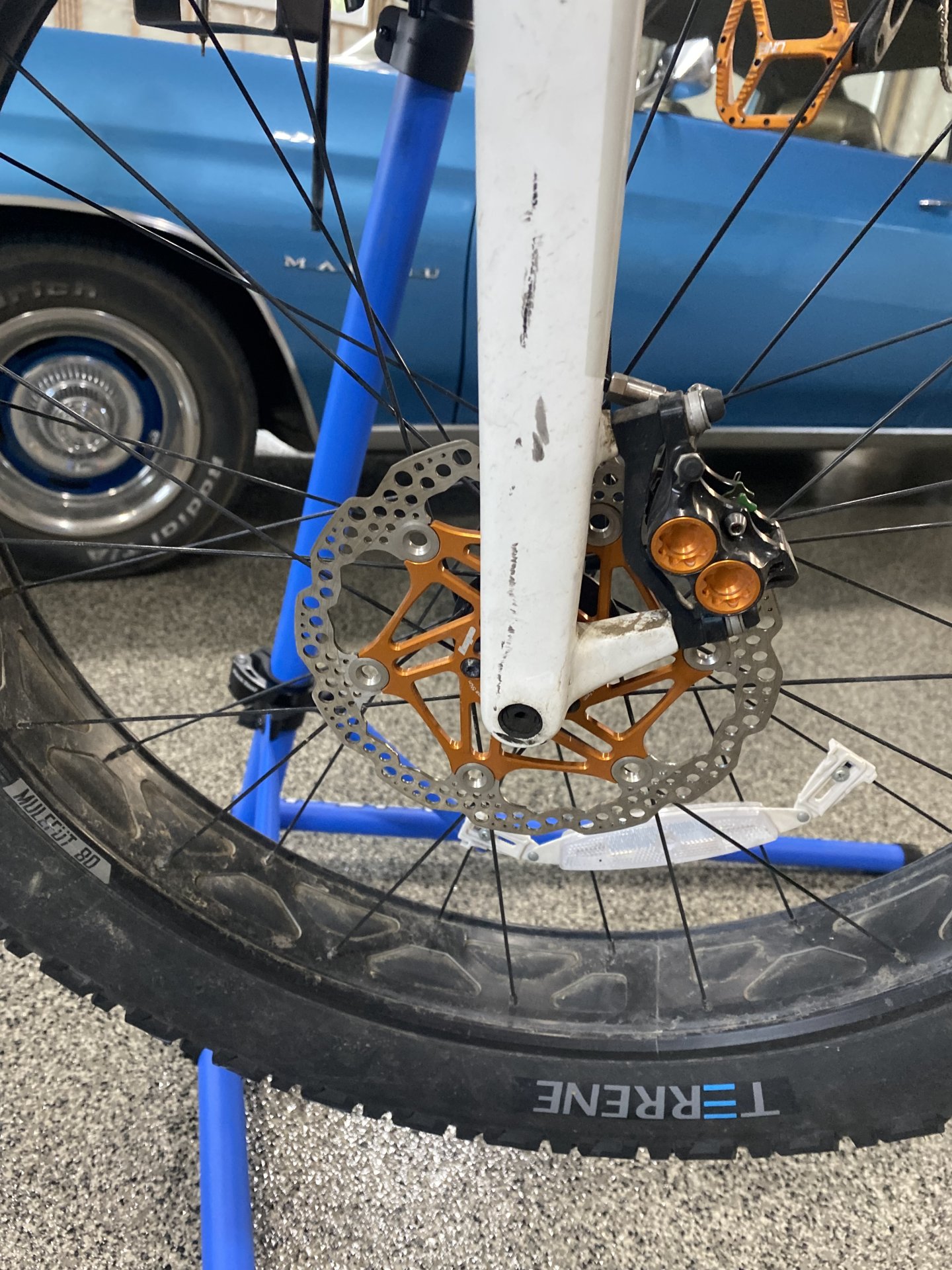

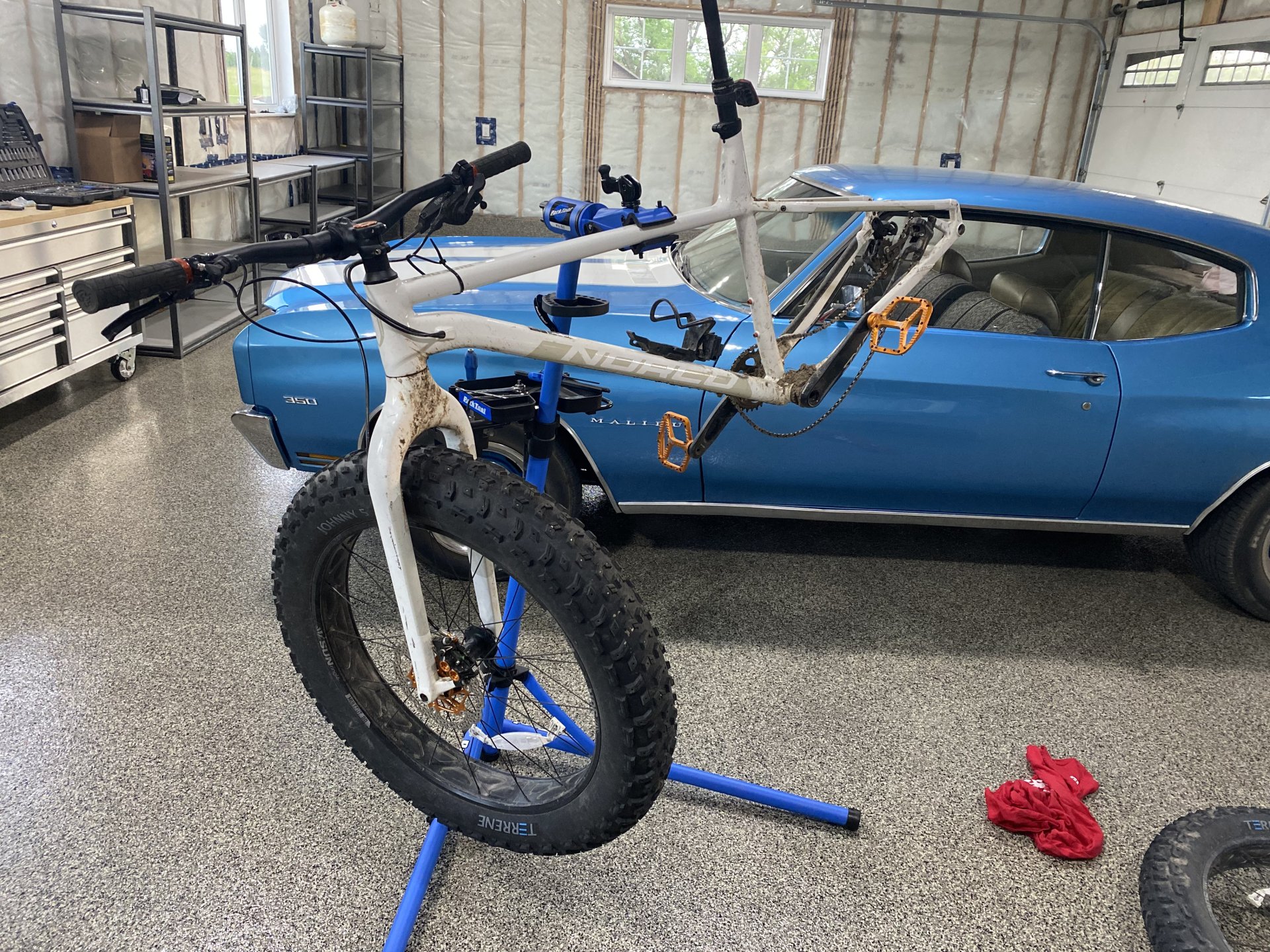

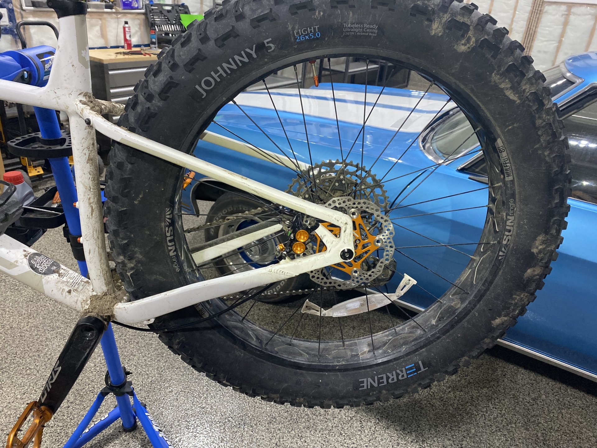

i got the hope tech4 e4 hydraulics. they aren’t cheap but they are beautiful. they have artistic craftsmanship for some bling but that’s not all that impressed me. their sales rep was excellent at taking me through the different brakes and making suggestions based on my bike and riding style. then the brakes got here and the material is top notch and they actually include all the little extra parts you’d need to set things up. they come all sealed and bled but the cable is too long for most bikes to just install and ride. they have excellent how to videos and like i said they had all the parts to cut down the lines and reinstall with new fittings. i’ve only ridden with the front so far and finally got the back done tonight. i have a little adjusting to do yet and need some correct size zip ties to route the hoses but from what i feel they are worlds better than the sram levels that came with my bike.
here’s a couple shots from tonight
so another update on these brakes. i got to use them properly with some long downhills and single track riding. they work so nicely. i can lock up if i need to but more importantly they have a very nice gentle bite. with very light pressure i can slow down perfectly without tiring fingers on long sections. i’m very impressed.
