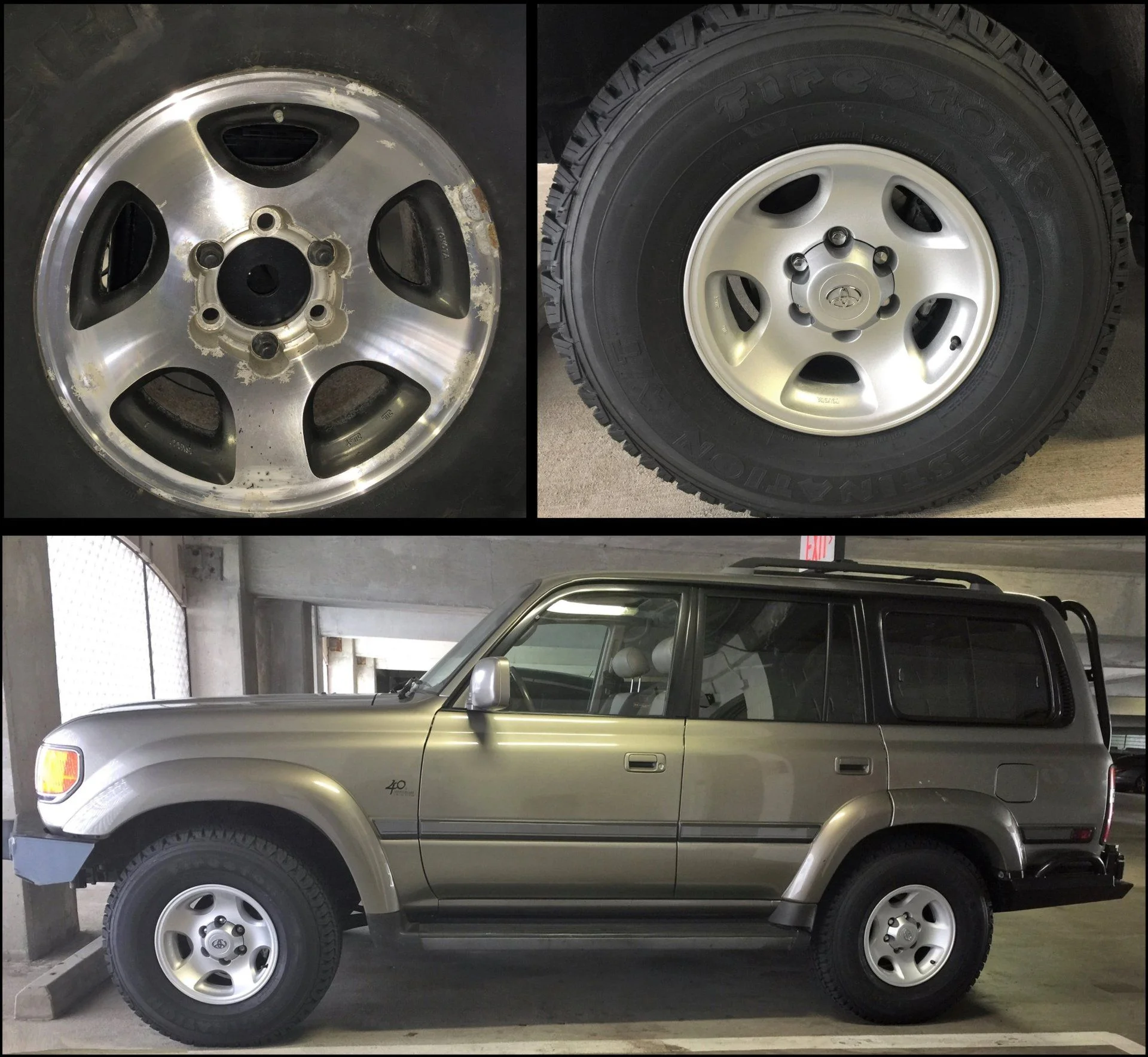

This white ones above were chromed before. Bling city. Yuck, and probably from 1993, so there was corrosion behind the chrome. I paid to have a proper chemical strip. No sandblasting. There was still enough corrosion damage that I spent a lot of hours going through the grits hand sanding each one. Then I did a rattle can aluminum primer. Holding up well. I did go with tape on wheel weights.

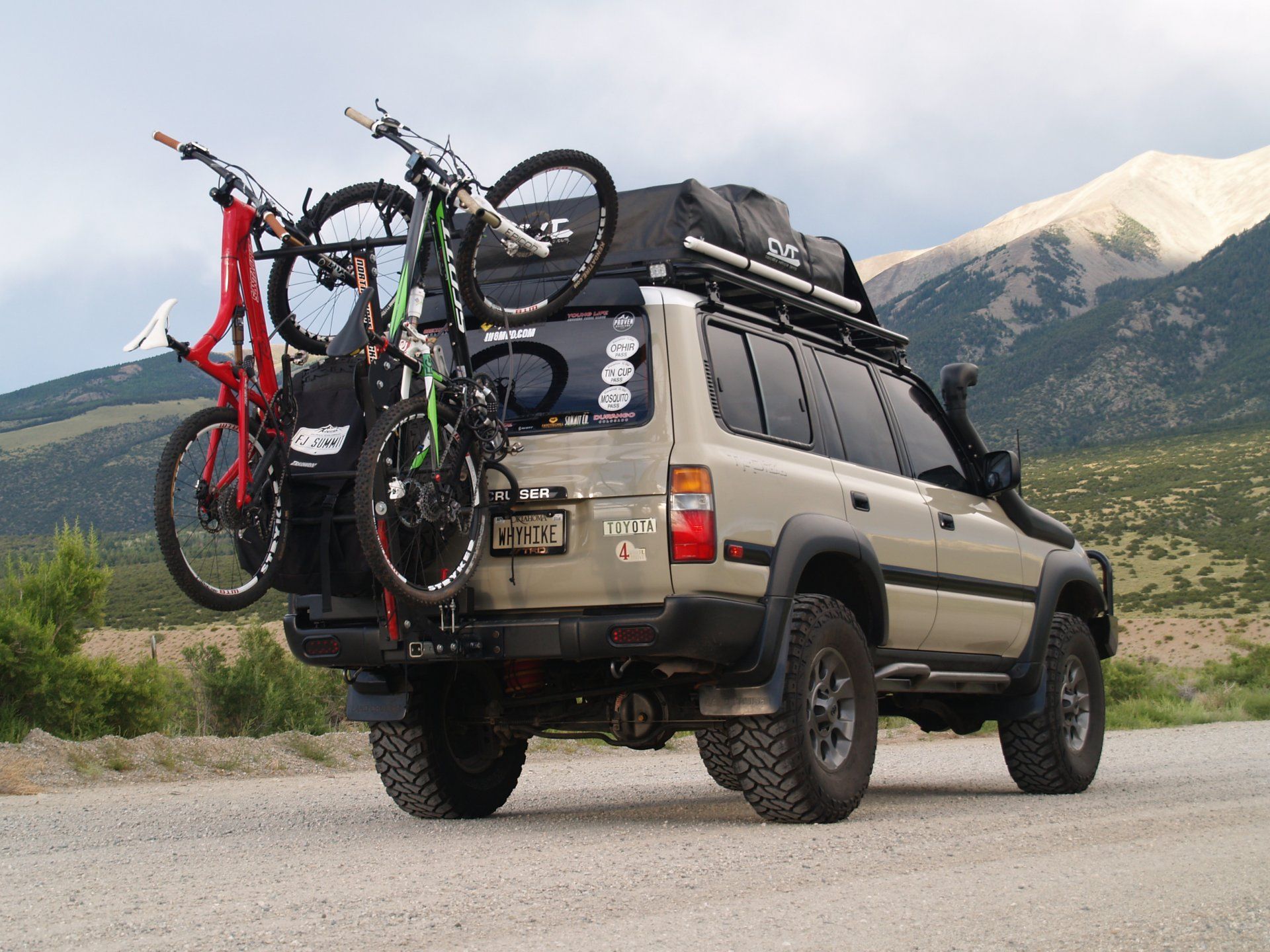

What kind of bike rack is that? I've been looking for one that carries like that!
It's a Northshore nsr4. It's been great. After 10s of thousands of miles of trips the only damage to my bike I'd some pain rubbed off on the fork crown
duplicolor bronze with clearcoat on a 40th.
