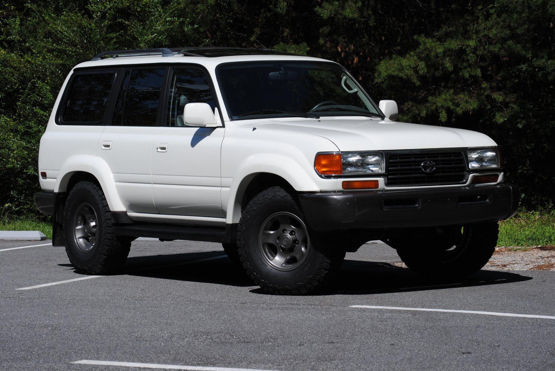

Sanded down to bare metal with 600 grit.
2 coats self etching primer.
3 coats of Duplicolor Graphite.
3 coats of Duplicolor Clear.
1 weekend of my life that I will not get back.
Holding up nicely so far.

I don't remember what the specific brand and color was for the paint I used on these wheels, but I need to figure it out because I think it looks great and is a good match for the factory color on the bumpers, I know that it was something readily available in either one of the auto parts stores or Home Depot or Lowes. Some sort of metallic gray.
EDIT: I think it was Duplicolor Graphite, no clear coat.

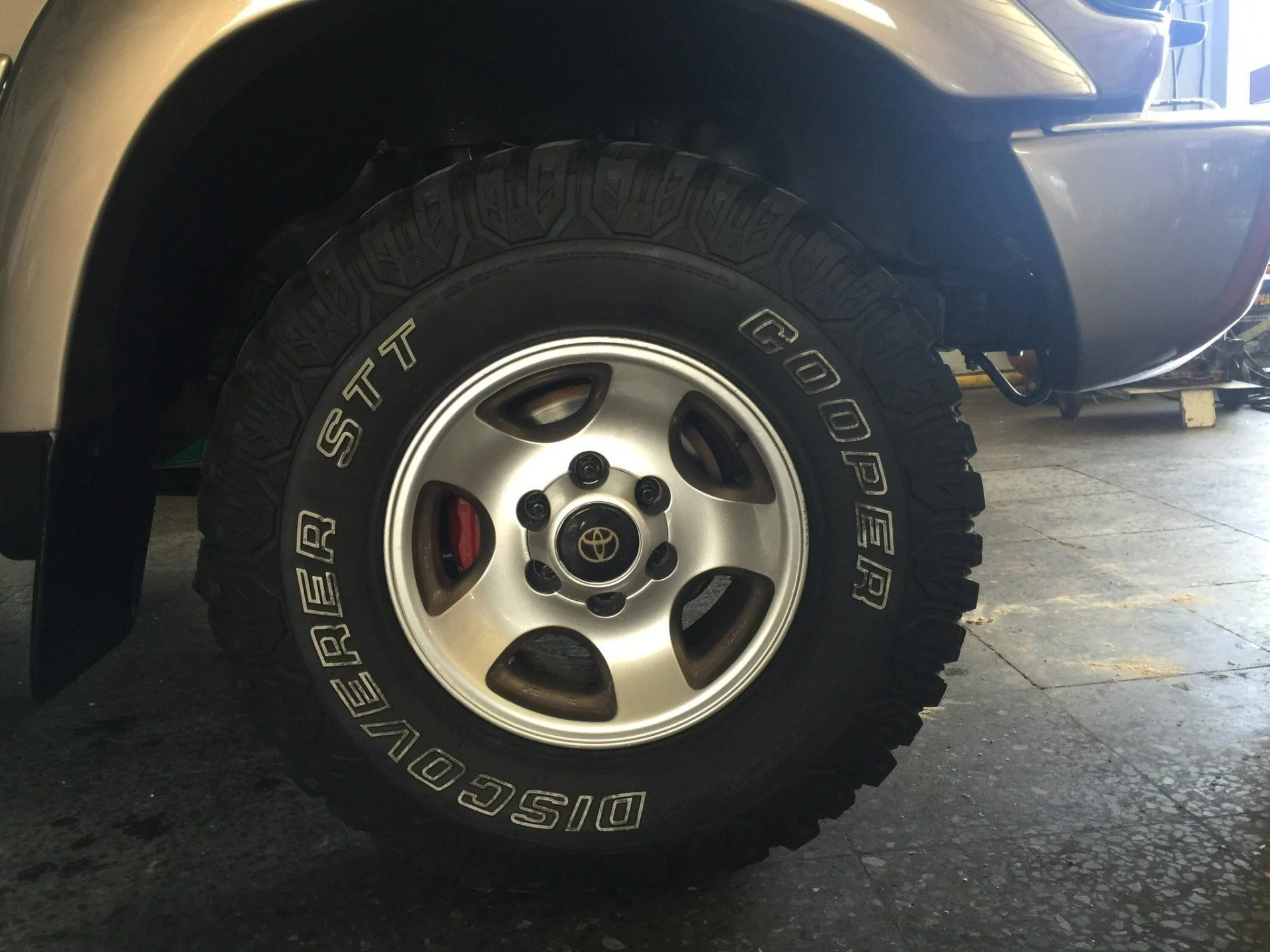

Is that duplicolor silver? Looks great. What lift and tire size is that too? 33's?
Hi there these are 33's 285-75-16 coopers but changed them now to same size BFG KO2's.
Lift is 2 or 2.5 OLD MAN but can't be sure as it was on the car when I got it.
Also can't remember the code of the silver paint for wheels but can tell you it's a sparkly silver that shines out. Had a choice of 5 & this was the best I felt to bring shine to them.

I hear ya there. I got them refurbished at the body shop so as for a ready spray can colour I know this colour was not available for me.

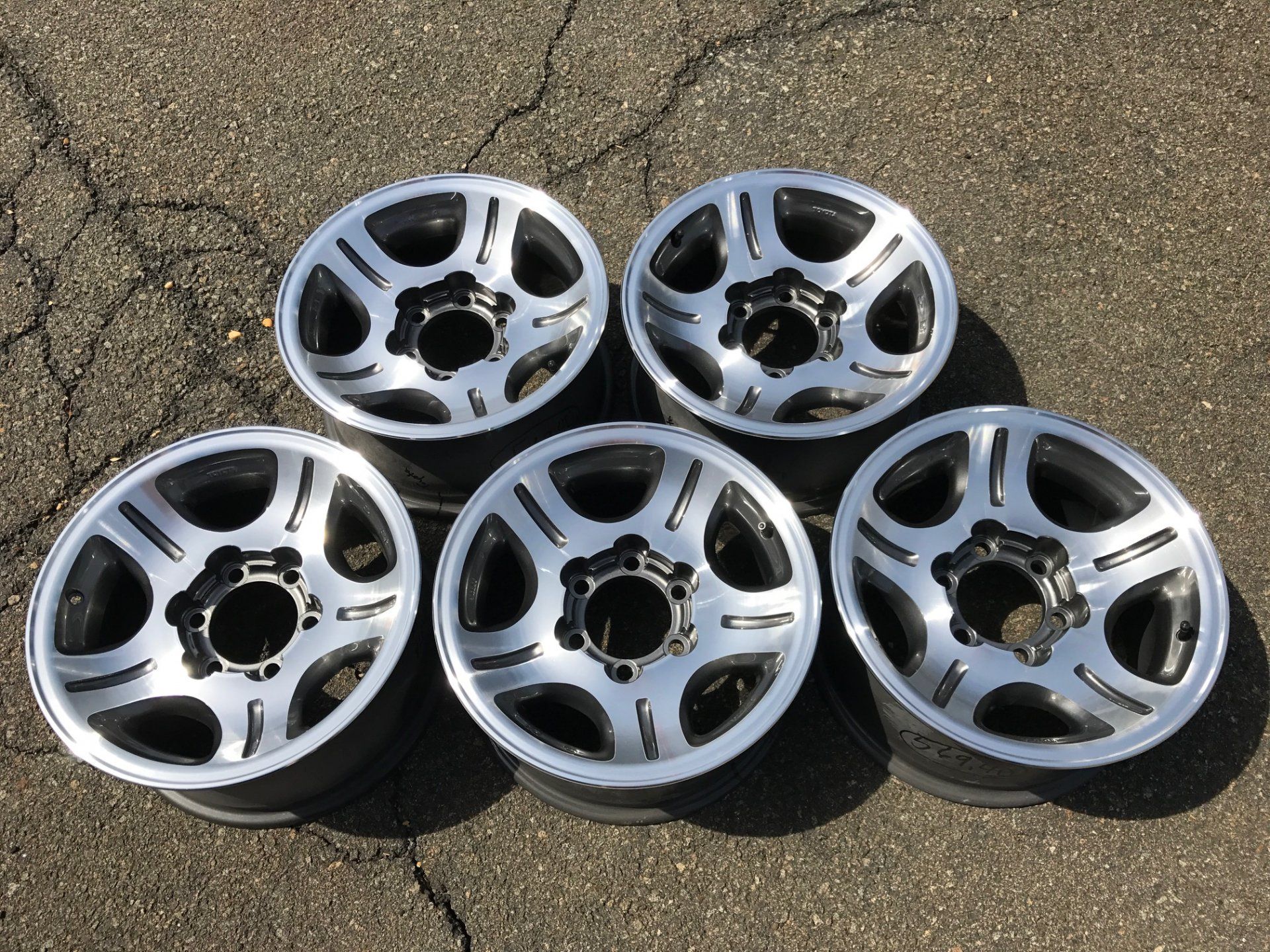

I had my LX wheels refurbished.
They took them down to bare aluminum, filled in the scrapes, gouges, and salt pits, repainted the factory two tone paint, polished to a shine, and then clear coated over the whole process. It ran about $150 per rim and all the rims were nasty with salt blisters and pits. Not cheap, but I wanted a factory look and I am VERY happy with the results.
Old to new
All five completed.
I had my LX wheels refurbished. They took them down to bare aluminum, filled in the scrapes, gouges, and salt pits with new aluminum, repainted the factory two tone paint, polished to a shine, and then clear coated over the whole process. It ran about $150 per rim and all the rims were nasty with salt blisters and pits. Not cheap, but I wanted a factory look and I am VERY happy with the results.
Old to new
All five completed.
great looking, gj!
