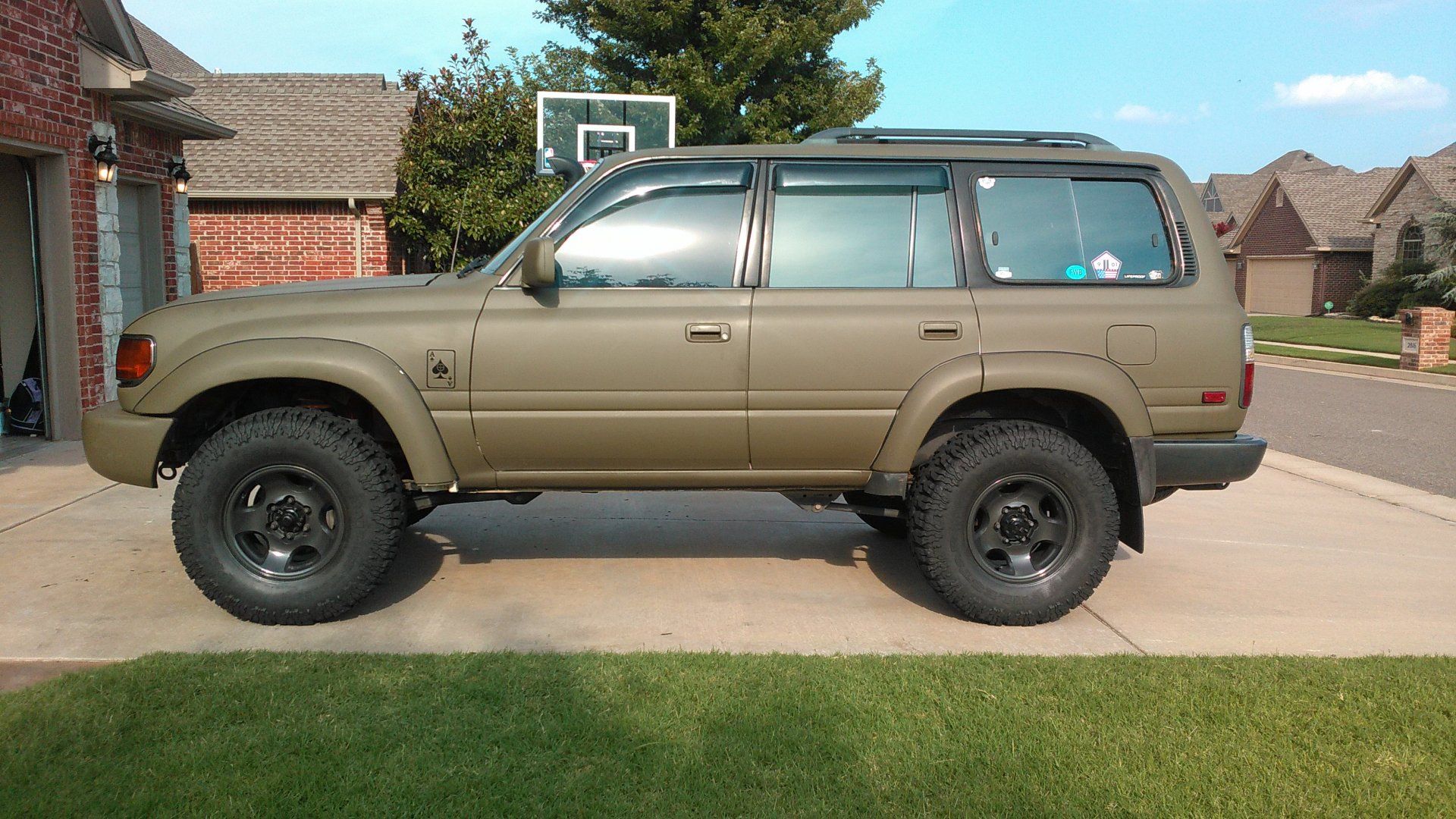

Both of these setups are sick! I love the steel wheels on the 80 series. Wheel and tire specs and backspacing? Thanks in advance!
dsc02896-jpg.1407837
Wheel Vintiques Series 12 Painted VHT Satin Black wheel paint, no clearcoat.
Has lasted pretty well, had to touch up a few chips spots over time.
The white wheels are on my truck. They come from 3rd generation 4runners spare wheels. There were 3 different types, so took a little work to get 5 of the same wheels. I have run them with and without spacers, spacers push them out and give it a little more of a bold stance, currently running without them. I ran them with 285/75r16, this picture is with the current tires, 315 75 r16 bfg ta ko2.

The white wheels are on my truck. They come from 3rd generation 4runners spare wheels...I have run them with and without spacers, spacers push them out and give it a little more of a bold stance, currently running without them. I ran them with 285/75r16, this picture is with the current tires, 315 75 r16 bfg ta ko2.View attachment 1563421
Thanks!!! Do you happen to know the specs on the 3rd gen 4Runner wheels? 16"x7"? What is the backspacing both with and without the spacers?
Thanks again!
I believe they are 16x7 and backspacing of 4.625" the spacers in the picture are 1.5"
