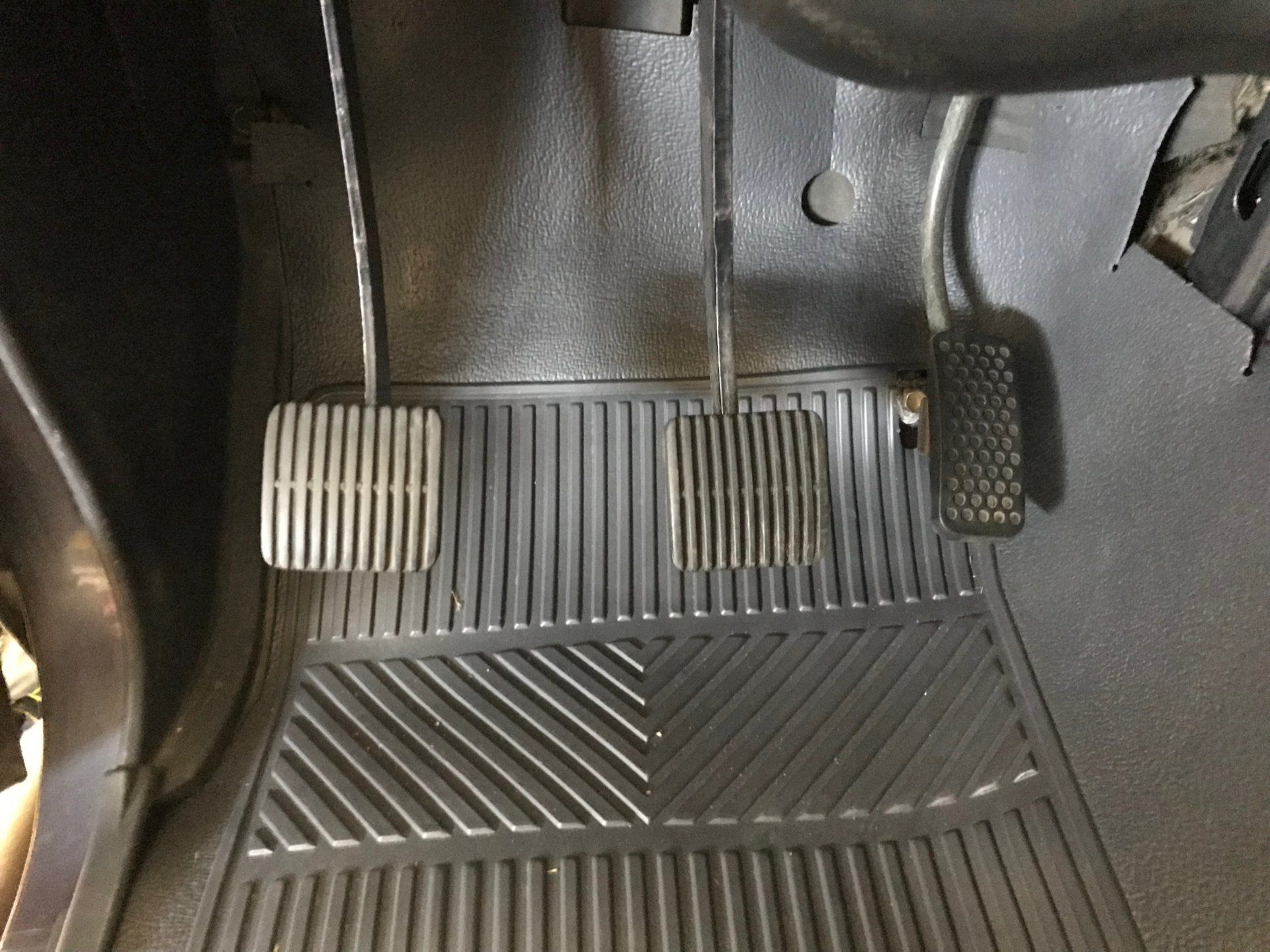

In between playing with the Troopy....we put this brake pedal in....2 of the 3 pedals are now accounted for. Getting more legit by the pedal.

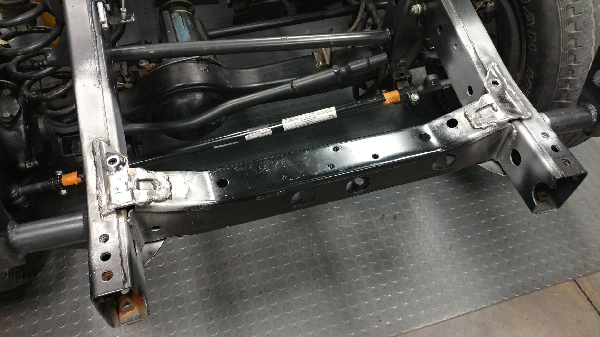

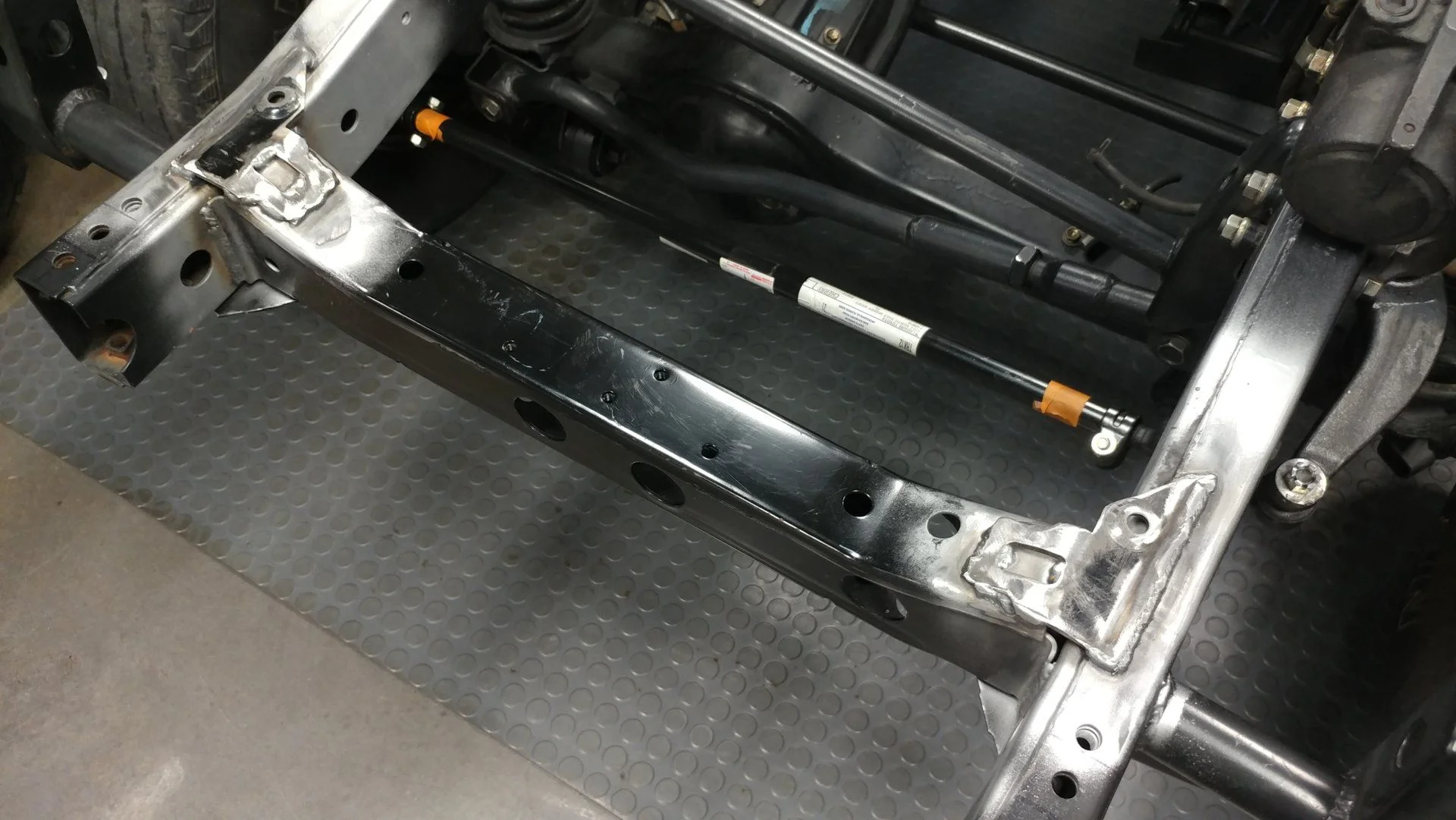

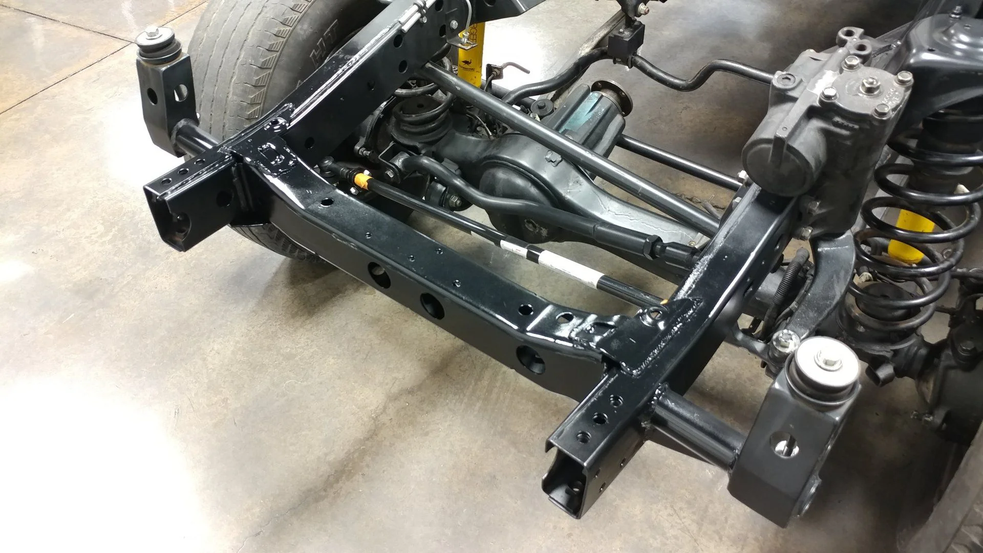

FINALLY finished this project. Really wish we didn't have to tear up the powder coating on the frame. Fortunately most of this stuff gets covered with parts and will most likely be covered by dirt.

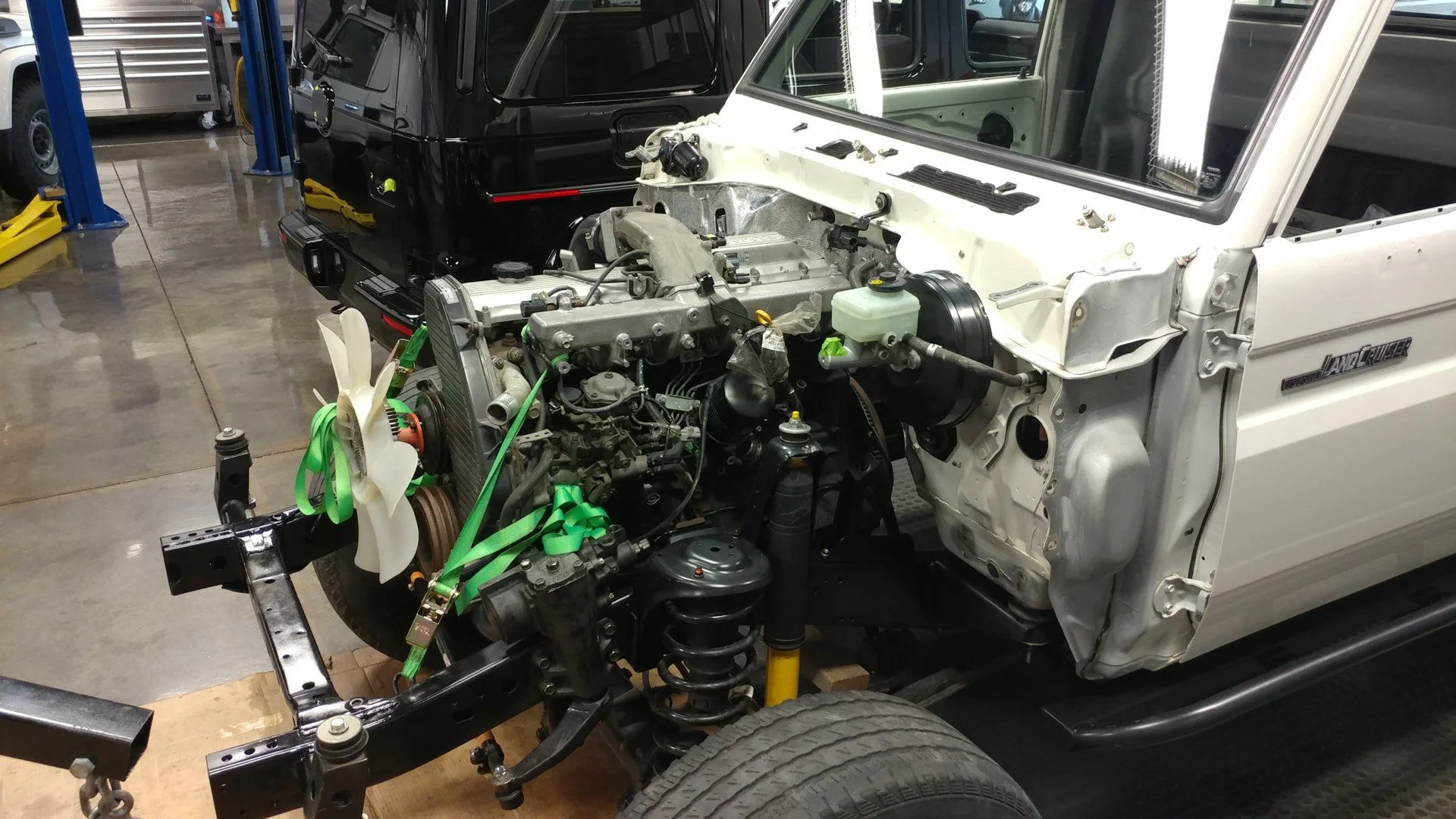

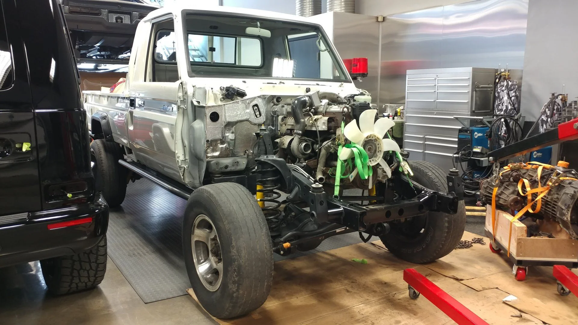

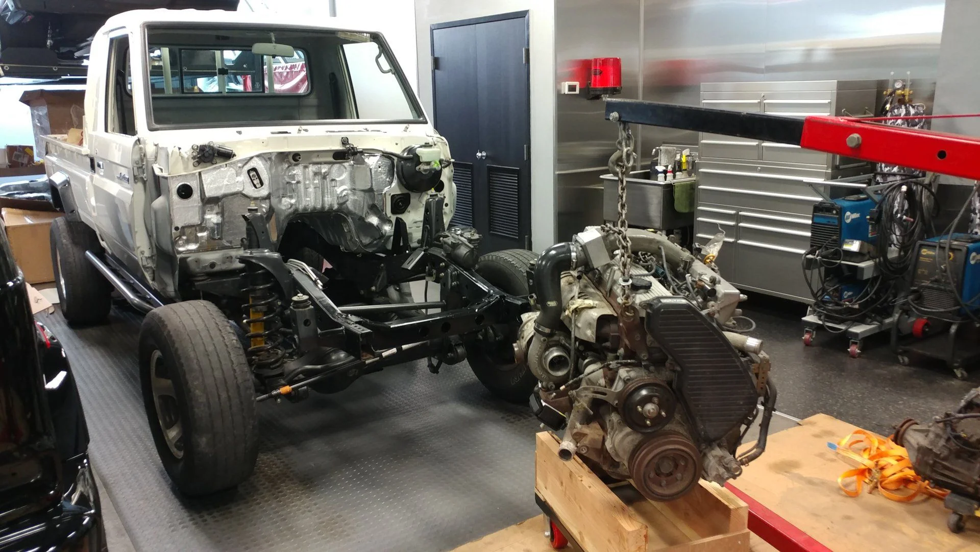

Finally something of significance....got started on this.
Dropped right in like it was meant to be.
Trans tunnel opening is about 3.5" too far reward which is what we kind of figured(H151 vs R151 length)....so we will mod the floor. Might pull the cab off to start on that project here very shortly(going to undercoat while we have the cab pulled....

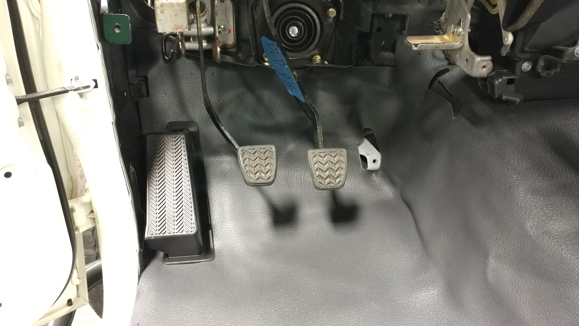

I wish I had room for a dead pedal. Hmm....View attachment 2034023
Wonder if a later model pedal would fit? Seems they are pretty interchangeable. And if not, they can be made to fit. The dead pedal is held on with 2 studs...easy to make a bracket. And it will fit with that kick panel I think.
I didn't even realize that there wasn't a dead pedal on my 73. Lol. Guess my foot is too busy shifting to rest it.
Yes, it seems like it would be a fairly easy mod. I'll have to think about whether the pedal spacing/positioning will be more/less favorable. I did have a RHD dead pedal on hand but I threw it out a few weeks ago. :doh:
Yes, it seems like it would be a fairly easy mod. I'll have to think about whether the pedal spacing/positioning will be more/less favorable. I did have a RHD dead pedal on hand but I through it out a few weeks ago. :doh:
Cruiserparts has the clutch pedal for $35. Hard to beat. Except for it being Cruiserparts. Ha. I will say, the last few things I have sourced from them haven't required 15 phone calls and emails to get the status on. And they have shipped the right stuff. They have the dead pedal too.
