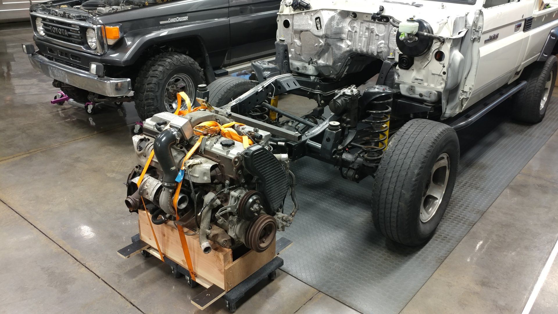

That poor Tacoma gets a workout with hauling all these Land Cruiser parts! And yeah....that crate was a bit much for it. I think the 1HDT I bought with an auto and ALL of the parts that went with it from an 81 was a tad heavier.
The 1HZ is really clean. Missing a motor mount though. LH mount.
Did not notice that but probably have one somewhere in the shop , I will look for it and send it to you.
There is no 1HZT from the factory. Perhaps you meant to say 1HDT?

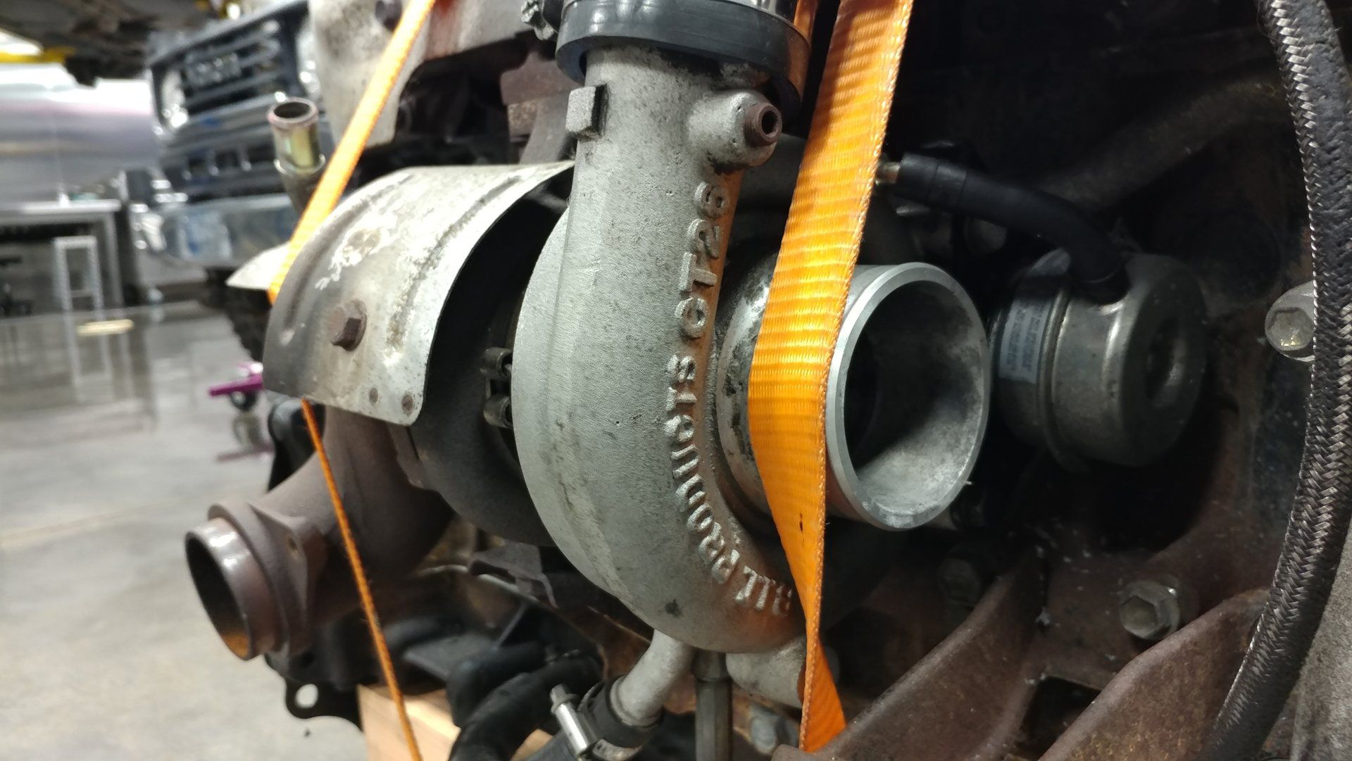

Just what I'm calling it....it's a 1HZ with an aftermarket turbo. I believe @joekatana said it was done in the Netherlands by a well respected shop. Customer removed it to install a 1HDTFE. Joe mentioned an early 2000s 74 or something that it came out of. Should be nice in the 79....
Pretty neat turbo setup on it...should do the trick.
A turbo (moderate boost / 10-12psi) will make a 1HZ come alive. You'll like the results.
It's going to be a great setup.
All American Imports in Kaatsheuvel the Netherlands build it , they have a reputation for not being cheap but doing things the right way. I believe they even have zero miles new 1HDT's sitting on the shelves for sale , probably cost anywhere from 15 to 20K just for the engine but they are the only ones I know that have stuff like this.
