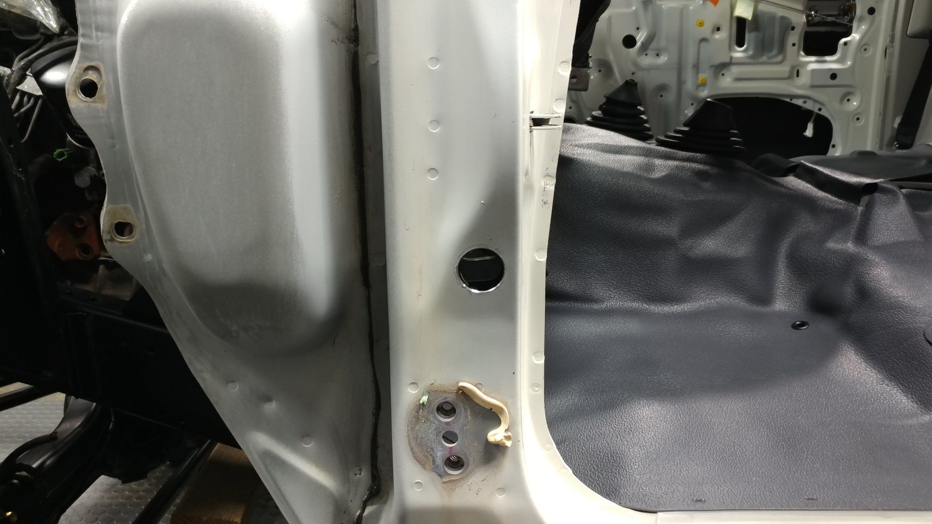

Drilled some big ol' holes in the body and the doors today. Harnesses fit like they were meant to fit. Almost all the clips line up to secure it in the kick panel area as well as in the doors.

Are you putting anything on the bare metal in those holes to protect them from rust, or just relying on the rubber boots?
Any hole we drill in my shop gets paint on them. Usually 2 coats to make sure nothing is missed. I should have drilled these prior to coating the floors...could have sprayed some of the sound deadener in the hole....it's really tough stuff. Paint will be fine though. Haven't had any issues in 25 years of drilling holes in cars.

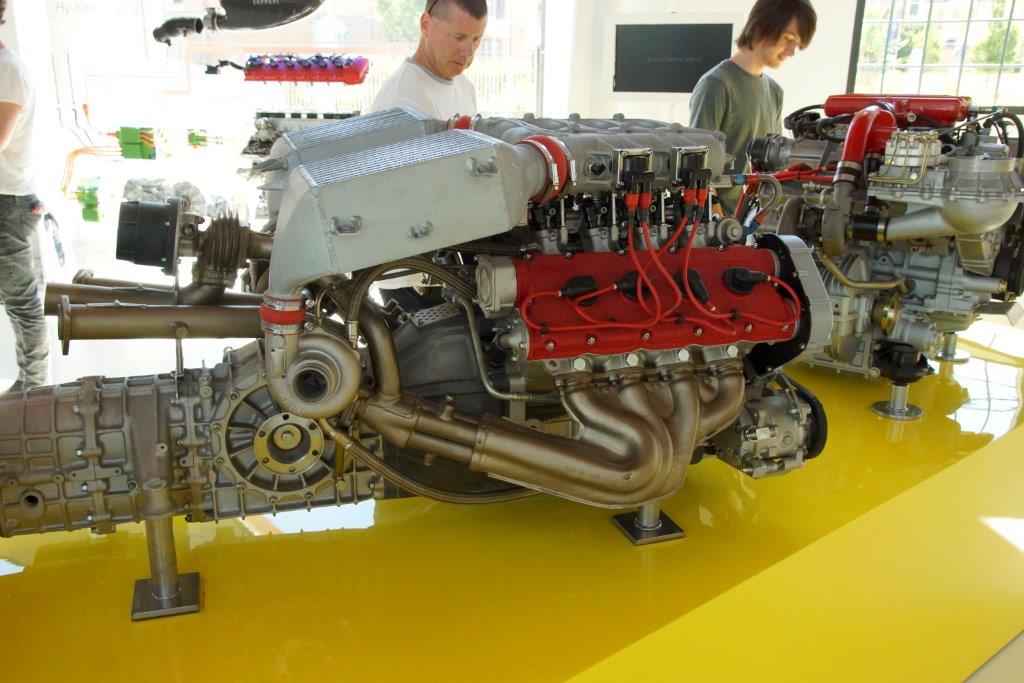

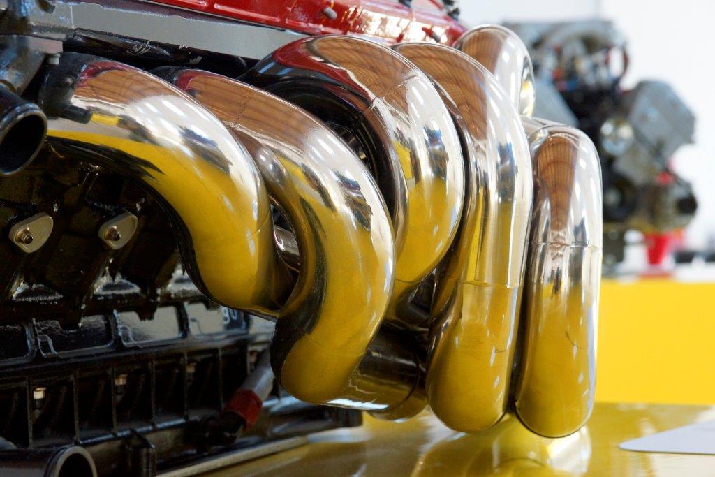

Sorry, way off topic but i just got back from a holiday in Italy which included Bologna so obviously the Ferrari musem. The only thing missing was a small quiet little room to be alone with you thoughts for a while, and a big box of tissues.
Sorry, way off topic but i just got back from a holiday in Italy which included Bologna so obviously the Ferrari musem. The only thing missing was a small quiet little room to be alone with you thoughts for a while, and a big box of tissues.View attachment 2041951
Cool pics! What a fun place to visit. In what seems like another lifetime, I worked at a Ferrari dealer as a tech for a 3 years. We would take these motors out of cars(3 year/15,000 mile engine out service) and it was always shocking how small they were when they were taken off the gearboxes and out of their subframes. Tiny. I believe the turbo motors in your pics are an F40 and a 208 Turbo. The F40 motor is a work of art.
Spent some seat time in an F40 at that job.....out of all the cars I've been fortunate enough to put the skinny pedal down in....nothing will come close to an F40. An insanely raw and pure car. Plenty of faster cars in the current group of super cars but nothing like an F40. I still can't believe they would let me drive those cars. Ha.
