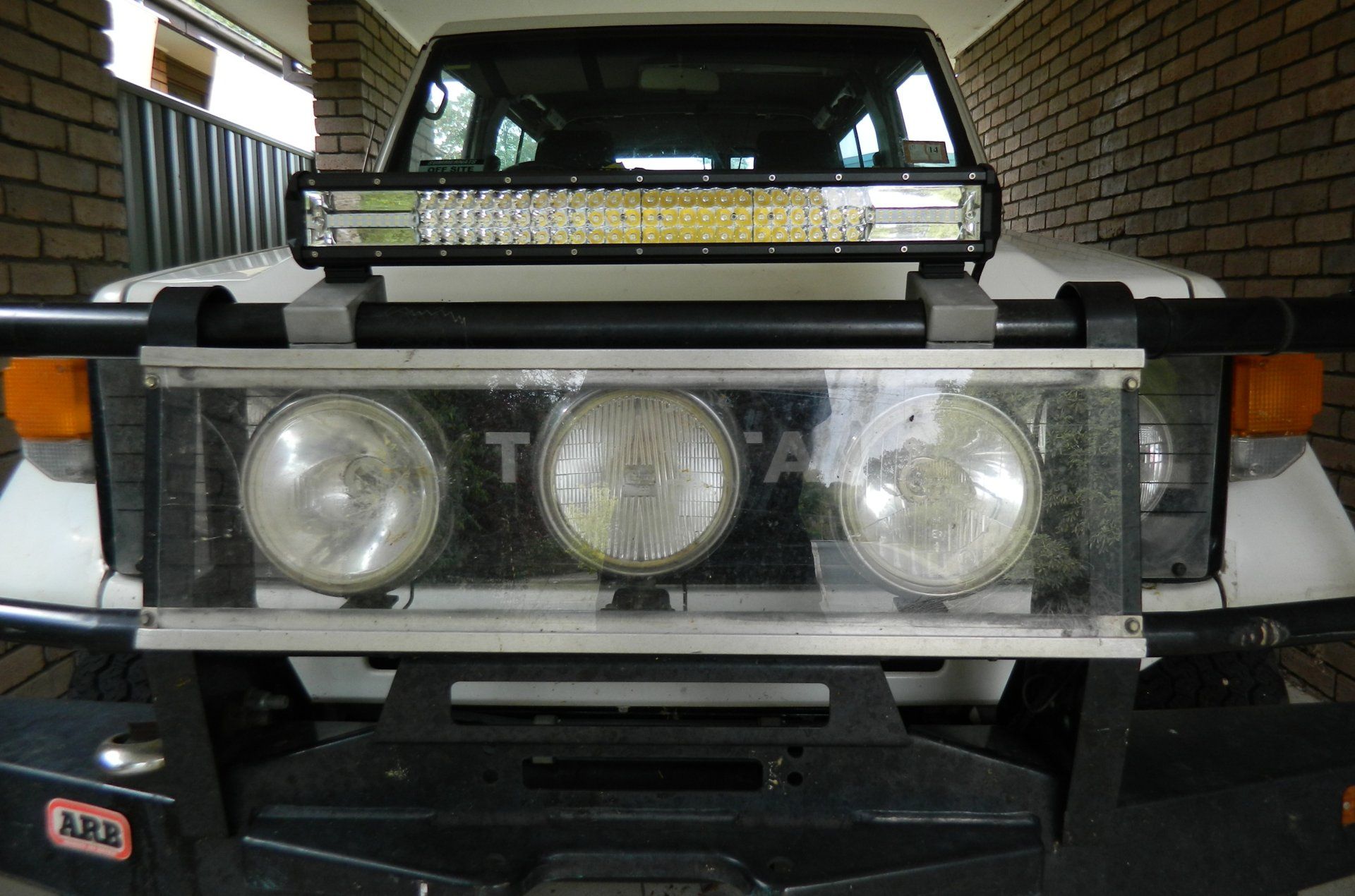

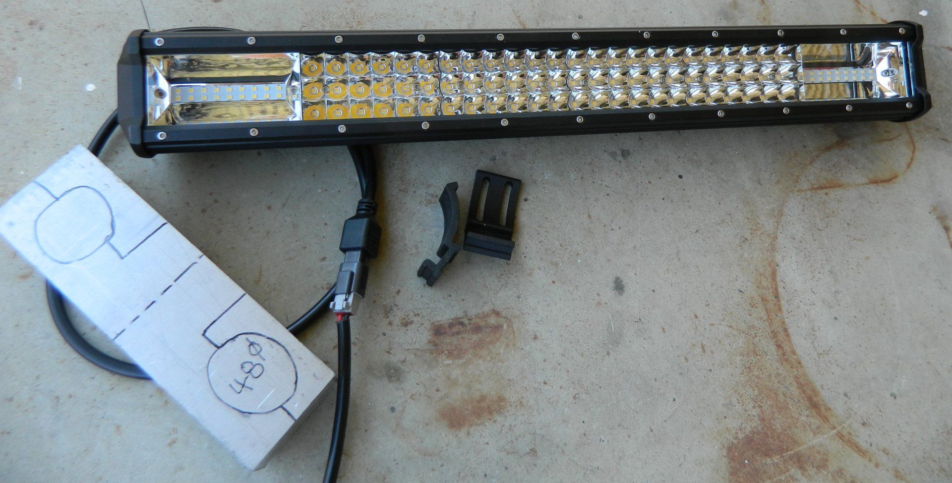

But recently, I felt it was time to make a move on this, and purchase and mount a LED light bar (iirc, 162 Watt and 13.5 Amp) on the Battle Cruiser.
It wasn't that simple, as I couldn't have just any light bracket for this light bar, i had to "Do It My Way".
So.........
Here is the 24" light bar and the slab of 50mm thick Aluminium, for the mounting brackets.

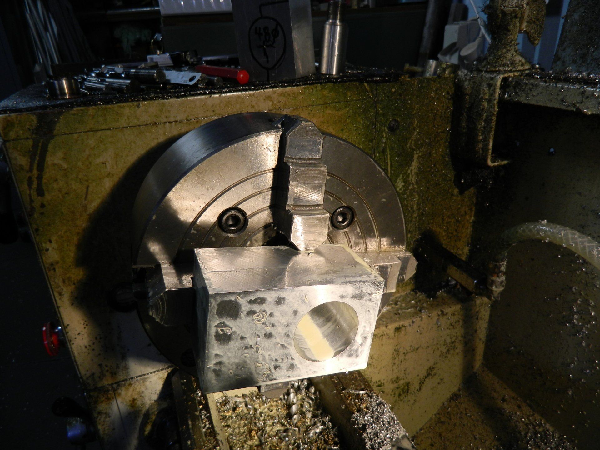

The same slab but in two pieces now and in the lathe, being bored out to 48mm DIA.
Ditto
Ditto

So with all the bits bolted in place, last night I took the Battle Cruiser to the car park of a sporting field, and adjusted the light bar.
After this, I took it for a run to the rural area (10 minutes from home), and WOW!
Why haven't I had one of these, like YEARS Ago?
Let me say, There Was Light and Homer is a Happy Lad!
