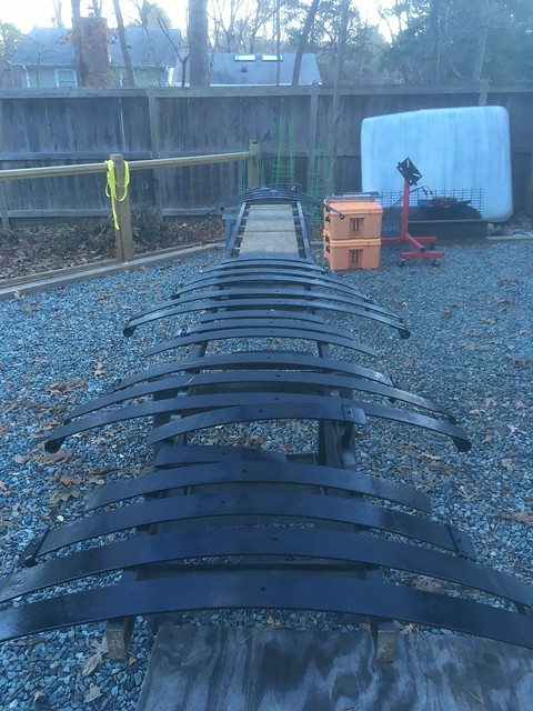

- heated and then pried the leaf spring bands finally removing the center pin, separating the leaves for each pack. I’ll wire wheel, paint, graphite coat then reassemble one day this week.

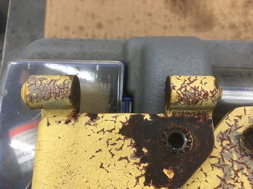

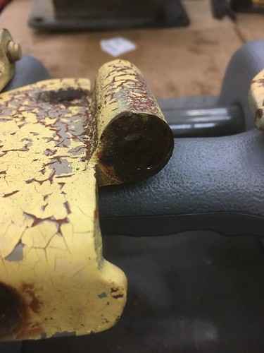

Fun find...the pin for one of the windshield hinges was broken in two places! No worries though, I’ve got a set of Steve’s stainless hinge pin sets that we’re going in regardless. The broken ones will need to be drilled out for sure!
Anyone know the fractional drill bit to use for the windshield hinge pins?

I drilled a little bit of the pin, set a bolt in the pocket and pressed it out with a vise.
Spanned the backside with a nut
Added a nut so the pin didn’t hit the vise jaw
I took yesterday off work as the weather was forecasted to be super nice! I spent most of the day wire wheeling, cleaning with acetone, painting and then coating the underside of the springs with Slip-Plate. HF it was a lot of wire wheeling with the angle grinder...my hands are still vibrating (even with wearing anti-vibe gloves).

I may have missed your explanation but why did you decide to redo your springs this way instead of A) getting them sand blasted instead of wire-wheeled and B) buying a new pack.
Initially I thought it was a cost thing but if you're taking off work....
Yeah I could've taken them to get blasted for sure...probably would cost a couple hundred bucks. Could've bought OME replacement springs as well...I don't look at the build as much from a cost / benefit thing, more about just doing something with my hands that's fairly simple and I get near instant gratification from my efforts.
Sitting behind a desk all deal dealing with risk based decisions and projects that take years to materialize while pays the bills, can be exhausting without some sort of relief. Keeps me content and sane (in my mind) even if others see it as ludicrous. While I may sound like I'm complaining...I truly do enjoy the process of taking something old and refurbishing it to function similar to when new.
I do think that what I hope to do 'next time' is to either 1) buy a bigger blasting cabinet to fit springs / larger items in OR 2) pickup a pressure pot blaster vs wire wheeling.

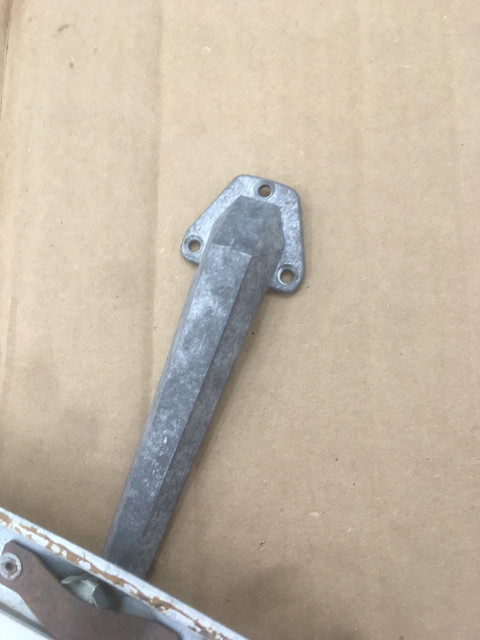

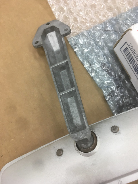

I couldn’t risist the urge to try and clean up the rear view mirror I lucked into. A gingerly glass bead blasting cleaned it right up!
Was the arm and mirror back painted? What color?
Mine is that exact finish, I’d just leave it...maybe matte clear if you’re worried about corrosion.
