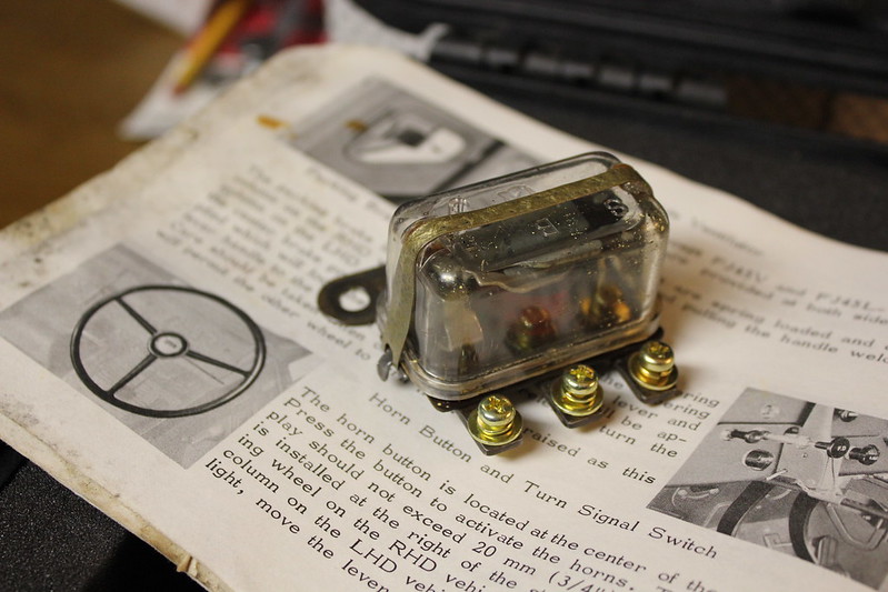

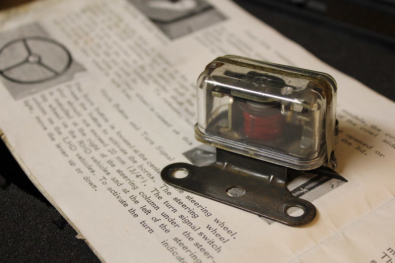

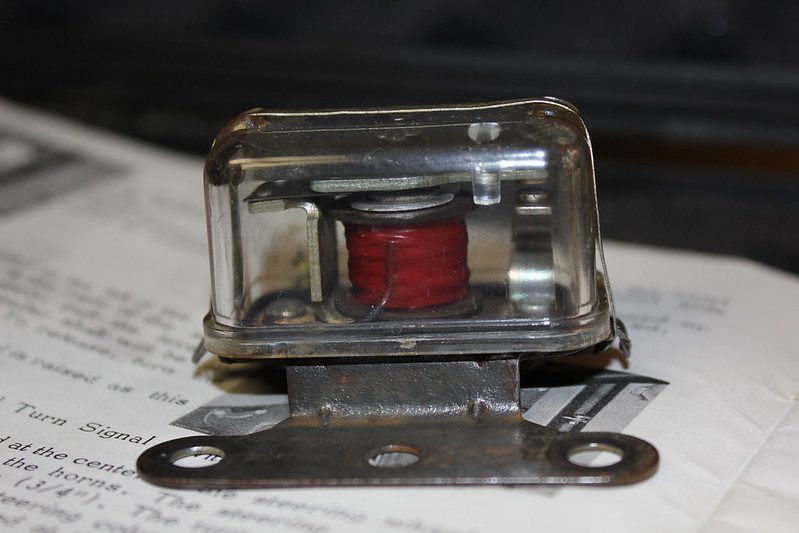

This cool little gadget was in my 'trash' pile (funny cause I throw nothing away) until I saw @FJC Mtneer mention in his FJ45 thread that it is the horn relay. It was so nasty that I thought it was a solid metal rusty cover...cleaned up pretty good!
They definitely don't make relays like they used to!
Nice job! Looks like new. You have skills my friend.

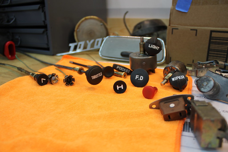

Spent another cold and rainy day in the shop... Worked on cleaning up the dash switches / knobs and running boards.
Knobs...simple green, a 3M maroon scrubby, paint and more scrubbing produced some nice clean refreshed pieces. Still undecided if I want to clear them??? Used the dremel and a wire wheel plus lots of patience to clean up the switches and brass ferrules. Notice something missing...still searching for a choke cable, '67 correct cig lighter and interior light switch.

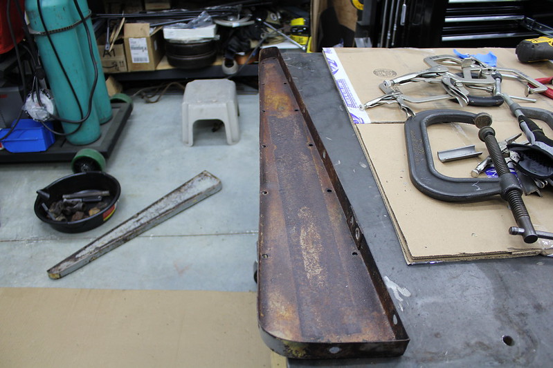

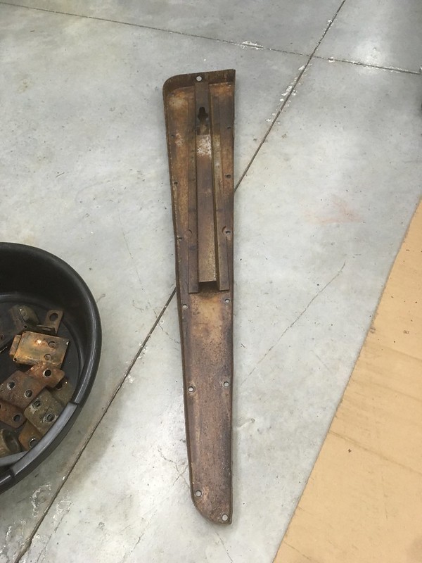

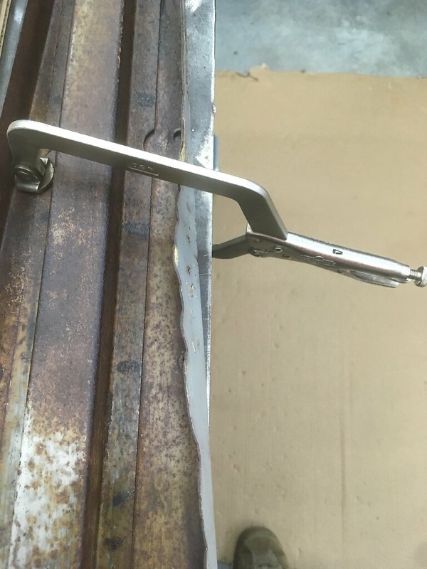

On to the running boards...which were anything but straight to begin with. I had very low expectations based on what I was working with...
Driver's side, which is the better of the two.

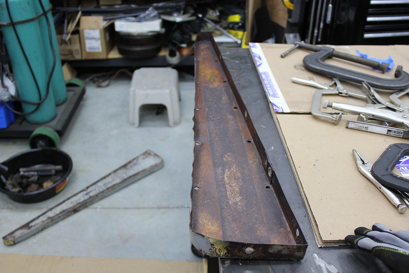

Passenger side...pretty much focked.

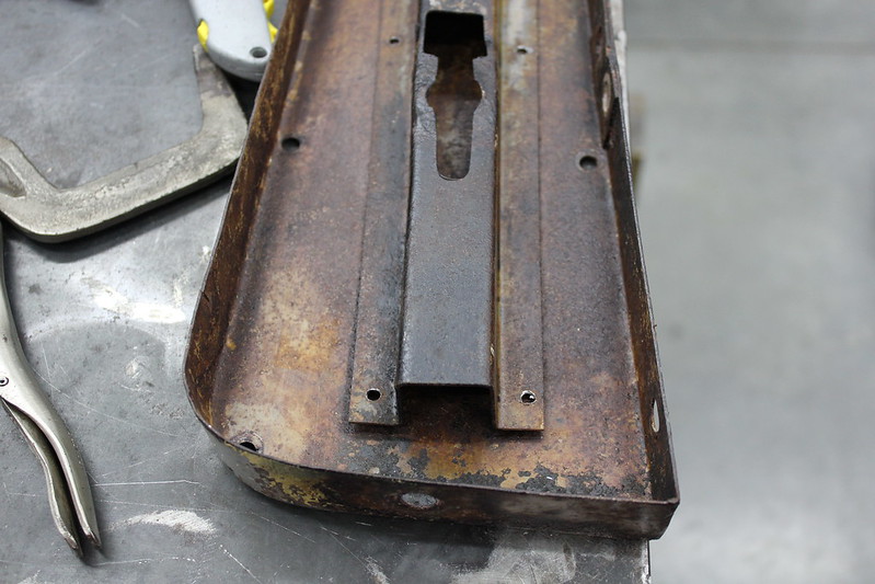

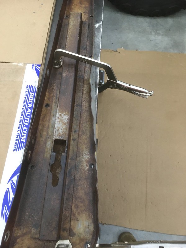

Passenger side in process...not bad so far.

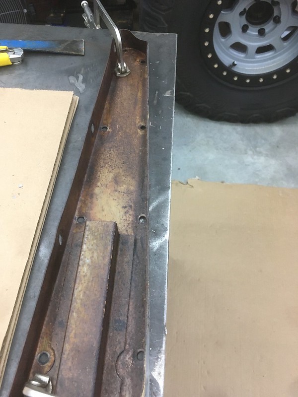

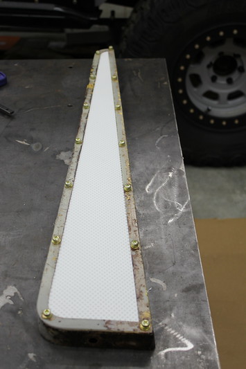

Got into a grove and was able to get both back to 'straight enough'! Was as simple as some vise grips to hold the board flat and a big ass c-clamp working down each side. The corners were tricky but a piece of scrap round tube helped reform the profile.
Passenger side done.
Driver's side done.

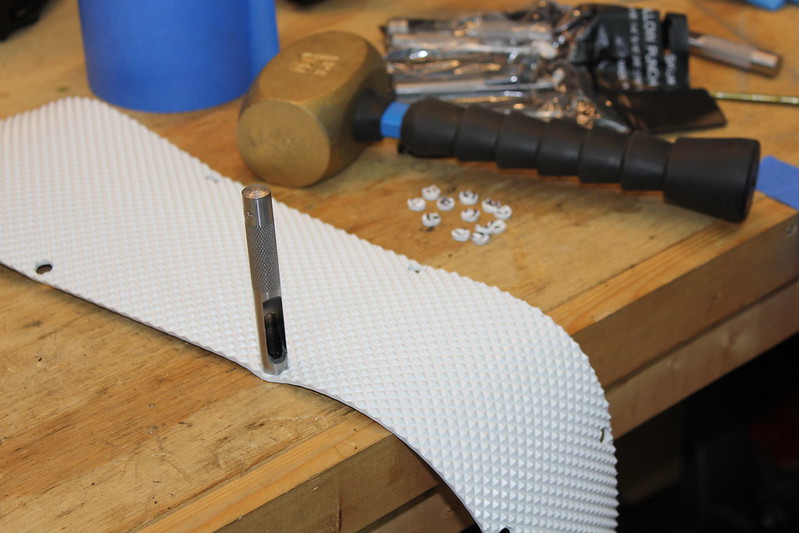

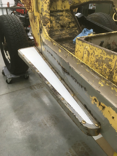

Since that went way quicker then I anticipated, I had time to work on cutting some pyramid rubber matting. Got both sides cut and holes punched. The matting isn't that hard to work with and would likely be much more pliable on a warm summer day...

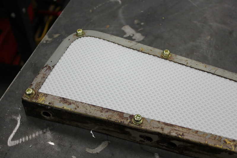

I had ordered some pan head JIS screws from our friends in the PROC...but all that arrived was an empty padded envelop with a small hole that I imagine all the screws used for their escape. Instead of waiting on another package I assembled the passenger side with some JIS SEMs I had on hand...which are definitely too tall and look a bit awkward vs just a plain pan head. These will get swapped out once the others arrive.
Drivers side needs the 'support' rib rewelded to the step before bolting the top piece and rubber...project for tomorrow!

I felt the need to actually reattach something to the tub as I’m been removing and disassembling for what feels like an eternity!
Running boards!

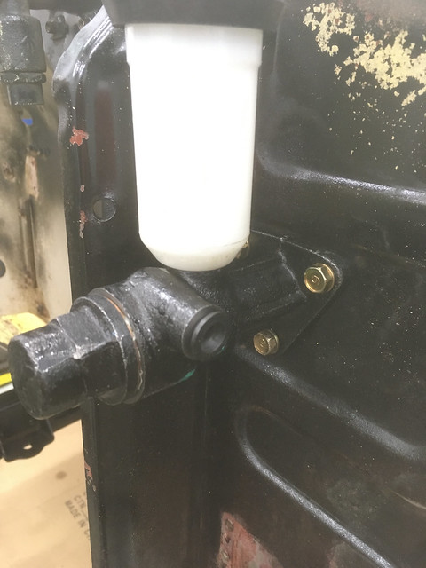

Clutch master from Curt @ Cruiser Outfitters with newly replated oem hardware...zero clue if the bolt labels are correct for this location but it looks nice!

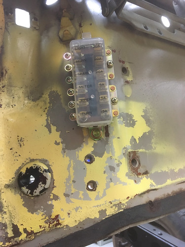

...and new fuse panel plus reproduction wire harness grommets from Roger @ City Racer...again, fancy fresh plated oem hardware.

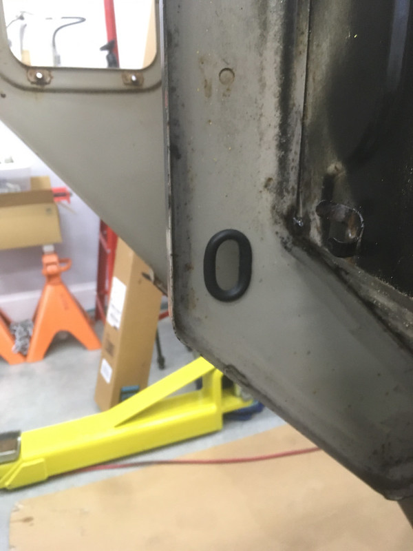

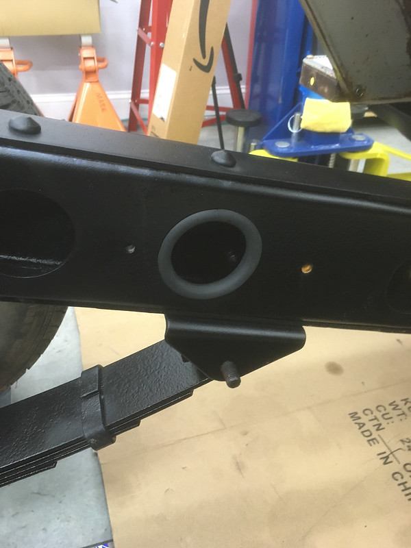

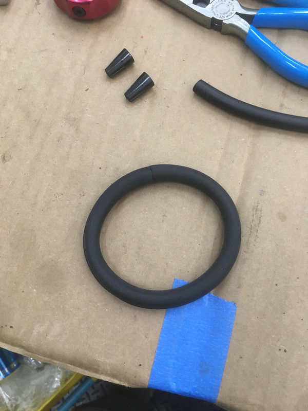

The '67 (and some earlier trucks) have a one piece plastic fuel line from the fuel filter to the tank and it runs within the frame rail. I pulled mine before getting the frame blasted/painted and after giving it a once over it seemed in good enough shape to reuse. The frame hole grommets were dry rotted/half there and long NLA so I improvised and made my own.
I took some larger vacuum line, sliced it down the center line and then glued the ends together. Turned out really nice. There are two of these, one pictured below (where the fuel filter will mount) and the other is the frame hole just forward of the tube cross-member.

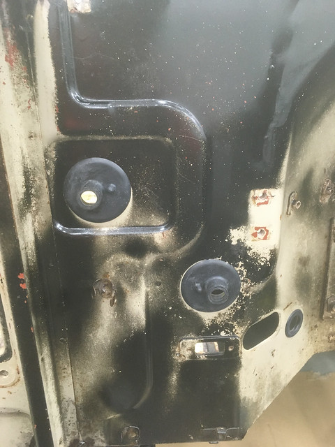

I ended using a similar technique but with smaller vacuum hose to remake the grommets for the firewall rib wiring pass-through (DS and PS).

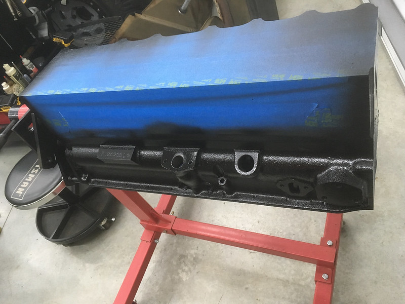

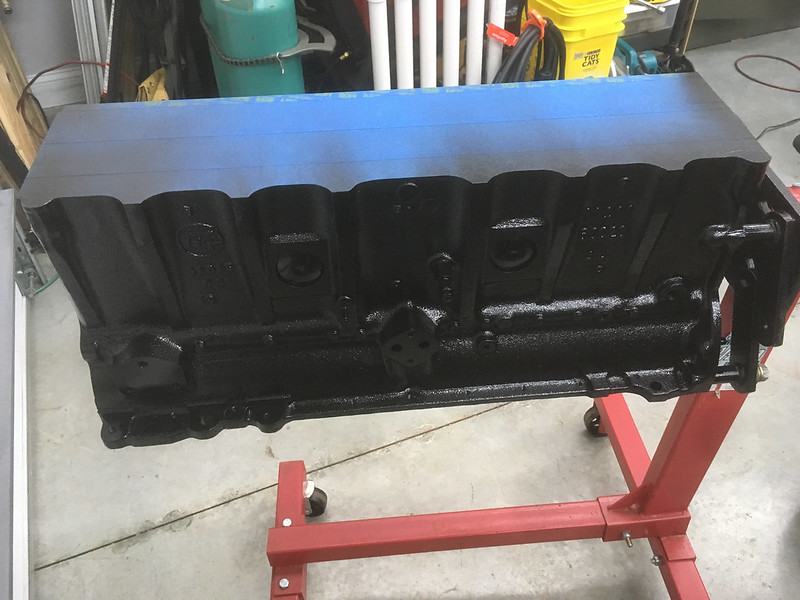

Also got a few coats of paint on the f135 block. Going to start assembly later this week after the paint drys...
