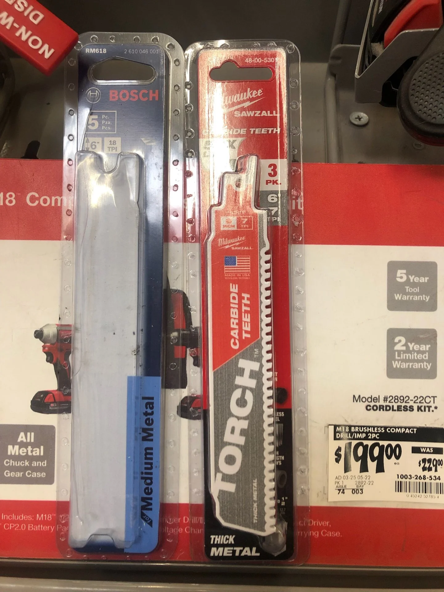

Hi all!
Just wanted to pass this on as it made a frustrating LCA removal a bit easier . If you have frozen sleeves and the camber bolts preventing you from removing the LCA grap some Milwaukee torch heavy metal sawzaw blades. Those bolts ate everything I threw at them and my 4inch cutoff wheels were not deep enough. Hope this saves time and trips to the store.
